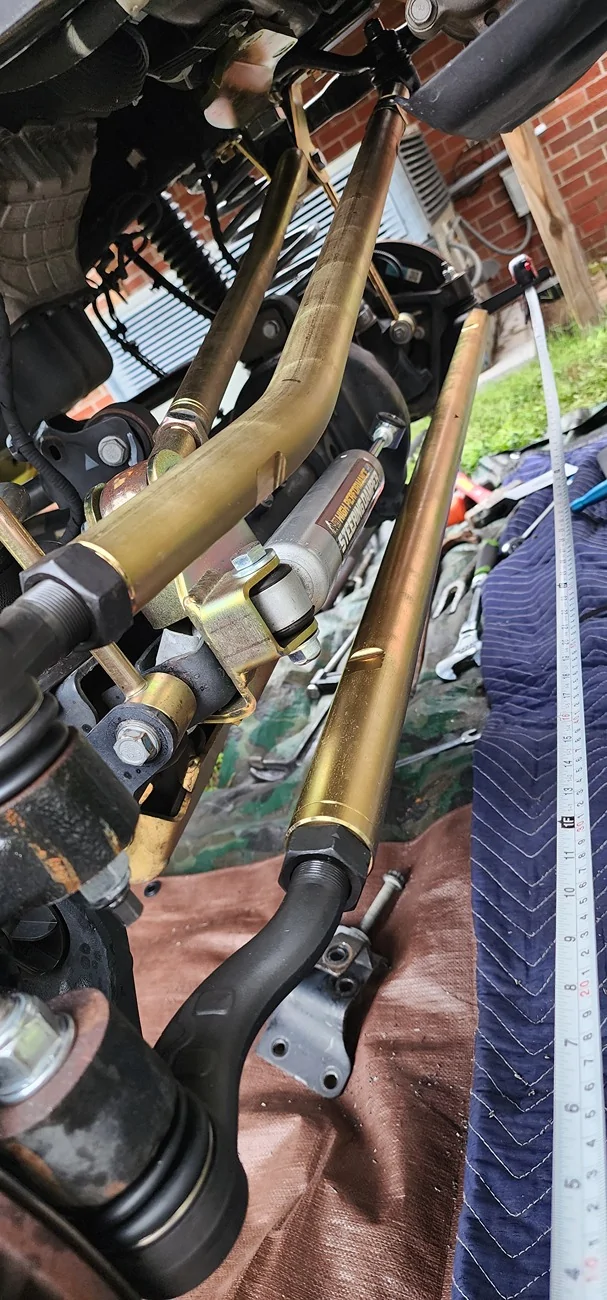

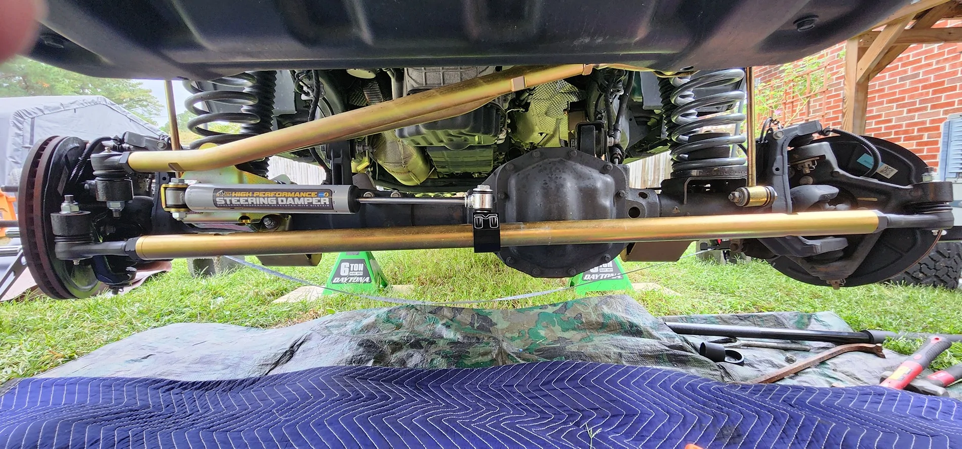

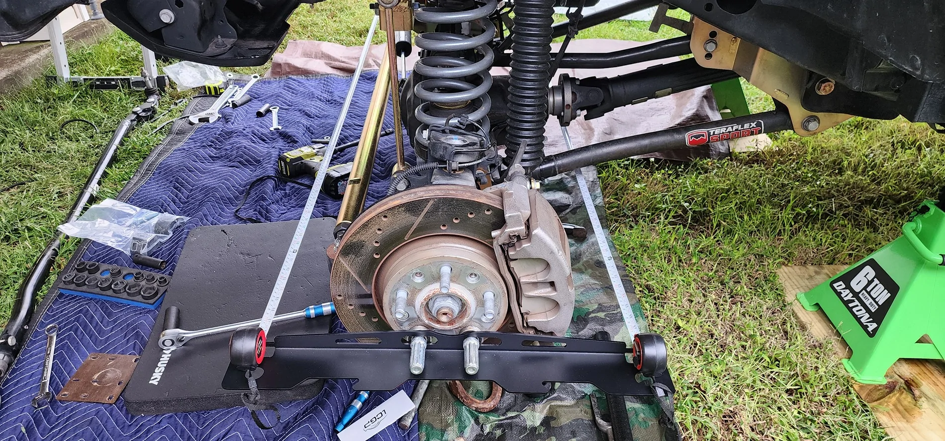

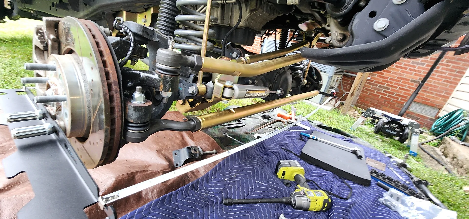

Finally was able to install the @Metalcloak Draglink Flip kit, TieRod bar, and their Billet Stabilizer mount. Got it aligned within a Frog's hair.

Test drove it after tightening everything up, greased the balljoints. Drives straight as an arrow doesn't pull when you brake, and adjusted the draglink for the steering wheel so it's nice and straight too. Couldn't be happier at the moment, and the Lions won too!

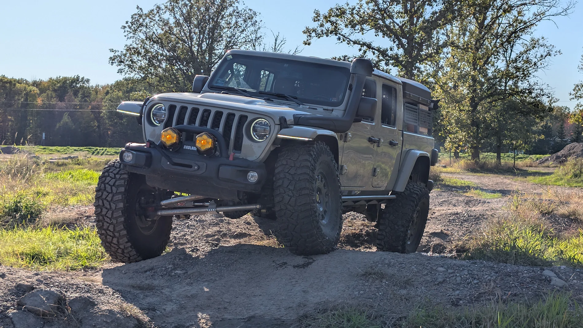

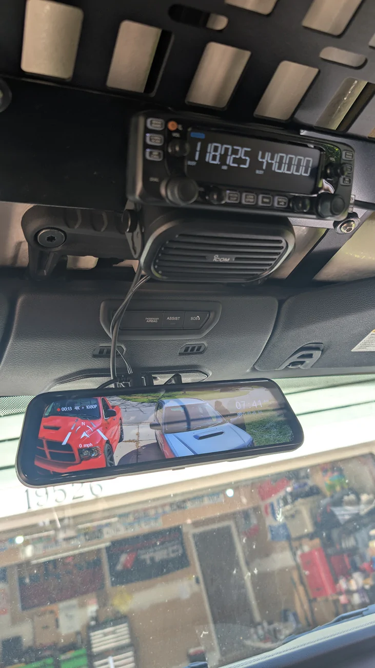

Radio works. Lights work. Mirror works.

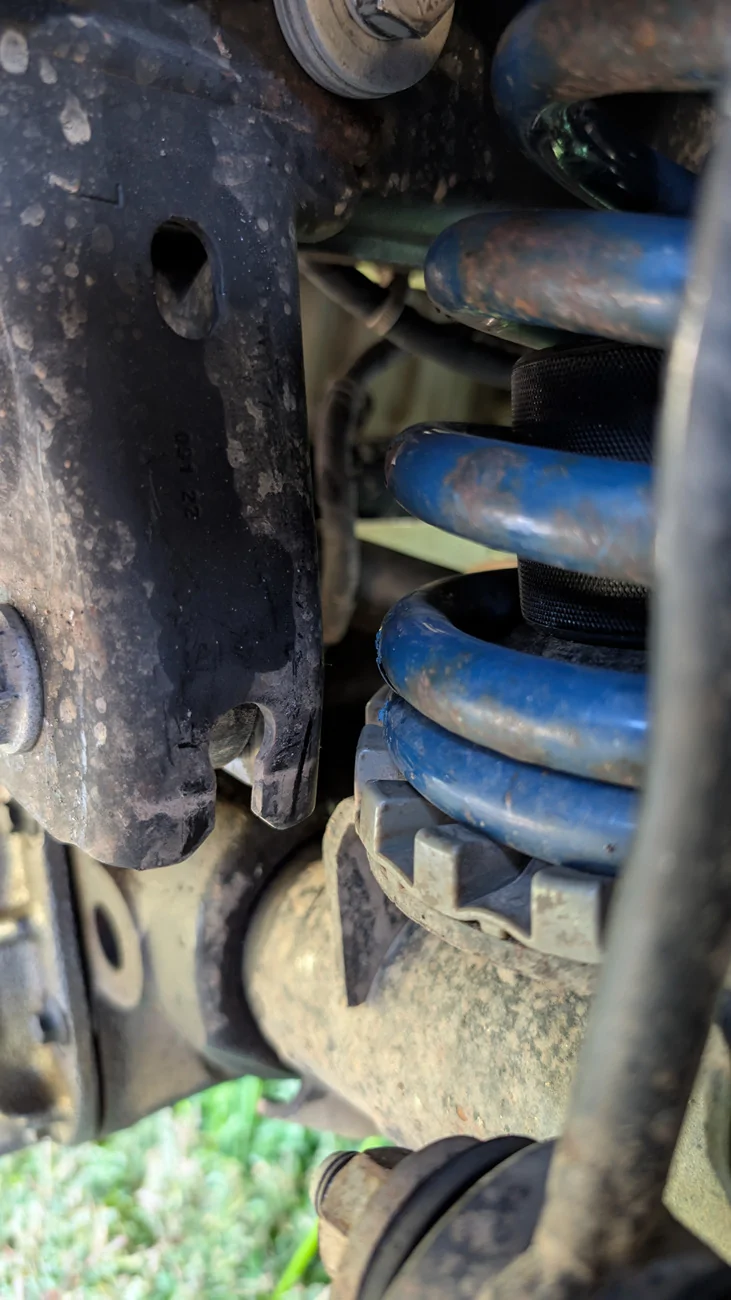

Rear Antirock works, just a bit stiffer than I'd like. Tbf I didn't test the rig fully loaded but it does seem to be limiting my articulation in the rear. Maybe I should have gone with the standard antirock and not the HD. I think the HD Antirock in conjunction with the AEV HD coils are just a bit too much off road.
Had to lose the front track bar brace entirely, coil was still hitting it at stuff. I'm conflicted on it. I know it's because I pushed the axle forward but it's positioned about as well as it can be for lock to lock clearance when stuffed so I'll probably either just run without the brace and if I run into problems cut and replace the track bar bracket entirely, or maybe hack the back side off of a brace and bolt it in but weld the vertical cut. That's the way I'm leaning. It won't be as stiff, but it'll help.
Just drove a couple hundred miles though and this Jeep drives absolutely fantastically for having 40s. Shit, it drives fantastically compared to a stock Jeep. It's going to be a very easy drive 1400 miles to Moab on Thursday.

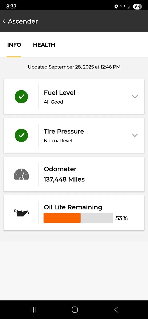

Still, if I recall, you aren't sitting at 50,000 miles, so............
137k+ but I was just impressed at the silicone . That stuff must last forever.
