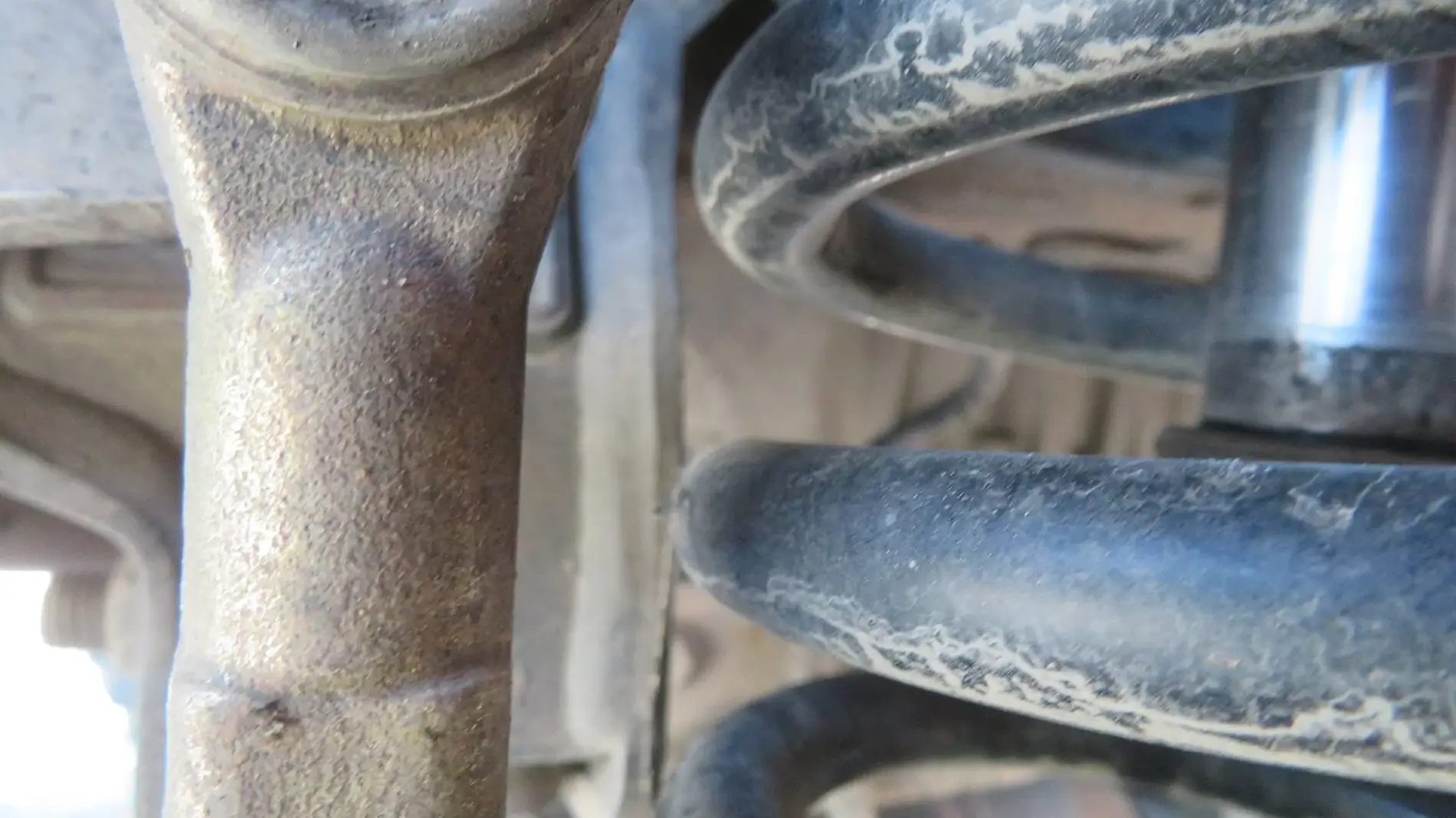

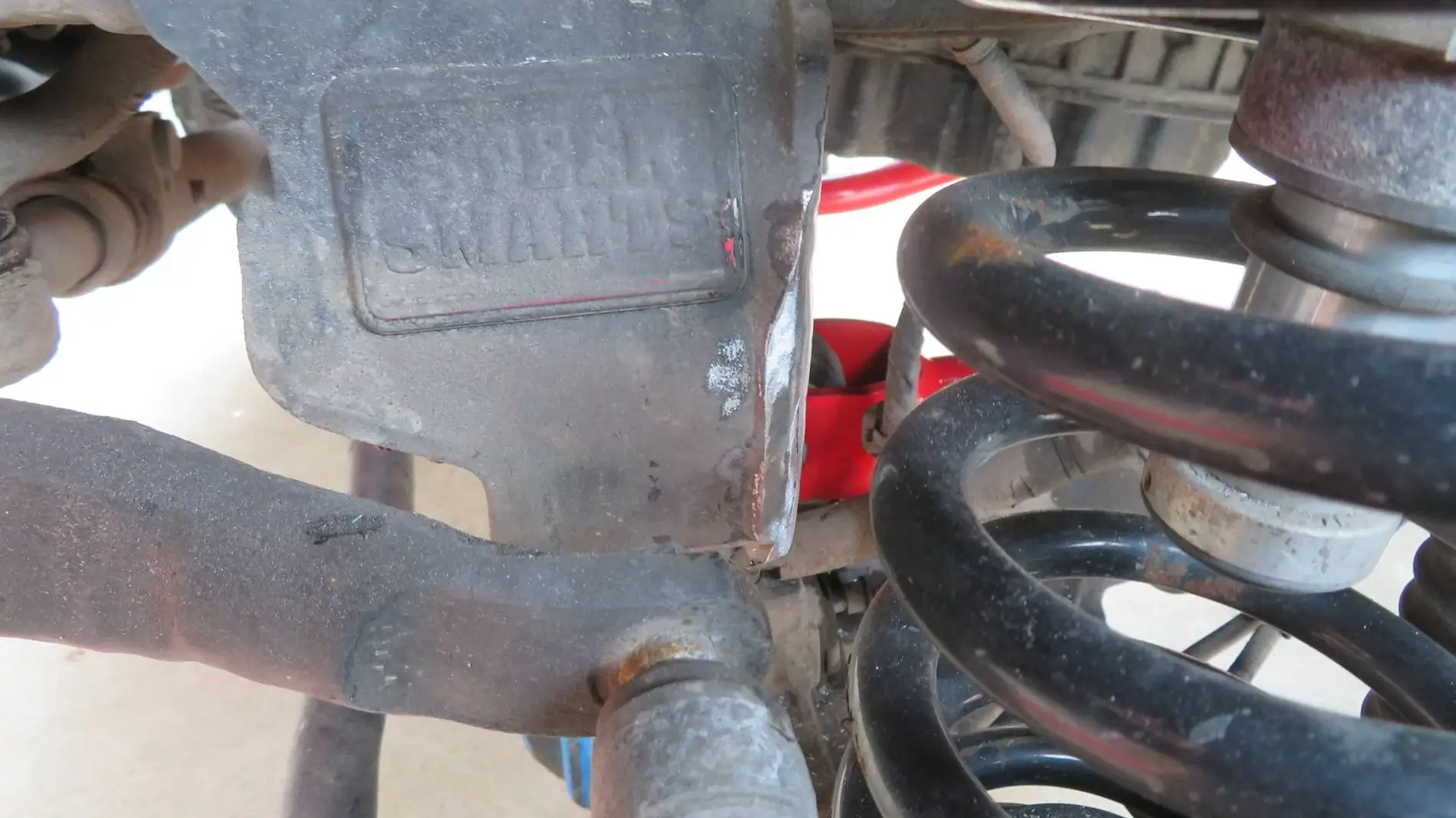

I had the same issue with the spring hitting the steering bracket. I have a Steersmart bracket. I used a grinder on the part of the bracket that was hitting the spring. I also shorten my arms by one full turn top and bottom.
Yeah so you replied to me when I initially trimmed it and I was confused by how you cut so much metal off but I think you have the track bar only brace and not the one with the sector shaft as well? I just ordered the brace without the sector shaft brace section because it's definitely lower profile but I really don't want to pull the axle back either. I'll think about it. I'm not opposed to moving perches either.
