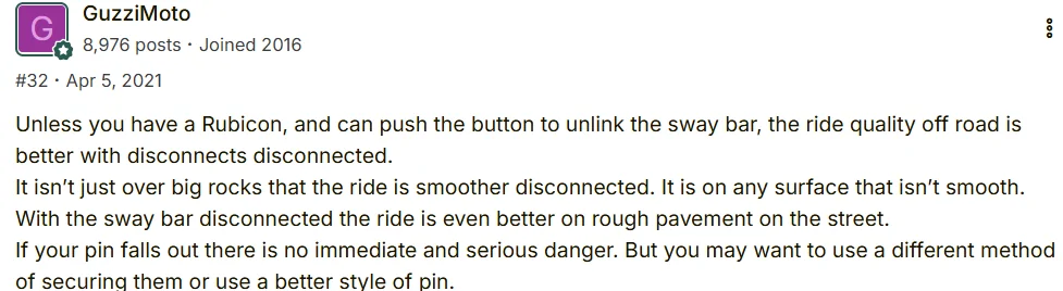

Any disconnect option is game changing on the trail. But bring your rubber hammer with you to get them back connected unless you’re on a leveled slab. And some astroglide.
One fellow showed me a tip - how he does his if it's not real even, using a bar in the spring to raise or lower the end of the sway bar. He said that can be "a thing" but he either manages or drives to a flat area to reconnect and then uses a bar.
I won't need them a lot, so not wanting to spend many hundreds, nor do I need fancy. So I figured any way would help.

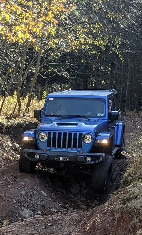

I can see your point, also I think it is much more about the articulation then smooth ride, in that picture my passenger side is stuffed into fender and driver side is way down but in contact with ground without sway bar disconnected driver tire would probably be six-eight inches in air allowing truck to tip that way perhaps .
This for sure.

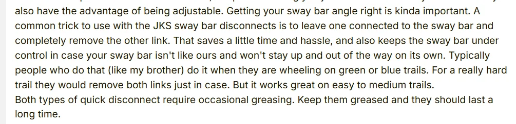

I did a lot of digging on the JL side of things last night - found a number of people using the Metalcloak or Teraflex disconnects.
Same story over and over "only takes a couple of minutes under the worst of conditions"
https://www.jlwranglerforums.com/forum/threads/sway-bar-disconnect-options.87857/
From another Wrangler forum thread - again, all positive on the cheaper disconnects, I see no one complaining (some even simply carry wrenches and disconnect the stock links - now that would be the real hassle, IMO)

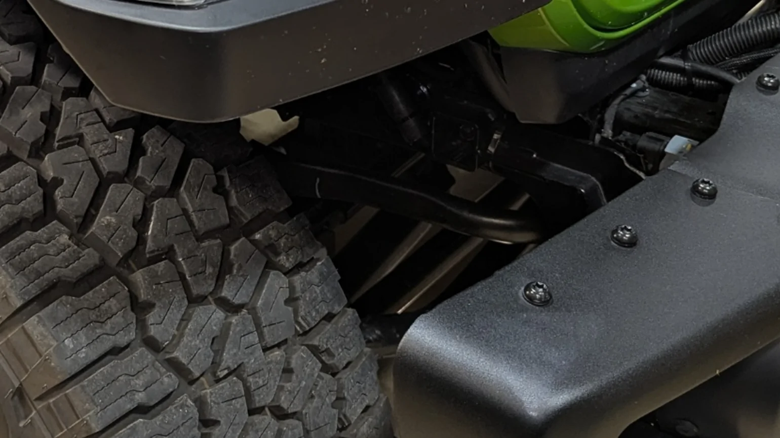

Since I don't want to cut anything - I hate that -

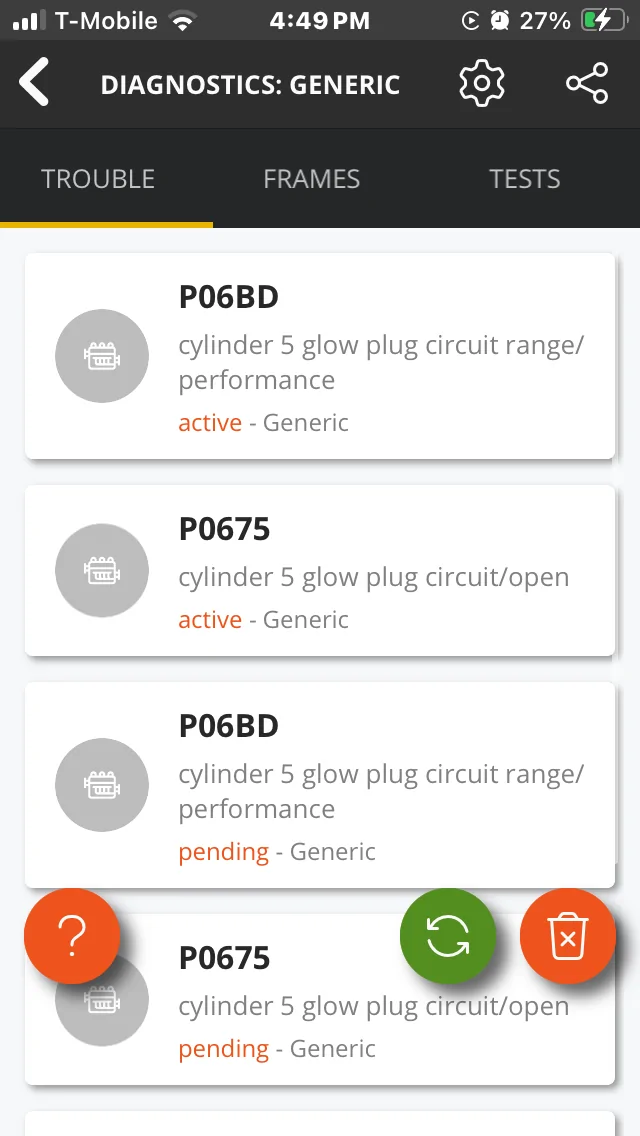

Today I stared glaringly into the dashboard of my Jeep junk as "that lil' light o' mine" showed up again to inform me that I have to replace the 3rd glow plug...CUUUUZZZZZ---> Jeep junk!
Thats because youre running one of those cheater engines lol
I was actually gonna go with he dropped a mirror walked under a ladder and let a black cat cross his path while under the light of the full moon at harvest time. But..yeah that too.

I have seen several guys buy that Rubicon disconnect and install it in sport models which you can find those in spades on lkqonline.com but the Mojave has those front reservoir shocks so I dont know if that interfers with that or if its out in front of that space that is utilized for the remote reservoir
