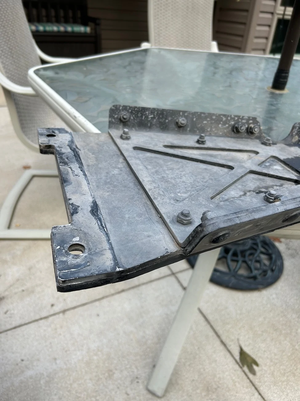

Inside (side you don't see when they're mounted under the truck) painted red. Can't decide if I'm going to do a second coat. Outside will be black Herculiner.
Not sure about liner spray , others do it, it works but if you are using your skids everything including galvanized gets scratched off, I use my belly skids hard as I am unlifted, have had to upgrade the oil pan skid and am using the UHMW board on bottom to slide better , which is nice. I paint everything underneath as I live in the NE Salt belt , and gloss black Primer/paint combo works good, when skids are really trashed a pad sander can smooth them out for a quick repaint. The liner would start getting rougher looking after two or three recoats. If you use the skids I would try not to draw attention to them as I don’t care what brand they are they will bend scratch and take a beating, hide it in the shadows with black color.

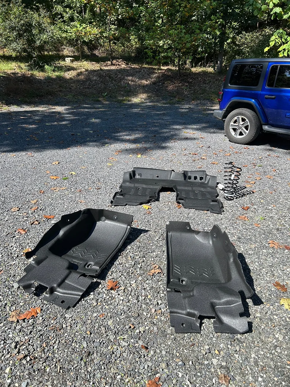

Doing not done!
Installing a Armorlite floor for Glady. Thought putting out in sun would help.
Thank you Armorlite for donating this to the recent Tread Lightly auction and helping them out and myself to! Perhaps if things go well I’ll get the Mojave X springs and half inch spacers done up front also…..Jack

Youre gonna love the new flooring.

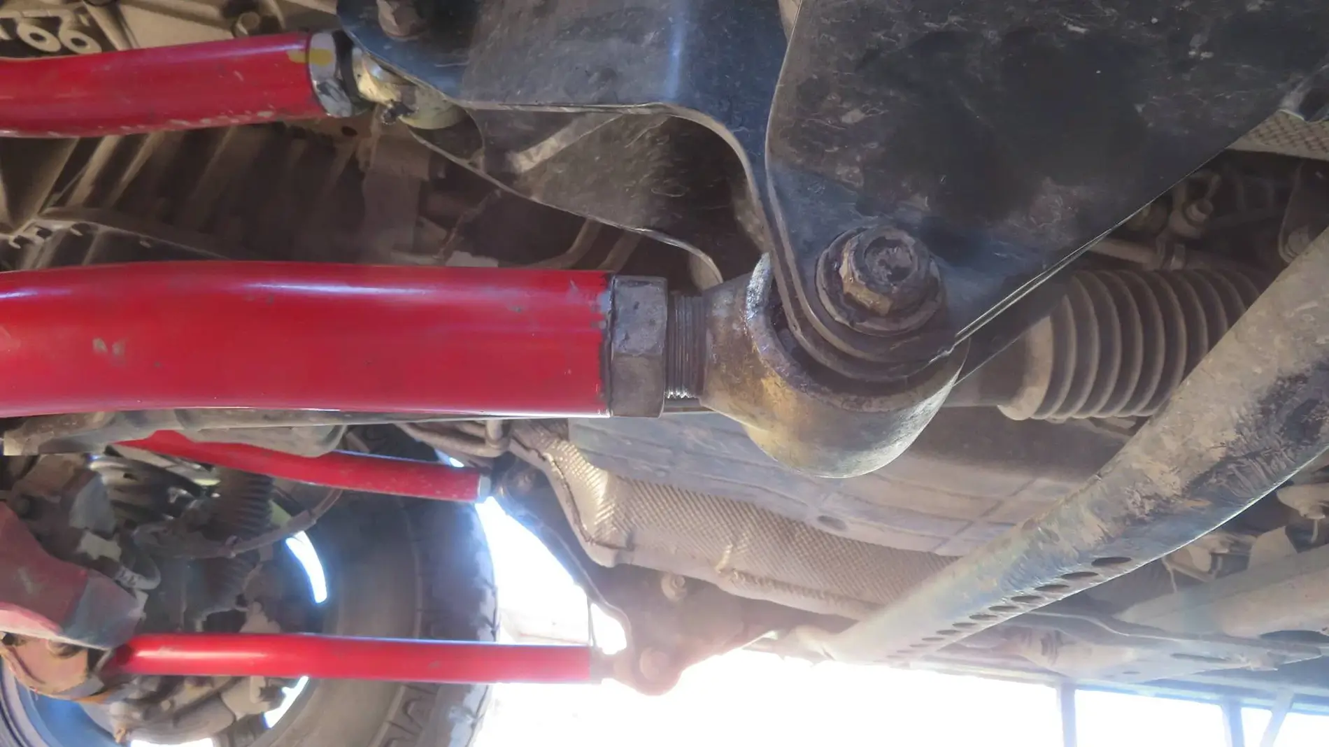

Got off work a little early today and installed the JKS Manufacturing front track bar this afternoon. Used 9/16" Grade 8 hardware. I will say there was a lot of preload on the Rusty's Off Road track bar reinforcement bracket as it was installed loose with the OEM track bar and everything tighten down. Had to loosen things up again to get the new JKS track bar installed.
What do you think of the JKS quality? Curious about their sway bar links.
