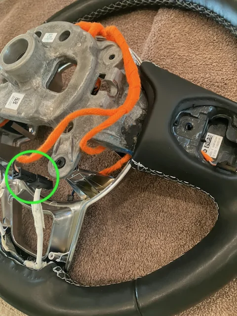

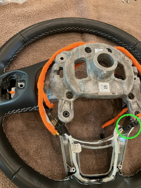

How hard was the paddle shifter install.
Not too bad.
Taking things apart had trouble with the little two wire connector for the horn. Mostly having to hold the airbag while using a pick tool to get that little connector to release.
This connector on the steering wheel was also difficult.
Jeep Gladiator What did you do TO your Gladiator today? [ADMIN WARNING: NO POLITICS, NO GUN TALK] IMG_2801
Jeep Gladiator What did you do TO your Gladiator today? [ADMIN WARNING: NO POLITICS, NO GUN TALK] IMG_2804
I just couldn't figure out how the release mechanism was supposed to work. Some sort of lever moved but it didn't seem to make any difference. Ended up getting a small safety pin and inserting the pointy end in to the one end of the housing to get the catch to release enough to be able to get the plug out.
Other than that, just take lots of pictures of the wiring before you start removing the old wiring harness from the steering wheel.
During assembly, I initially overtightened the screw holding the passenger paddle switch in place. Pressing that paddle didn't result in an audible click, so backed it off maybe a quarter turn and then it clicked when pressed just like the drivers' side.
Used Jscan to make the one setting change to set the paddle shifters as present.
I bought this kit: https://www.allmoparparts.com/sku/jljtpdlshifter.html

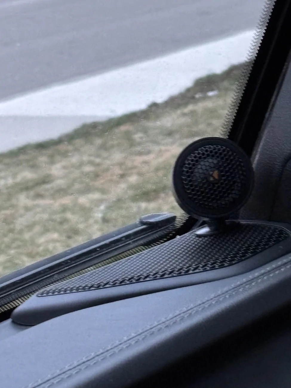

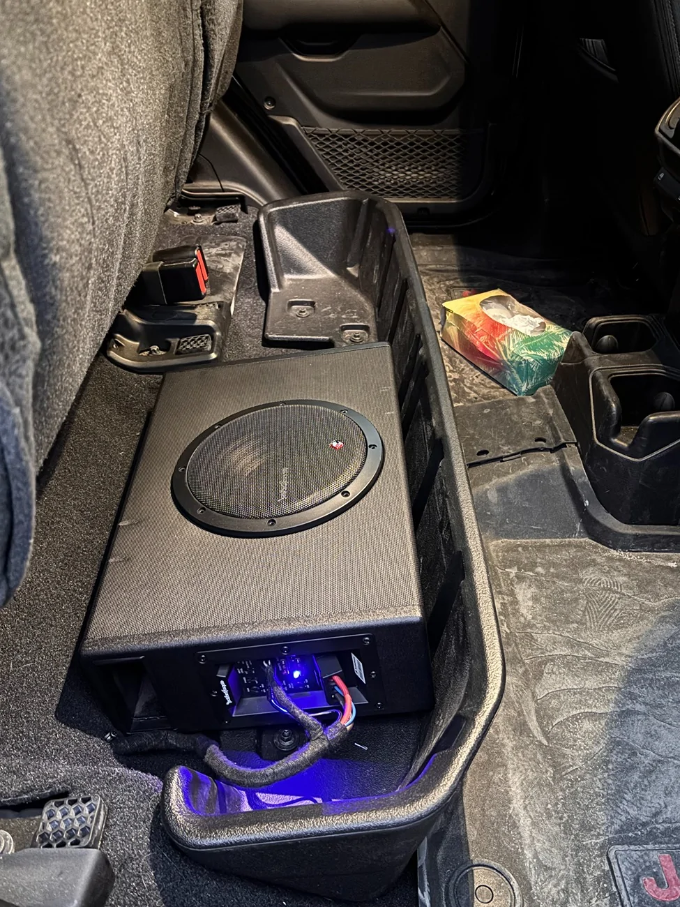

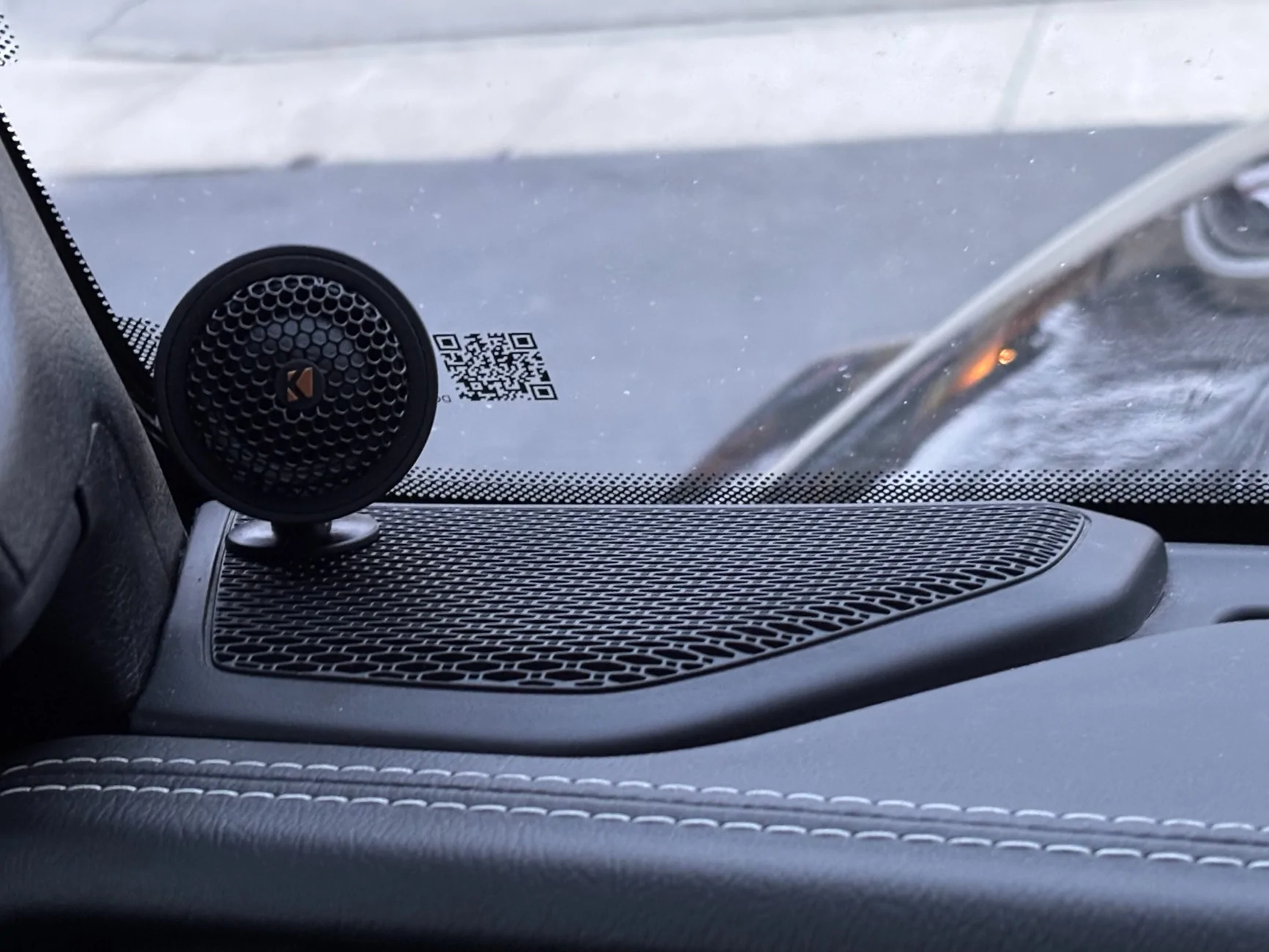

I upgraded the sound. Well, I paid for somebody to upgrade the sound.
KICKER 47KEY200.4 SMART 4CH AMLIFIER WITH AUTO DSP 50X4 RMS
KICKER KSS365 3-WAY COMPONENT SPEAKER SYSTEM (dash and knee)
KICKER KSS690 2-WAY 6X9 SPEAKERS (sound bar)
Rockford Fosgate P300-8 SELF POWERED 8" SUBWOOFER WITH BUILT IN AMP (below rear passenger)
METRA JP1010 6.5" FRONT JEEP SPEAKER ENCLOSURES
METRA JP1016 6X9 REAR JEEP SPEAKER CONVERSION KIT FOR SOUNDBAR
I also had the same guy install the Thinkware ARC 700 dashcam.
Kudos to AudioPros in Brantford ON, the install looks VERY clean; way more clean than if I tried to do it.
I had an hours drive in to work this morning where I could really listen and it is so much better. If you can do the install your self, then I can definitely recommend the components for an improvement over stock (I had the 7" non-Apine"). Paying to get it installed, for me, was also worth it.

Keep the paperwork for that Thinkware unit. I had one die on me in about 8 months of use. I think the sun ate it up. It was great when it worked though.
I’ve been loooking at those Kicker dash speakers. Wasn’t sure how “in your face” they’d be with the tweeters positioned like that. Thoughts?

Thanks for the heads up on the dash cam. Hopefully my "Northern Exposure" sun isn't quite as debilitating as your SoCal exposure :)
As for the tweeters being "in your face". Physically, I think it's one of those very jeeplike "you either love it or hate it" things. Personally, I like the look a lot - sort of gives a premium look, in my opinion. Sonically, I think having them point into the cab directly can only make them sound better. The Gladiator is not a quiet machine. I definitely heard a difference during the broadcast of the Hockey game on Sirius 91 last night; I was on the highway doing about 120 km/h (about 75 mph) for a bit and never had the volume over 10, and the play-by-play was very very audible. And this morning's drive I listened to FM for a bit and Sirius for a bit: different genres (classic rock, country, even a bit of current pop) and all of them I heard the lyrics with more clarity than I had previously. And the percussion was crisper, louder, cleaner. As an aside, the Pussycat Dolls "Don't Cha" doesn't have as much of a bass line as I remember....
I'm still in my honeymoon phase with this setup, obviously, but yeah, I like it a lot. Hope this helps.

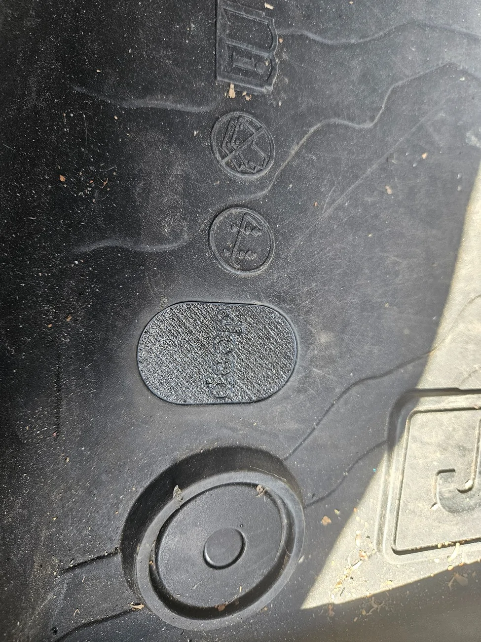

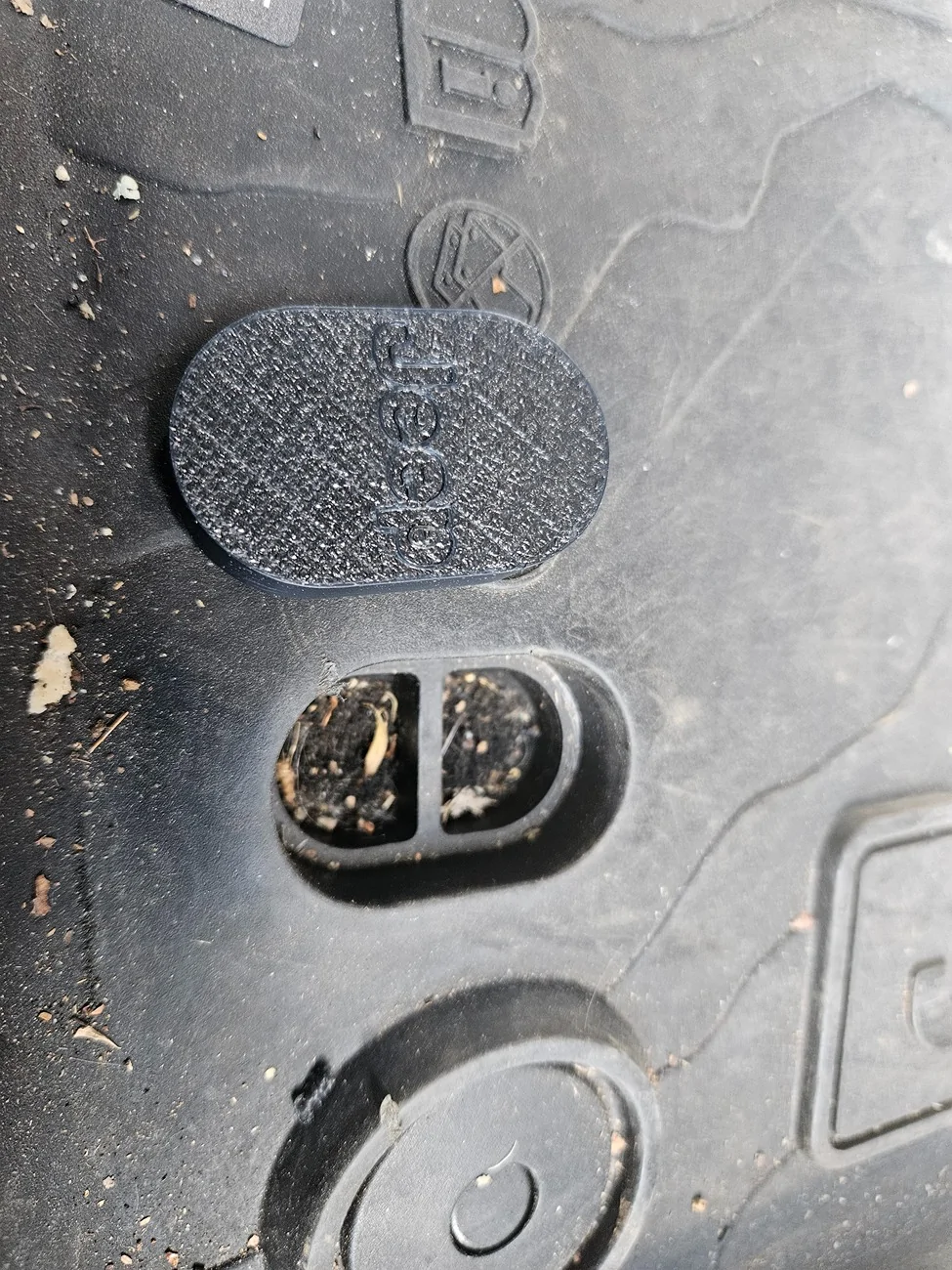

A couple of quick thing,
1. 3D printed plugs for floor drain holes in the factory floor mats.
Jeep Gladiator What did you do TO your Gladiator today? [ADMIN WARNING: NO POLITICS, NO GUN TALK] Jeep Floor plugs

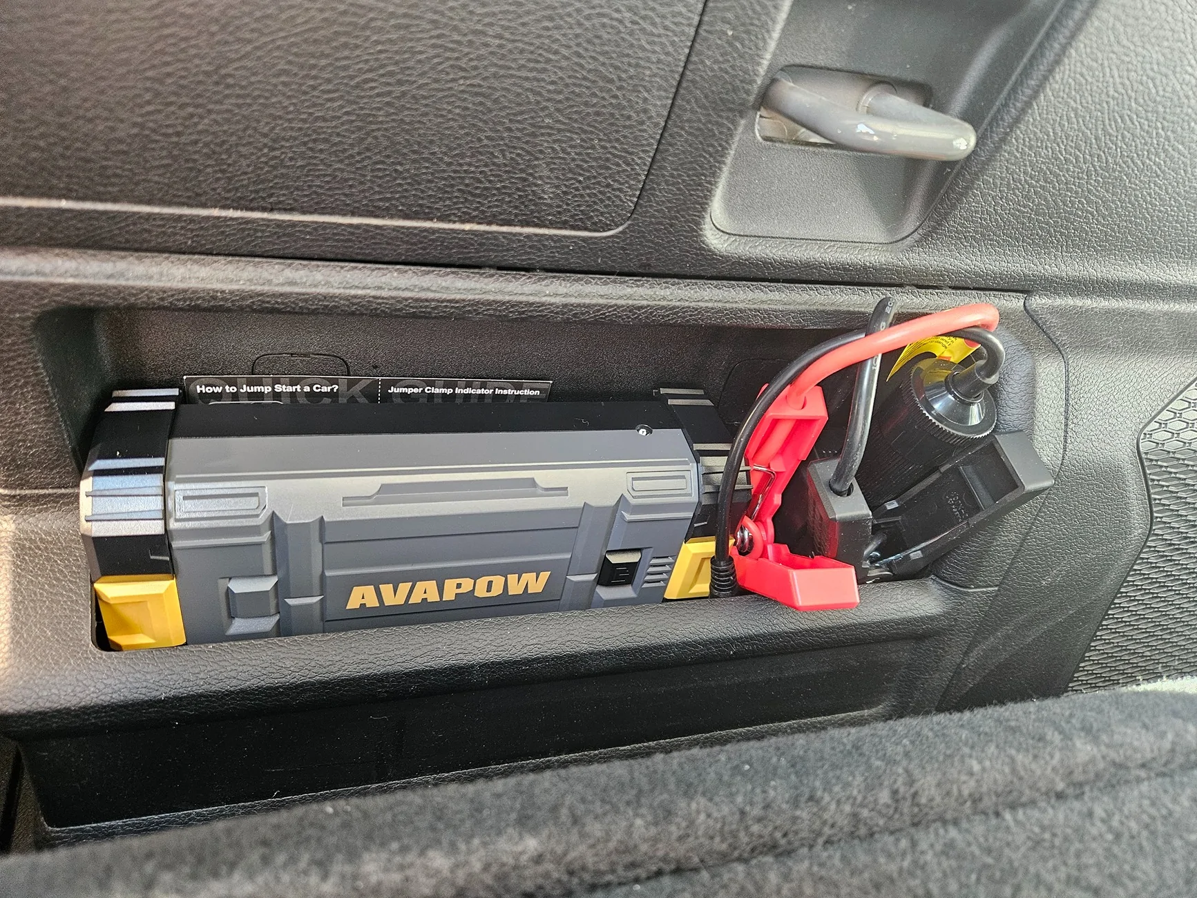

2. I Found the perfect spot behind the back passenger seat for my battery Charger/Jumper, Everything fit like a glove with no rattling around.
Jeep Gladiator What did you do TO your Gladiator today? [ADMIN WARNING: NO POLITICS, NO GUN TALK] Battrey jumper storag

1. Looks like a better fit than OEM
2. That's where I keep my NOCO Boost - great spot for something I rarely need, but I'll never be inclined to remove to make space for something else.

Isnt that where that super cool Bluetooth speaker is supposed to be? Just asking because I don’t have one either. :CWL:

That’s where my thin powered 20” sub is.
