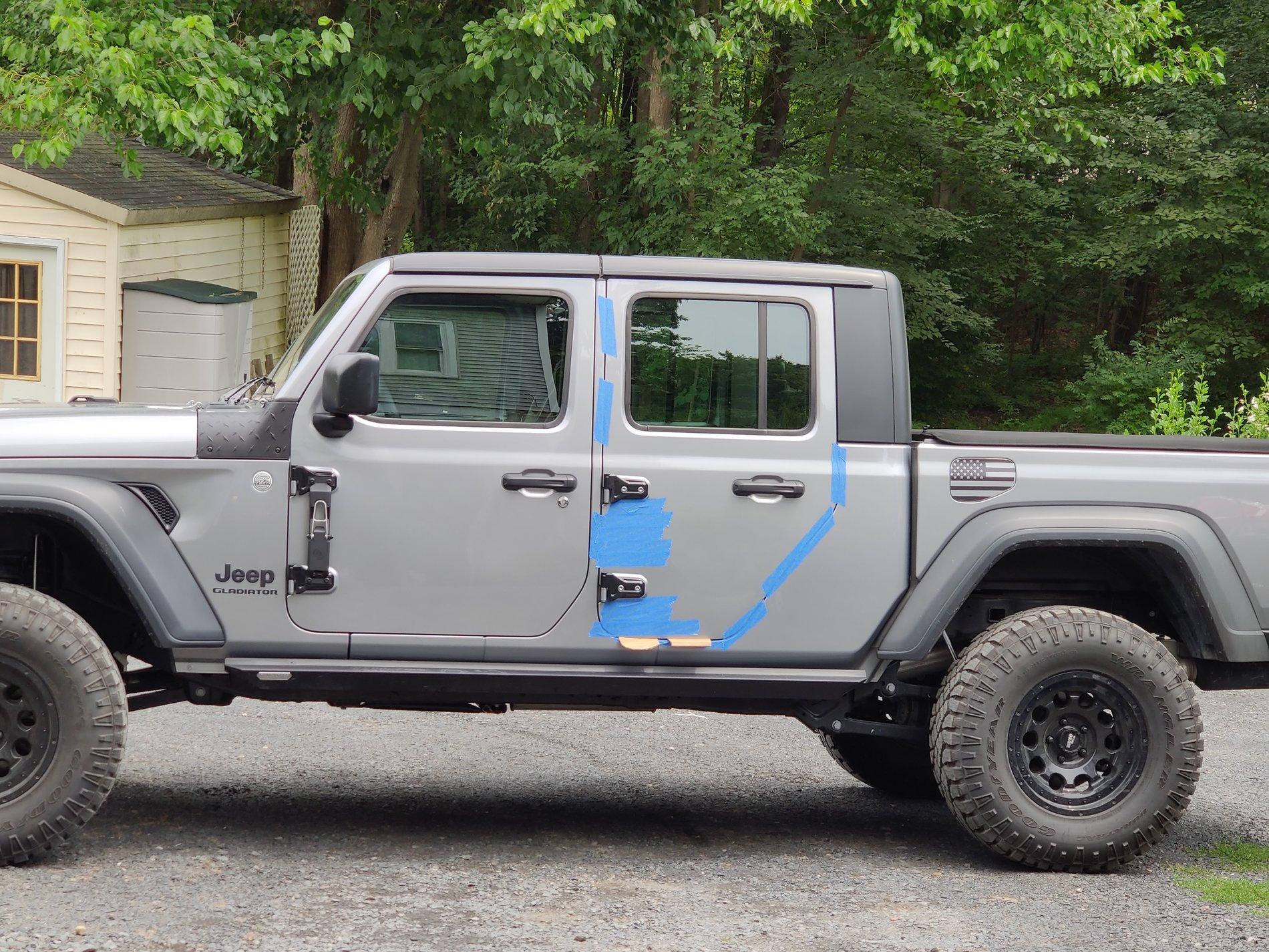

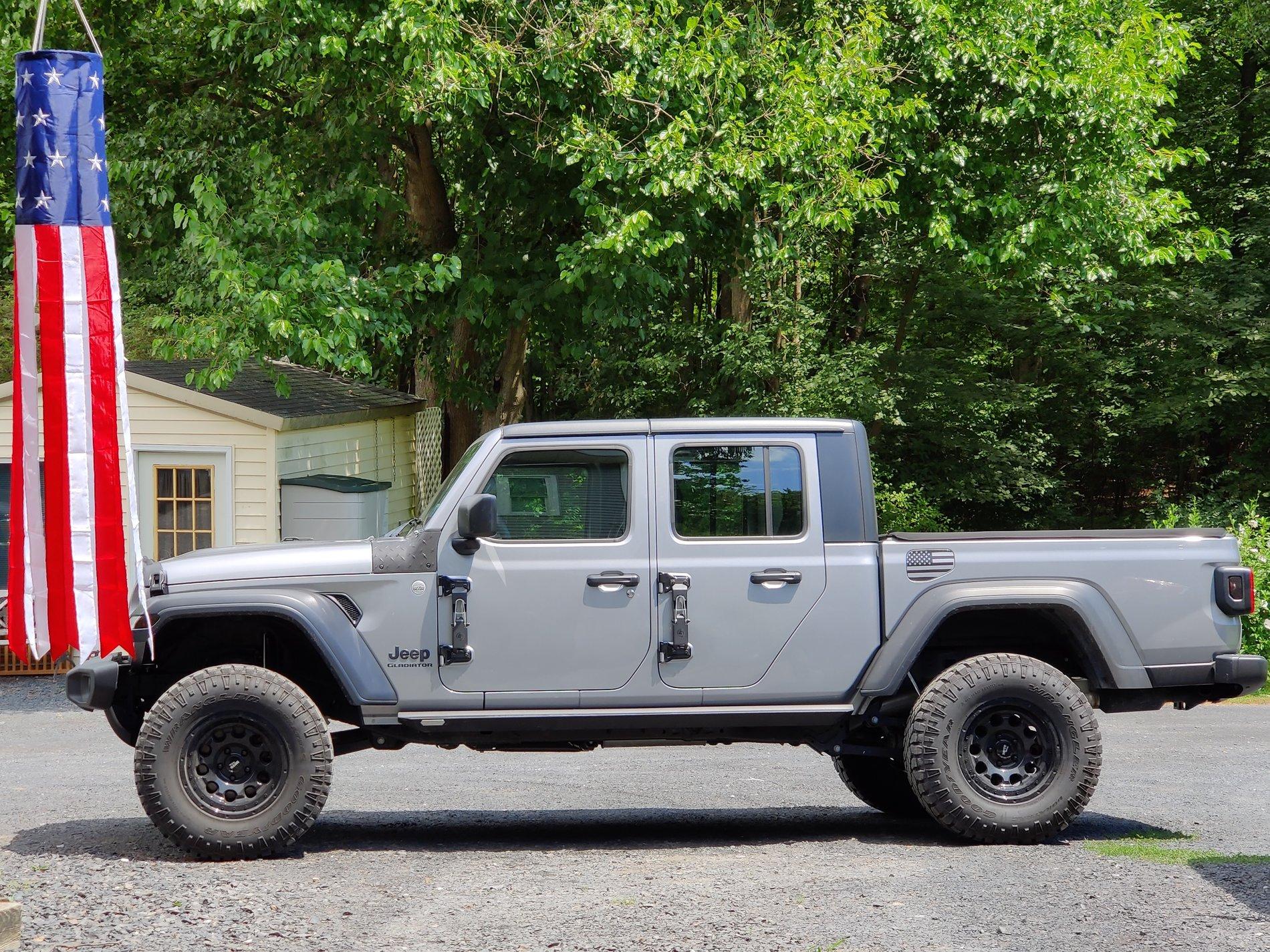

So I wrapped up 4th door today. If anyone's planning on getting these Smittybilt hinge steps your gonna need the TT50 craftsman from Lowes. I went through five different t50s and they are all different in size by brand. The TT50 craftsman with hole in middle was so tight at insert it banged in with a hammer like a glove then you have the grip you need to get the bolts loose with a breaker bar.
Thanks for this as it’s in my future
treat me like I’m stupid, I know why you taped around the bolts, but why around the seams of the rest of the door?

I stripped a bolt last week with one of those other t50s I had and the breaker bar got away from me and I scraped a 3 inch gash in my paint. I put extra tape near the bolts incase it happened again. I did the rest of seams to hold the door to keep it aligned when removing the bolts. I also used two pieces of folded cardboard for wedges on the bottom.

Looks good.
Is the black diamond plate cowl cover a stick-on, or is it a replacement cowl?

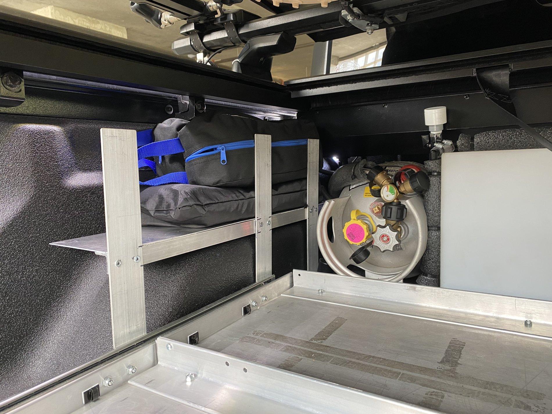

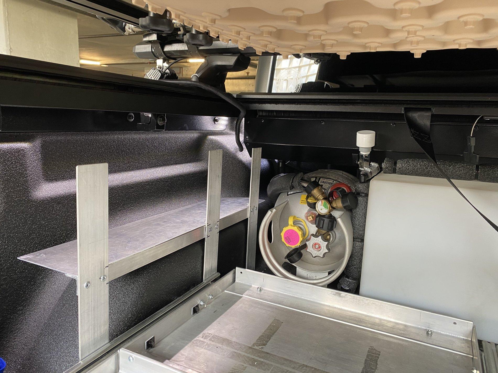

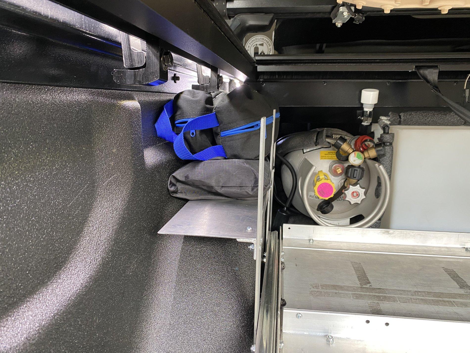

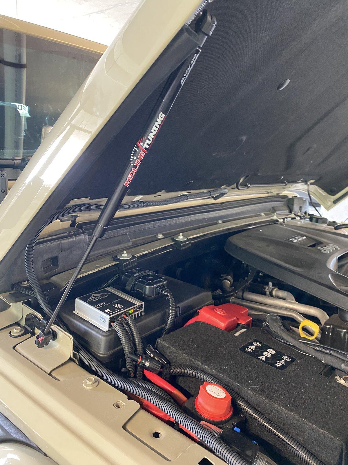

Also had time today to make a shelf over the driver wheel well to store a folding camp table and camping chairs.
Redline Tuning hood lifts installed too..

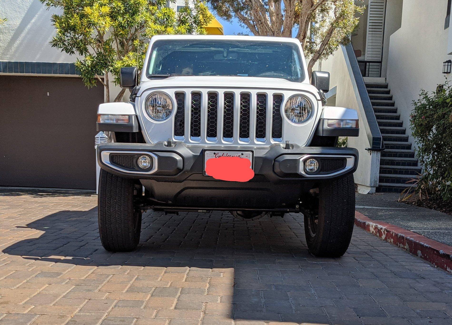

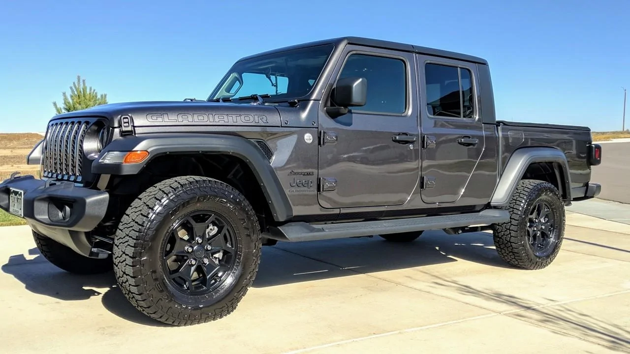

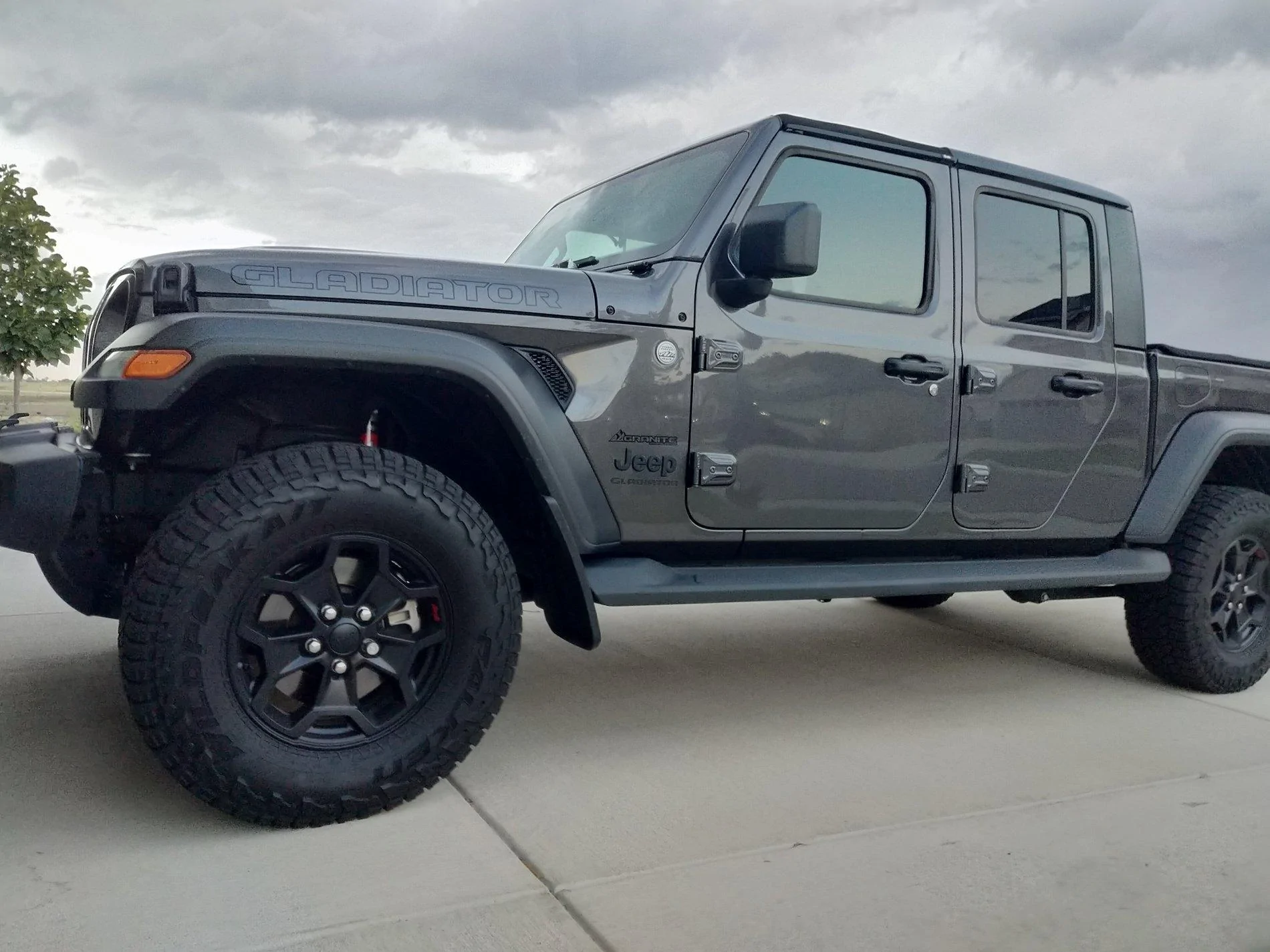

1.75" @Quadratec spacers. Rubi takeoffs and 35/12.5/17 go on tomorrow, getting the spacers settled before that.
If I were keeping stock I'd still do the spacers, way better stance.

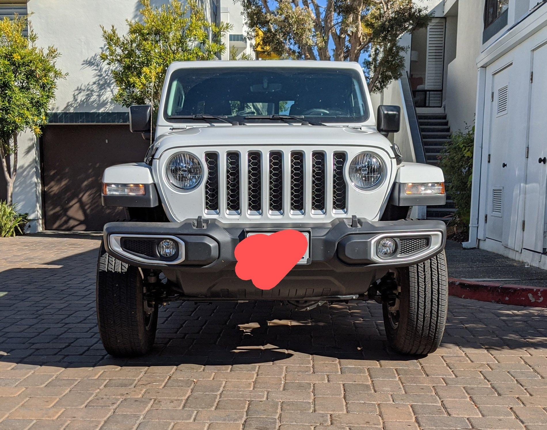

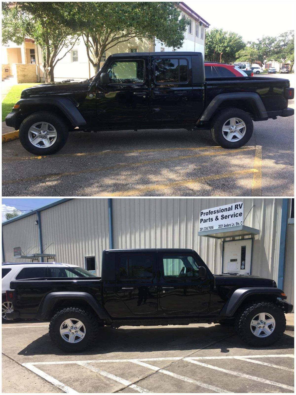

The ride height in the front is higher than I expected with the Rubicon suspension swap, but then I realized that the front coils are expecting a 83lb steel Rubicon bumper to be there. I'll get one of those soon enough. Here's before and after images.
Not all Rubicons have the steel bumper............ maybe the springs you got came from one with that, however. Mine has settled in to a bit less than an inch higher now than the Overland springs. I figure I'll lose that with a skid plate and if I ever do a winch up there, or even just a different bumper.
Different Rubicons have different spring numbers.........mine may have come from a lighter Rubicon.
