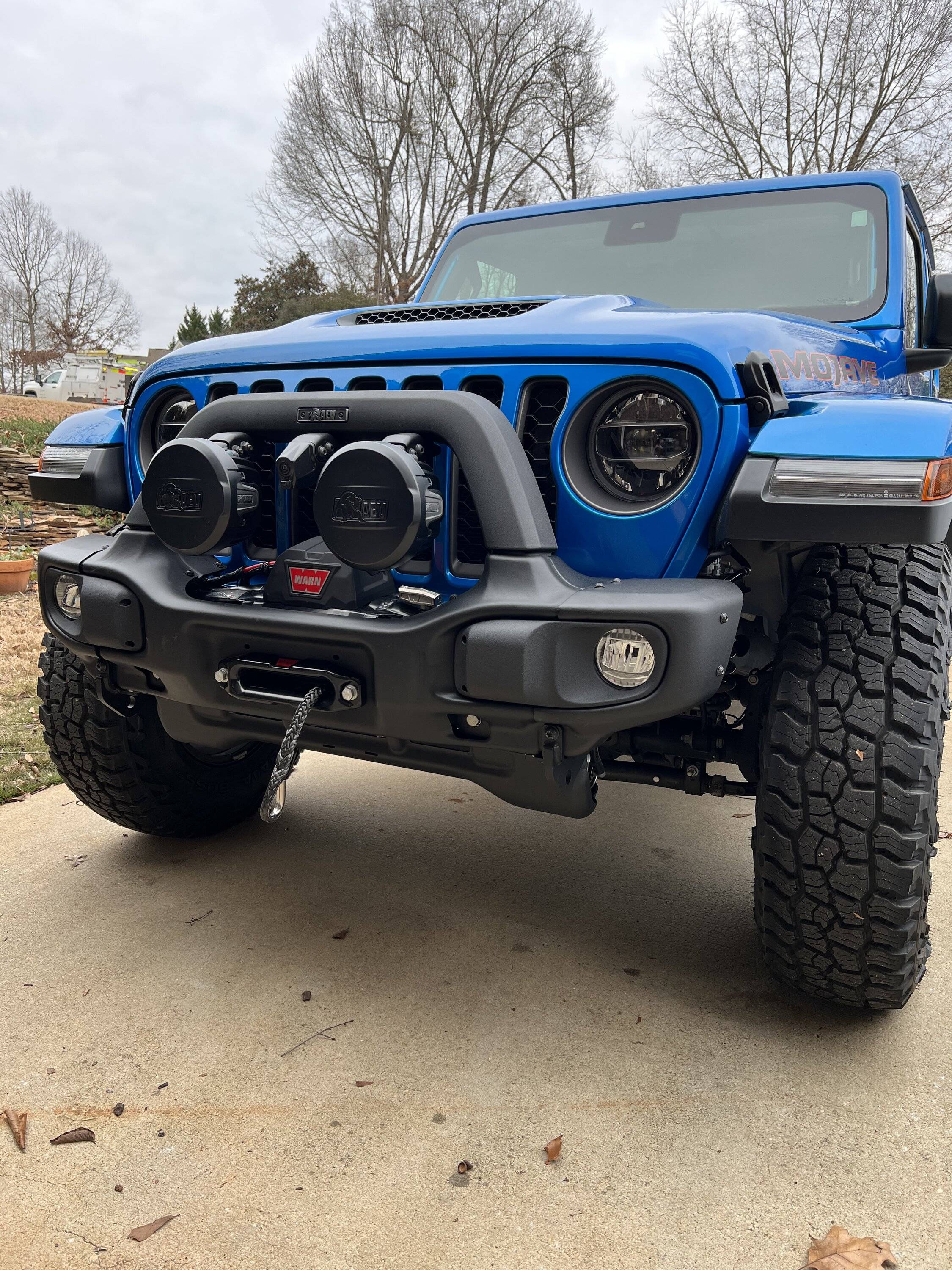

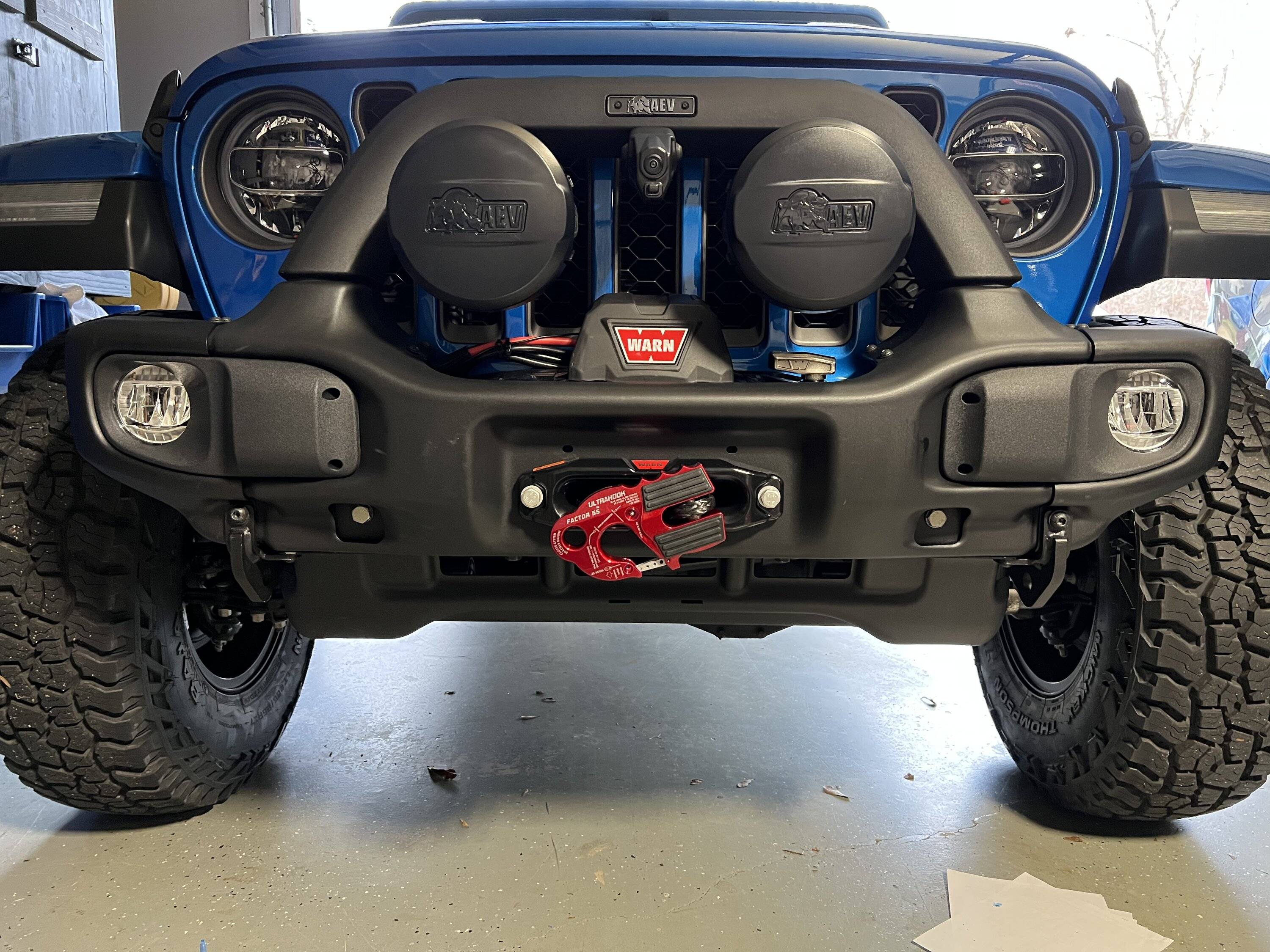

Installed a winch and wired in the contactor and fuse holdaer. 1/2 inch carriage bolts works great for the fairlead with the Warn plate.
What brand of grill guard is this? Remind me not to get it. They tack welded it all the way around.

Lmao. It does looks terrible. As a welder, i was telling my buddies that i feels ashamed installed as is. I'll re-tig weld it though. Got it off Ebay.

Welder myself. Was scratching my head when I seen the picture. They button welded it. Guess they didn't want to turn down the wire speed and volts.

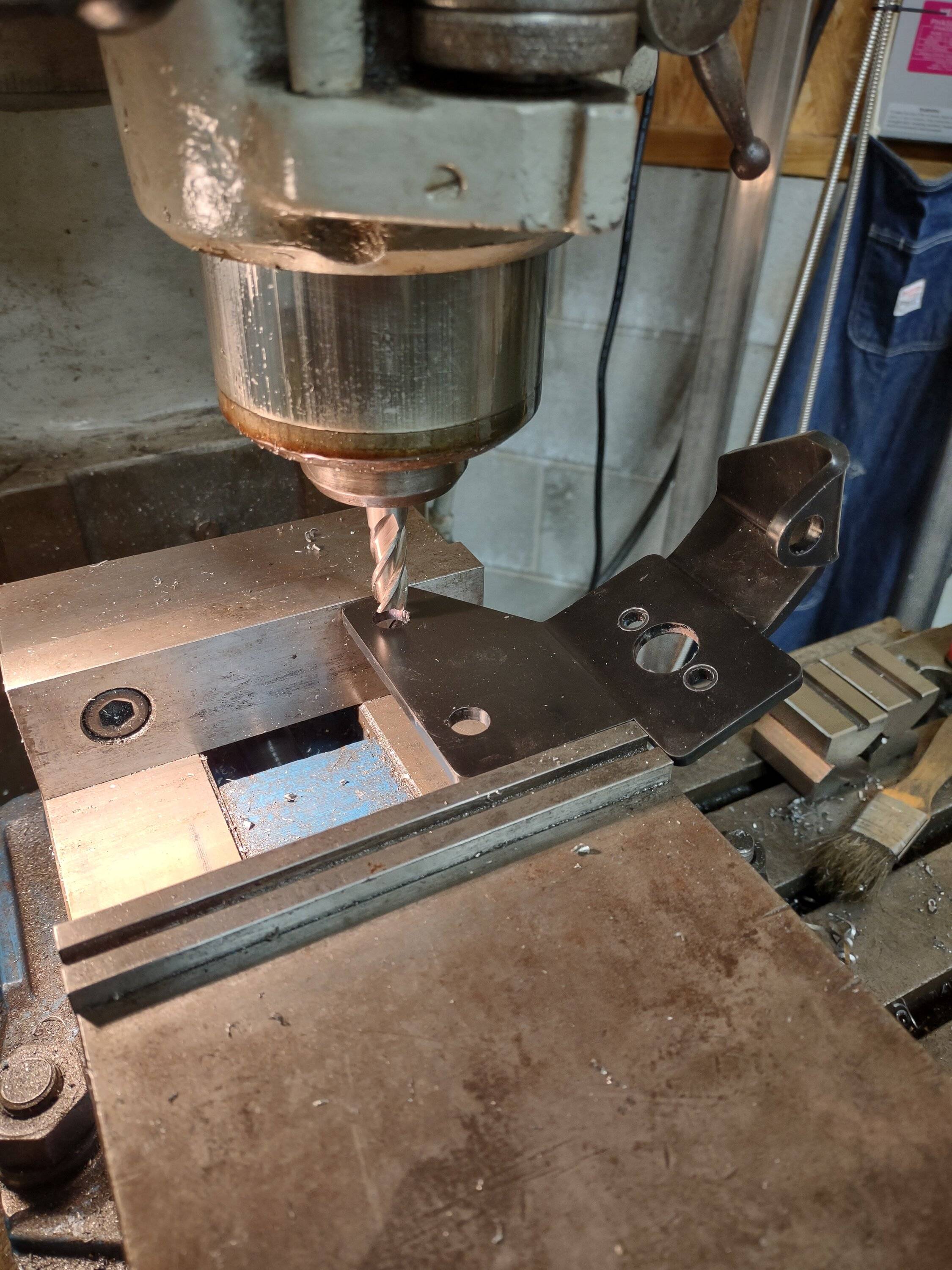

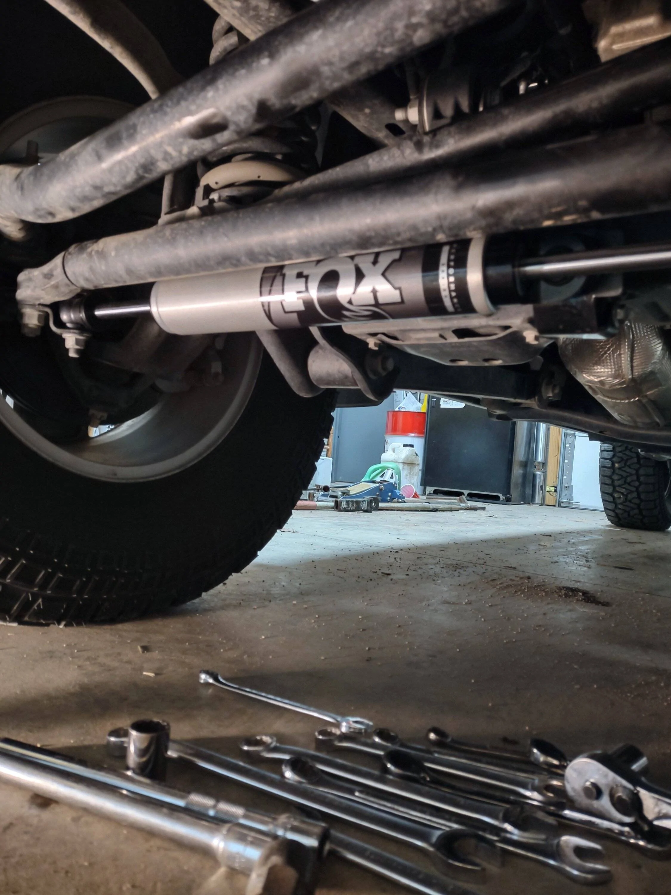

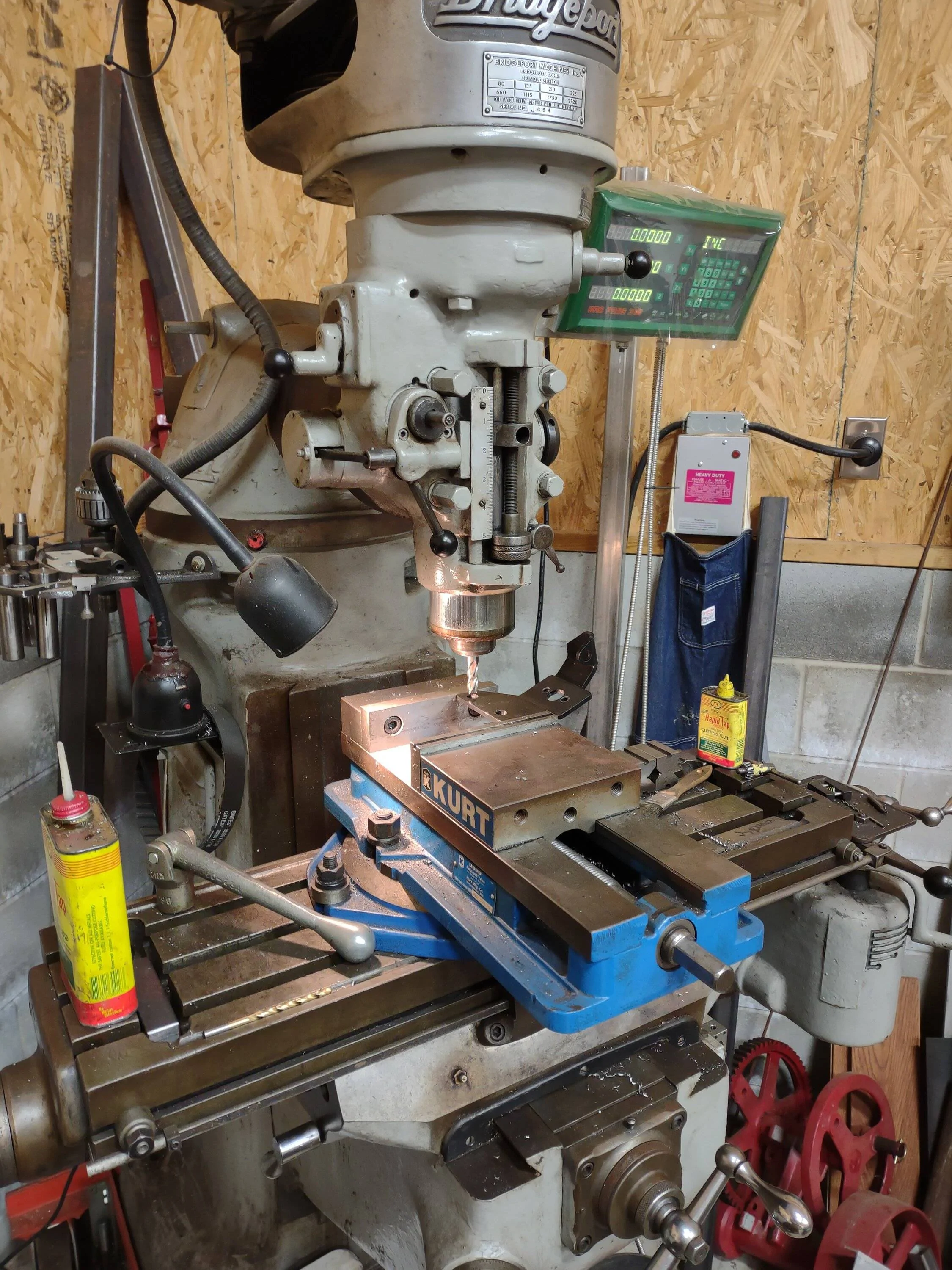

Installed a Fox through shaft stabilizer, had to work on the top two holes in the mounting bracket, which was a bummer. I had read some reviews where other folks were having trouble with hole alignment and my case was no different. Think the engineers at Fox need to loosen up on their tolerances and test fitting their parts to keep quality control in check would be a good idea too. Regardless, armed with an old Bridgeport, short work opening those holes and the rest of install was a snap.

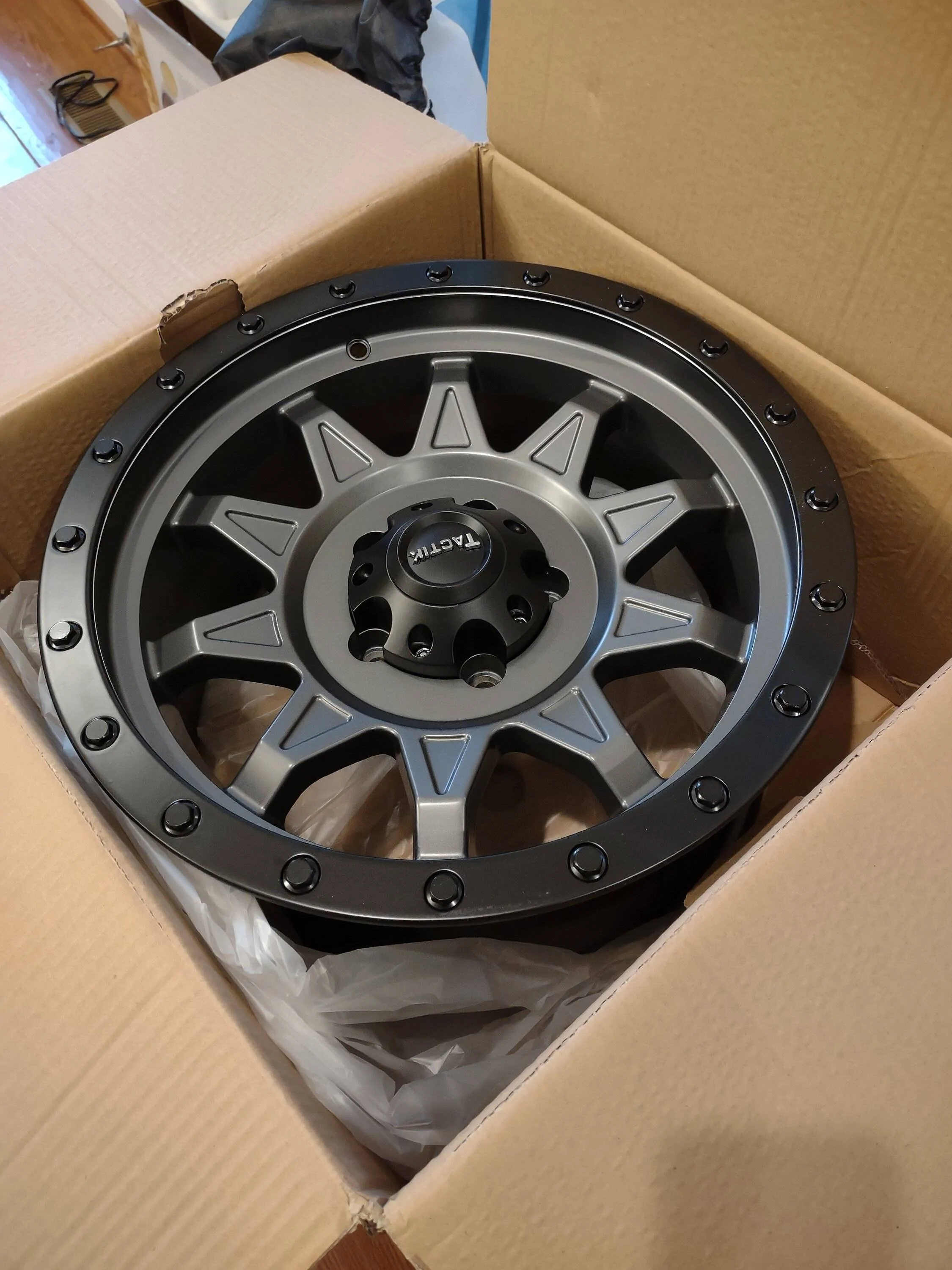

Got some some new rims too, but it will be some time next week for those.
8.5" +6?
What size tires are you going to run on them? I'm eager to see how they fit. They shouldn't poke at all with 12.5.

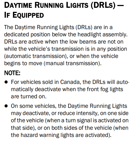

I noticed that the DRLs on my 2022 (LED) operated differently from what's described in the 2020 manual.
2022->
My original 2020 manual said "automatic transmission in any gear other than park" or something like that, then December 2020 version of the 2020 manual it reads like the 2022 manual.
I recall checking the lights when I got the plow all hooked up and it deviated from the original owner manual.

Tires will be Kenda Klever AT, 315-70-17, those Walmart specials from a while back. I've been running them on the stock rims but it's time to upgrade to something wider with 5" or better back spacing, in the hopes of keeping everything in the wheel well as possible. Out of all the possibilities I found, these Tactik rims from Quadratec satisfied both my eyes and wallet.
I'm itching to get them installed too, the wider rim should allow the tread to flatten out and I can bump my air pressure up for better fuel mileage and drivability.
