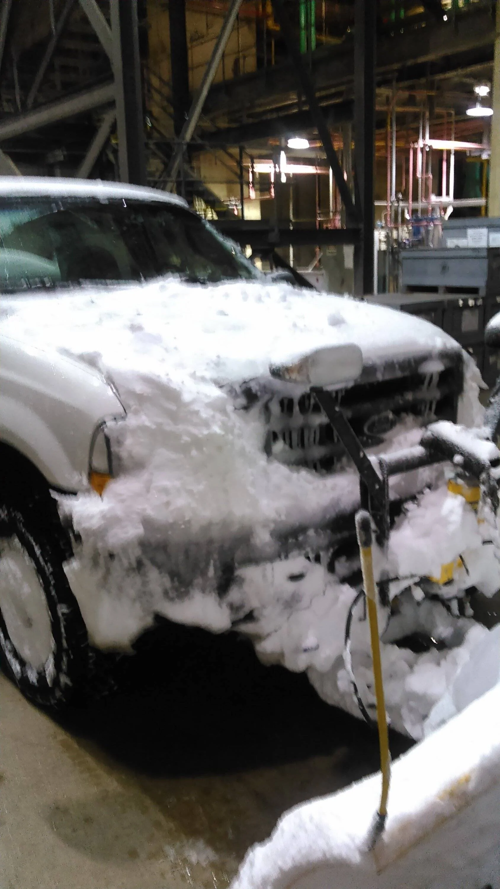

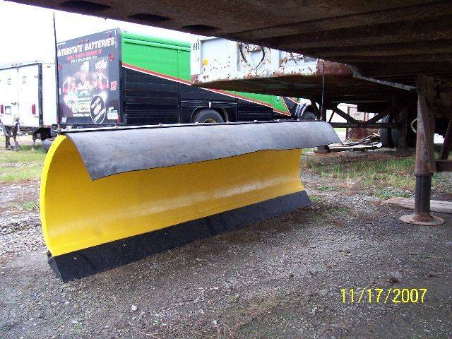

We add some ballast to all our plow trucks at work. Makes a big difference in handling, especially when the plow is up. You should think about putting a rubber flap/deflector on the top of your plow.
Really makes a difference with snow blow over.
On another note, you can get clear lenses for your outer marker lights on the front fenders.
Edit-looks like @Scrubb84 beat me to it.

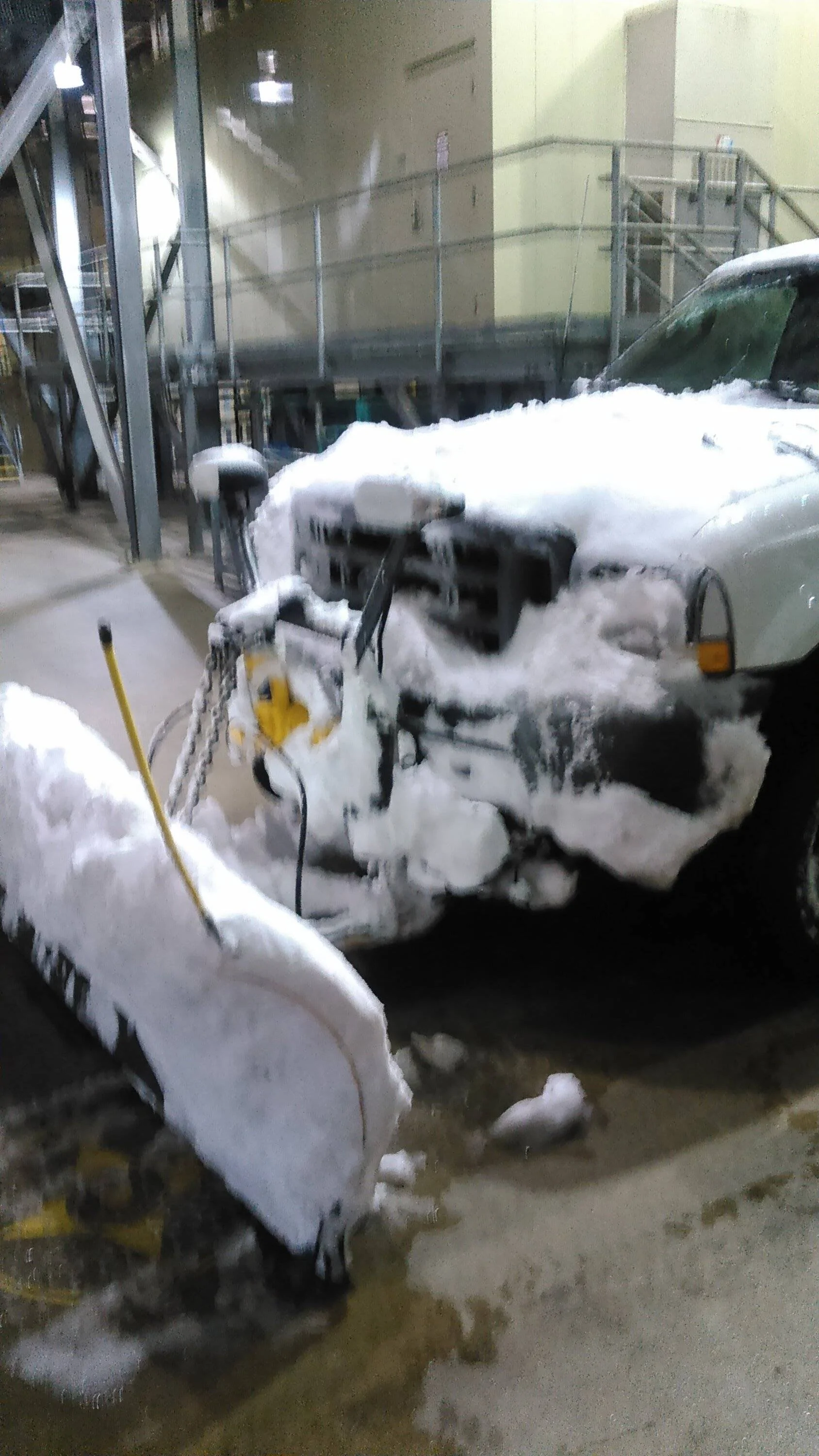

My work truck when I worked at the power plant.

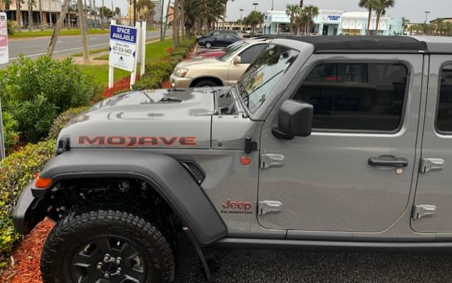

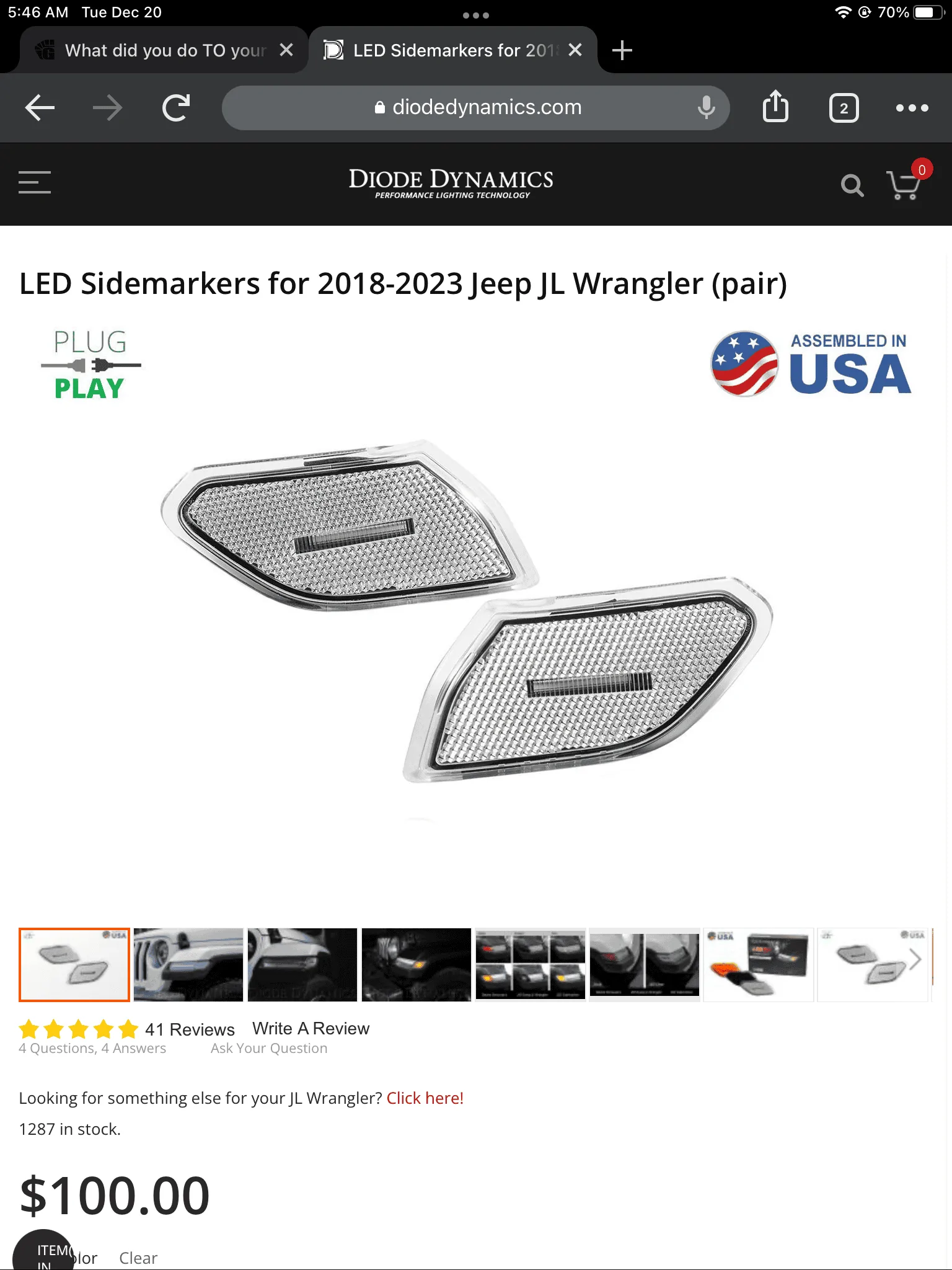

I got the Morimoto side markers as they were a bit cheaper than the diode dynamics. They make amber, clear, and smoked. I also have the matching morimoto turn sequential turn signals.
I had wondered about smoked - when I had my last WJ I was looking into replacing all of the front lights due to age and clouding, etc.
Wonder how smoked would look with the blue, though. Better than the amber I suspect.

Edit: I’ve had these on my JT for 2 years now. Love them. Only issue I had…I popped the lens apart on one when I was banging ice off the fender when it was -22* out one day. Had to get a replacement.
I have their fog lights in this truck - actually had them in my other and transferred them to this one - and they are solidly built, work nice.
LOL - you guys are convincing me now I have to go out when it gets above 0 and see how much work is involved in replacing them.

We buy it by the roll, 8x1/4 inch should work, then cap it with 2x1/8 flat bar. It will be a bit more work, but should safe a bunch over those $300+ kits. Just look at Rusty PW's pic and you'll see why I suggested it.
If all your plowing is your driveway and only doing like 10mph or less it might not be an issue. We plow hwy and secondary roads.

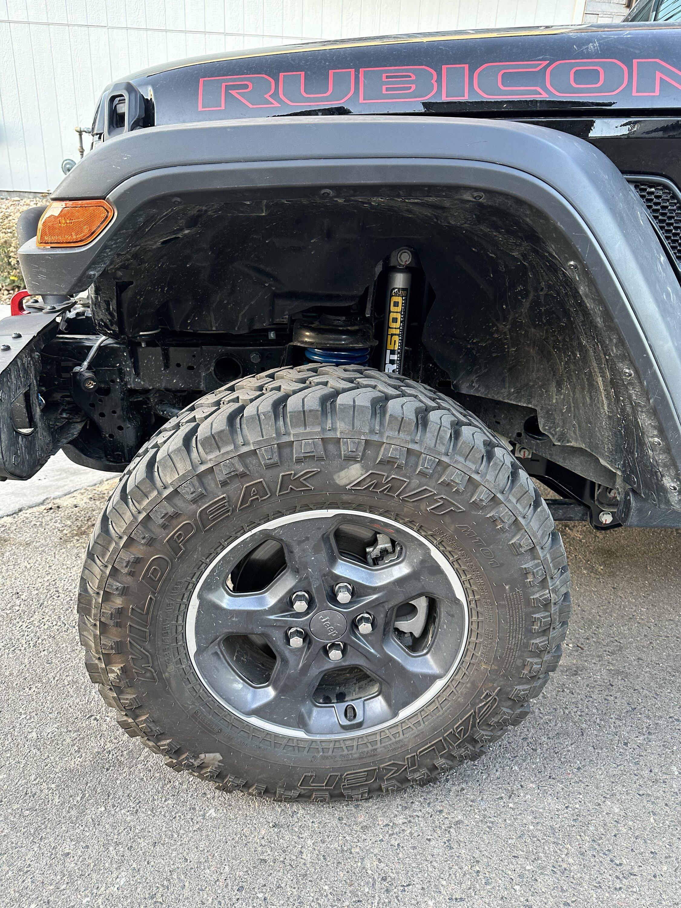

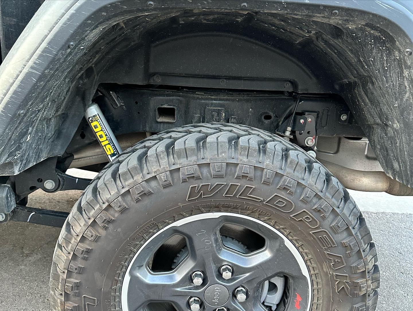

AEV 3" DualSport with High Capacity Springs installed Monday...
Now that you've had this kit on for a couple of months how do you like it?
I'm wondering if you used the control arm geometry correction brackets or ended up using adjustable control arms? I've got the kit ordered but the local shop is recommending I go with adjustable control arms, at least in the front to get the castor dialed in.

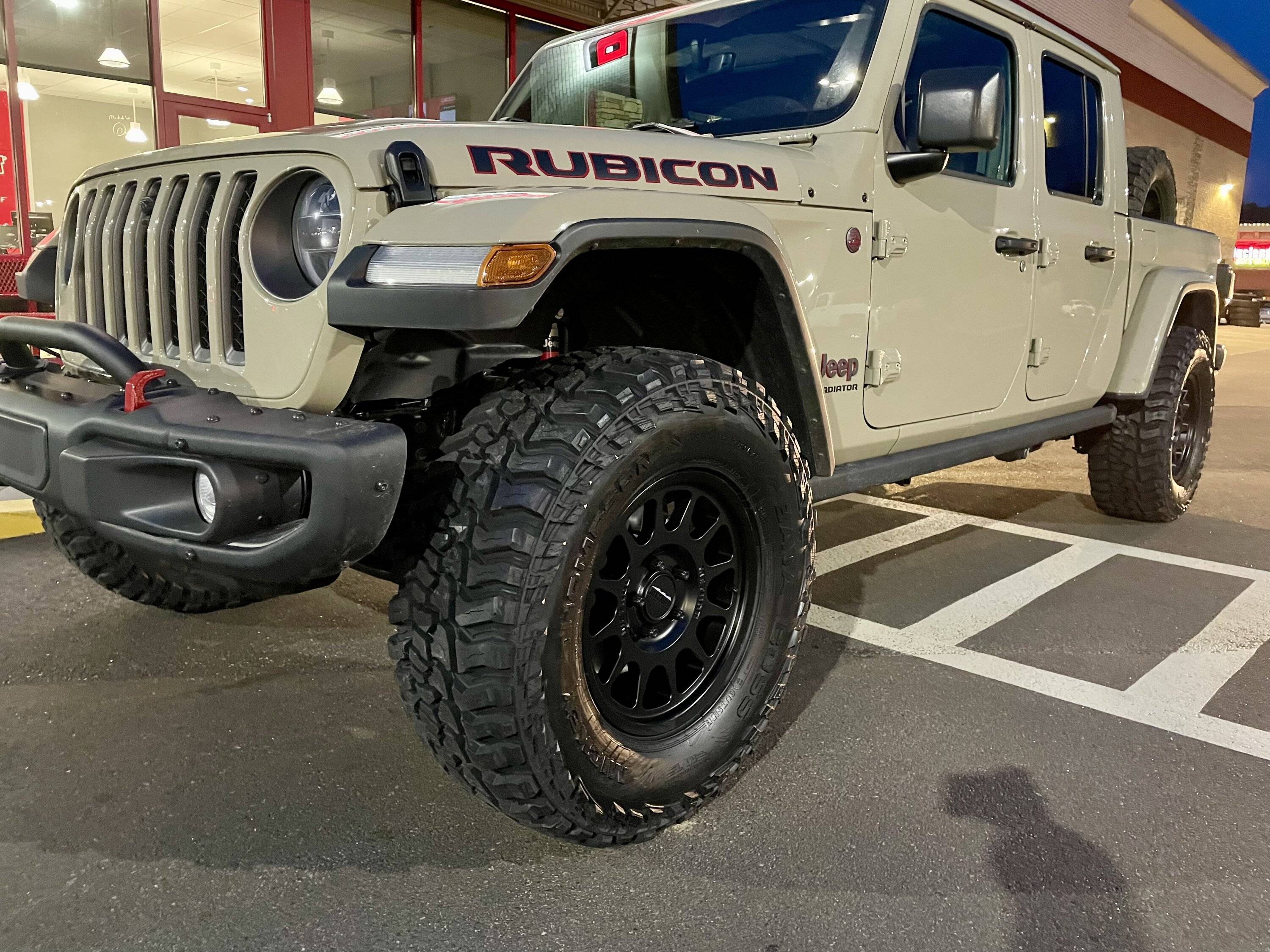

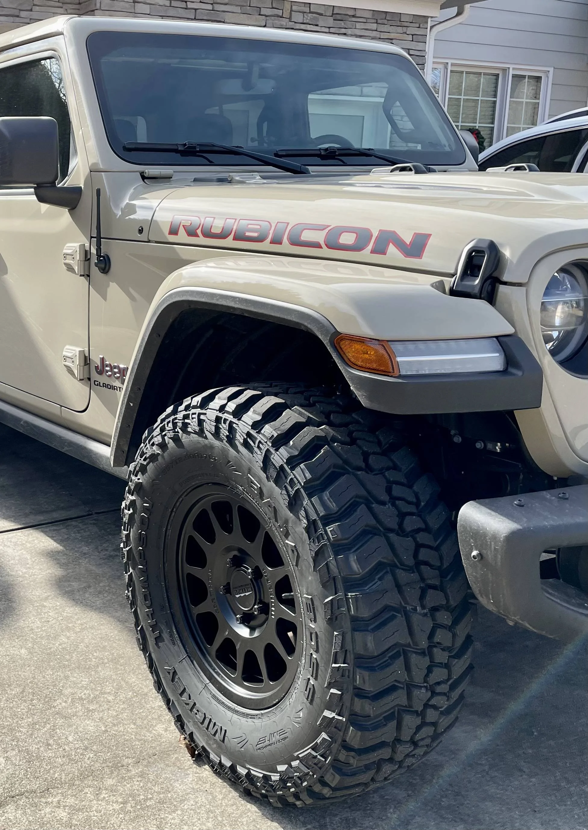

Added some Mickey Thompson Baja Boss MTs (35x12.50R17) on Method 703 +25 offset 17x8.5. Love the look with no lift. Also, added the Mopar grille gaurd and a Bak Revolver X4S. A winch is still on the list, and I’m done for a little while. That’s what I told my wife anyway ?

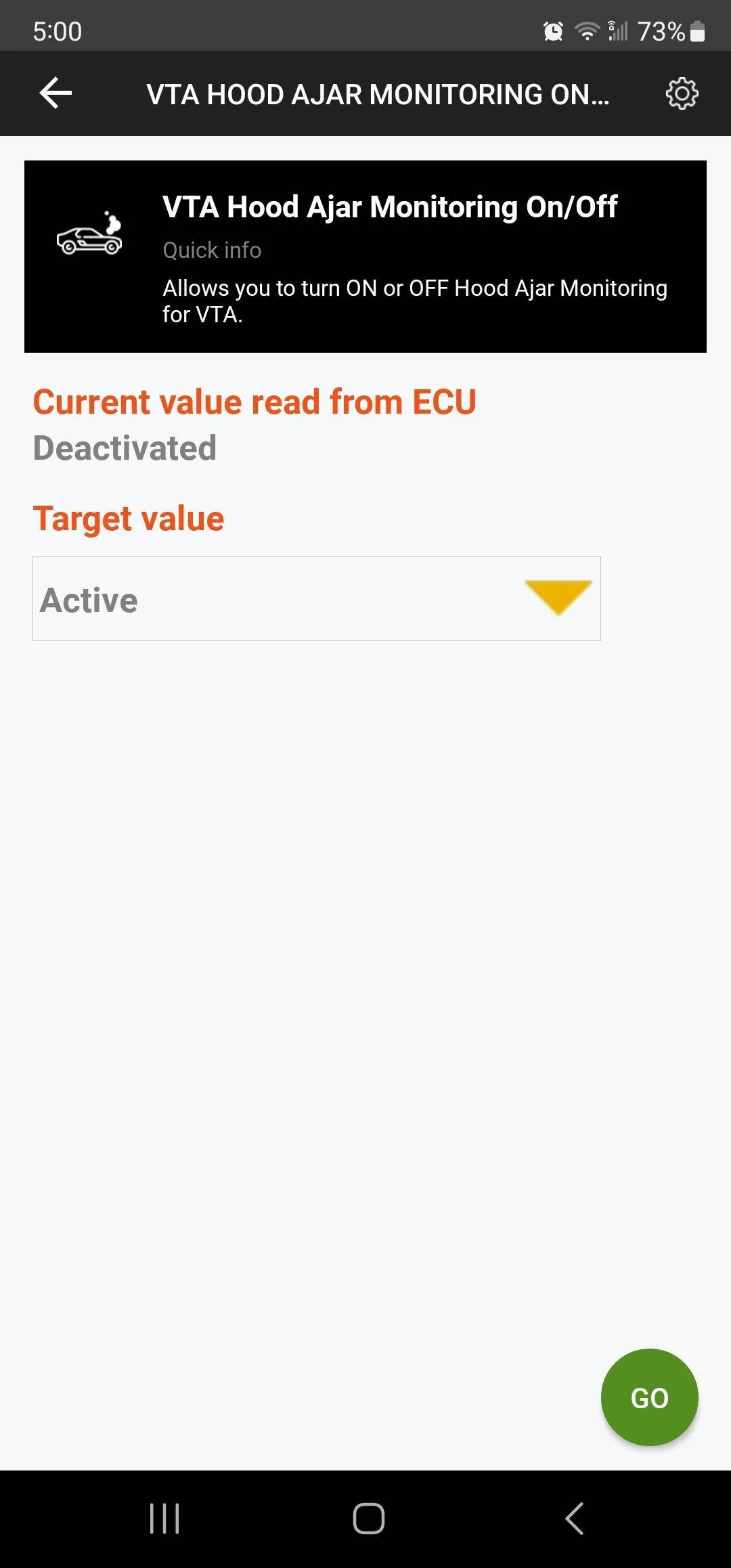

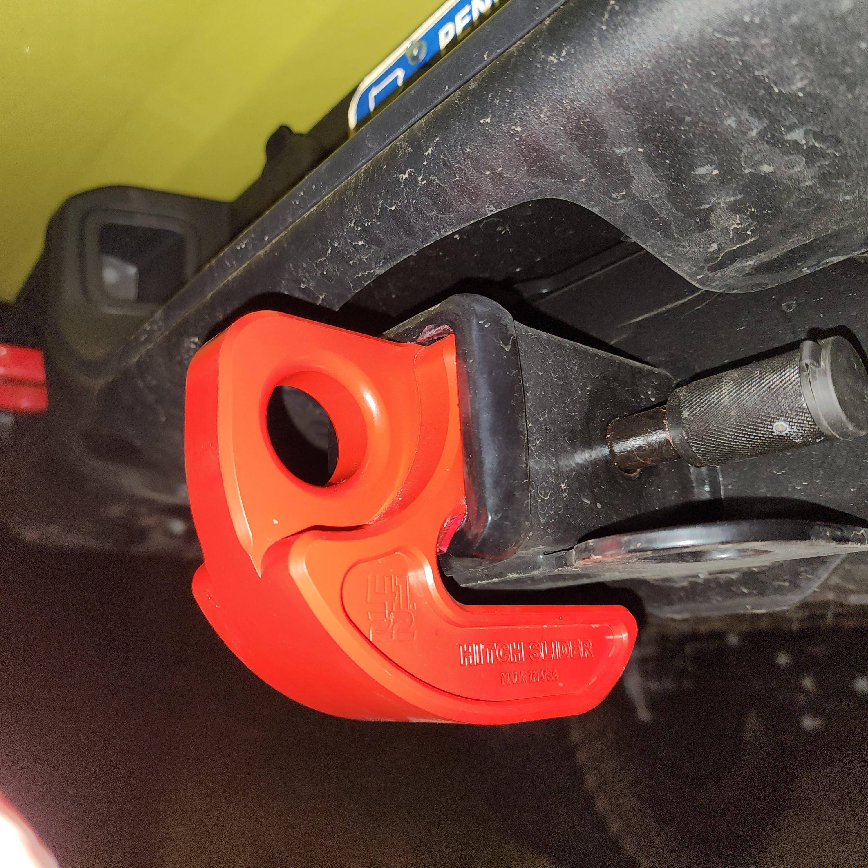

Upped security!!

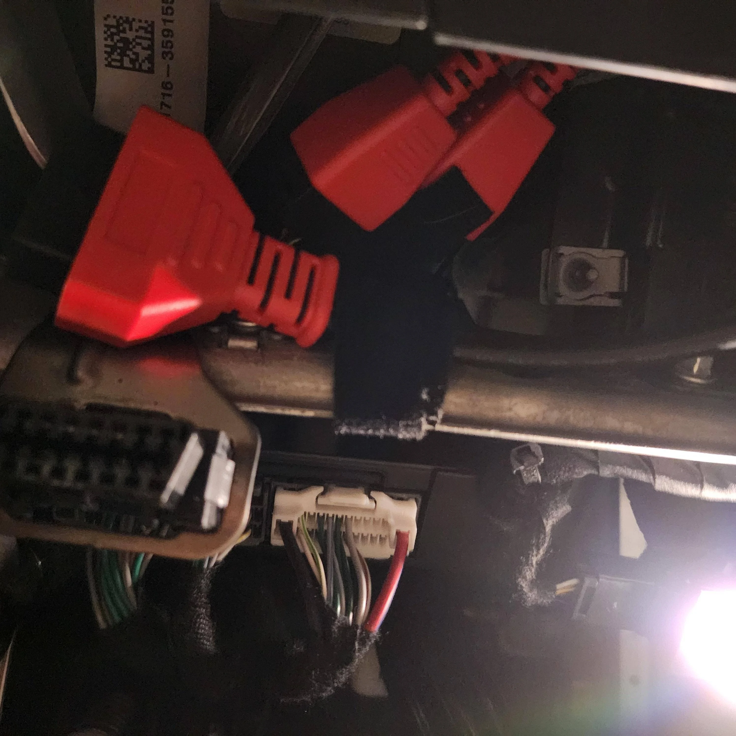

Installed the security bypass cables and J scan changed some stuff! Those cables are very easy to get to, after reading people complain about getting to them, I expected them buried in the dash. They are literally right there by the OBD port. Thankfully easy!!

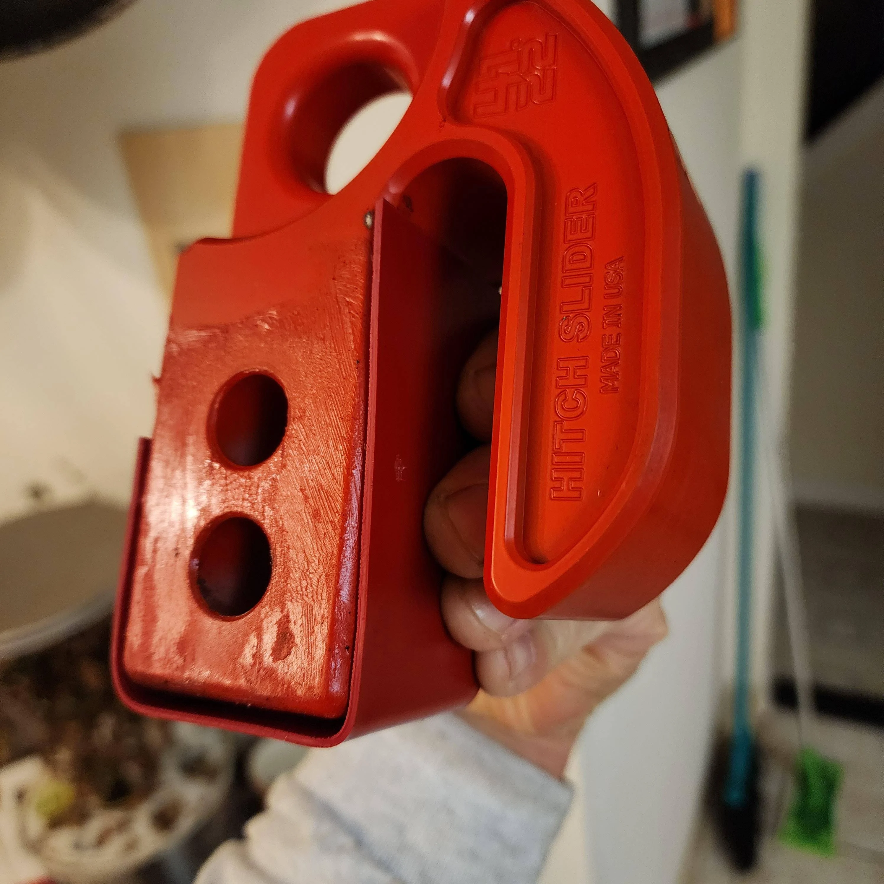

Wrapped the hitch skid in Kydex. Had to take off the top wrap around, so installed it as just a 90 degree piece. Tapped it in with a deadblow, just tapped, not full send, lol
NO RATTLE!!!
