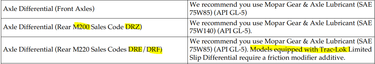

Will this be the gear oil I use if I have the willys?
You need it, or something similar, or the slip additive, if you have the Limited Slip rear end. Otherwise, any 75W-85 or 75W-90 gear oil should be sufficient. It is recommended to use 75W-140 in the rear differential when doing a lot of towing.

Just to clarify, so the willys has the limited slip and i dont tow so i can use the exact oil on the link, correct? Do i use it for the front too? Sorry, im a noob with this gear oil. Thanks.

Dont want to pay $54 a quart dealer prices, lol. Dealer didnt metion if the front used the same oil, he just said i would need 4 quarts because it would be over 3 quarts for front and back.
Yes, with the limited slip and no towing, that will work. You can also use it in the front. It contains a friction modifier that is needed in the LSD rear. It's not necessary for the front, but no need to buy and keep track of two different gear oils.
Thank you for the confirmation! Just ordered.
