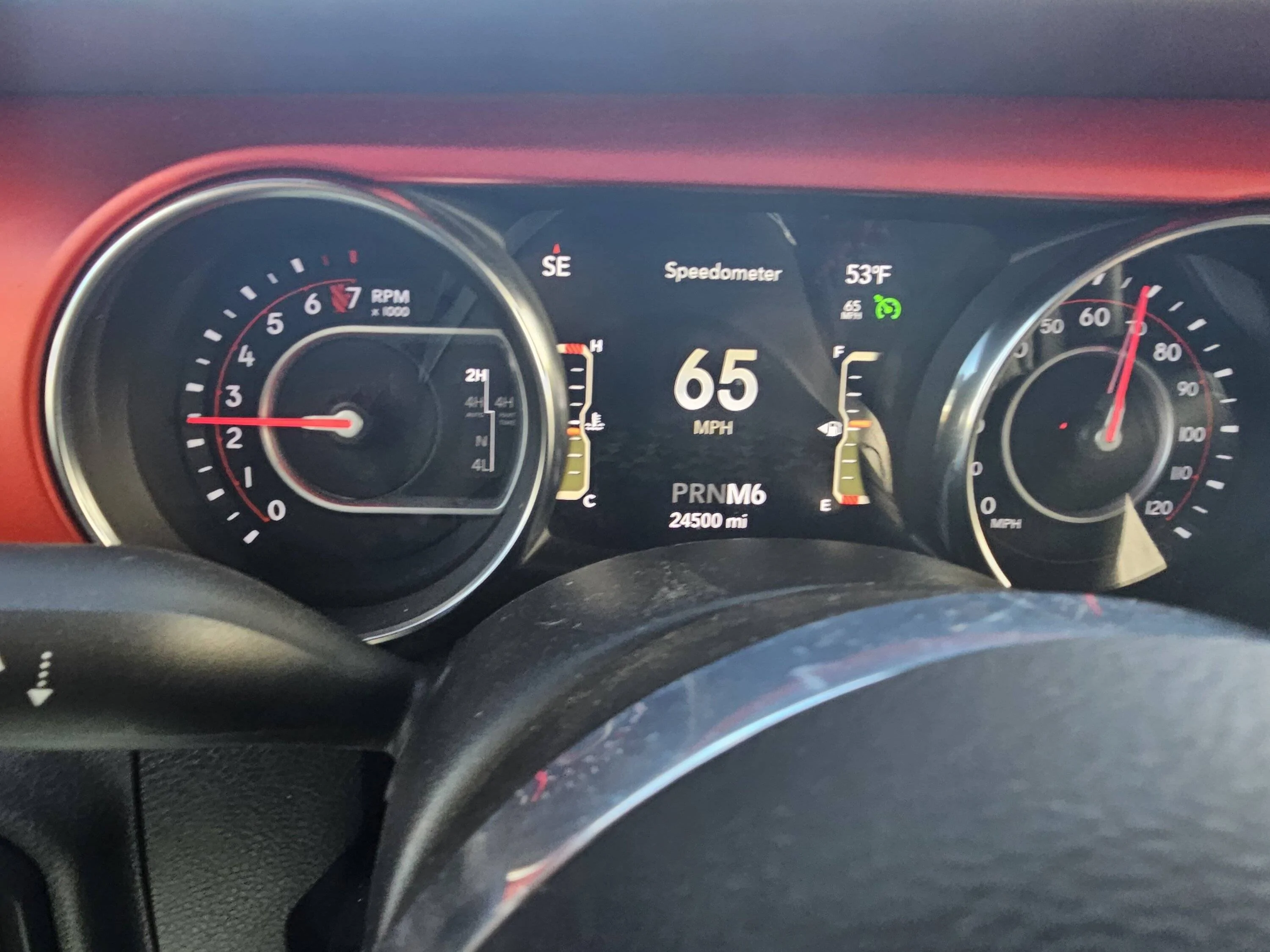

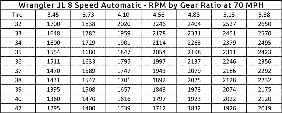

So pretty flat besides a few mountain passes. I have 38s with 4:10s and I can tell you it's a dog. 65-70 I never see 8th and speed limits around here are mostly 55. Most road around western oregon are pretty hilly with hair pins and low speeds. My jeep is in the shop now for gear and going with 5.38s. It's not a matter of freeway speeds but just overall driving sucks lol.
Photo is me doing 65mph and stuck in 6th wouldn't shift to 7th gear till 70mph.
Our 2019 JLUR was on 38s, but it had the 2.0t. Made the mistake of 5.38s. You'll see 8th gear all the time for sure, like any speed over 40mph. What's the point of an 8 speed if it's out of shifts by half the speed limit? People think the damn thing is broken if it spends "too much time" in 7th. That's still an overdrive. It's the top gear in the JK in fact. I don't want or need my jeep geared so it is always in the 2nd overdrive. It will still spin the 37s if I pull away from a stop sign too hard with the 4.10s. Sure 4.56s would be optimal for my driving style but I'm not about to drop $3k for a bit more gearing. As I've stated, a supercharger will add actual power for a few grand more and you can bet it will downshift less with an extra 130hp too. If you rarely drive over 55mph, then gearing so it's in the top gear by 40 works. If you roadtrip thousands of miles a year at 80+, that gearing sucks in my experience.
