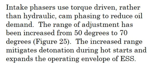

- is he talking these specific engines built for this? Or, generically - the engines he works on.
Yeah, thought so.
These don't use the sort he's talking about which rely on oil pressure. Doesn't matter if oil pressure drops on these - it's why they do not interchange with the non-ESS engine phasers
Also - the chain is constantly subjected to uneven stresses while running by the mere fact that the cams don't turn under the same forces all 360 degrees.
Yeah, what he's saying isn't going to apply to these. He's talking generically of other engines.
Jeep Gladiator Whats is your opinion the jeeps engine stop start system? 1743369313469-m9
So, problem solved.
40,496
54,011
Did you look at the video about start stop and oil??
Yup. He's another hater, and not taking all things into account, especially the fact that these are specifically taking all of that into account. I can tell by the terms he's using. Another youtuber talking generically (and with a bet of his own speculation thrown in)
I even read the transcript to be sure.
Why don't people with the 3.6 and who use ESS all the time, let it work as designed, have issues with the timing chains and such? Because these were radically redesigned to handle it. Even the timing chain itself was totally redesigned, the phasers do not use oil pressure.

I agree, just that what's he's referring to will be more of a subject relating to what he's working on. I mentioned the specific differences because what he mentions doesn't apply to these 3.6 engines.
There's probably a lot of engines out there where the ESS was just tossed in, and they will figure out the problems later.
I enjoyed the oil bit as I can so related to that with the AMC years and the T5 transmission where they kept having issues and kept changing the lube recommendations - running from gear lube to ATF to engine oil - book after book was changed, and in the end - they finally got it, with a synchromesh lube that works perfectly. But the poor guys going by the owners manual or the first TSMs - they'll have some trouble.
I wouldn't discount what he's saying, just the single small bit that was pointed out by a prior post here pointing to what that tech said - and how it doesn't relate to our engines (others, it likely does, and the tech explains it well).
