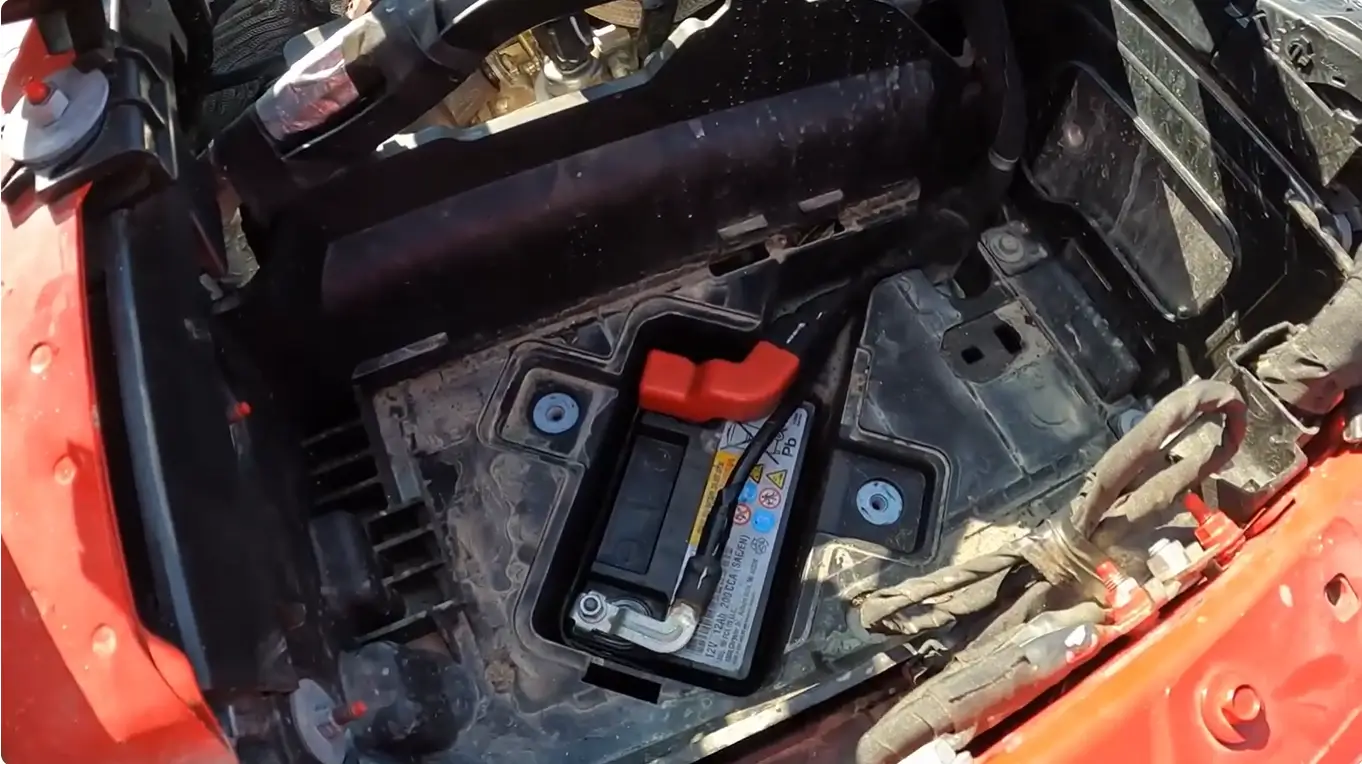

I saw a YT video where someone replaced the aux battery on a diesel JL. For the diesel the aux battery is below the main battery and the main battery is located where the fuse box is. The airbox is also located on the drivers side and the fuse box is where the airbox was located.

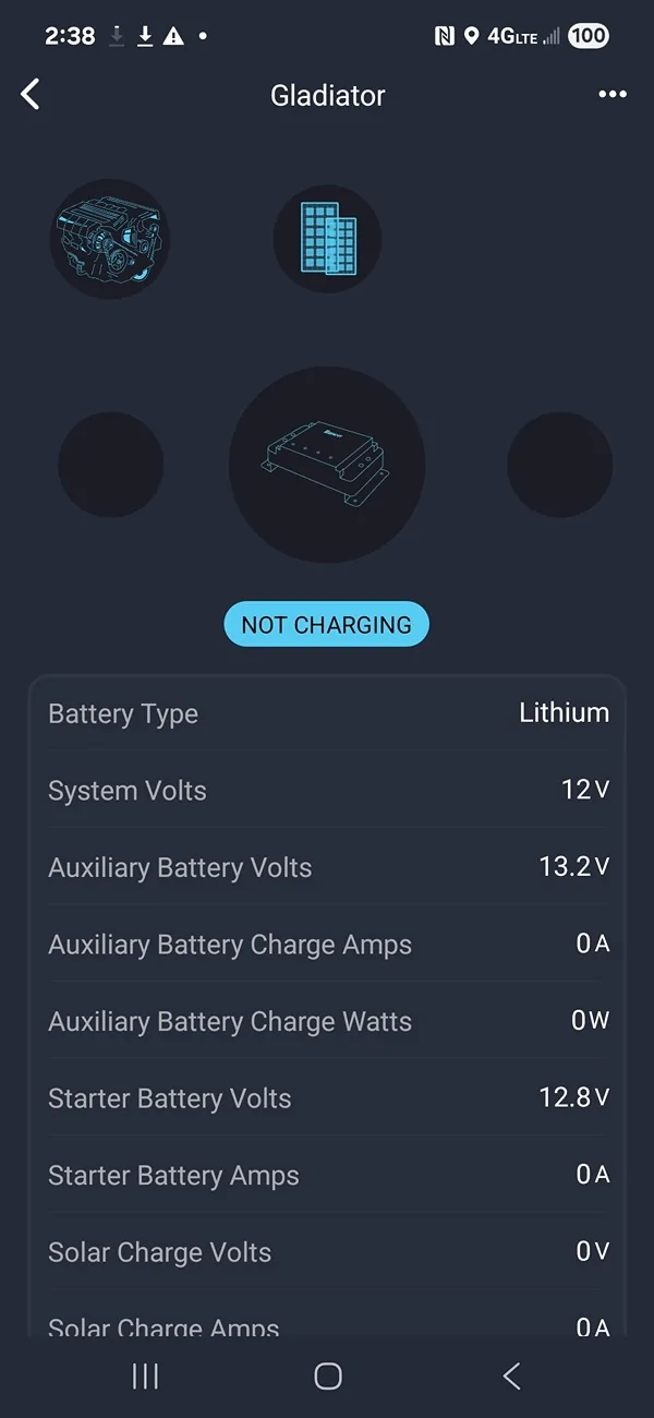

I got back reading here this morning and did a screenshot from the Renogy controller after checking the current voltage of batteries. I'll drop it here.
Jeep Gladiator Start/Stop battery is STUPID! Screenshot_20250902_023849_Renogy
It was raining here yesterday so not a full charge for solar systems.
I started it up and moved it Sunday to unload food for cats then parked back. So not been driven much in general for the last month about 307 miles total. So the 85 watt solar system has been main upkeep on starter and ESS batteries for the month. The Renogy charges the house battery as priority. On my start up to leave VA medical clinic the ESS system light up after a false start and restart. I wouldn't be surprised on a bad cable issue with mine to or from the ESS battery. The drive there is about a hour.
