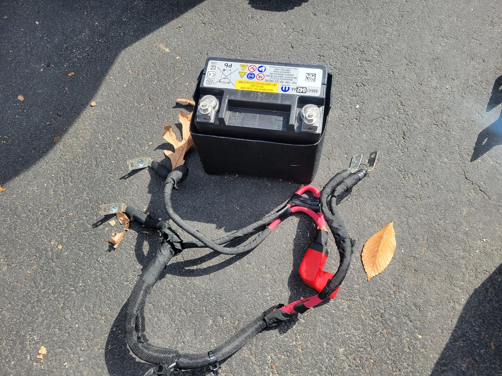

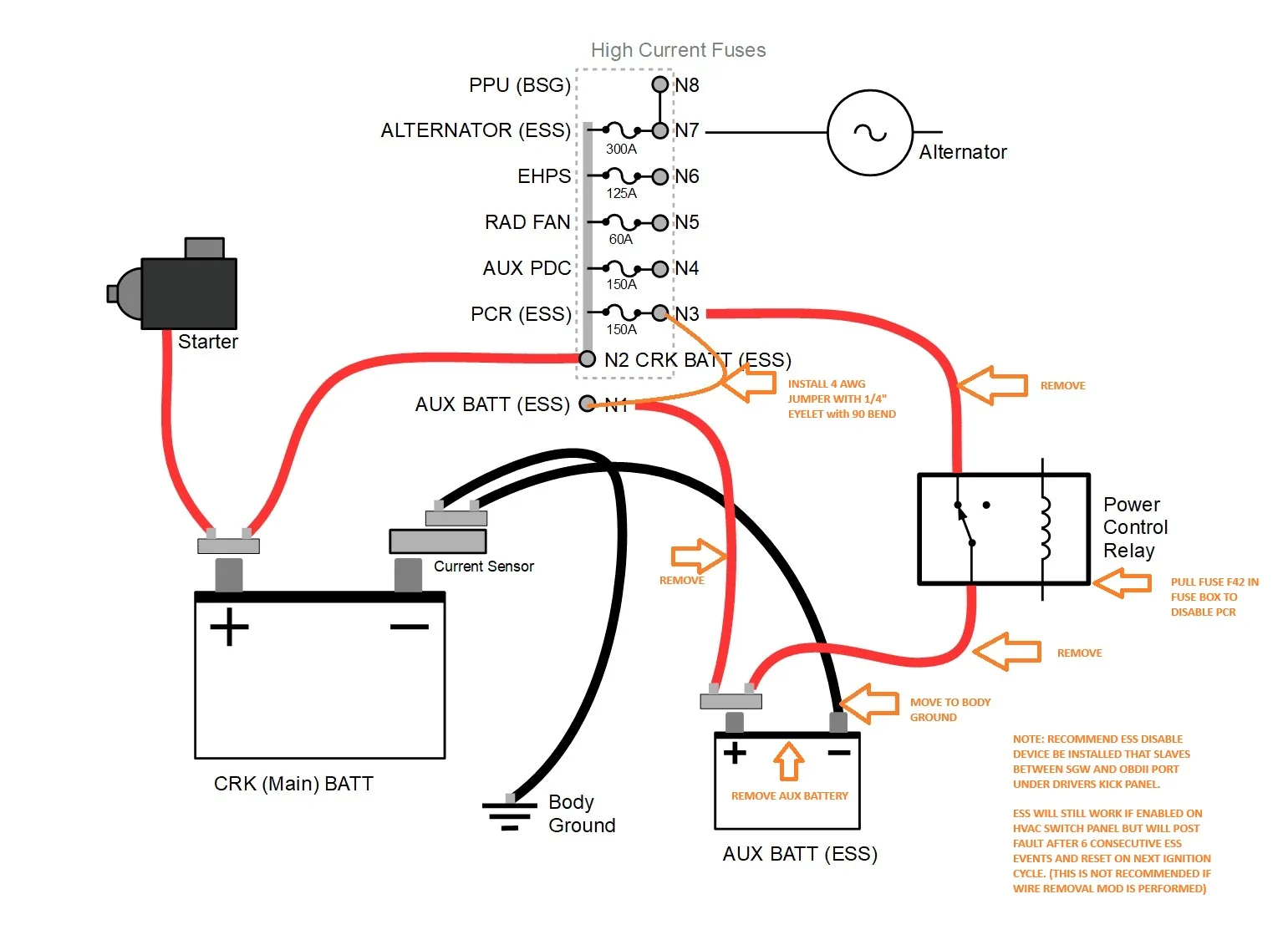

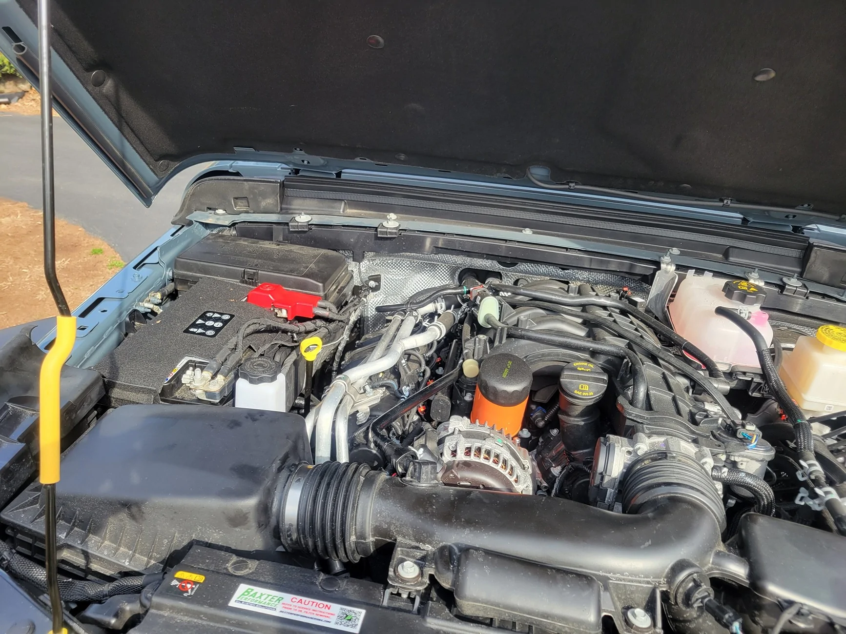

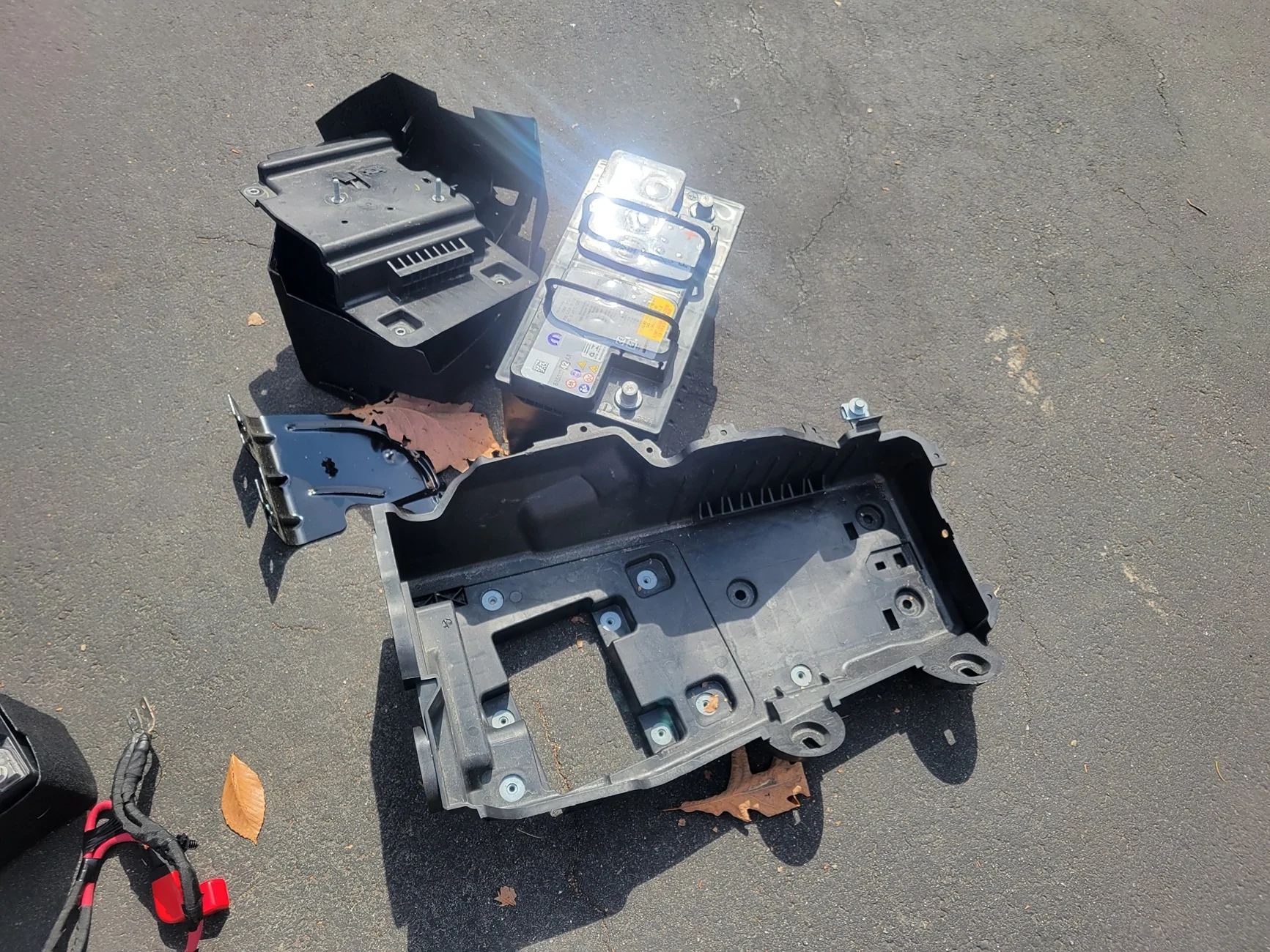

Unless you are married to having a ESS function, just do the full delete mod and you can stop worrying about it.
Looks like you reached in and grabbed its little heart and entrails and threw in on the ground. That’s pretty savage man
40,496
54,007
Canadians would never do that - it attracts BEARS.
Hootbro
Apr 13, 2019
10,207
20,004
2025 Gladiator Sport
There was carnage. Not for the timid.

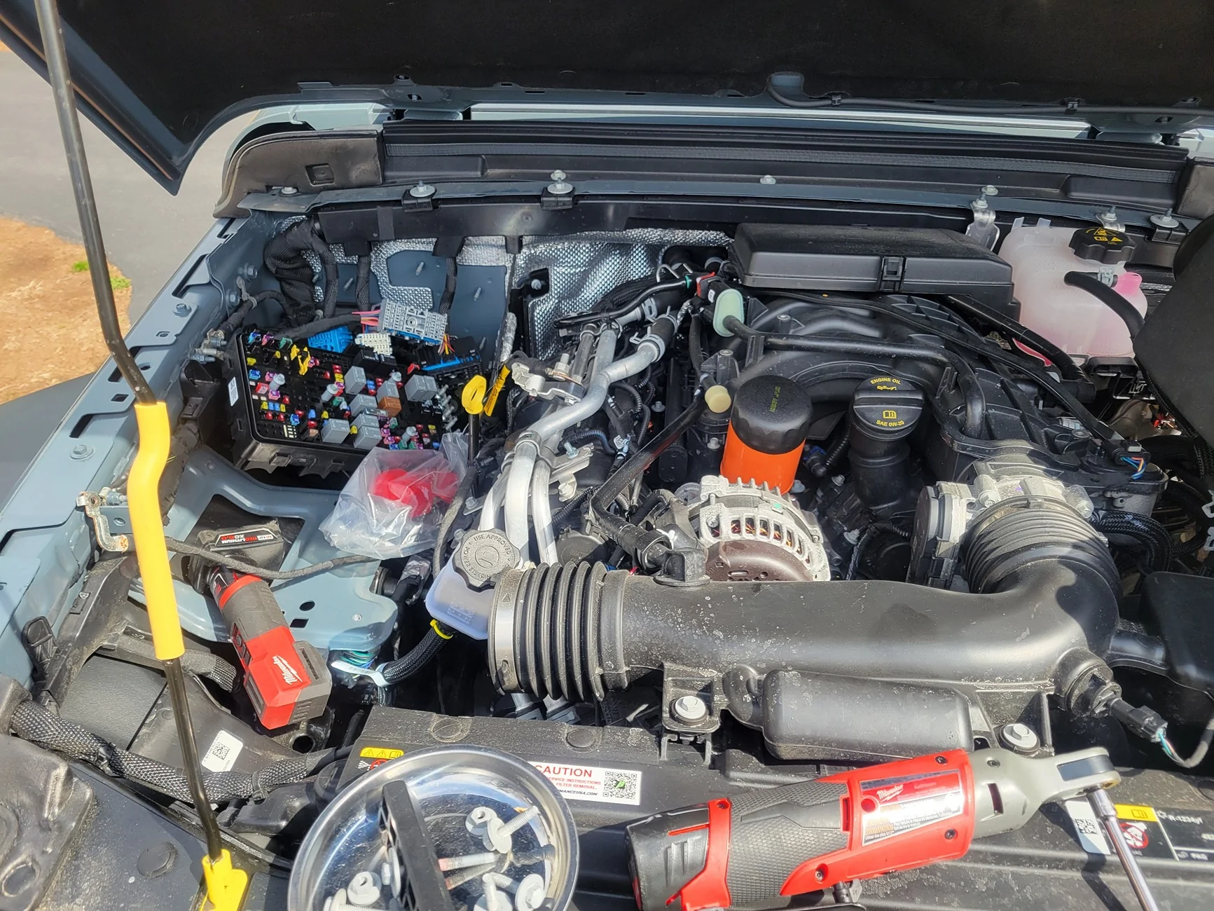

Is removing the fuse box as scary as it sounds? (considering the panicked warnings I got when I stumbled onto some canbus wires in the back wall)
Is it easier to remove the battery this way or through the wheel well? Bolts at least seem more reusable than those plastic rivets.
Hootbro
Apr 13, 2019
10,207
20,004
If you are replacing the aux battery, through the wheel well from the bottom is easier and less risky of blowing the fuse array. Top down through the fuse box you just have to be more careful.
Edit: For anybody doing a full removal wiring and all, the battery tray has to come out but it will not come out if the aux battery cover on the bottom side is not first removed also.

the quick fix for me was to jus tdisconnect the aux battery (several youtube videos on it) and then installed the Tazer Mini and turned on the "remember what the auto start/stop is set to on or off"
40,496
54,007
Don't need the videos - there are great instructions here in several places on the forum about how to disconnect and pull F42. No big deal. Just have to be sure to disconnect the correct cable since there was a change some models years back. 2020 would be different than 2023 for example.
