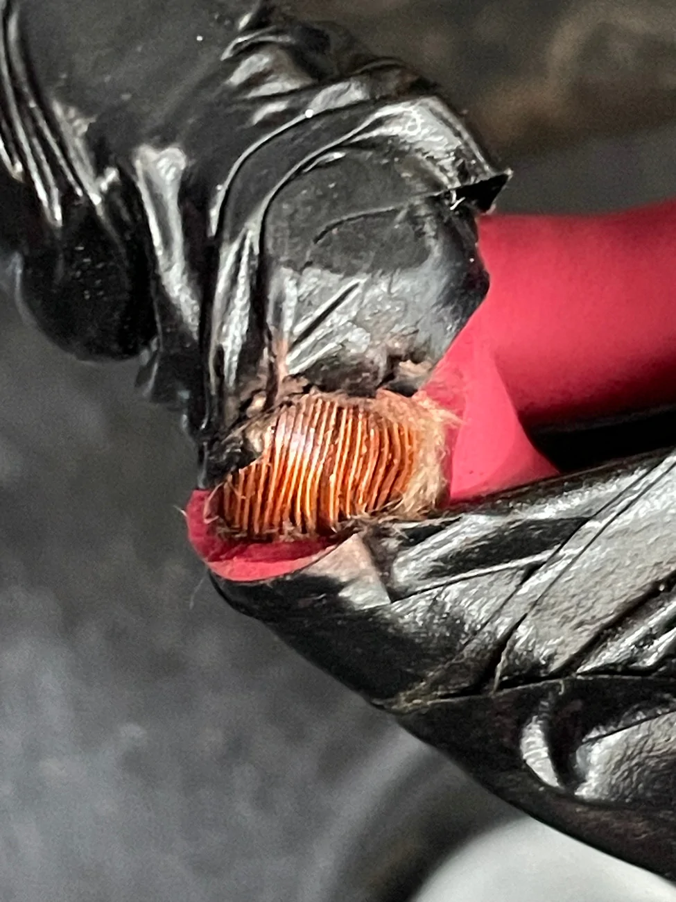

This start/stop function is the dumbest invention ever. It’s an over engineered, discombobulated, mess that does nothing to save gas and causes nothing but problems. I just didn’t realize how stupid it is untill I had to change the Aux battery. 3 years old 2022. Gladiator and had two Aux batteries replaced under warranty.
I had to leave work today because the wife couldn’t leave the house when the electronics went haywire. Service trans mission warning. Put car in park warning without the vehicle actually running. Oh yea… the car can’t shift from park because you can’t start the vehicle! Couldn’t turn off the vehicle from “RUN” to off. It was a mess. Every warning bell and light was going off. So now it’s time to replace #3
So I got a new aux battery. But removing the fuse box and trays was THE BIGGEST PAIN just to replace a battery. I couldn’t imagine what a dealership would charge.
just ranting a bit. lol.
I went through two and then put in a Genesis Dual Battery System. The aux battery typically went on the fritz during the wetter months (PNW) and the dealer told me the first time it was because of the bad design of the water draining from the plastic in front of the window through the battery tray. Well, when I was taking everything out I found the real culprit - something that would not have been seen if swapping the battery from the wheel well which is likely what the service department does. This was above the battery squeezed into the small space between the battery and the fuse box. No bite marks, just split wrapping and exposed wires.
For lurkers, onlookers and so on.......
A battery in water will not make it go bad.
Enough water such as making a path between the posts, can cause a slow discharge and it would discharge both over time, but not ruin.
A bare wire if not touching anything conductive is not good, but won't cause a bad or discharged battery. It would have to touch something conductive, such as metal
