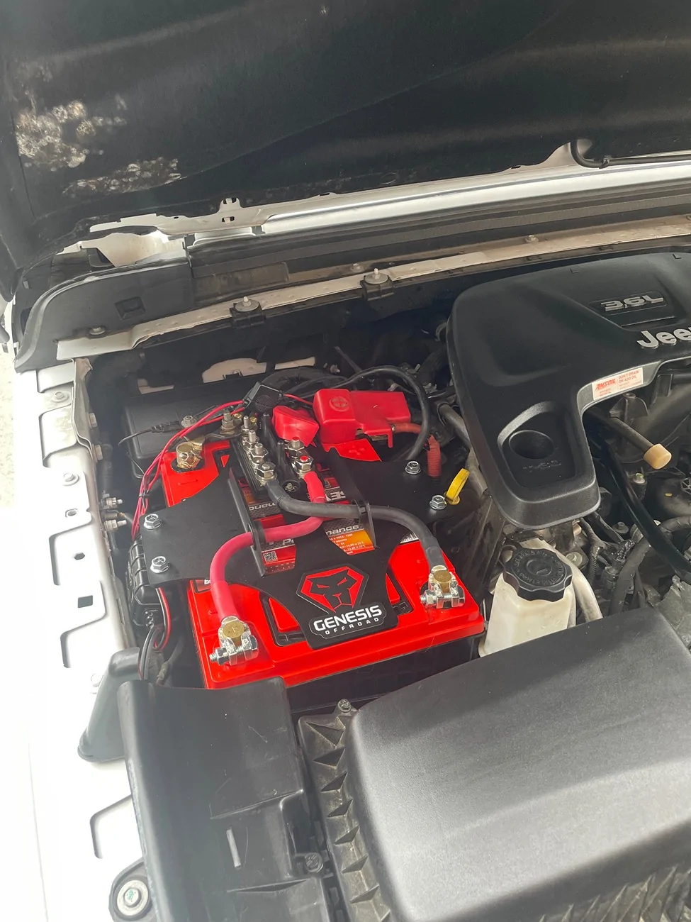

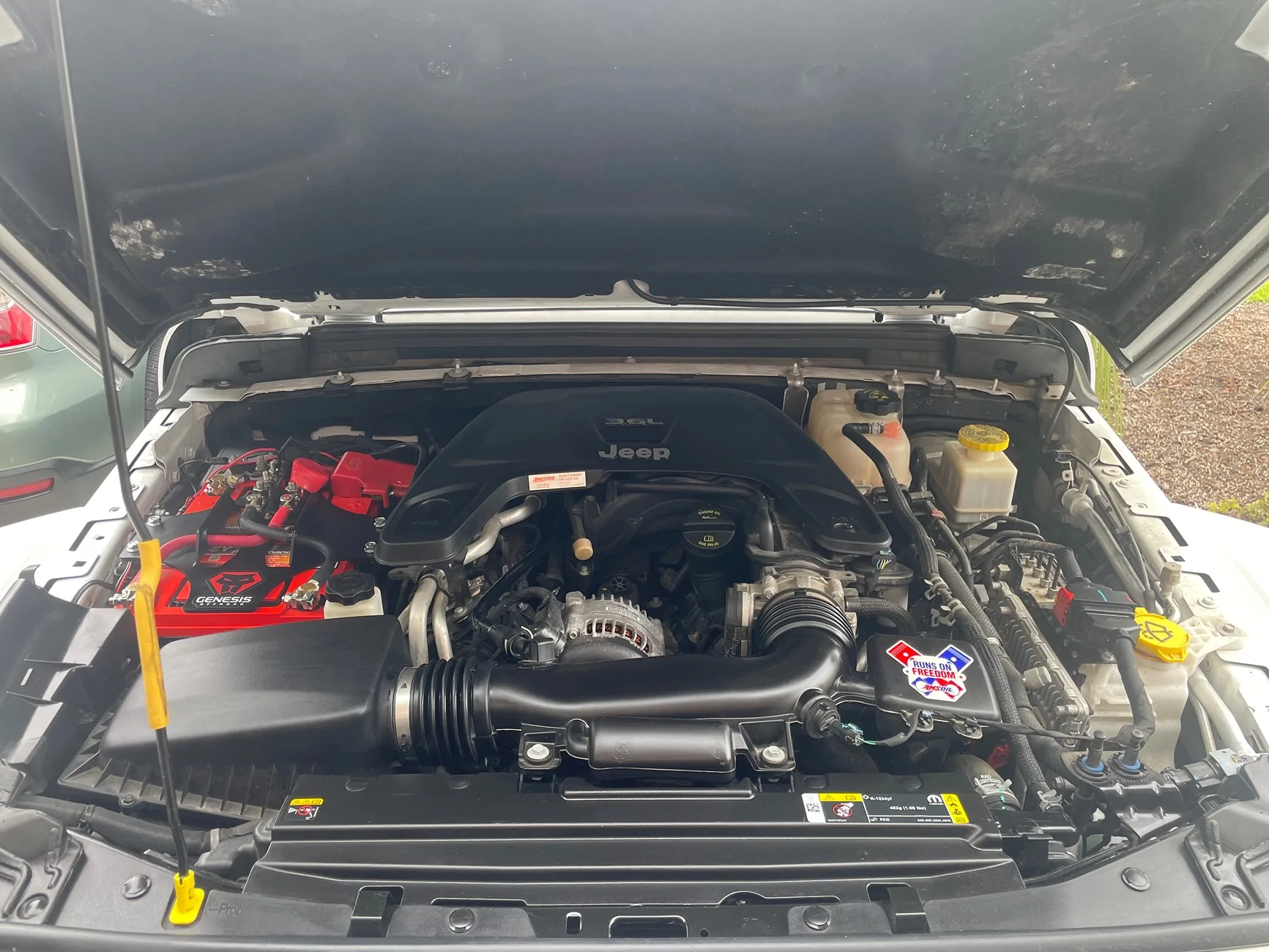

I finally pulled the trigger on the Genesis Battery Replacement Kit using two Odyssey Group 25 batteries. So essentially it maintains factory designed operation in a hefty dual battery setup. My only regret is not doing this in year one when I was dealing with all those pesky Aux battery issues the first time.
Jeep Gladiator Start/Stop battery is STUPID! IMG_6867
Jeep Gladiator Start/Stop battery is STUPID! IMG_6868
