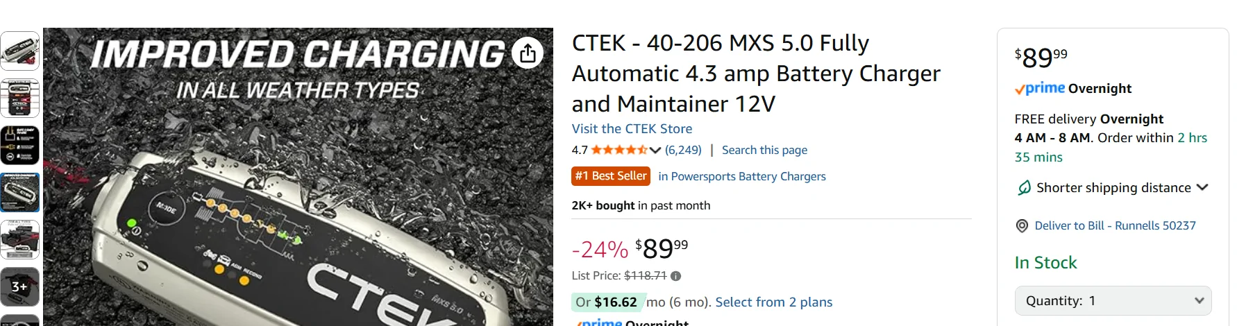

In a hurry? Do you have Amazon prime?
Jeep Gladiator Start/Stop battery is STUPID! 1756863117432-5h
Caspien
May 3, 2021
282
422
StLouis, USA
2025 1500 RAM, 2020 GC Trailhawk, (Previously 2021 JTR)
I.T. Architect
Yep.. got prime.. gonna go ahead and bite the bullet, order that one, and just keep the noco as a spare, or maybe re-gift it to someone less OCD than me ;)
