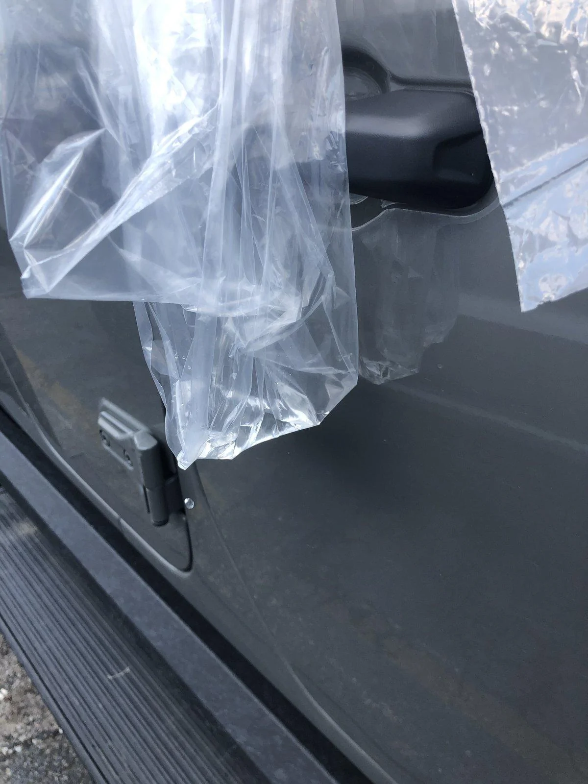

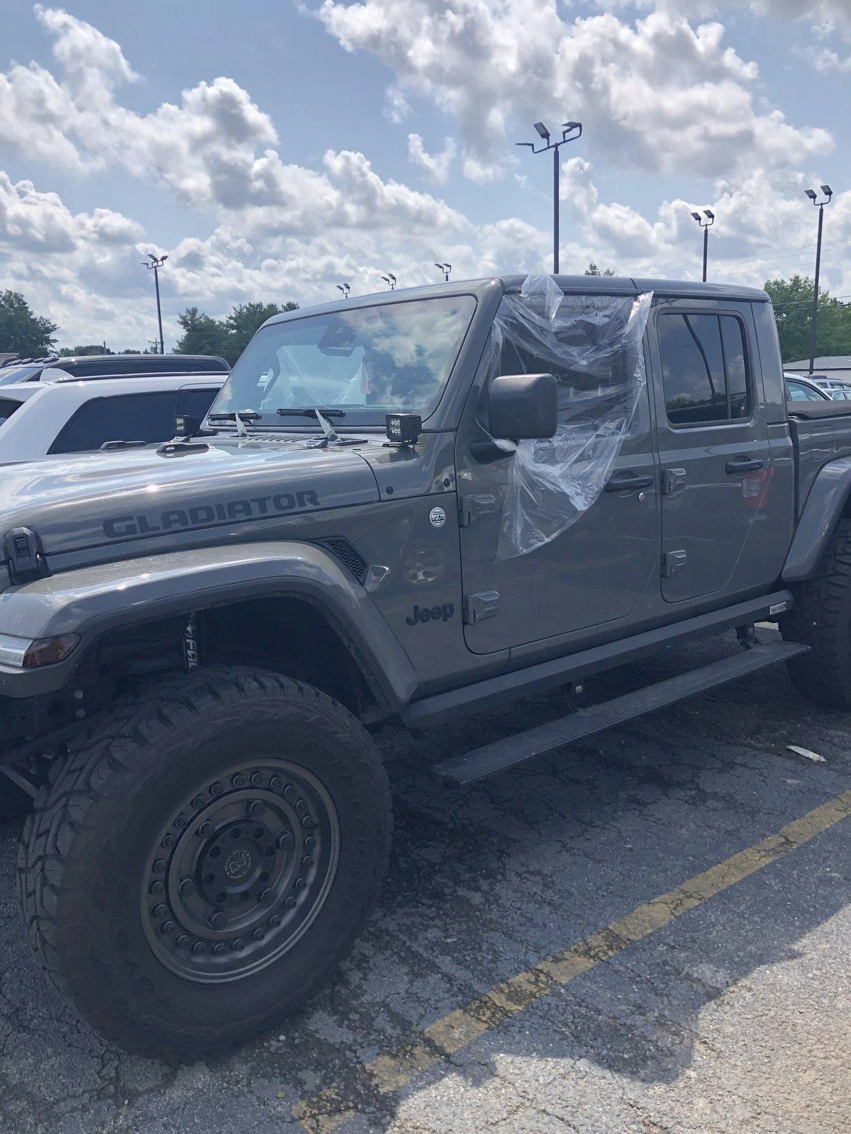

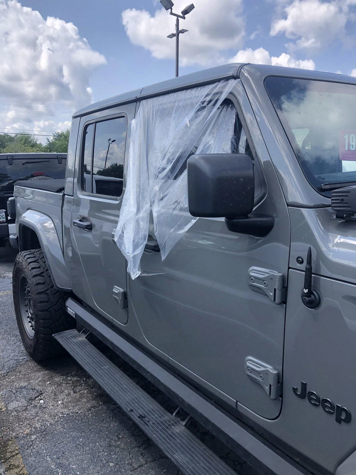

Sorry if this should go somewhere else. Ten days ago my Gladiator with 5000 miles signals a “stop start service system” warning. I pull over, shut down and restart. Clears it. Drive a little ways and then a new warning “vehicle will shut down soon, please go to a safe place”. Before I could pull off, dead. With every light twinkling.
Had to find the release pull for neutral and get pulled off the road.
Dealer replaced the small battery, then found faults and blown fuses. It will be another week for a relay and new fuses, etc.
Stopped at the dealer today to request a loaner. What a nightmare. Went out to get my insurance info - and here’s what I find. Jeep parked, windows down with plastic bags over them, the day after a hurricane rolled through. Soaked. Everything.
Treated like crap when I complain. Treated like crap when getting the loaner. Curious what you guys think I should do/ask for. Already concerned about electrical gremlins. Now soaked inside.
Dealer is Jeep Ram Chrysler of Franklin TN
I find it deplorable the way that they treated your Jeep. And to think, you bought a mopar lift from this dealer had it done there. Isn't there a relationship here? I mean those items aren't cheap? At the minimum @JeepCares should at least get involved to the point where you can be given answers about why you were treated this way!!
