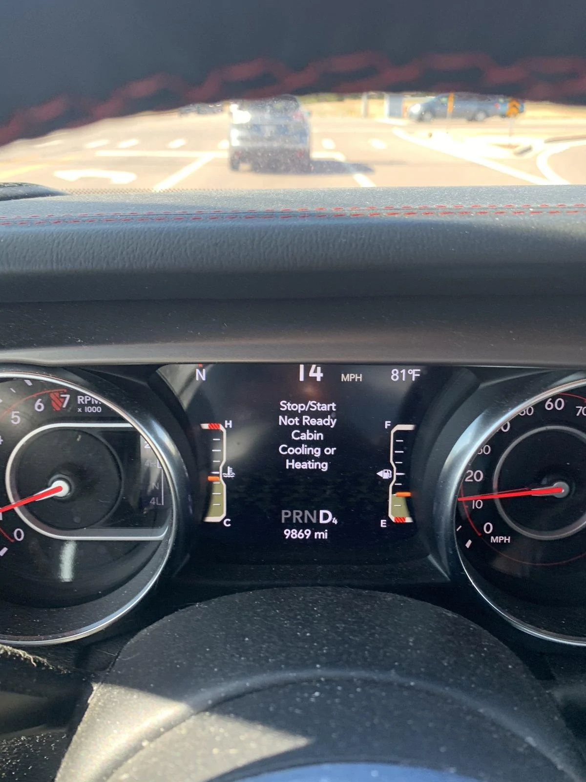

I had this issue on my Gladiator Rubicon I just bought. Seems like it had been sitting in the dealer lot for a while and the small battery might have been low or close to dead. I had test driven it and had no error. The day I picked it up I had the ESS warning light and the message saying "Service Start Stop System". Dealer said to give it a few days. I gave it one day and decided to start troubleshooting myself.
I first charged the batteries with nothing unhooked. Warning light and message still there. Next I disconnected the negative battery terminal and separated the lead for the smaller battery. I verified that they were both charged fully(they weren't initially). Left the batteries separated and unhooked for about an hour. Hooked everything back up and the light and message are gone. It's been over a month and 1000km later still no message. ESS works as it did on my JLUR.
