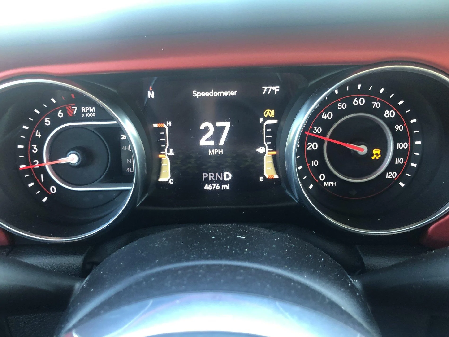

I'm having the same issue with mine as well! Comes on after 5-10 miles and resets when ignition is turned off for another 5-10 miles. Goes to the dealer on Thursday.
Jeep Gladiator Service Stop/Start System IMG_2541
rdcox23
R.D.
Feb 13, 2020
40
Charleston, WV
My warning light seems to come on when I hit about 30 mile per hour.
My back up camera stops working then also.
