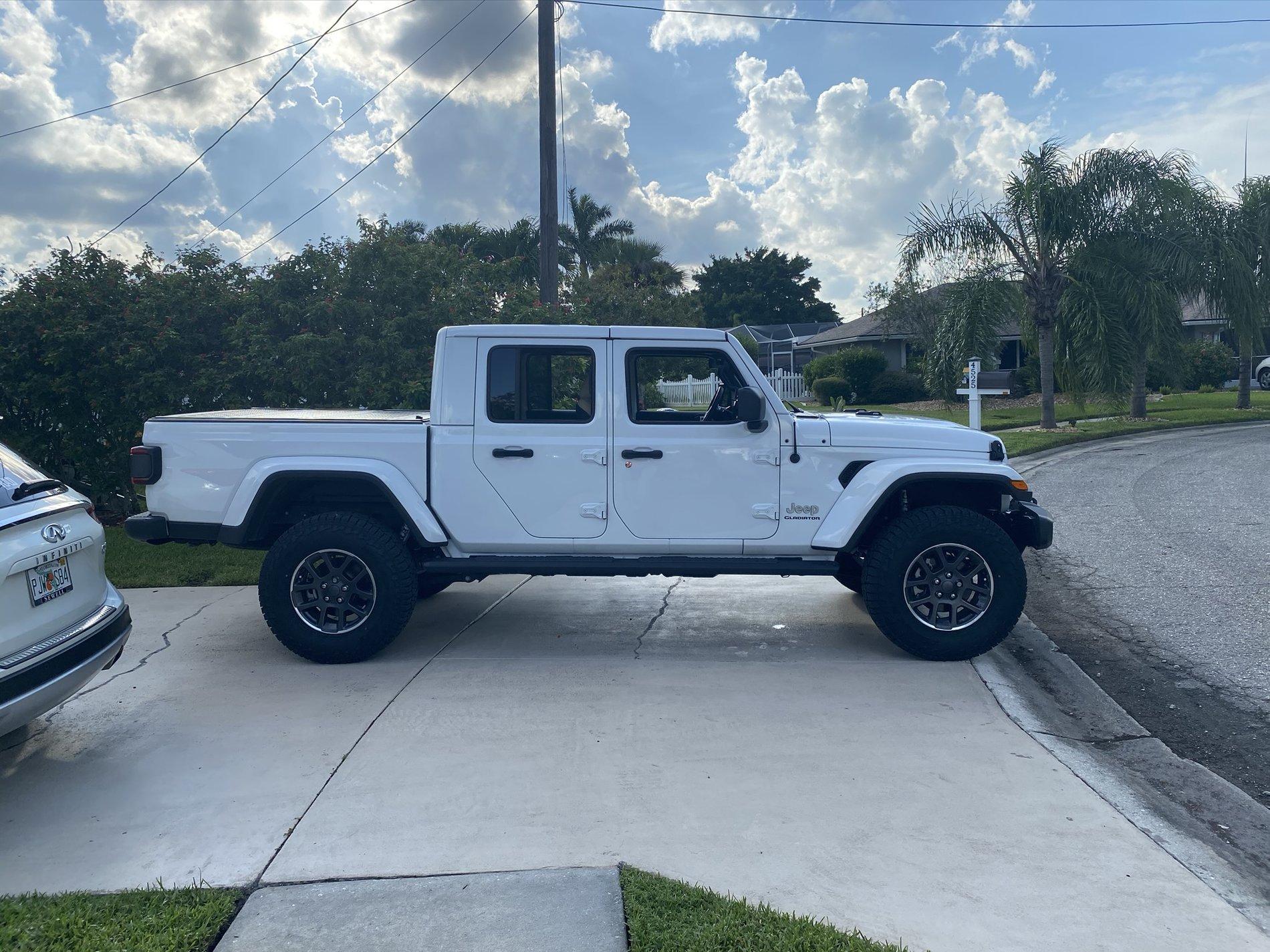

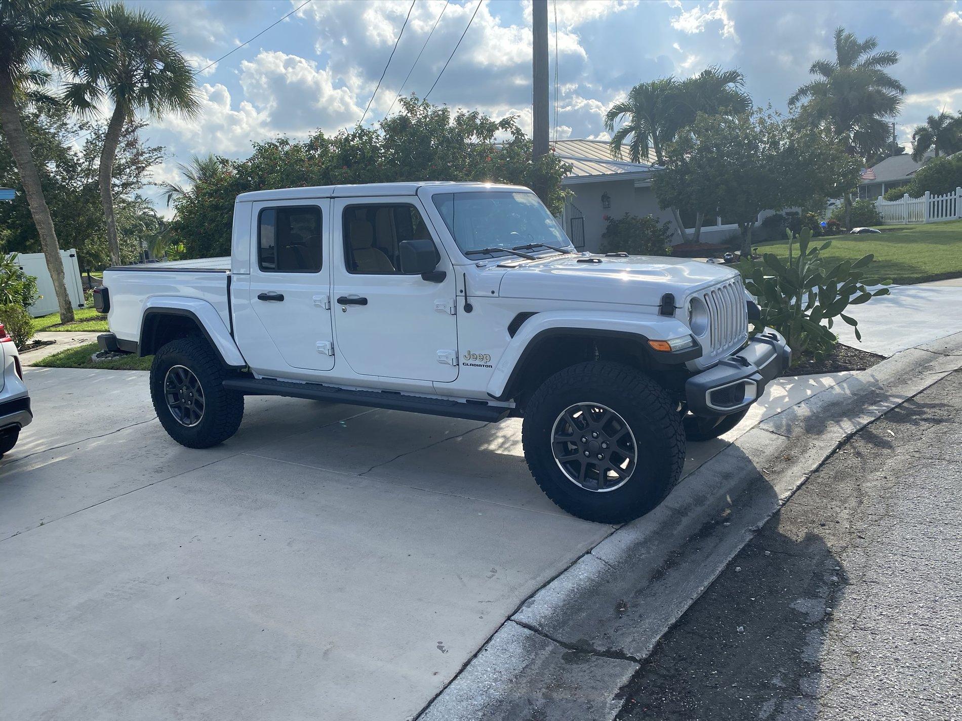

Its not perfectly level, but close enough for me. 35”(34.5 actual) Falkens and Mopar Lift totaled 5.5-6” total lift from stock on the Overland with 31.5’s from the factory. Total height is 77 +inches now.
SHARP!!!! Mine is white too (whenever it shows up). Thanks for the info!

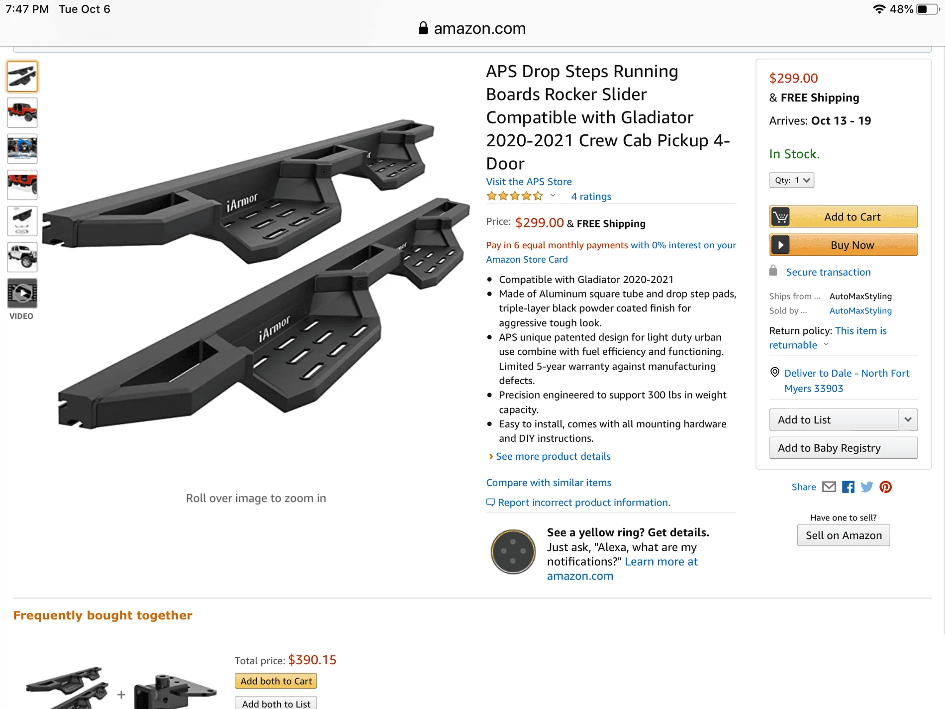

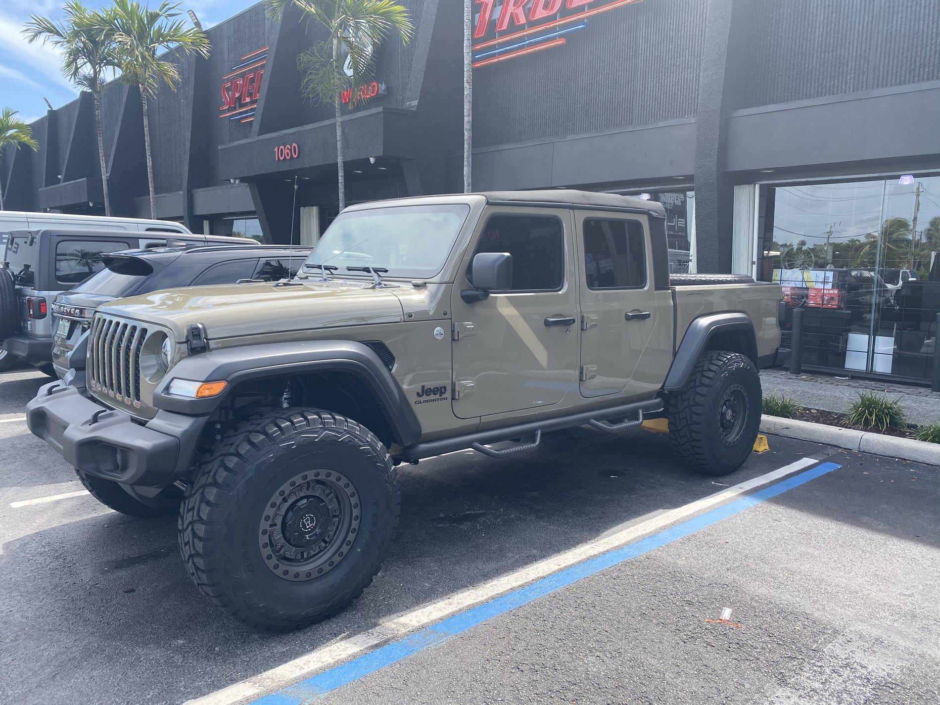

Its high enough I a, putting these on this week for the wife....its a stretch even for my 6’2 200 lb ass to climb into at almost 60 years old, and my shorter Friends really struggle....
Do these mount to the body bolts or pinch weld on the rocker?
I like the looks of those
Don’t know yet. I should have them today or tomorrow. The current ones on my Overland are mounted to pinch weld and work perfectly fine, just don’t have the step downs.
Are those the stock 18" rims? If so what size tires did you put on it? It looks pretty level to me. Did you ever measure it?

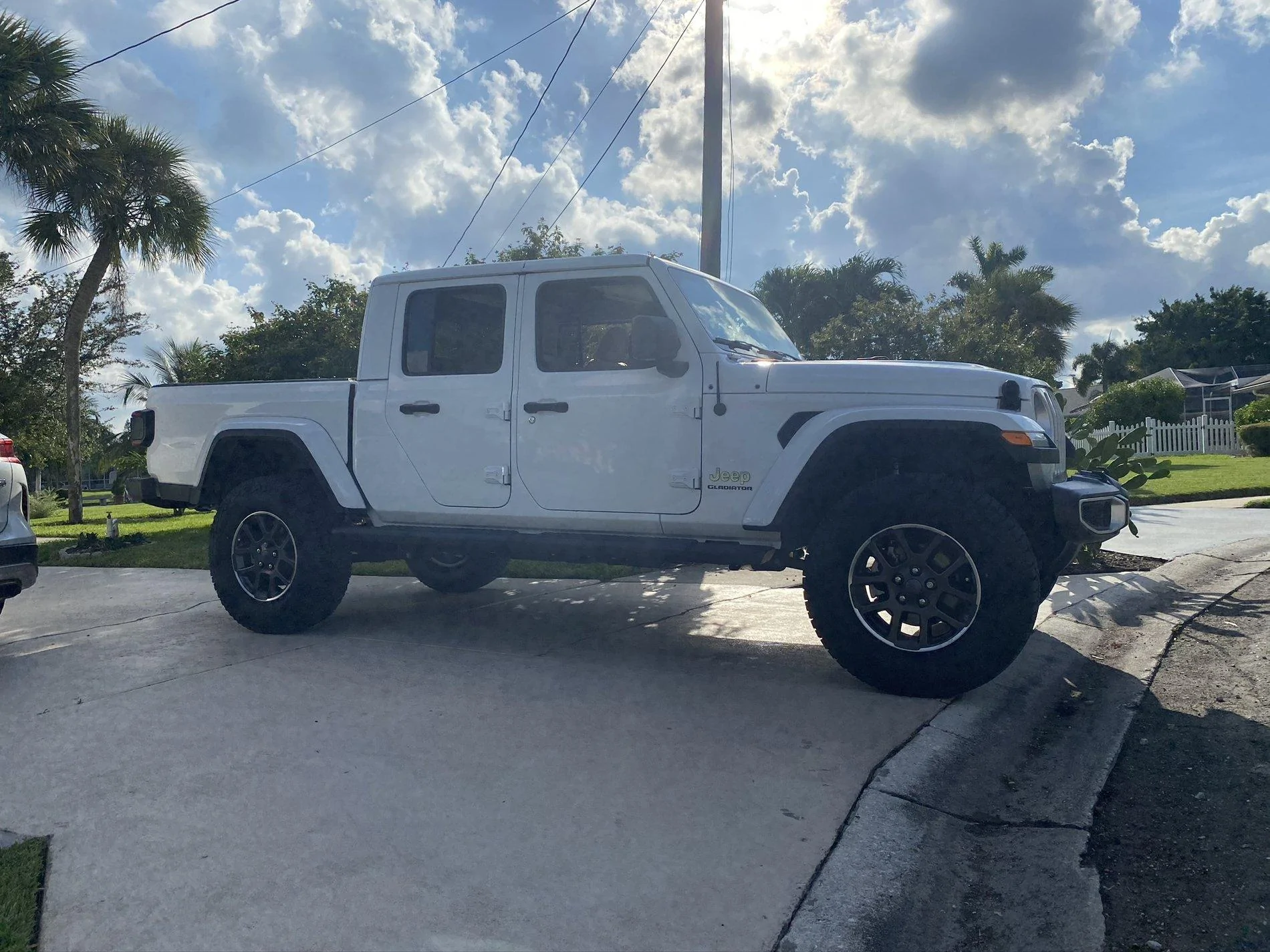

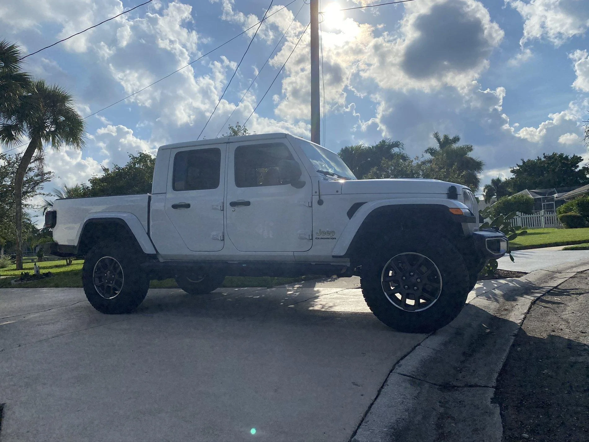

My Gladiator gained a lot I feel like with Mopar lift and .75” front spacer
