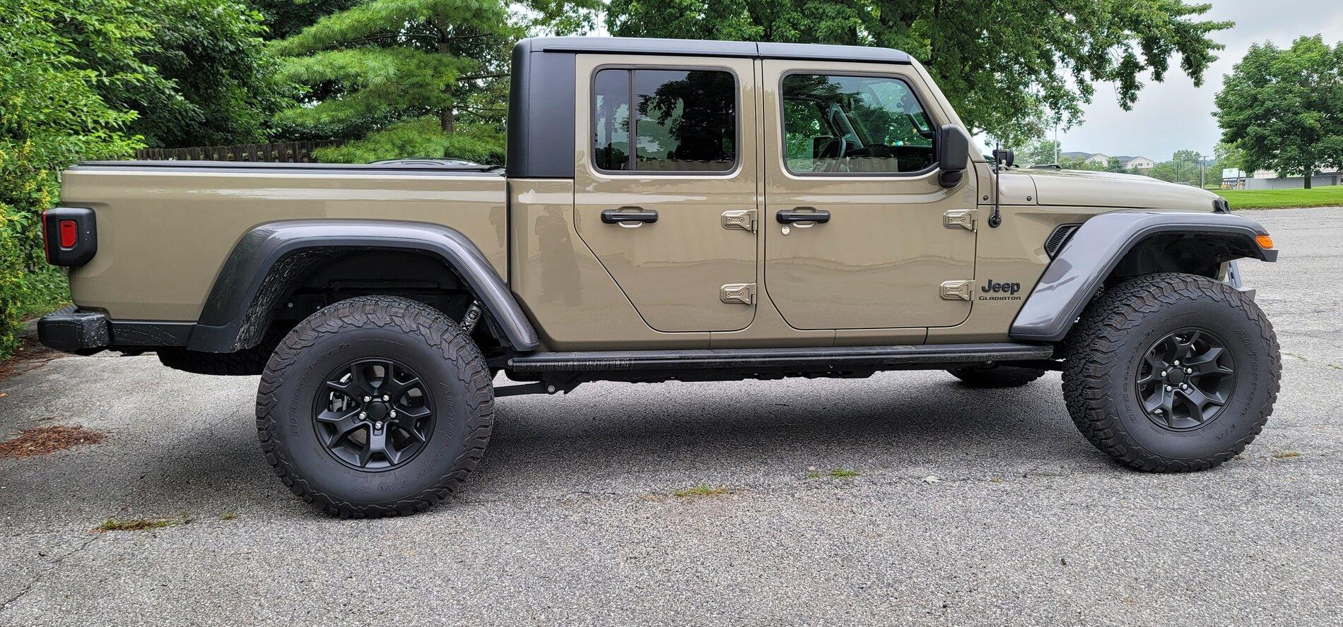

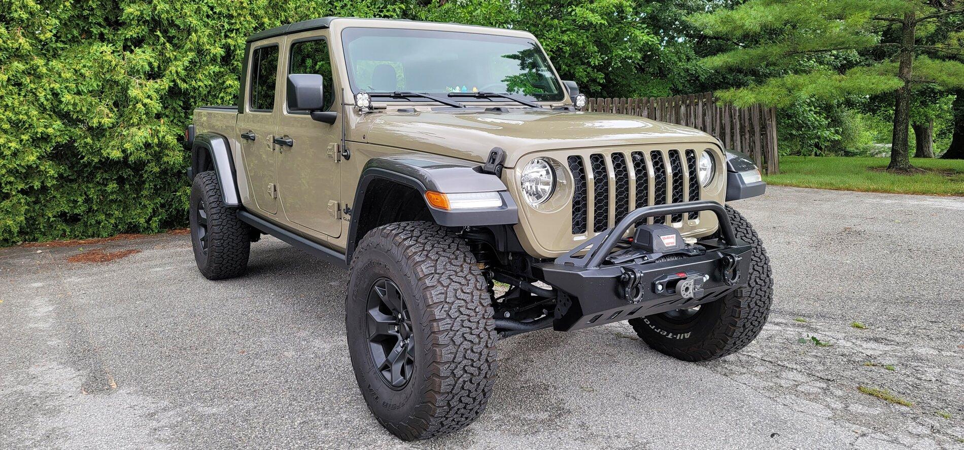

I measured mine once, I think it was 1" lower in the front and I have a steel bumper and a winch.
Jeep Gladiator Is there a lot of rake on the Mopar lift? 20210713_092349
Jeep Gladiator Is there a lot of rake on the Mopar lift? 20210621_090202
