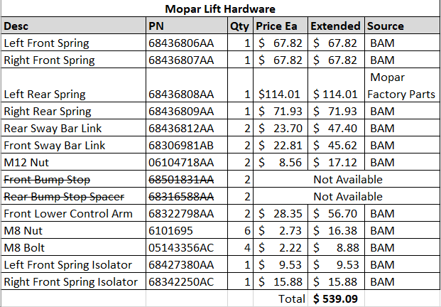

Was thinking the Mopar kit minus the rear springs, add rear spacers to keep my rear max tow springs and air lift bags. Also add a front adjustble trac bar. Thoughts?
It’d be nice to know the spring rate of both your springs and the Mopar 2” lift springs. The lift springs might have a higher rate.
I have no plans to offroad heavy so stock spring rate or the difference beyond whats needed for the lift. I know the rears on max tow work well just want to match up with the new fronts.
