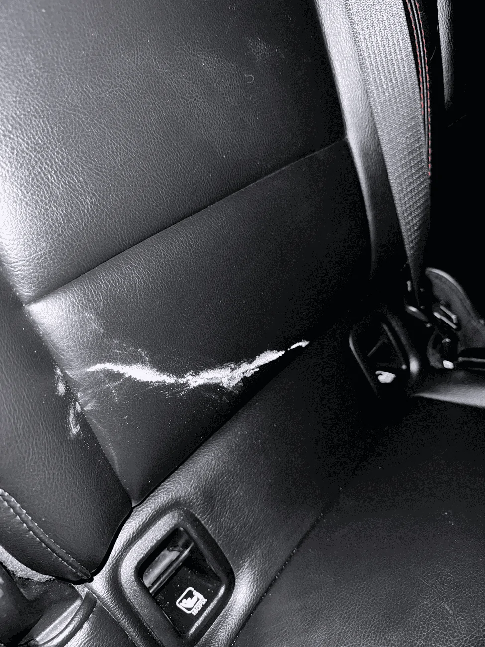

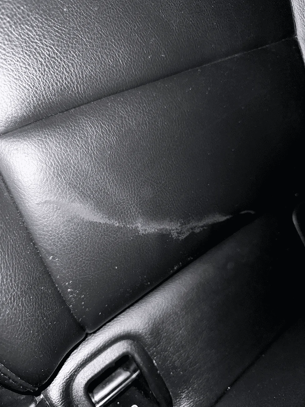

If it is grayish/silver in color, then it could be anti seize compound. Hand cleaner may take it out quick and then a follow up with a good leather conditioner.

What sort of work was done? Your info says you have a diesel Rubicon, and that looks sort of like dried/crystalized DEF on the seat. That stuff is corrosive so would likely leave some damage on the seat if left long enough.

The leather in these sometimes “ashes” or dries out a bit, but it seems something abrasive was spilled on there. I had something similar happen and used leather cleaner, then conditioner (Lexol)and I can barely tell it’s there now. You might even try black shoe polish and buff it out if that doesn’t work. I have done this with couches with great results.

But first I’d try to get the dealer to replace the skin.

Just my $.02, but based on the pictures you posted, it looks like an abrasion as mentioned above. It looks like something with a sharp edge was sat on the seat and when they dragged it out, it "Scratched" the leather.
