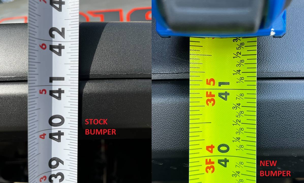

Something I forgot to include... before and after height measurements... Height stayed the same. That was nice... pretty sure, once the winch is installed (an additional 58.9 lbs), I will see a difference.
Jeep Gladiator What the heck is this?  Is this real?  Aluminum Rubicon 3 piece bumper... Heigth Comparison
I wish I had taken this photo when I added the winch. I measured, but don't remember the numbers. It was very minimal though. Post the difference if you remember.

Toss a dog or a child on the bumper and that should give you a pretty good idea on how far it's going to drop

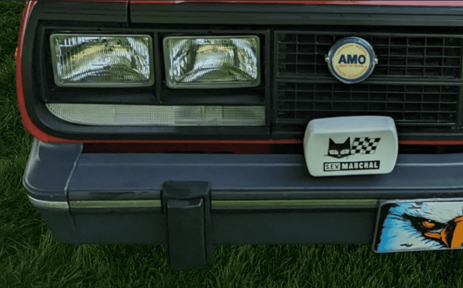

It will definitely be stronger.
The bumpers on many cars in the 80s were aluminum. The bumpers on my SX4 are aluminum and when I hit the deer with that car years ago, the bumper came out fine.
People have bolted small trailer hitches to the rear bumpers on these and pulled trailers up to a couple thousand pounds or so, no issues.
Several years ago when my son had an SX4, he was in Des Moines sitting at a light waiting for a left turn and he was rear-ended by a young female, hit his car hard enough hers had to be towed away. Shoved her fender into the wheel, smashed the grill and hood. All it did to his car was knock off a short section of trim from the bumper (same trim you see on my front bumper with the silver center although his being a black Sport, his had red in the middle of that trim)
The deer hit totally destroyed everything about the headlights, shoved the right fender back, crunching in the front of the fender a bit, but didn't hurt the aluminum bumper -
Jeep Gladiator What the heck is this?  Is this real?  Aluminum Rubicon 3 piece bumper... 1701279087641
Depending on the way the bumper is made, aluminum can make strong bumpers. Not as strong as steel, of course, but if you are that concerned, you'd not run a stock non-steel bumper on a Jeep anyway.

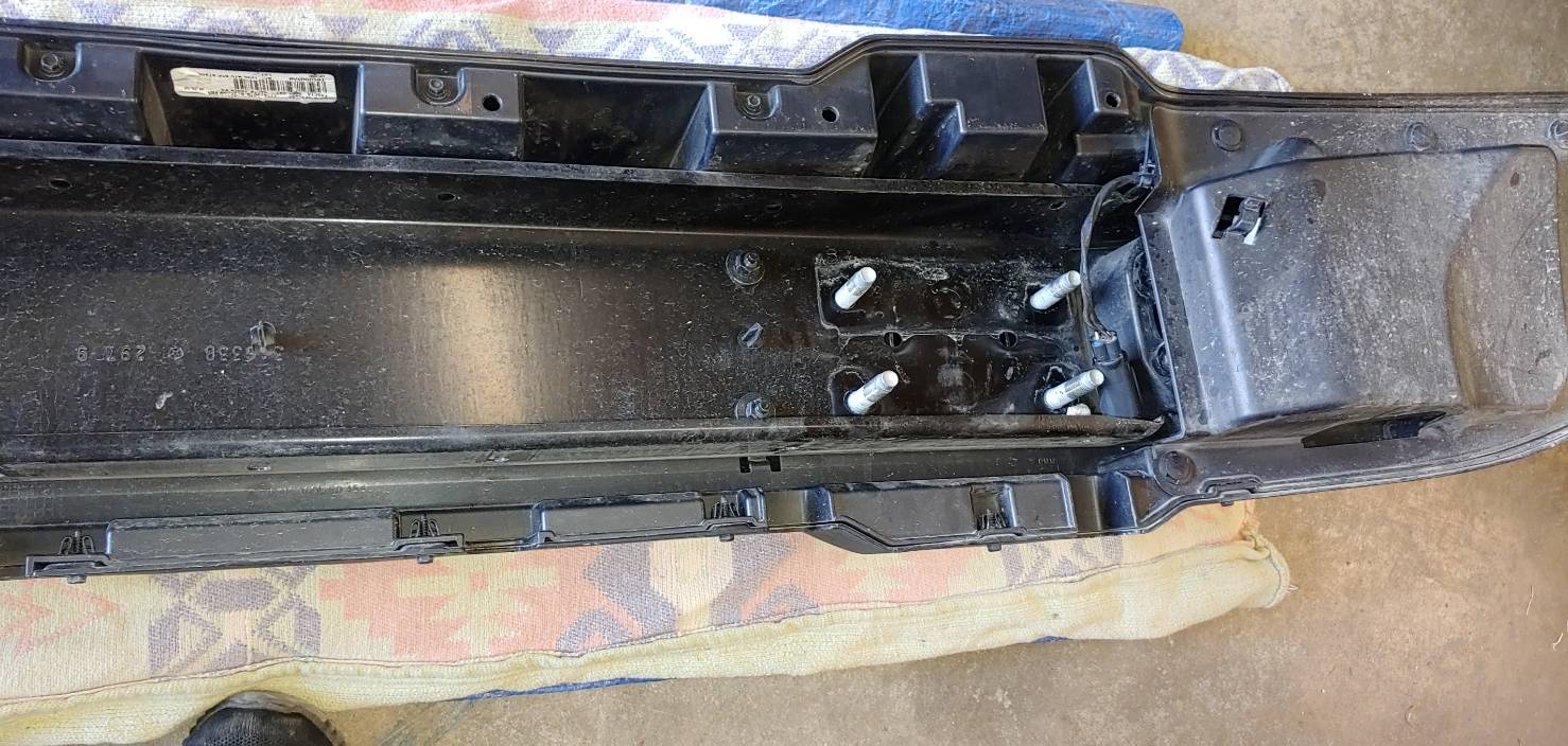

if you have had the stock bumper apart on these (the non-steel bumper) what's to be less safe unless it's as it relates to EU laws.
These will have nothing to do with air bags. Yeah, there's the crush cans - but you can still literally fit the proper OEM Rubicon steel bumper crush cans in the bumpers like I installed if you wanted to.
A bumper has little to do with airbags, otherwise. And the crumple zone is the rest of the structure. A bumper isn't going to have a large impact on that.
These aluminum bumpers and the steel knockoffs are pretty much the same as OEM - and if Jeep can sell the Rubicon steel bumper on these, I see no problem.
That plastic bumper is a joke and a bumper in looks only.
And yet on the exact same vehicle, Jeep will also install for you a STEEL bumper that's got a lot more mass and far less likely to bend or flex or give.
The aluminum version is somewhere in between the stock plastic bumper and the heavy steel bumper Jeep installs.
I really think people are over-thinking this as far as safety. And as far as airbags, it's not even a player.

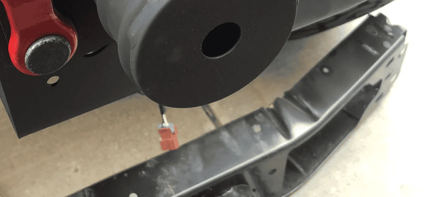

Plastic -
Jeep Gladiator What the heck is this?  Is this real?  Aluminum Rubicon 3 piece bumper... 20201013_155411_HDR
And here's the steel that's inside of that plastic (laying on the floor) - about the same as no bumper in anything over a couple miles an hour, other than the crush cans.
The way it's formed, it's already ready to bend and collapse. I bet you could kick the end of that bumper back.
