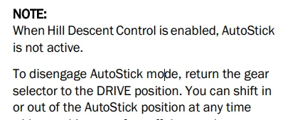

OK, remove the suspense...
Where did you find THAT?
In this -
Jeep Gladiator What to expect with Hill Descent? owner-manual
I saw what you wrote about the JT not having it - but was sure I'd read something about it in the owner manual. So I did a search and found that bit. However, that's the only place the word "descent" is present in the book!
I thought - I KNOW I'd read about it when reading about what they say about towing and manually shifting - and sure enough, there it was. But that's the only instance.
So - either it was supposed to have it and they ended up not putting it in the truck - or whatever.

In this -
Newer versions of the manual don't mention it.
Probably a misprint.
Yes, otherwise there'd be a section on it. Could be they planned on calling the other feature by a different name, could be they at one point considered such a feature. Since it's so very specific, it's not just a typo - makes one wonder what the intent might have been. In the end, what we got is great so it doesn't matter.
That's also not the original version of the 2020 manual so they left it in there through a few revs.
Anyway, just found it interesting that the very specific wording even existed in there.
It sort of proves that one should always go by the latest version that applies to their model year truck. Keep current. Mistakes in books happen.
