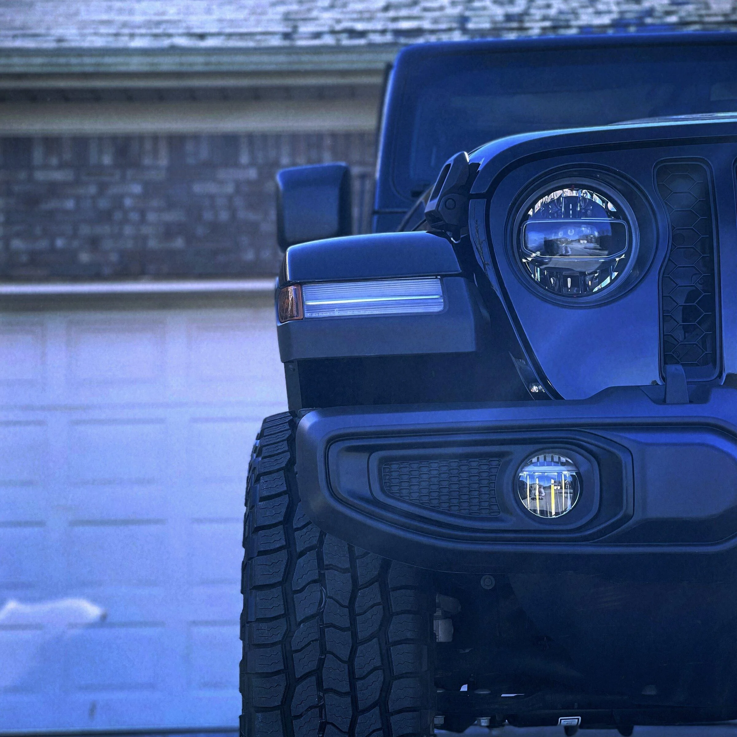

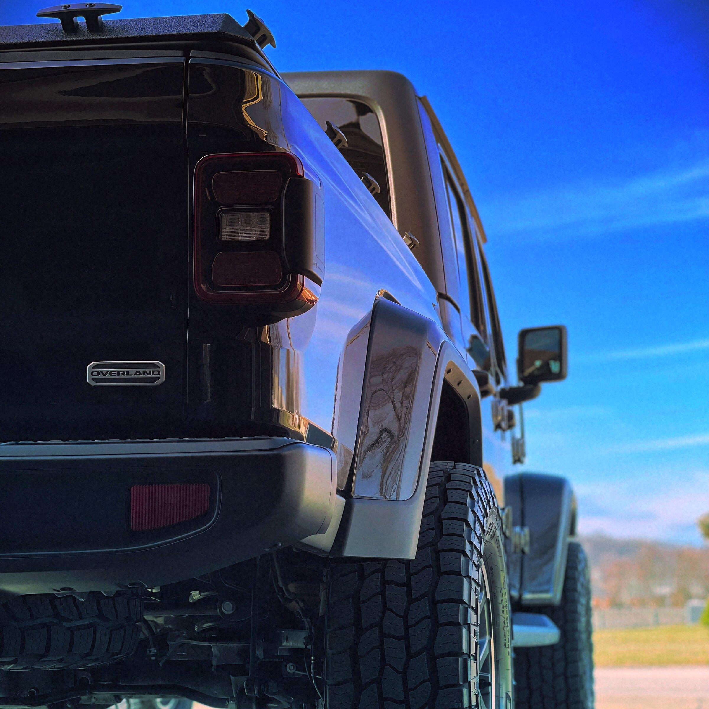

I run teraflex 1.75s and love them. I mainly did it cause I kept the stock Overland wheel which is the best stock wheel of any trim in my opinion. However As most stock, they sat flush with the fender even after bigger tires and I wanted a little poke. I haven’t had any issues. In my opinion it isn’t any difference than running an aftermarket wheel with the same backspacing. I’ve even taken it off-roading with spacers and no issues.
Jeep Gladiator Wheel Spacers - Pros/Cons? 9C95628F-CB5F-4FCA-AC19-85CB48820B68
Jeep Gladiator Wheel Spacers - Pros/Cons? EFE4739F-5A34-4B48-B296-54A4C94E18F3
