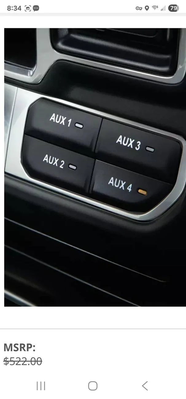

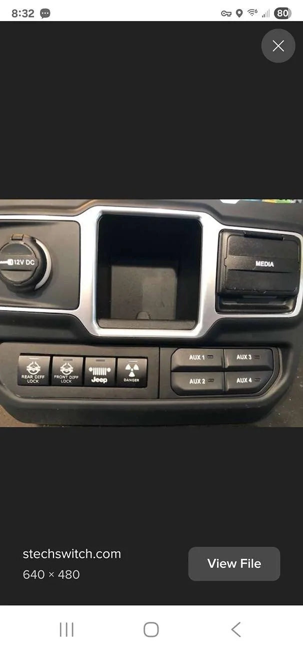

Jeep Gladiator Which Aux switch set to buy? Screenshot_20250629_083456_Samsung Internet
Jeep Gladiator Which Aux switch set to buy? Screenshot_20250629_083232_Samsung Internet
The top photo is OEM and the bottom photo is S-Tech. Not my photos, but it does show how the S-Tech panel compares to the OEM panel.
