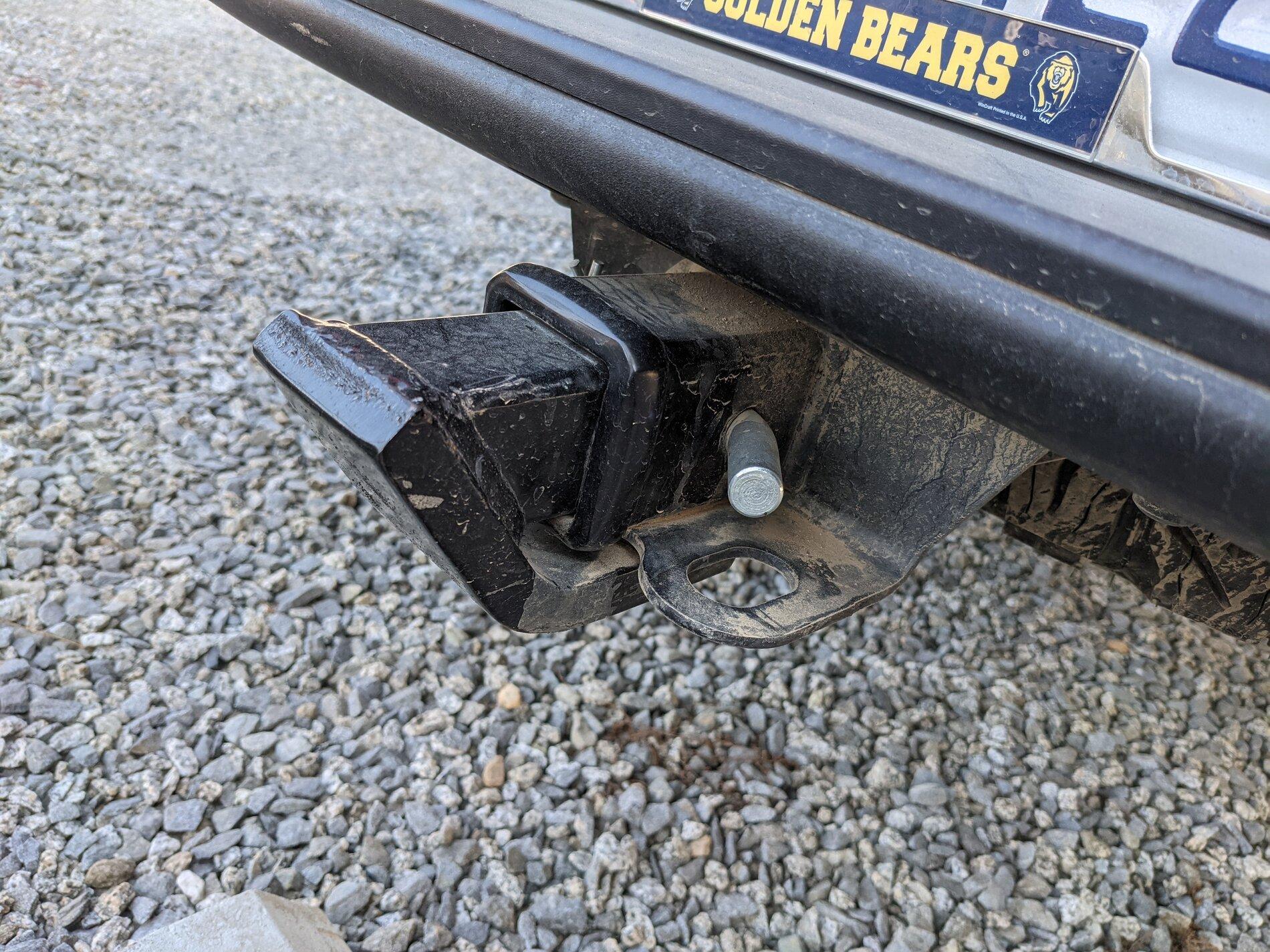

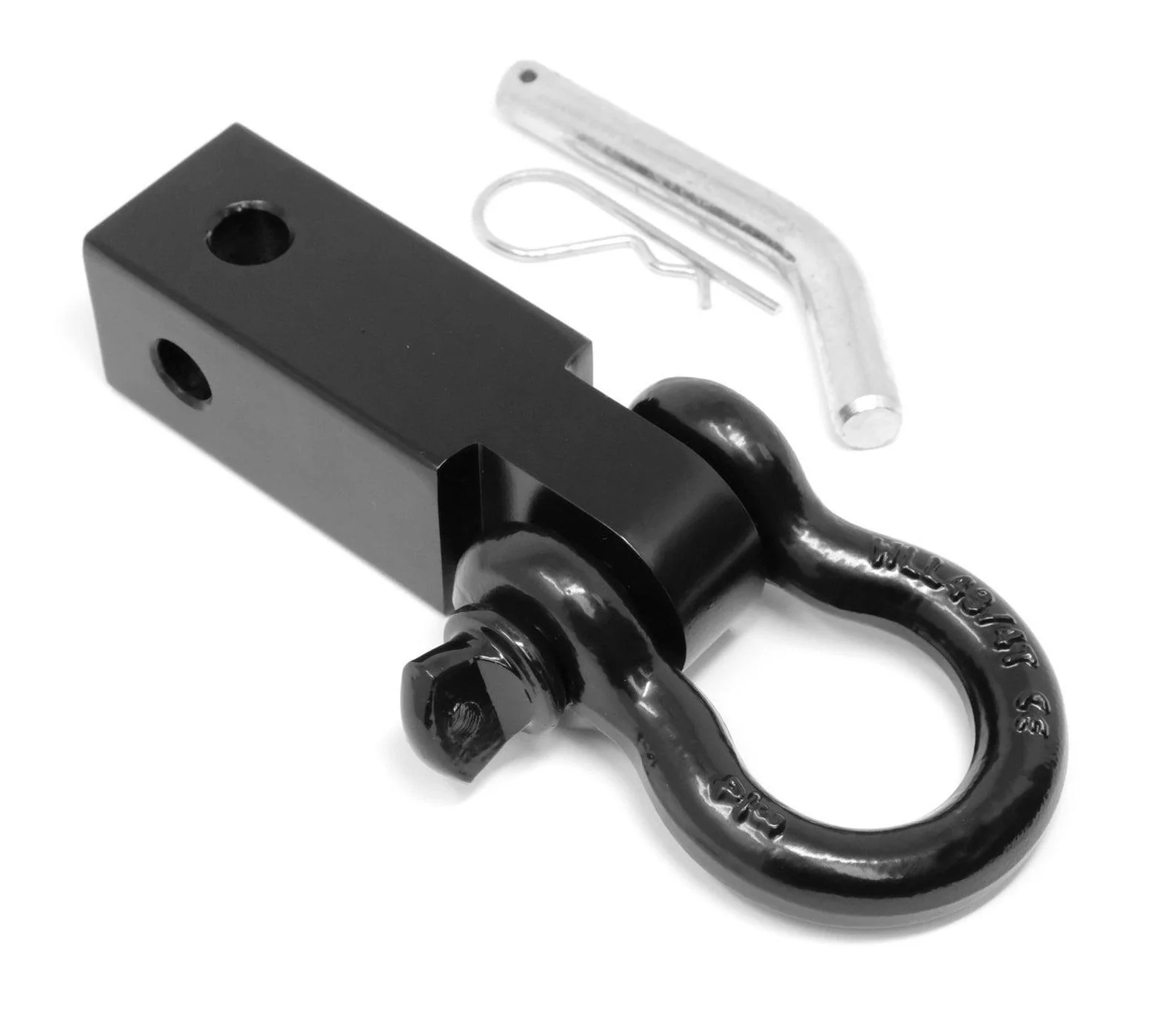

Having driven a pickup offroad for over fifteen years, prior to picking up a JTR, using your receiver hitch as a skidplate isn't a good idea. Beating up the safety chain loops isn't a good idea. Grinding down the lip of the insert hole isn't a good idea.
I ran and do run a clevis insert on a number of 4x4's, Ford's, Jeep's and Hummer's inclusively. PIckups drag ass off-road, there are different solutions to address tearing up your hitch, and good for you for not caring, but that's not everyone.
Nor is every solution to the issue a giant loss of departure angle or clearance.
Jeep Gladiator Which hitch skid plate? PXL_20201130_222159044
I agree 100%.
That box section on most receivers is doubled up for the last inch or so. You will NEVER collapse or damage it.
Putting a skid plate on it only makes it more likely to drag. Its a solution in search of a problem.
If you are afraid of collapsing the box section buy a shackle that goes into the hitch and leave it at that.

Where can this be found? I like the idea of this one…
brianinca
Brian
Jun 8, 2020
1,328
1,374
USA
IT Manager
It is nothing but an inexpensive 2" drop receiver from Harbor Freight. It was $10 at the time, June '20, last I saw the pandemic inflation kicked it up to $15. I saw this on a Taco several years ago and thought "DAMNED good idea!" I used to have a Ranger and I used a Clevis insert, this is better and I knew it when I saw it. Just had to wait for Jeep to bring back a pickup.
Jeep buddy at work handed the insert to a fabricator, cut the drop tongue off, flip the square and weld it back on reversed. He understood exactly what I wanted when I walked into his office. We have a shop full of perfectionists so it came out REAL nice.
Whatever the cost to have a welding/machine shop do this is worth it to me, maybe $50? The minimal loss of ground clearance and departure angle makes it better for my purposes than a Clevis insert given how much more protection I get.
Guerillah
David
Jan 24, 2021
47
TUCSON, AZ
4Runner
I see! Awesome idea.
Basically, buy this:https://www.harborfreight.com/ball-mount-hitch-with-2-inch-drop-94902.html
Cut off the drop part, flip it, and weld it back on.
