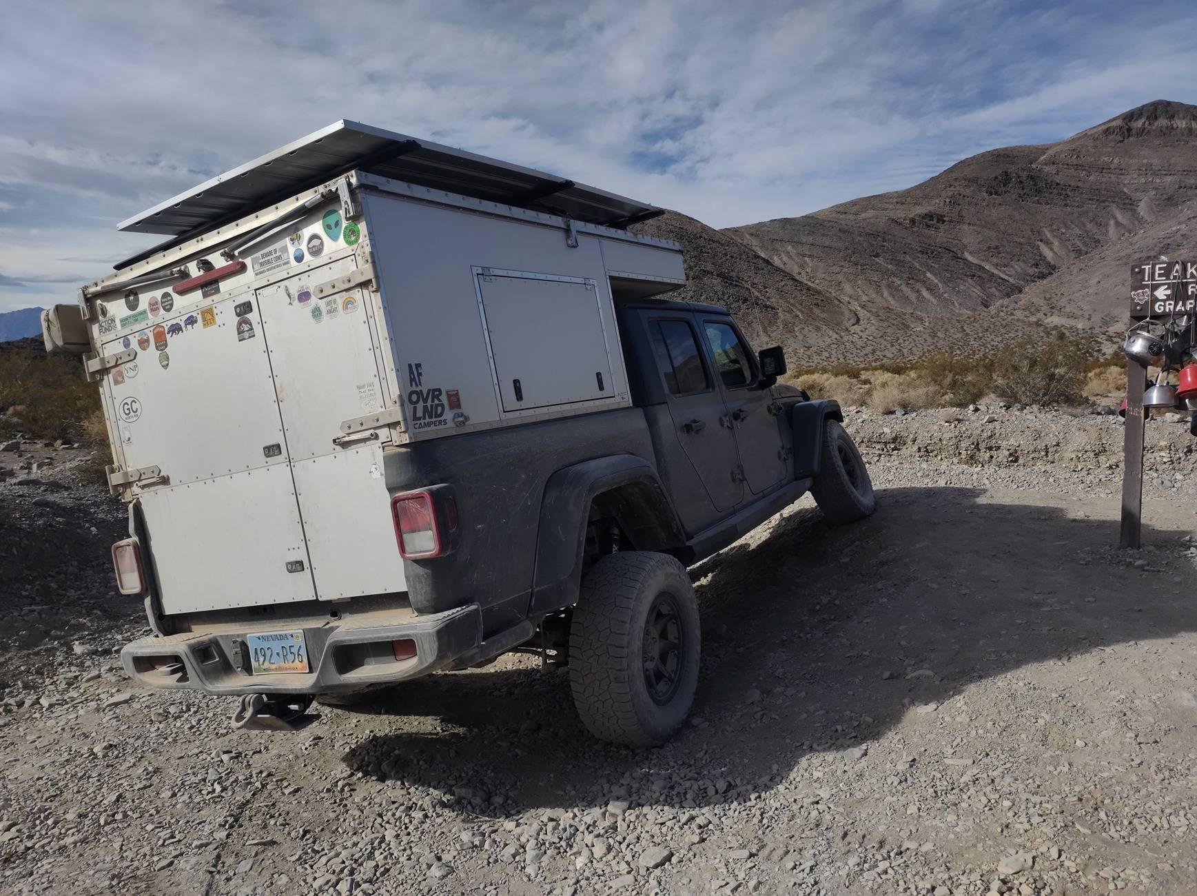

Wow, that was definitely tested. Lol
We started calling it "Sound the ground alarm", as it makes a horrible screeching sound when it slides down that sandstone. Lol

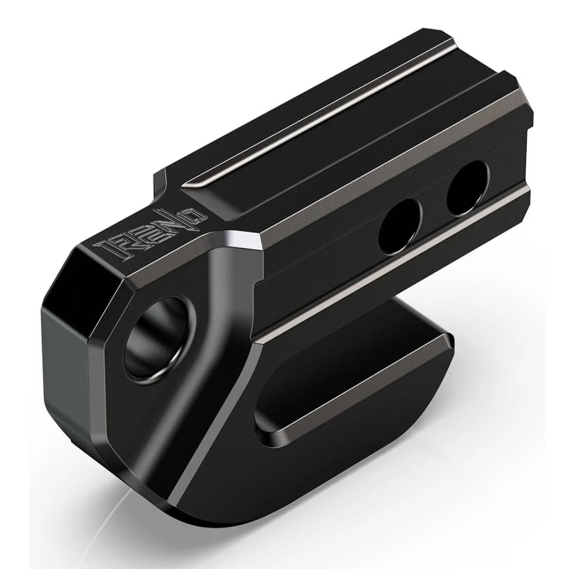

I actually have not bought one yet. I have a short drop trailer hitch that has worked perfectly. First time I hit it, I was a little alarmed and then realized it saved my bumper and now put it in for each off road excursion I take. Would be nice if it was wider, but it has worked well so far. I also have several hitches so I am not worried about damaging it in any way. My father in law welds his own hitches so they are very thick metal and really over engineered!

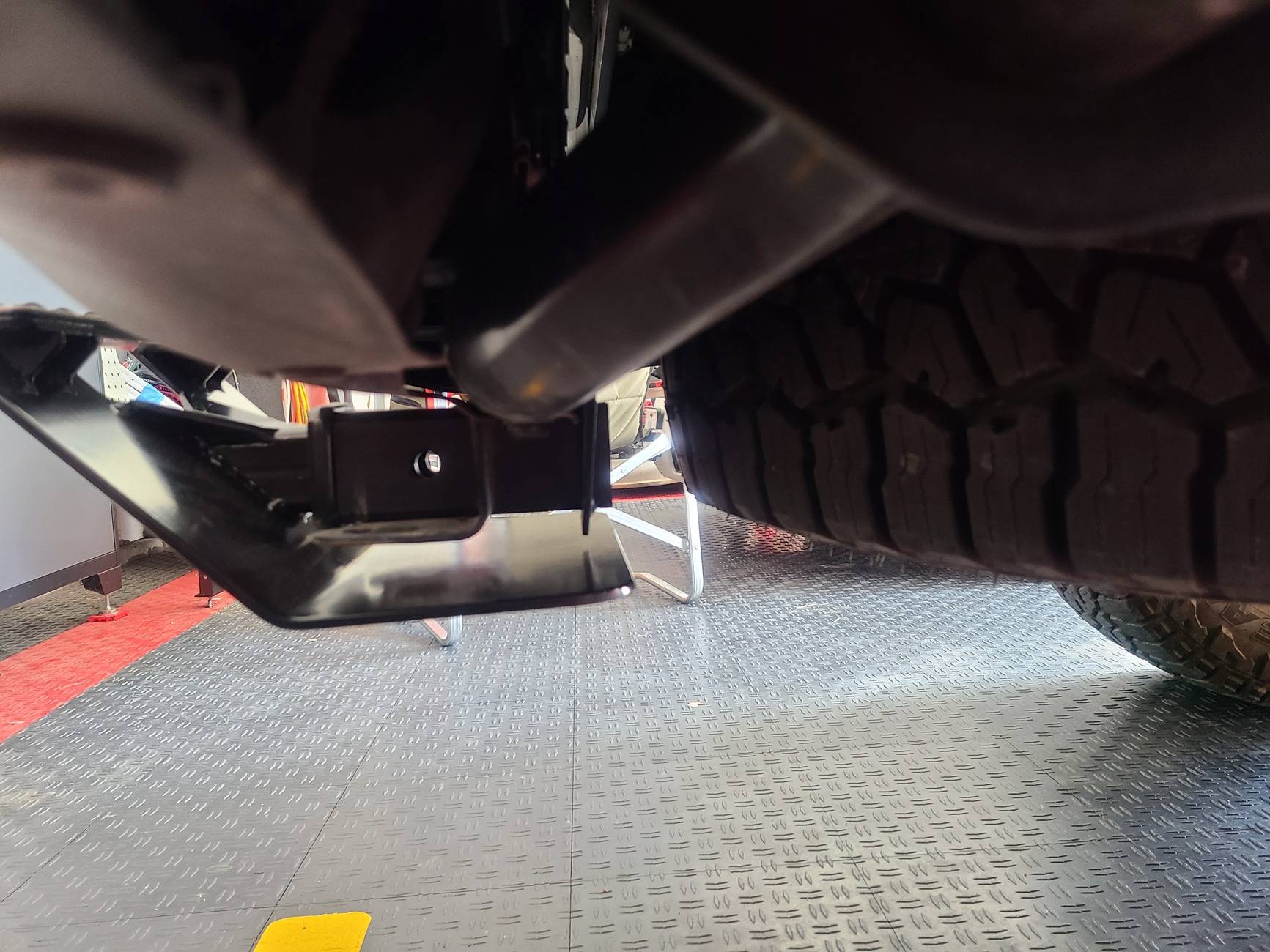

I went with number three Warfab Sheridan biggest differences are it is not a step but it also protects your safety chain attachment plate which can get destroyed, and is a solid shackle attachment point. I can not leave things alone and cut mine down a bit to be only 1/4” below chains. Which gives more clearance but on flip side it might allow bumper get hit more as it does not drag as soon …..Jack
This is why I do not have one yet. Yes they protect your hitch but then stick down so low below your hitch that you might not have ever hit except for the fact that now you have 1" less clearance.

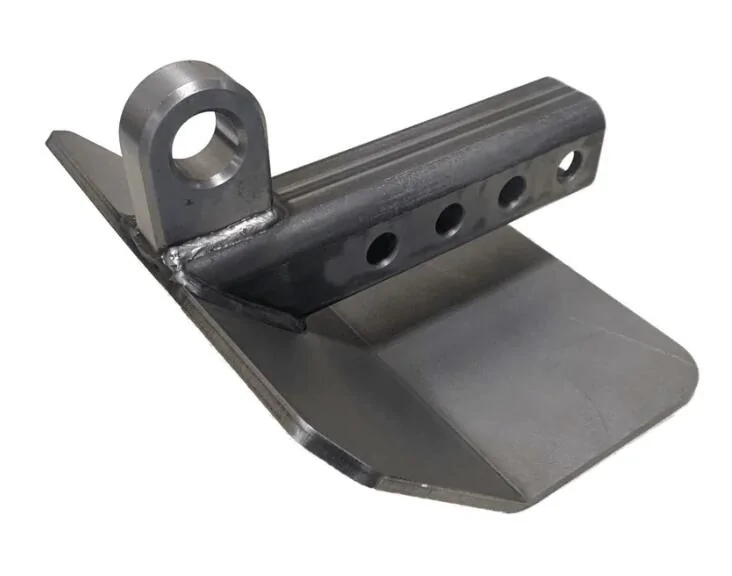

What type hitch skid is your choice, why?

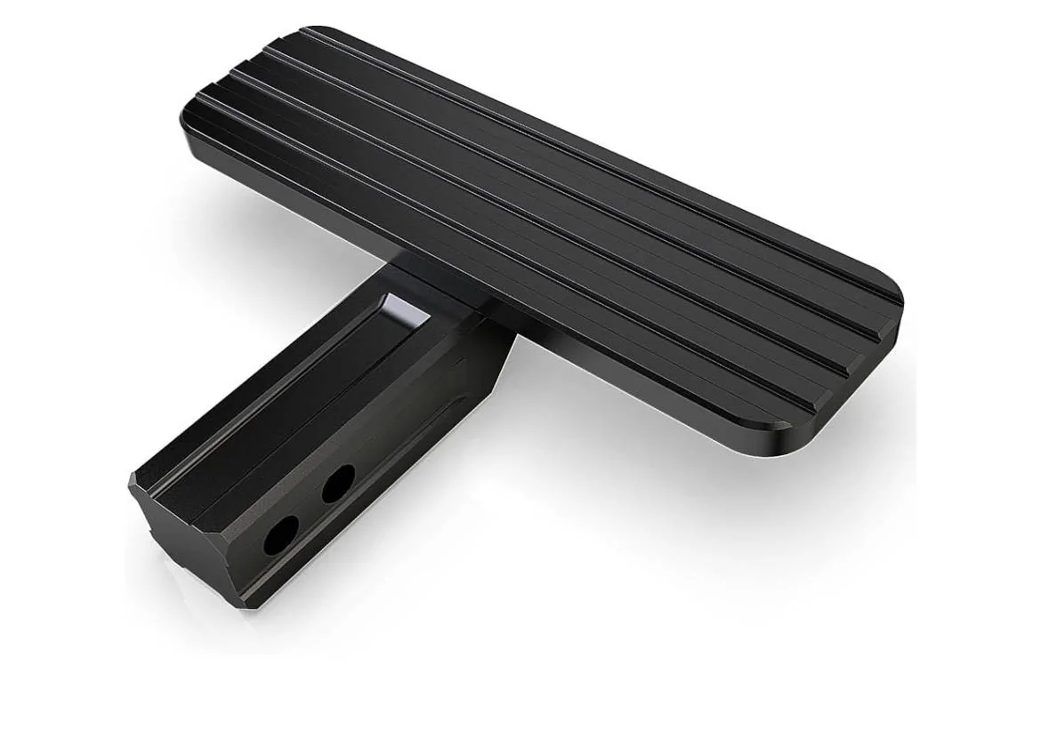

I am trying to decide which one would be best to protect the bumper. A step is nice, but the bumper has an area built in that can be used as a step. A simple skid seems like it limits protection.
#1. Simple Skid
#2. Step Skid/Simple Skid
#3. Skid Plate with integrated step
Your number three is the warfab Sheridan short. It’s built like a tone of bricks. I can’t recommend it highly enough.

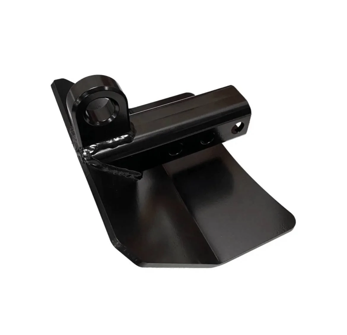

I've got a warfab as well. I like the fact I can attach a shackle to it.
And it’s got soft edges for soft shackles. I’ve tested it for real many times.
