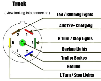

In my opinion charging through the rear trailer connector has a lot of wire to the battery and a charger's sensing circuitry may not give an accurate charge. I think the pins labeled charge are for charging the trailer battery from the truck while driving.

Hi everyone. I'm trying to find a better way to put a maintainer on my battery whenever I leave my truck for extended periods. Right now I have to open the hood and clip on to the posts each time, and I do it frequently enough that I'm hoping to find a better way.
The way I park in the garage, I would love it if I could connect the trickle charger at the rear of the truck instead of the front. This has led me to think about using the 7-pin trailer connector in some way to feed current to the battery since it has both +12v and ground connections. It would be the most convenient and the cleanest solution. I get conflicting information on if this is do-able when I look into the question, so I figure I'd ask here and see if anyone had some practical knowledge about how this would work on a Gladiator.
I know there are some considerations here I need to be aware of, such as the run of the wiring from the 7-pin to the battery (and the expected loss over said run), how it's pathed and fused back to the battery, and how this would affect maintaining both the main and aux batteries. If anyone has some insight on this, I would really appreciate it. Just trying to cover my bases before I do my own trial-and-error setups.

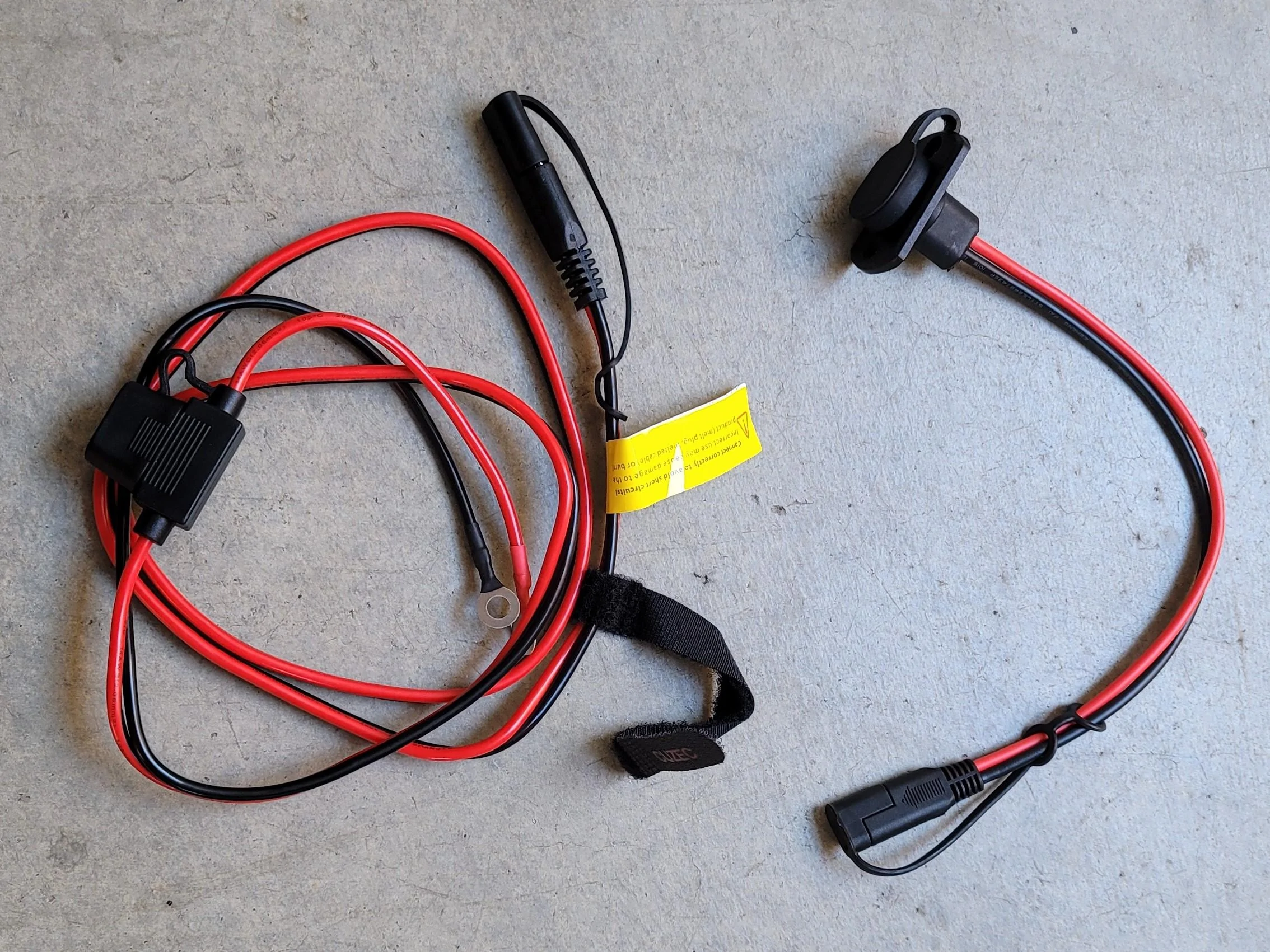

So here's what I ended up doing. I drilled a hole to the right of the license plate, and mounted a marine quality 12v socket there. I tapped that socket into the wires feeding the 7-pin plug, routed the wire, and taped everything off. I also retrofitted a male cig adapter onto the end of the trickle charger cable, and viola. The result is a socket that I can use to maintain the battery, but also use to power 12v accessories from the truck. Plus, if I drive off on accident, the charger end will just pop out of the socket.
Jeep Gladiator Trickle Charger Through 7-Pin Connector 1662947206090
Jeep Gladiator Trickle Charger Through 7-Pin Connector 1662947030863
Jeep Gladiator Trickle Charger Through 7-Pin Connector 1662947149009
The trickle charger is reading the battery just as well as it did clamped directly to it. Obviously you couldn't use this to recover a drained battery, but to maintain it, it's working just fine.
