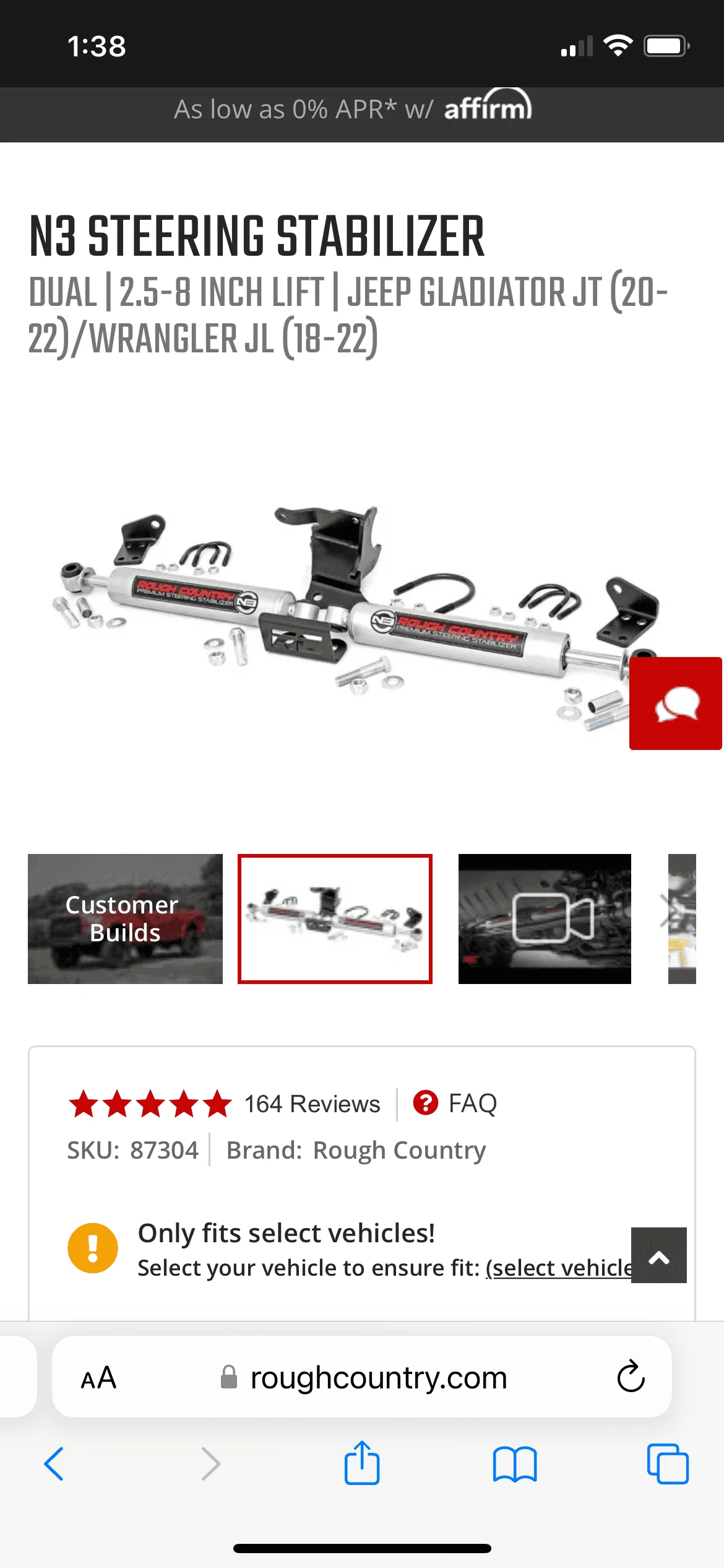

I don’t mind the price difference in the fox, but part of me thinks “ if one is good, two is better”.
No to the dual stabilizers unless that is a look you are wanting.

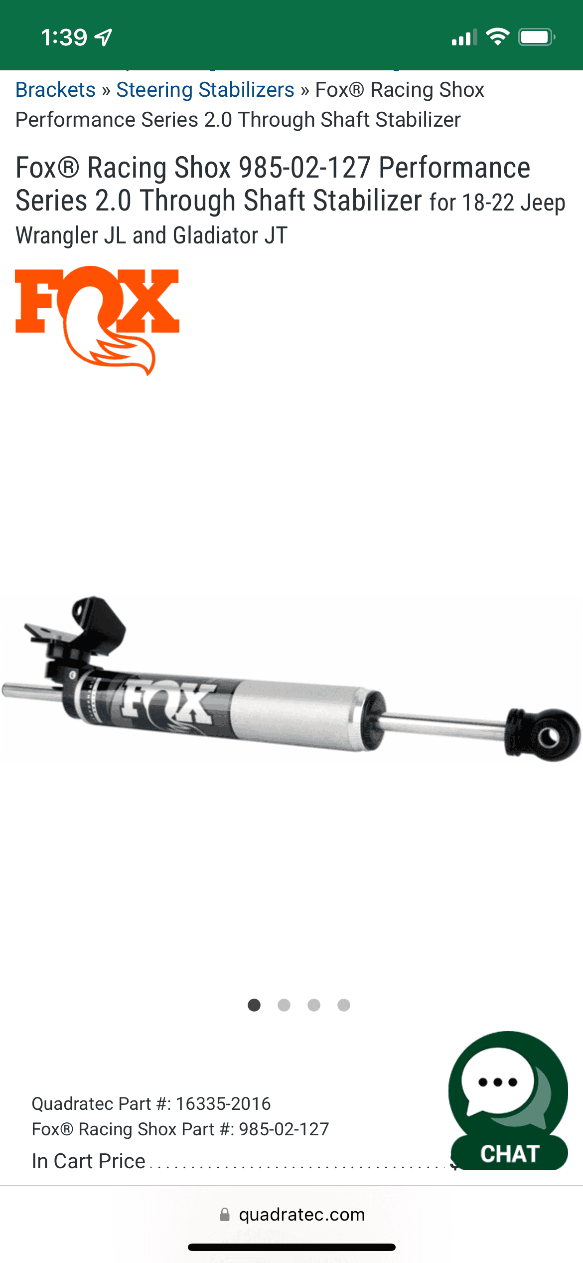

The through type stabilizers are very popular because they allow even gas pressure loading on either side of the piston. It make it a very neutral feeling stabilizer, no difference in feel between the left or right side.

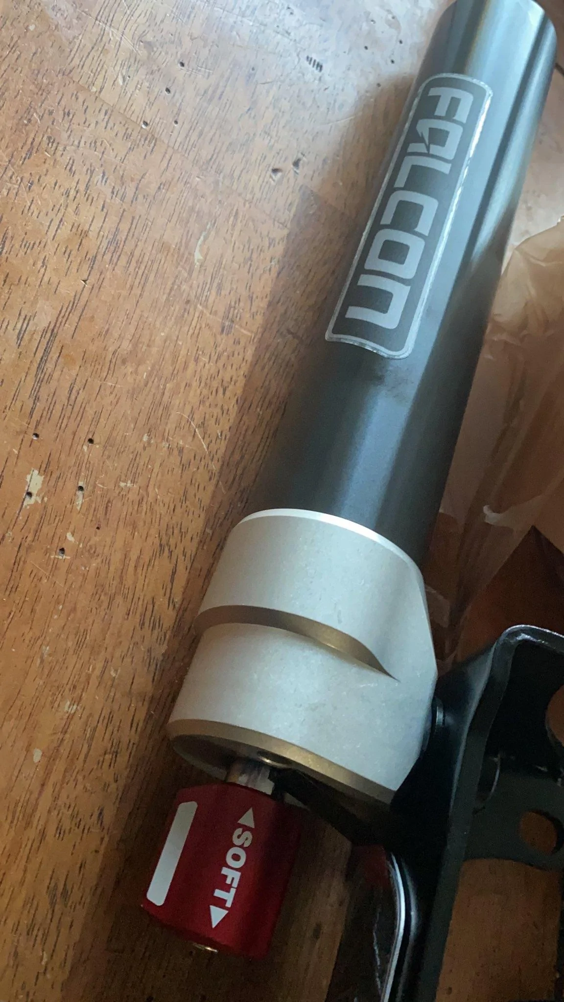

On the TeraFlex Falcon stabilizer, go with the JK stabilizer, it has the eye style end like the Fox stabilizer and will work better with aftermarket track bar brackets.
The Falcon Nexus 2.2 Adjustable allows you to adjust the stabilizer for firm, medium or soft, but it does cost a little more than the

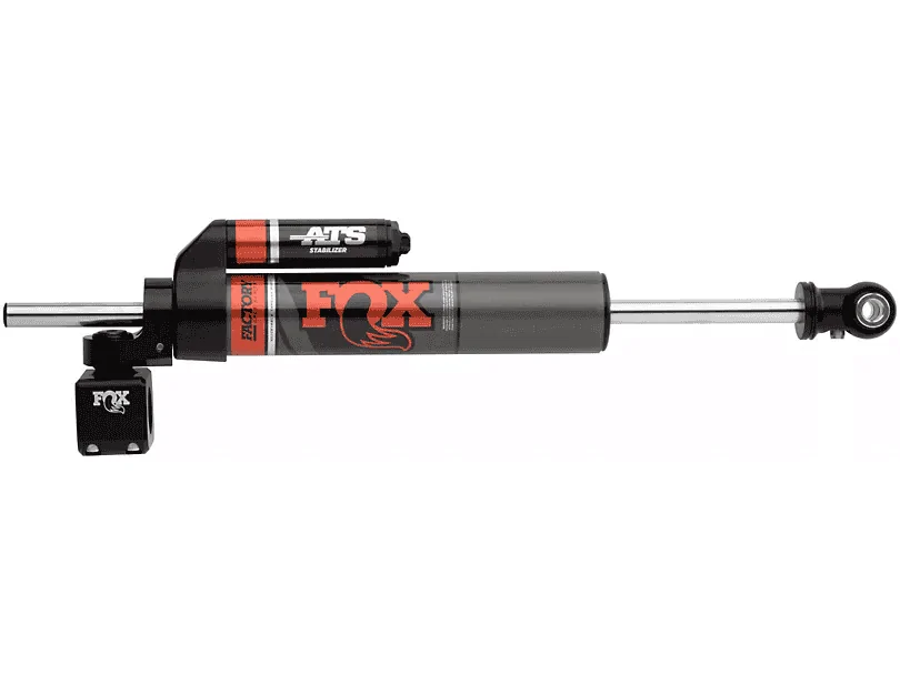

If you're changing it and it's not an adjustable one, I don't think it's worth it. Get the orange Fox ATS Factory one, not the basic grey one.

I just have the regular Fox stabilizer, not the through shaft. It works fine. No issues. Slight improvement from stock.

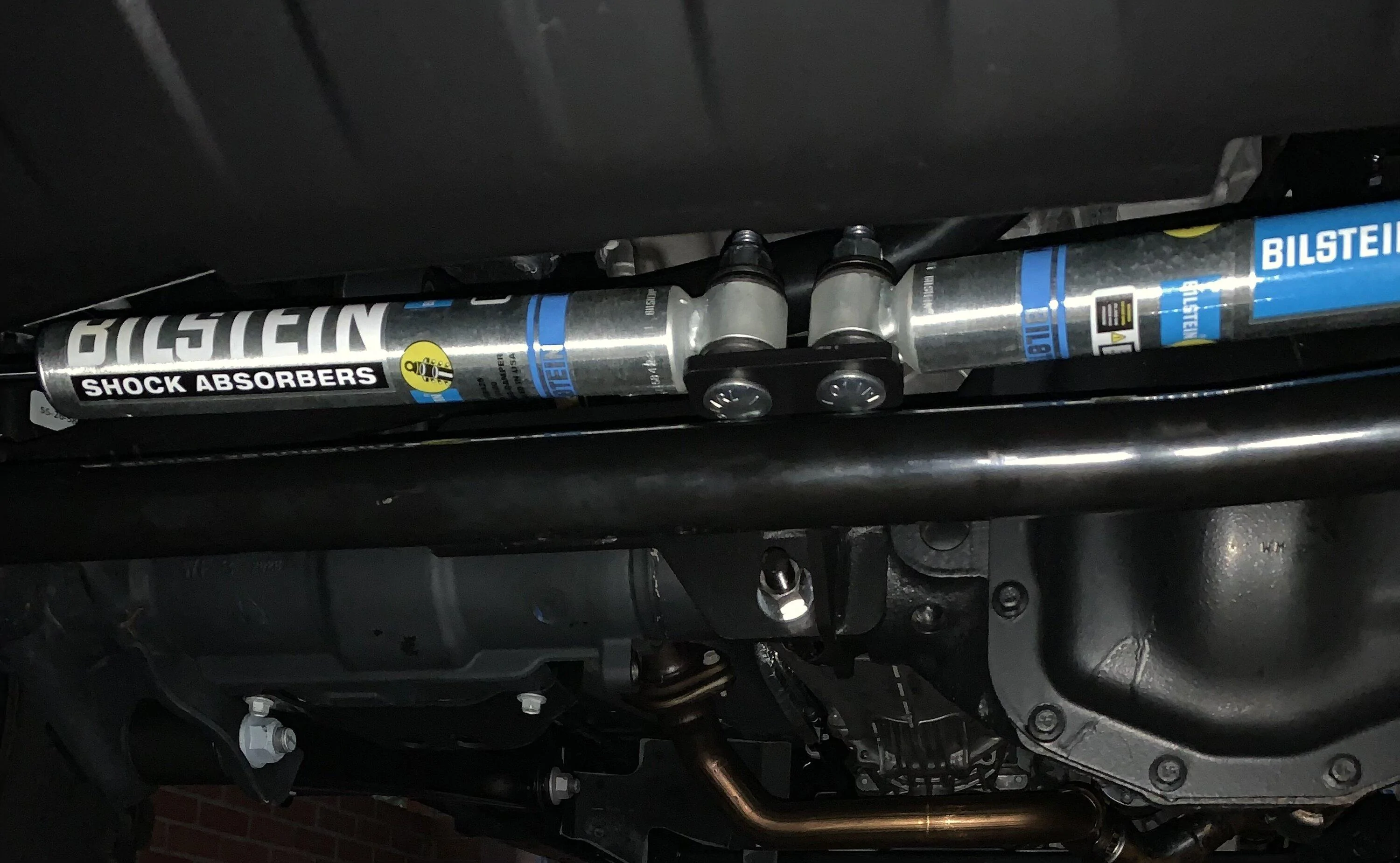

Dual Bilsteins by Superlift

I am running the FACTORY OEM steering stabilizer and have no complaints. I bought the fox 2.0 through shaft, but wanted to get a feel for the factory one felt like before swapping. I no longer feel like I need to change anything. Sent it back for a full refund.
