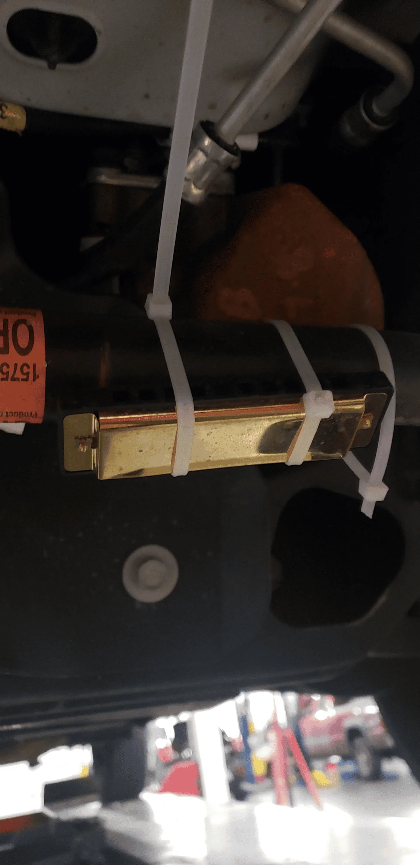

Customer states........
Harmonica zip tied to car.
Jeep Gladiator Whistle when accelerating 1668136055401
