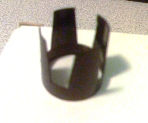

Cellphone chargers/GPS’S (at least for a time) were too loose for real cigarette lighter sockets. They’d pop-out on their own. Many chargers came with a ‘shim’ to take-up the slop. I was driving German cars years back. Maybe that had something to do with it..
Jeep Gladiator Why cigarette lighter and not 12v DC??? shim
