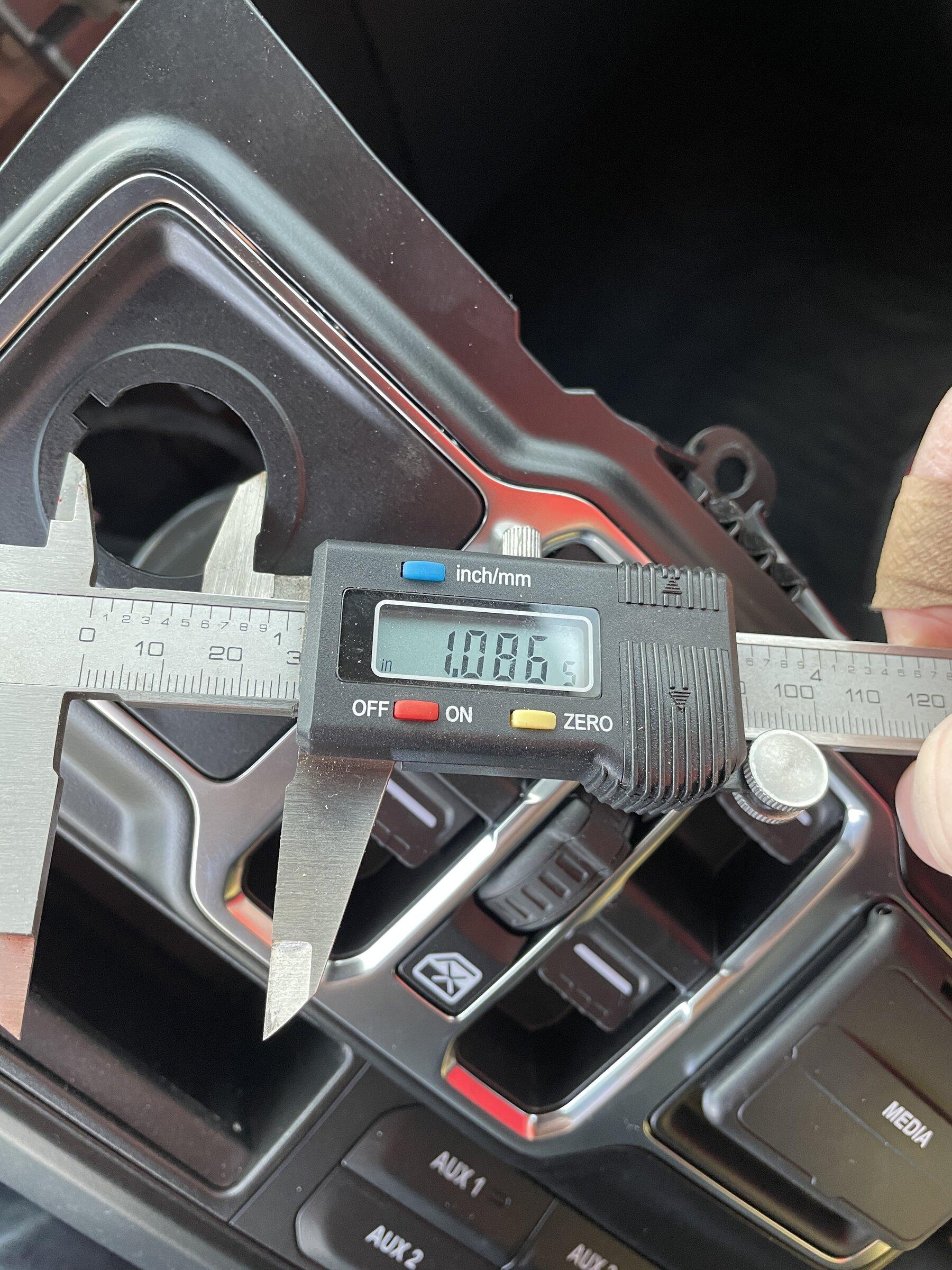

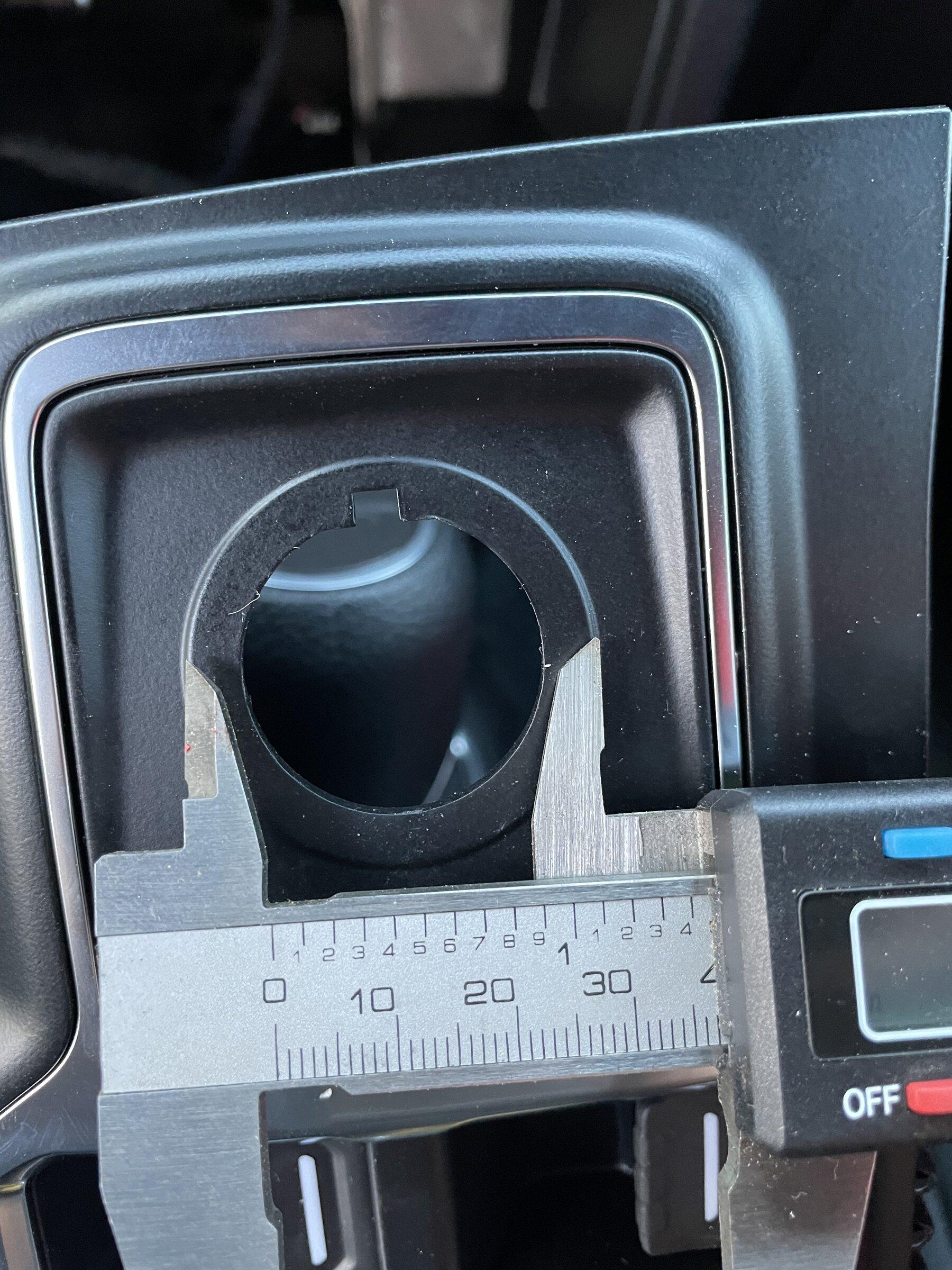

Dunno about a solid blank, but I'm sure you could make one. I put my redarc controller in there.

Thanks guys for the feedback. I appreciate the dimensions pics and the video link. I thought about trying to find some sort of round rocker switch to slip into the cig lighter hole, but haven't come up with anything yet. I'll keep looking.
