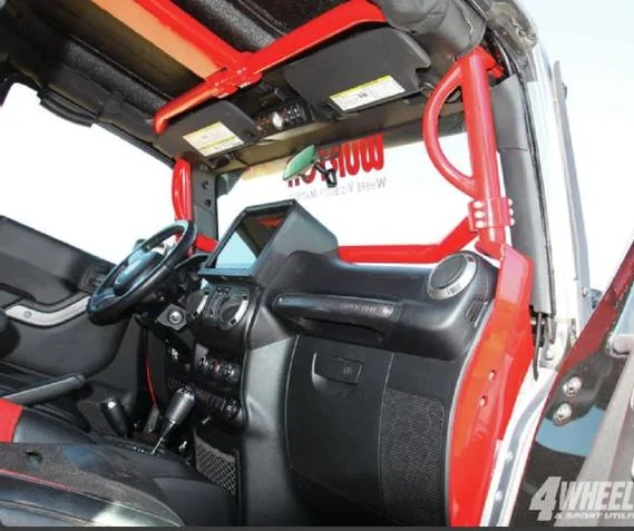

It's probably unnecessary for most users, but if you do really wheel hard and do really roll hard, it's important. Especially for a bolt-on cage that still ties into the body sheet metal. A really hard flop, or multiple rolls could compress the dash structure, thereby weakening the rest of the cage.
The bolt-on versions really impede visibility, and most people running a bolt-on cage probably aren't going into extreme enough positions to need it.

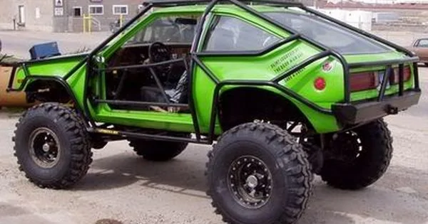

I built this cage on my old crawler several years ago and wanted to keep visibility impacts to a minimum. It required cutting the dash, but it was a toy so I didn't mind. This cage was tied to the frame at all six points as well.

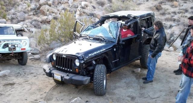

So from what Ive read, its an additional structural piece of a kit that is to strengthen the existing factory cage.... It is also able to be used as a mount for iPads and phones..... and unless your TommyGP that rolled his jeep because he is truly doing extreme Jeep stuff....... this is probably more of a status and looks cool / tuff mod, possibly installed on a mall crawler.

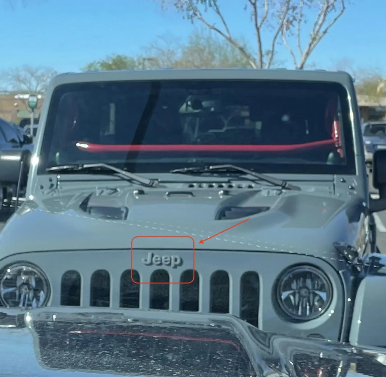

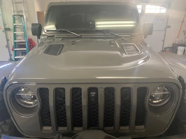

Below is the original picture I posted and one I just took of my 2020 Gladiator Rubicon hood.
NOW.... this is just for fun but,
As we can see the first picture appears to be a modern Rubicon hood that looks identical to mine.
But under closer examination I found that the one with a roll bar... assuming its a Wrangler does have the JEEP logo and we don't.... WHY?
Is it all about that larger, wider spaced grill for more cooling stuff?
Second and I might be wrong but as I look at the side of the hood on the roll bar one... I can see the reflection without obstructions... meaning if there was / is a Rubicon sticker on the hood wouldn't it not show the reflection? So is this a Wrangler? Is it a Rubicon? Is there a sticker or not and was this hood offered on something that is NOT a Rubicon? Like I said just for fun, I was just wondering if anyone else saw this.

It's a JK with an Anniversary Edition hood.

The Rock Hard Sport Cage add ons were more functional for JKs, which lacked some of the forward structure that exists in the JT/JL. I dislike the color contrast, but that stuff can be valuable in the right application, and it’s cheaper than custom fabrication. There’s more to it than just the dash crossbar
Can always paint it to match the exterior if desired. The JT is pretty strong up top/front, unlike the poor fellow in the other post - ouch. Hope he was ok, but the poor Jeep......... wow. That JK could have benefited for sure. That's a case of definitely landed WRONG.

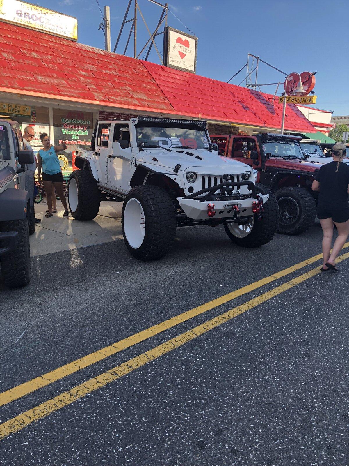

I spent many years wrenching on other folks' motorcycles. What passes for custom and art for one ethnic group is incomprehensible to another. That white thing is the Jeep equivalent.
