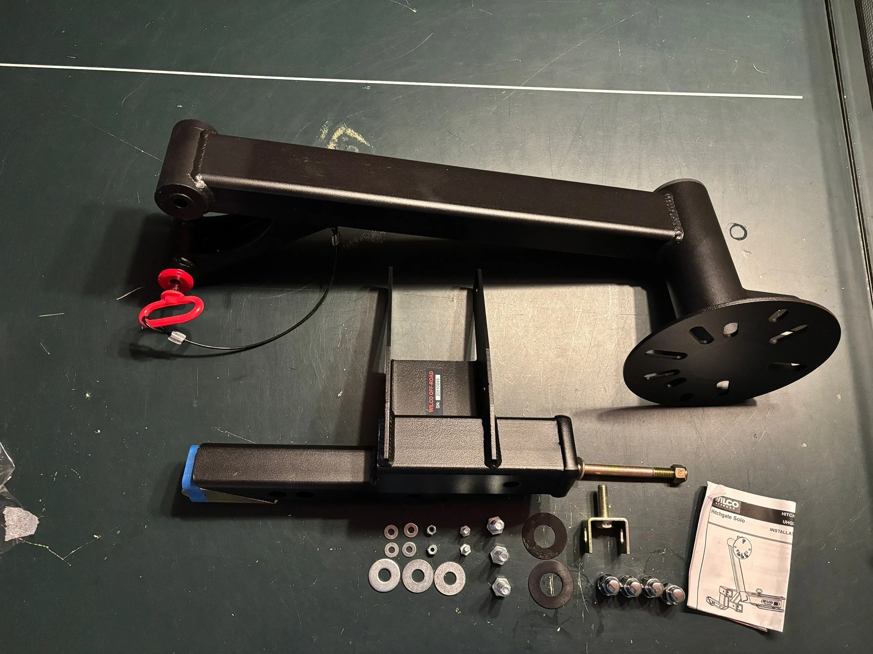

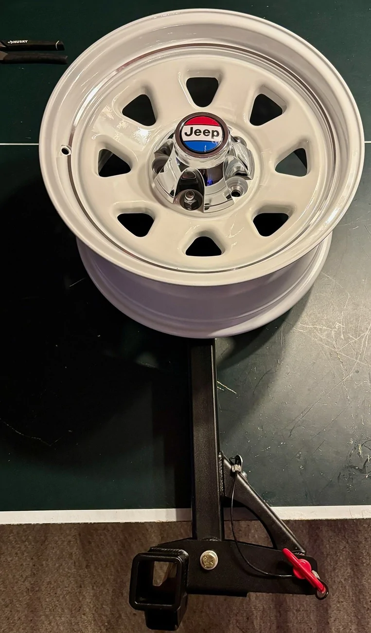

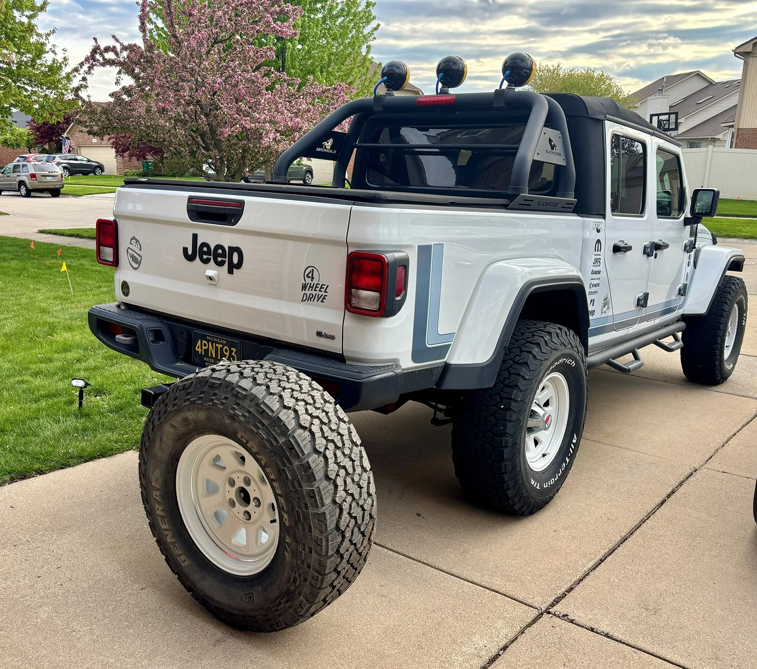

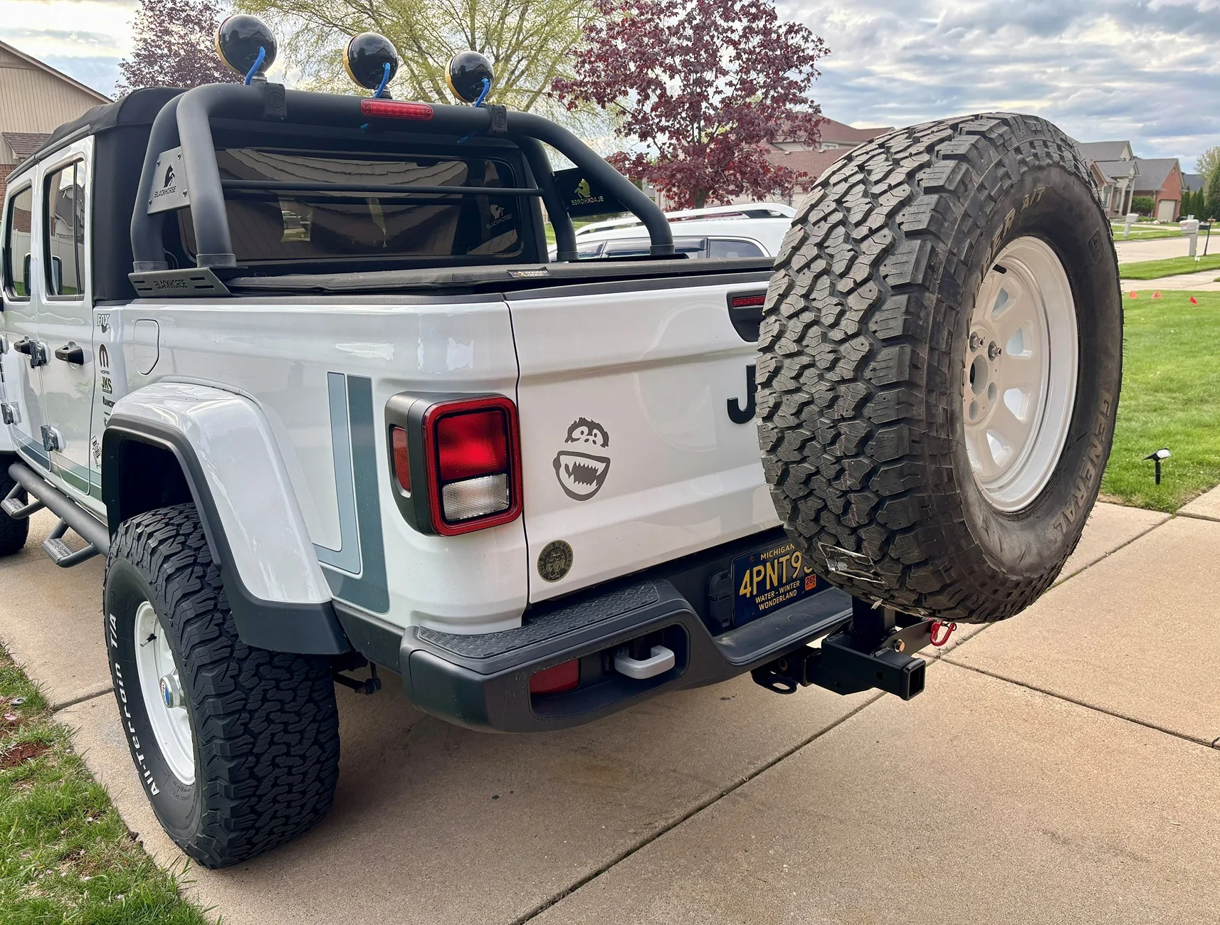

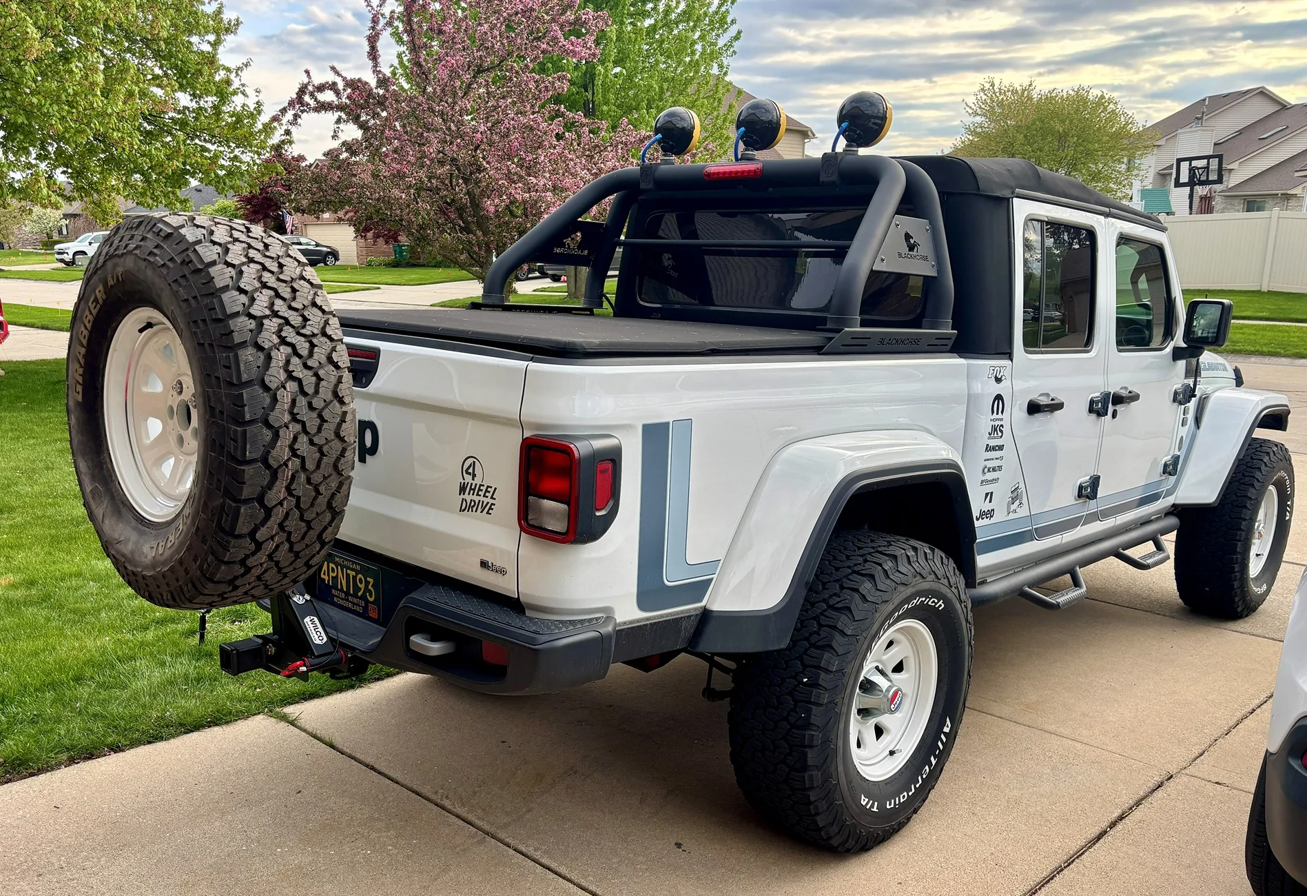

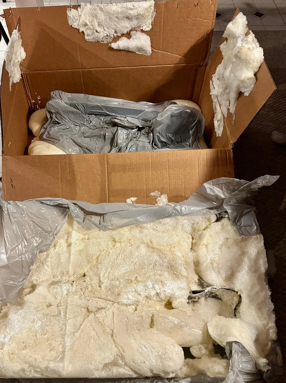

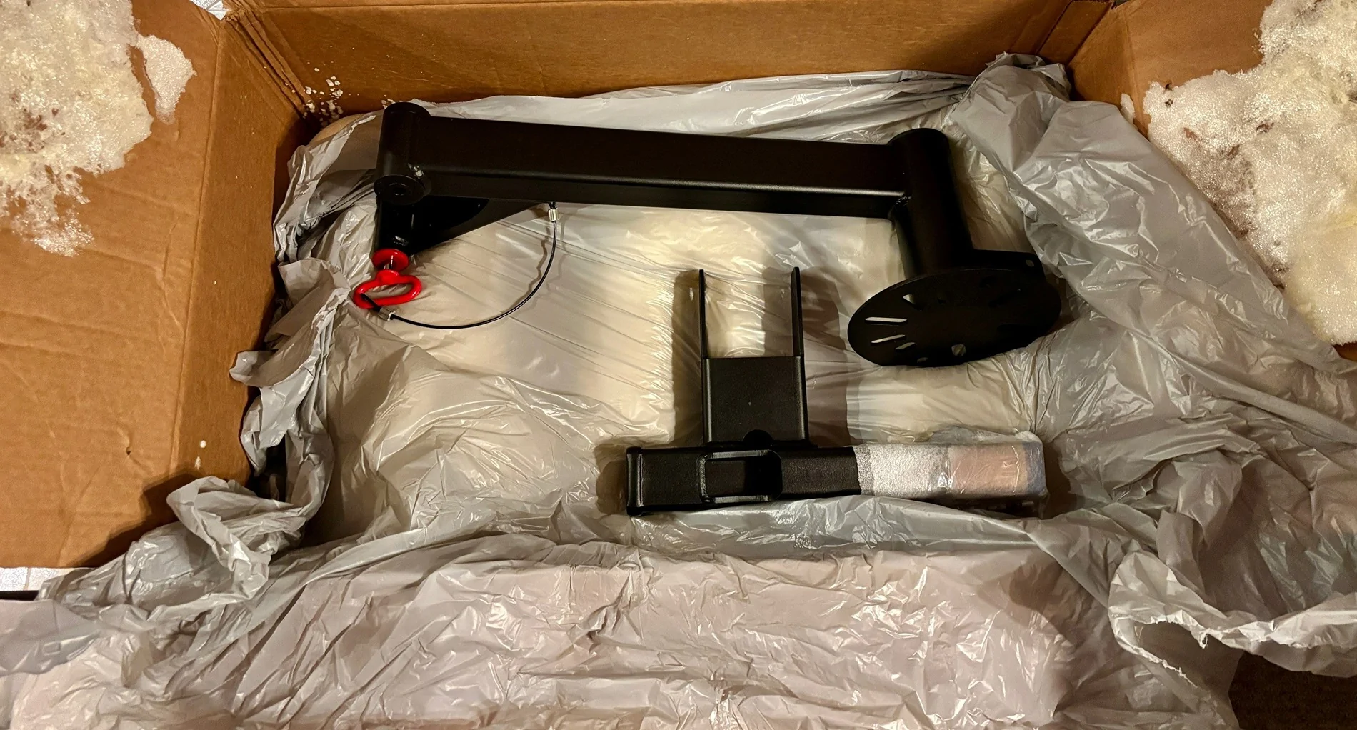

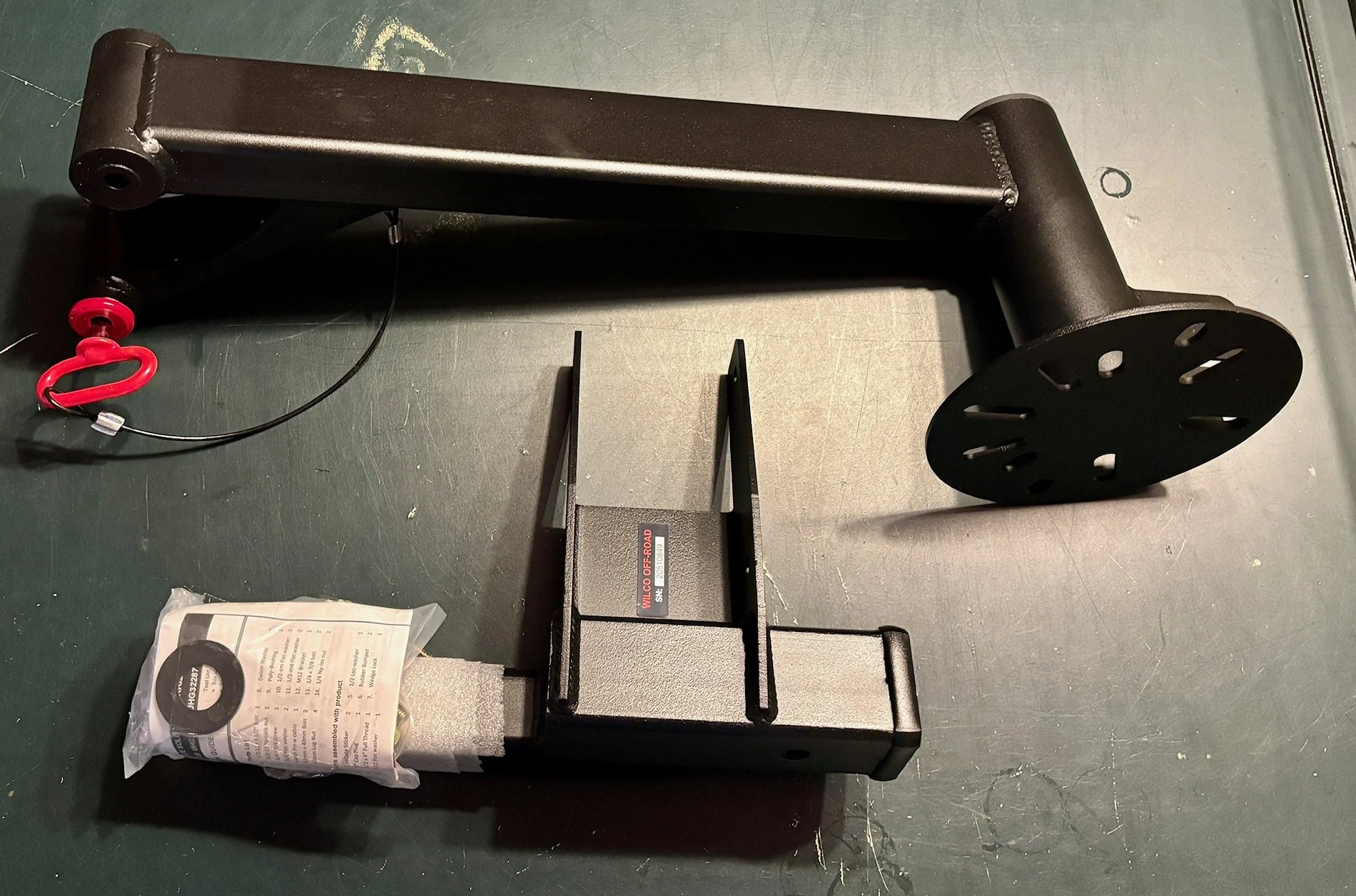

No idea on how I posted this in the classified section. But it got deleted, so let me post it again with updates
Got it unboxed, got my extra Q tech retro wheel and center cap this past weekend.
Did a quick test fit using the 35" Grabber spare i had under the truck. I was going to purchase a 37" matching BFG, but not so sure now. Might just keep the 35". The tailgate opens just fine with the tire in the down position, but it contacts the tailgate by about 1" before being complete flat and open.
There are 2 holes in the receiver that sets the depth closer or farther to the bumper. This one was with it farther away. I think I could get it closer to the bumper but it might put the cotter pin that you pull to pull to lower the unit under the bumper which might be a pain to get to.
I do like the wedge lock feature which makes its 100% rattle and movement free into the trailer hitch.
Ran out of time. So will tinker with it tomorrow and install the center cap and clean the tire up and go from there.
I like it. Don't necessarily love it, but think it will serve its purpose. Don't care about losing the back up camera as I never use it anyways. Still on the fence about getting the license plate relocation bracket.
More to follow when its done.

AWESOME!! I was rooting for you to get it. Looks great and fits build. Is this the closest it gets to tailgate ? Looks great with softop,roll bar. BTW i think its 12 inch extension i believe is needed for that bolt. What tools you used ?

This mounting location was the furthest from the tailgate. I can go closer the tailgate / bumper the only issue is the cotter pin to pull the pin out will be located under the bumper which just makes it a tad bit more difficult to pull the pin out to drop the carrier down to the passenger side. But I'll try it tomorrow and see how it works.
The wedge lock uses a 3/4" socket and yes a 12" extension is what I used to lock it down inside the trailer hitch. No wobble and no rattle at all.
Will get more pics tomorrow with the center cap and tire cleaned up and if I can get in closer to the tailgate / bumper, I will do so.
