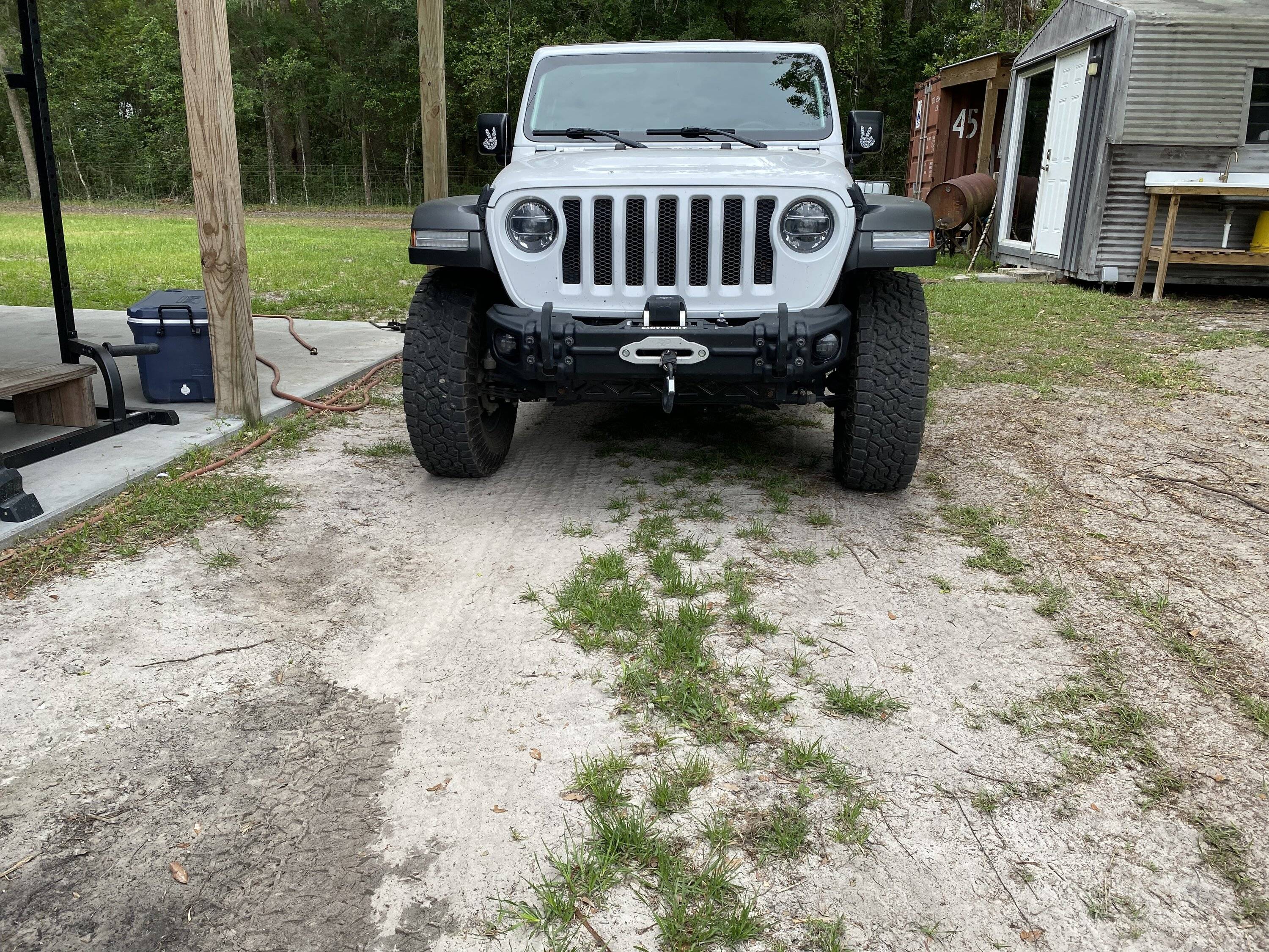

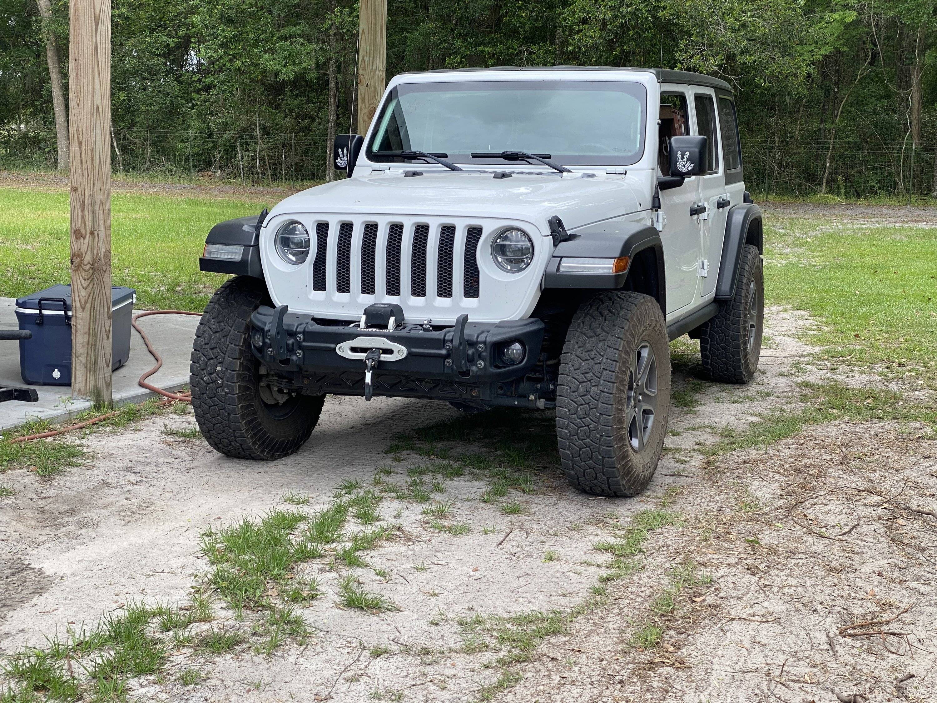

Okay...I'm going to be the unpopular one here and I can't believe I'm going to say the following...
When I made my mind up on getting what I did, it was a JTRD or nothing. I wanted the option and have the intent to do a clean but VERY functional build. There were too many options on the vehicle I found that were must haves, several I didn't want, and we were on the verge of rates going up.
In your initial post you gave some very specific parameters that you were going to have it remain stock with just a minimal increase in tire size. Here it is folks...If I were you, I'd consider the Tacoma or possibly GM Colorado/Canyon. The type of recreational driving you're talking about can be easily done by all 3 manufacturers, but I feel the Toyota would probably be more comfortable, and they have a history of being exceptional vehicles. The Gladiator in my eyes is excellent and can-do somethings better than the others, especially when modified. Your intent of your future vehicle is totally different.
Part of owning a TJ, LJ, KJ, JL and TJ is knowing things will crop up that you'll have to fix or modify. You can do searches though out this forum and others and pick up on the ones that didn't realize this before purchasing and end up pissing and moaning that their vehicle sucks, because of a paint blemish, there's a surface rusted weld, it steers funny...etc. I know sometime down the road I may have a Death-wobble issue. I know I may have leaking axle issues. I know I may have an interior leak issue. Sounds strange, but this is part of the charm of having a point and shoot vehicle, especially when it's built or modified to help provide insurance that I'll get home on that rare occasion that I get to get away. Oh yeah...and modding the JT...I don't think its ever been easier to mod a factory vehicle or be able to mod it this inexpensively. I don't want the feeling of ...well I don't want to go down that trail or attempt something because of what ever. Again, based on YOUR parameters, it doesn't sound that this is the type of vehicle you're looking for. If I had your parameters, I'd go with the Tacoma or 4-runner. My $0.02.
...And if anyone ever says I said this I'll deny it to the grave!

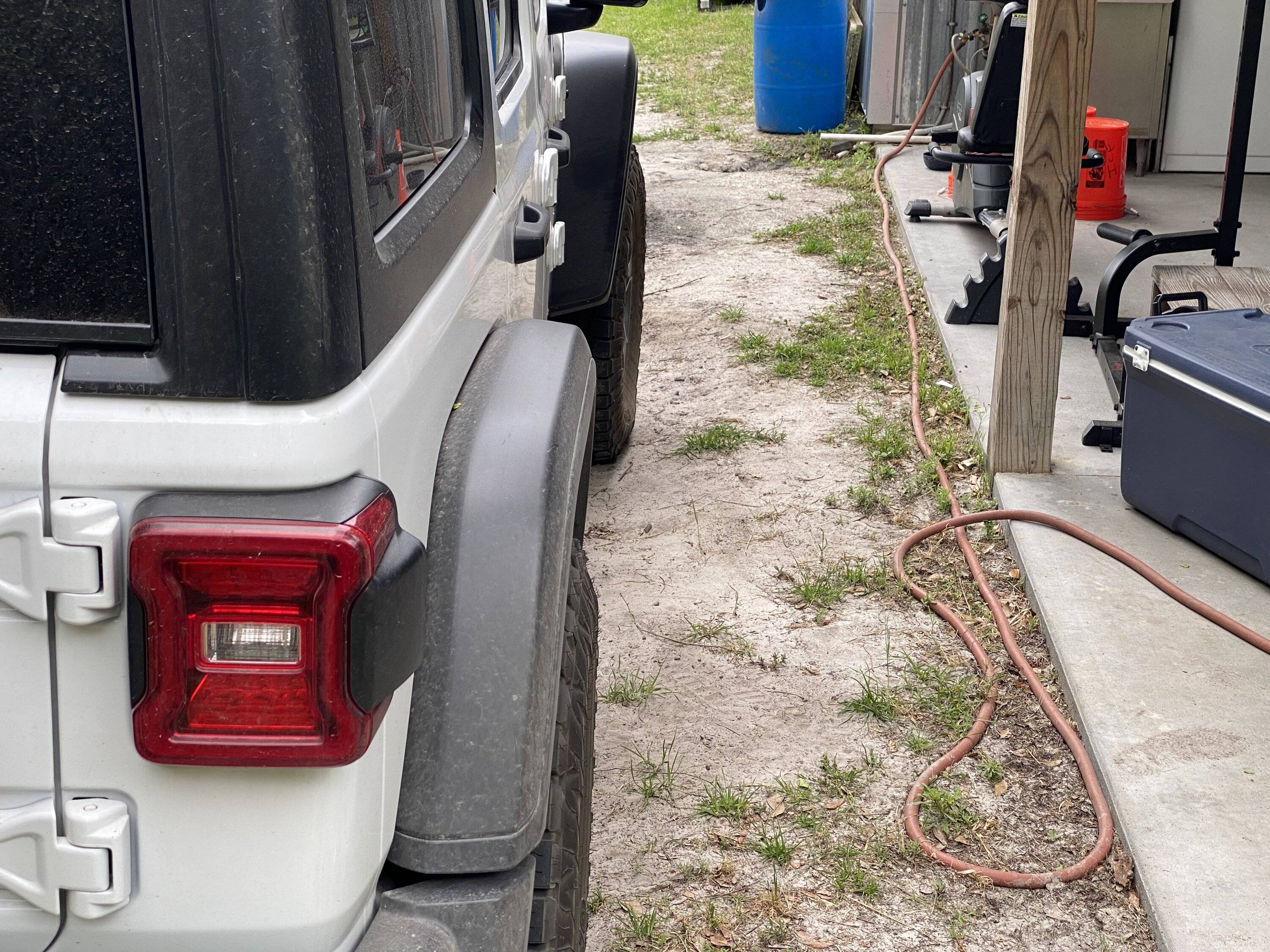

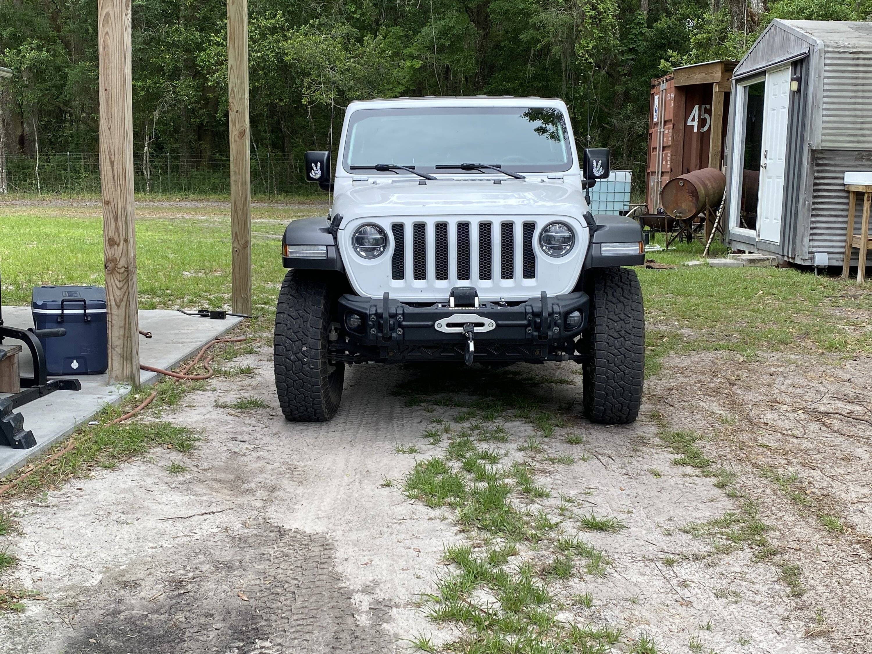

If I haven't scared you away yet, I say go for the 4.10's. I say this because many people that say they're not going to mod end up doing so once the bug bites them. With the 4.10's comes heavier duty wider axles. Additionally, better cooling and a couple of other things I'm probably leaving out. If you do some relatively minor mods, you can go to 35's on a non-Rubi or Mohave. Already having the 4.10's just saved you 1800 to 2K in having to upgrade your axle gearing.
In this forum, I've posted about a buddy of mine that has a JL sport. He got on Facebook market place and picked up takeoff LED headlights, Highrise fender flairs, Rubi rails (ditched the sport steps and now it’s easier to get in and out of) and a Rubicon suspension off of a diesel JL. He didn't have the larger axles, so he had to install wheel spacers, but installed 35 - 11.5 - 17 tires. He and his wife love it. It's actually hers. He stated that it handles and rides far better than when it was stock. In addition to the Rubicon springs which add about an inch over the sport/overland vehicles, the fact that they were springs out of a Rubicon addressed his nose down rake due to his steel bumper and winch. Not including the price of the tires, he probably has 1k in it. Not including a Rubicon disconnecting anti-sway bar he either got for free or very cheap. No he didn't have the electronics to operate it like a Rubicon, so he spend a little and got the manual bypass to eliminate the need...and there's no way for it to short out if/when he gets water in the electronics. He's a tinkerer. It relieves stress. Oh yeah, it wasn't about the $$$. He's got plenty. This is just what wanted to do.

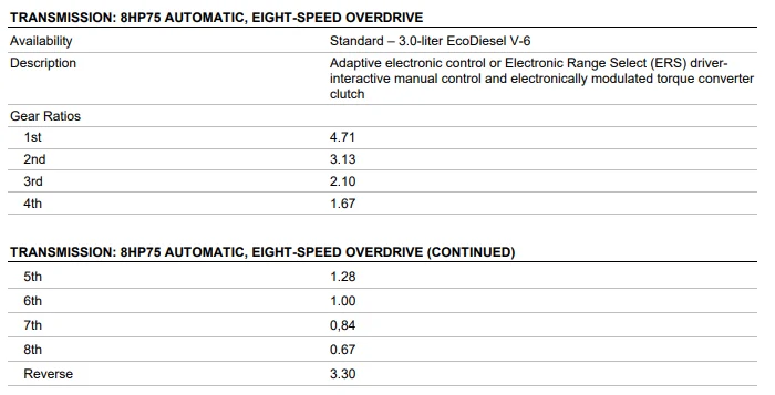

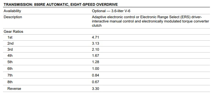

This thread refers to 'overdrive' gears in a couple of posts and I'm not convinced they are, we are just making excuses for an engine with low torque...do JTD owners refer to 7th or 8th as overdrive gears?
Being a Brit and having owned several British '60s and 70s cars with actual overdrives, I'd maintain that 7th and 8th are just 2 gears in an 8 speed box and the Jeep should be able to use them all and not drop to 7th in a headwind.
Thoughts?
7th and 8th are overdrive gears.
