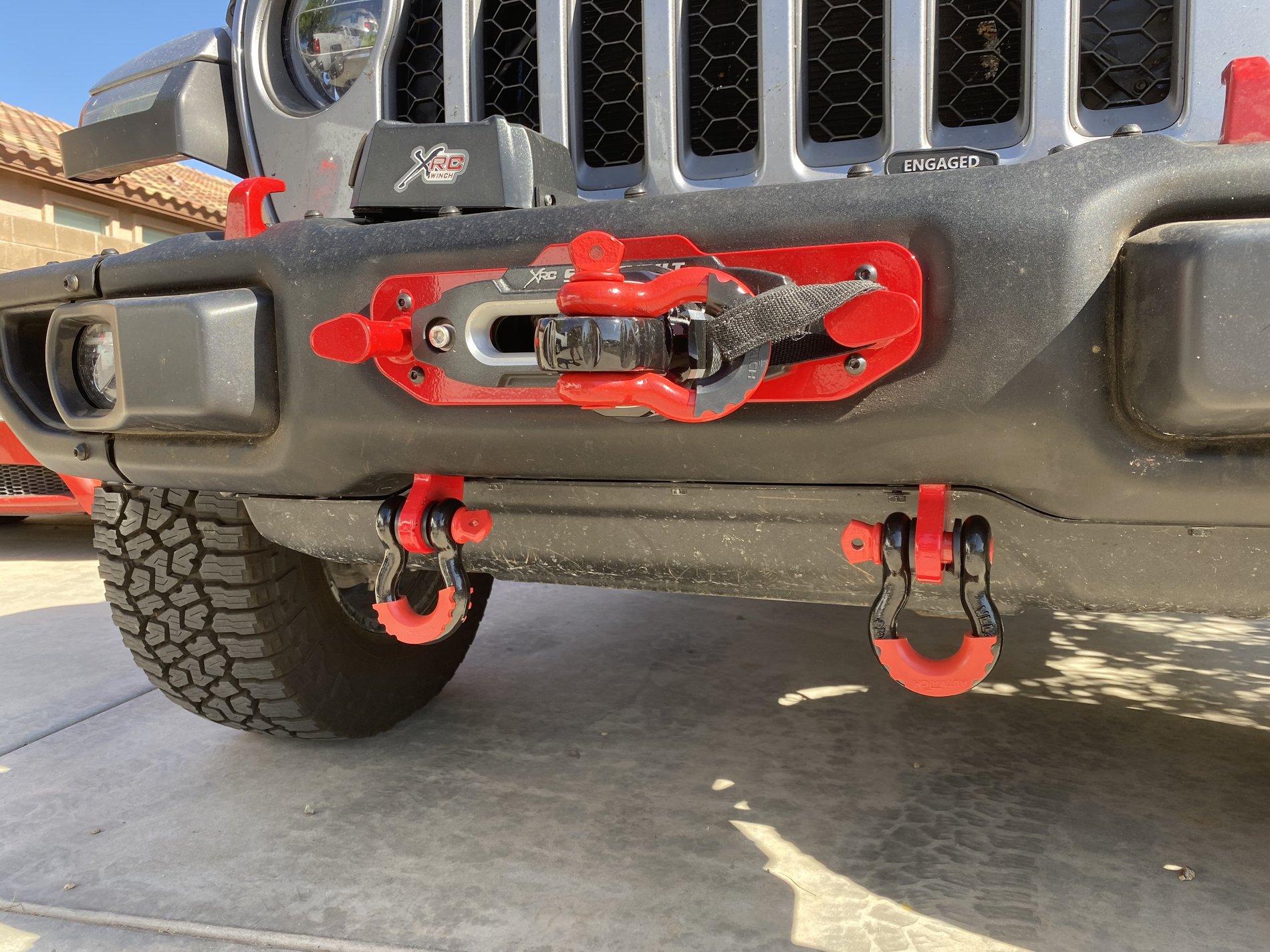

There are plenty of them. It's hard NOT to find a bunch with a basic search. I just did a Maximus-3 and I will tell you that both my helper and I were *very* impressed with the completeness of the instruction manual, and the build quality is superb. It's expensive but worth it.
I also added the shackle loops, and THAT part required cutting. The winch plate does not.
Jeep Gladiator Winch Plate Compatability IMG_6599

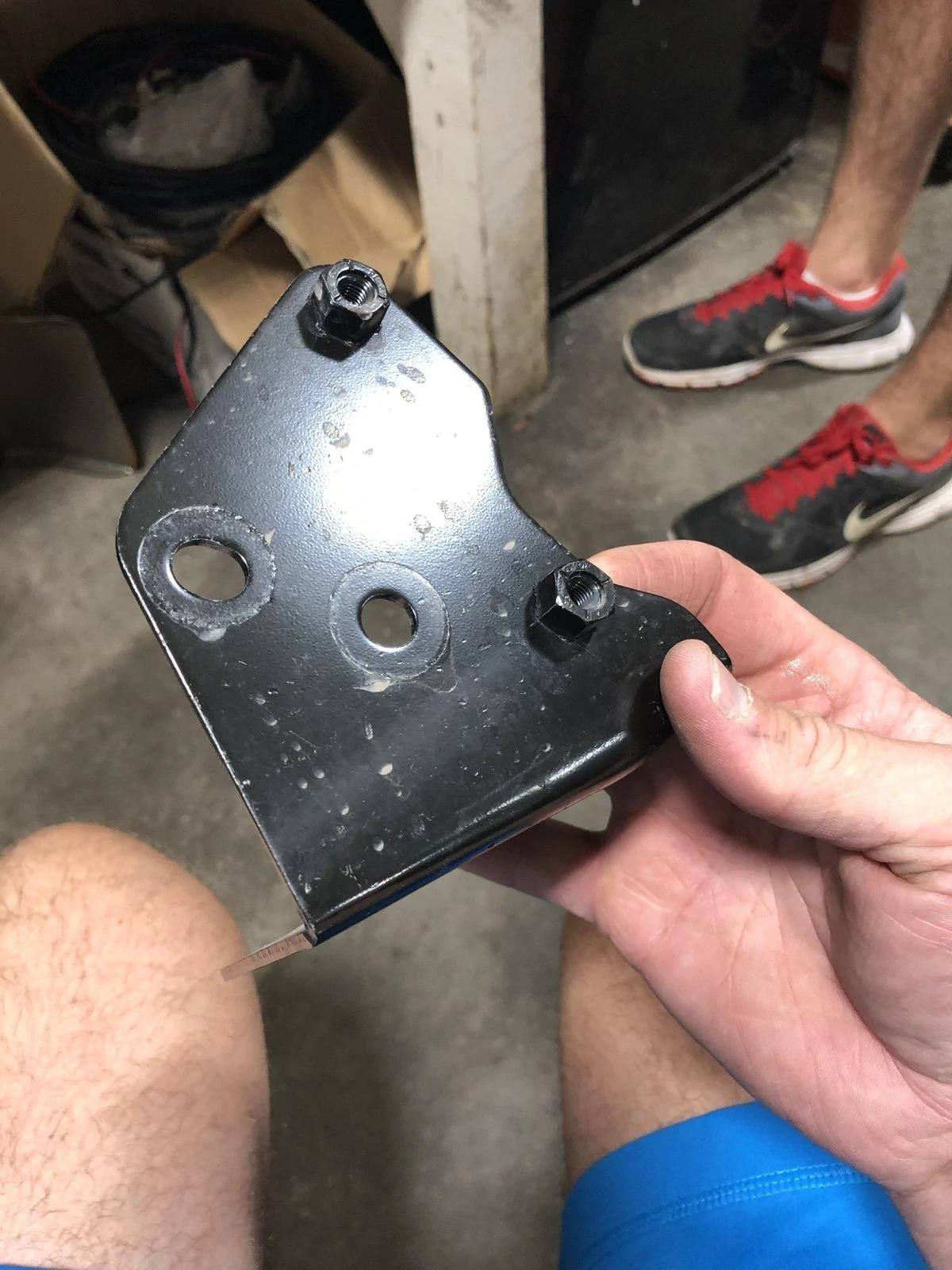

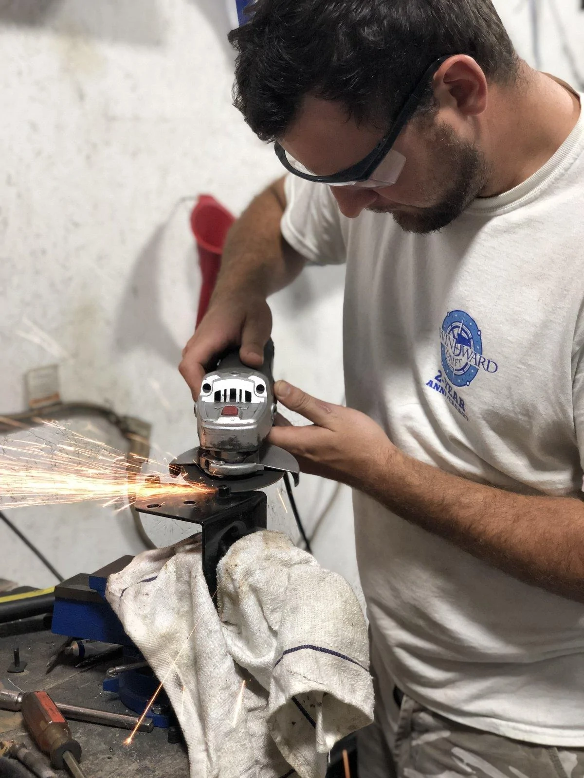

Just received my Gladiator launch edition on Friday and ordered the JL warn winch mount for the JT OEM steel bumper. I can confirm that it fits with a small modification. There is a bracket that has a thread in it for the OEM skid plate under the bumper, that bracket had what appears to be useless Threaded nuts welded to it and i had to cut/grind them off and paint the bracket to get the warn brackets to work.
However, it was a quick fix and everything else lined up. i am running a warn 12-s platinum and it fits.
Easier to use a breaker bar and a socket and twist the nuts off vs the die grinder.
