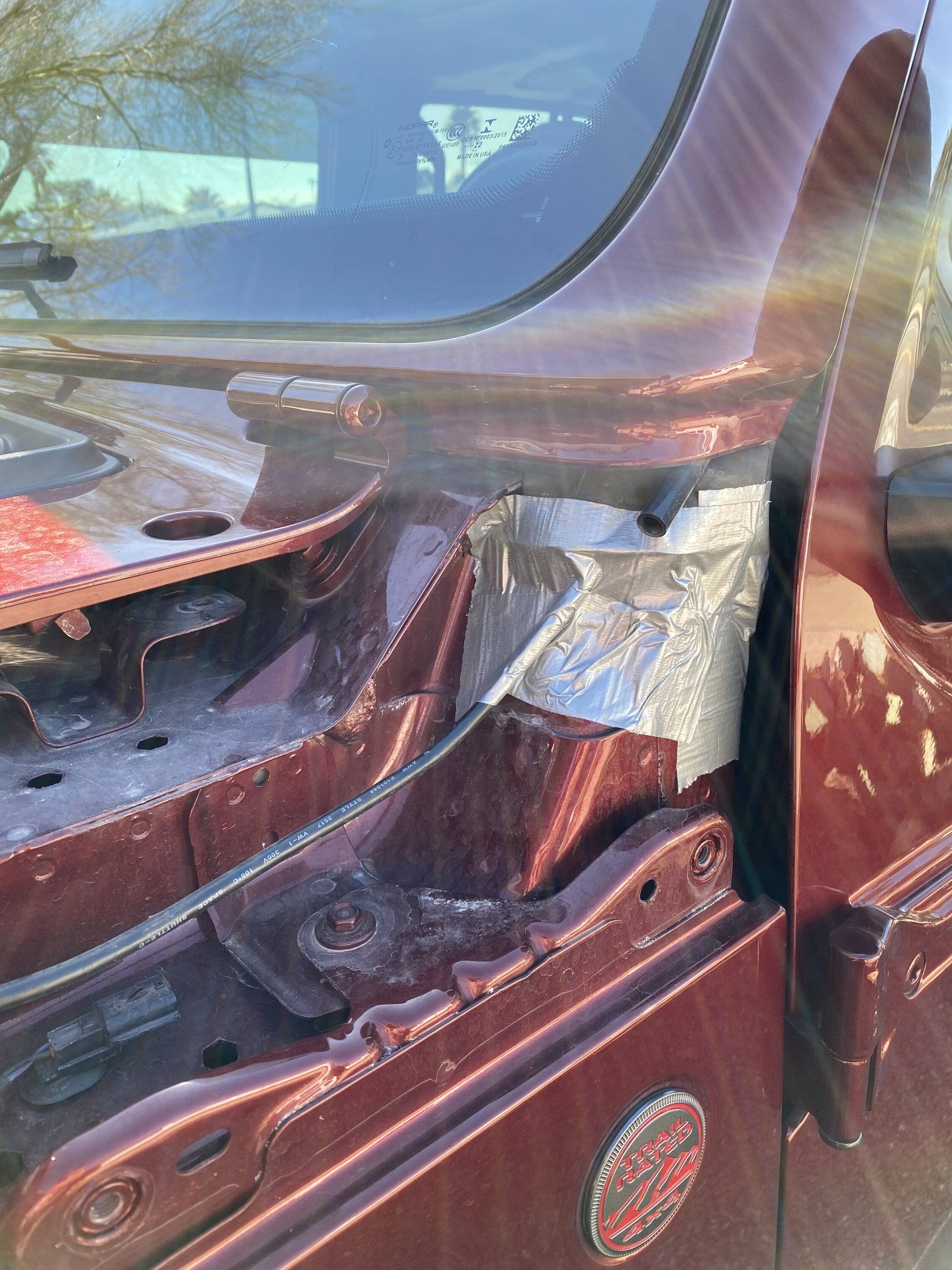

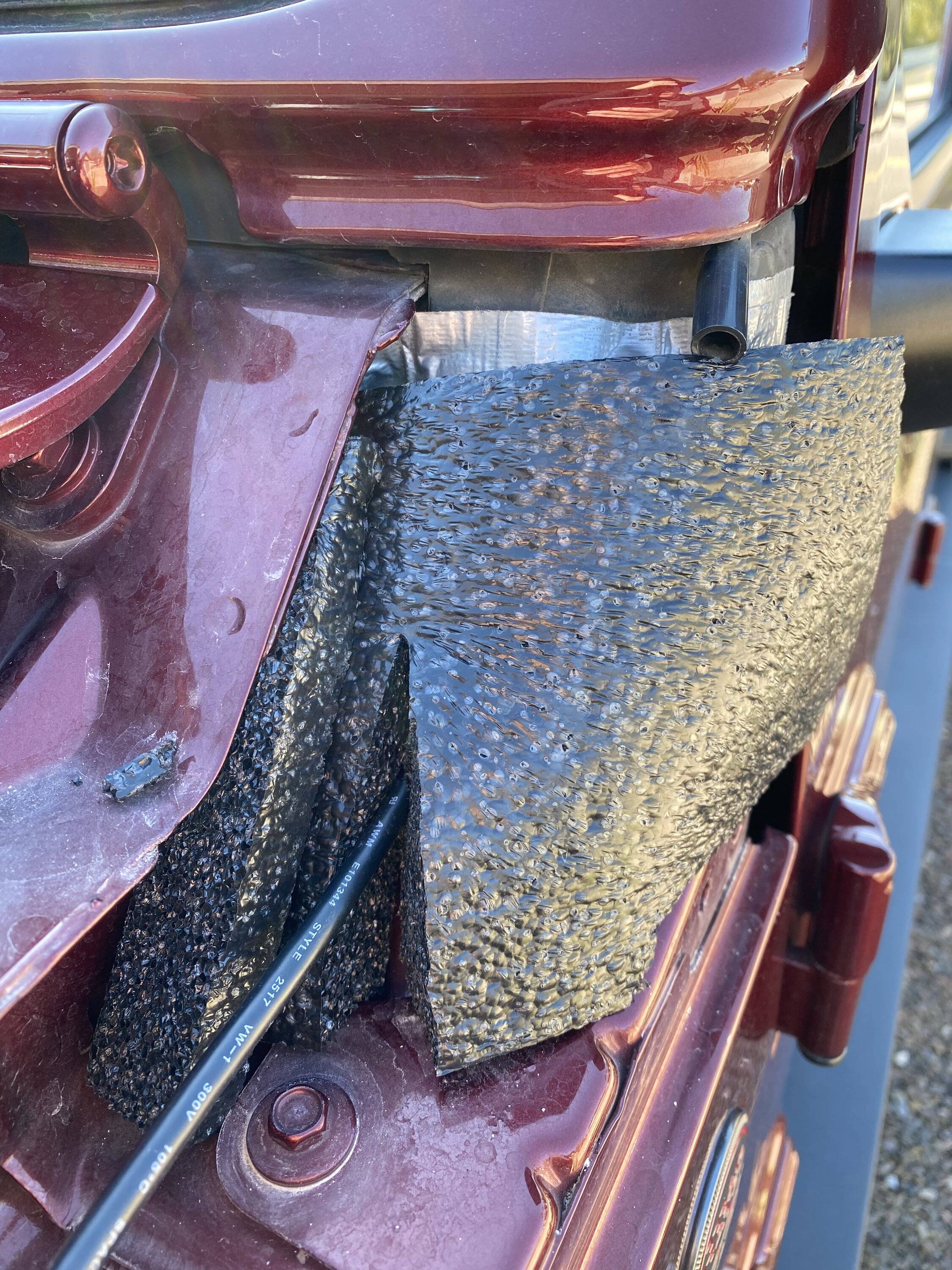

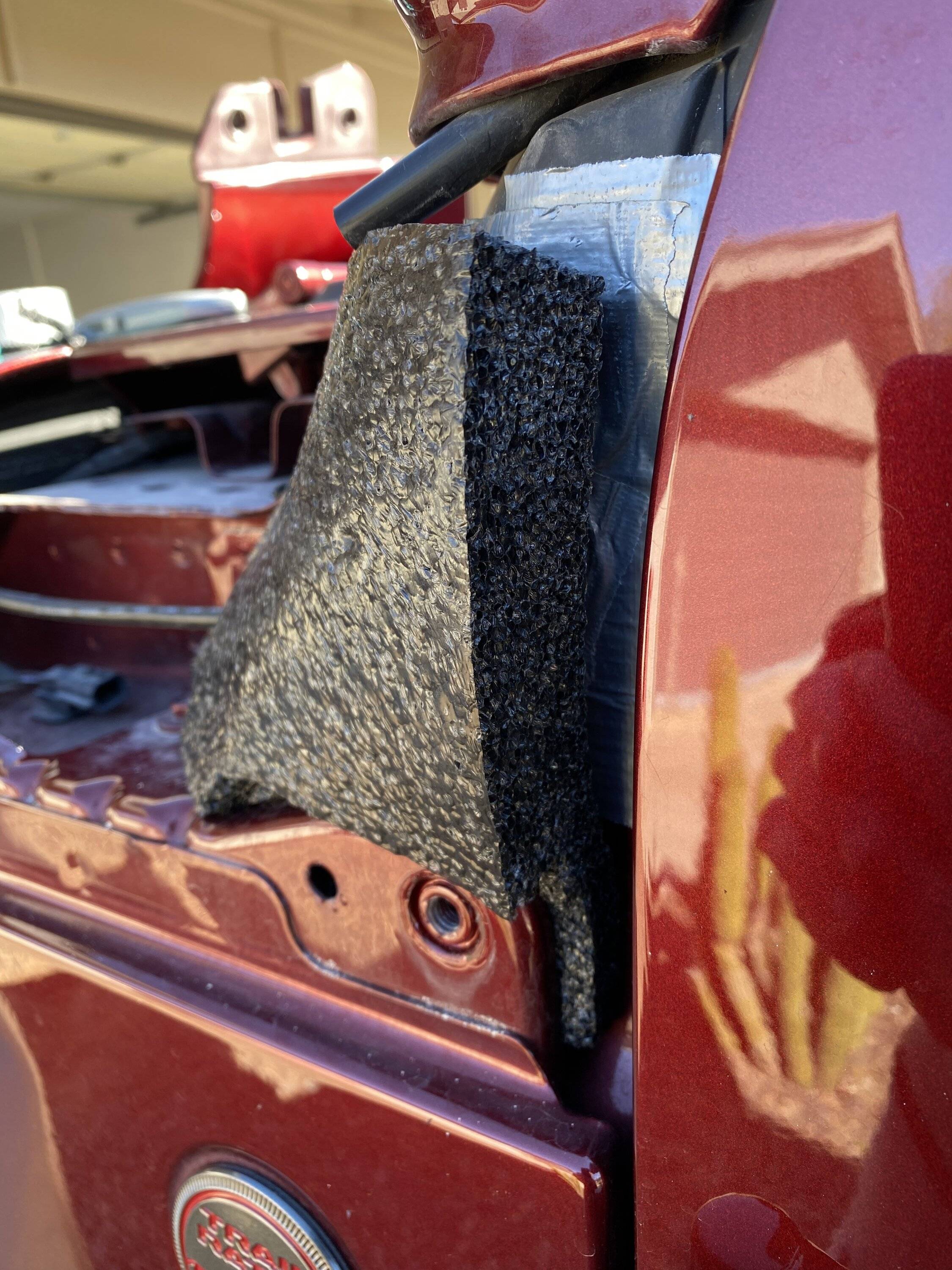

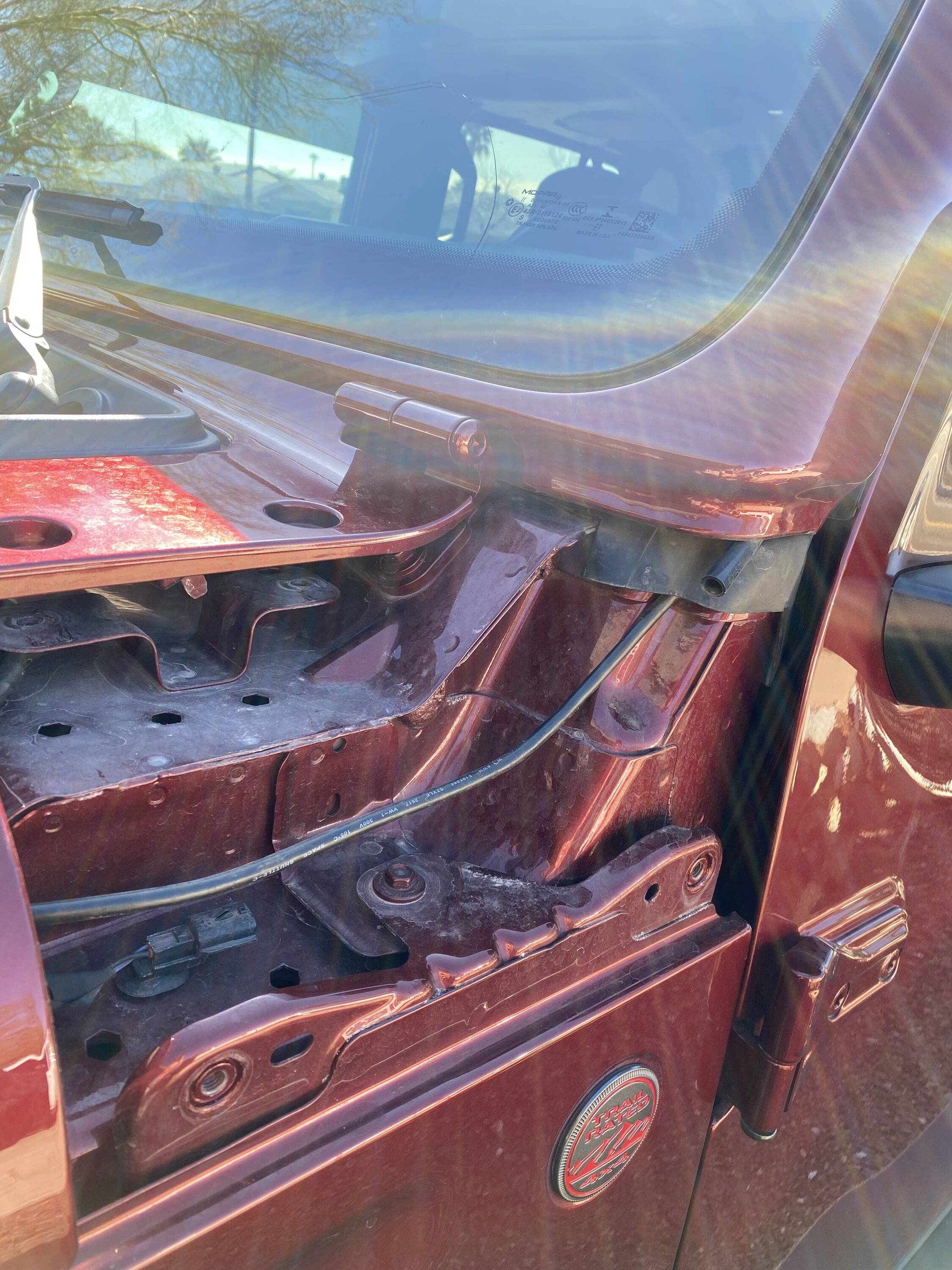

I've had a large block of foam material set aside in the garage for the last few months and finally got around to this. I used a piece of cardboard to mock up the general shape, traced that onto the foam, and then used my lil M12 handheld mini reciprocating saw with a fine tooth blade and carved out the blocks.
Right after I installed them I made a 2 hour drive and holy cow, the noise reduction was immediately obvious. I used to be able to feel the draft on either side of the instrument panel by holding my hand there, and it's gone.
The nvh reduction as well as the improvement in insulation is a major win for a small amount of effort. Thanks for sharing this.
