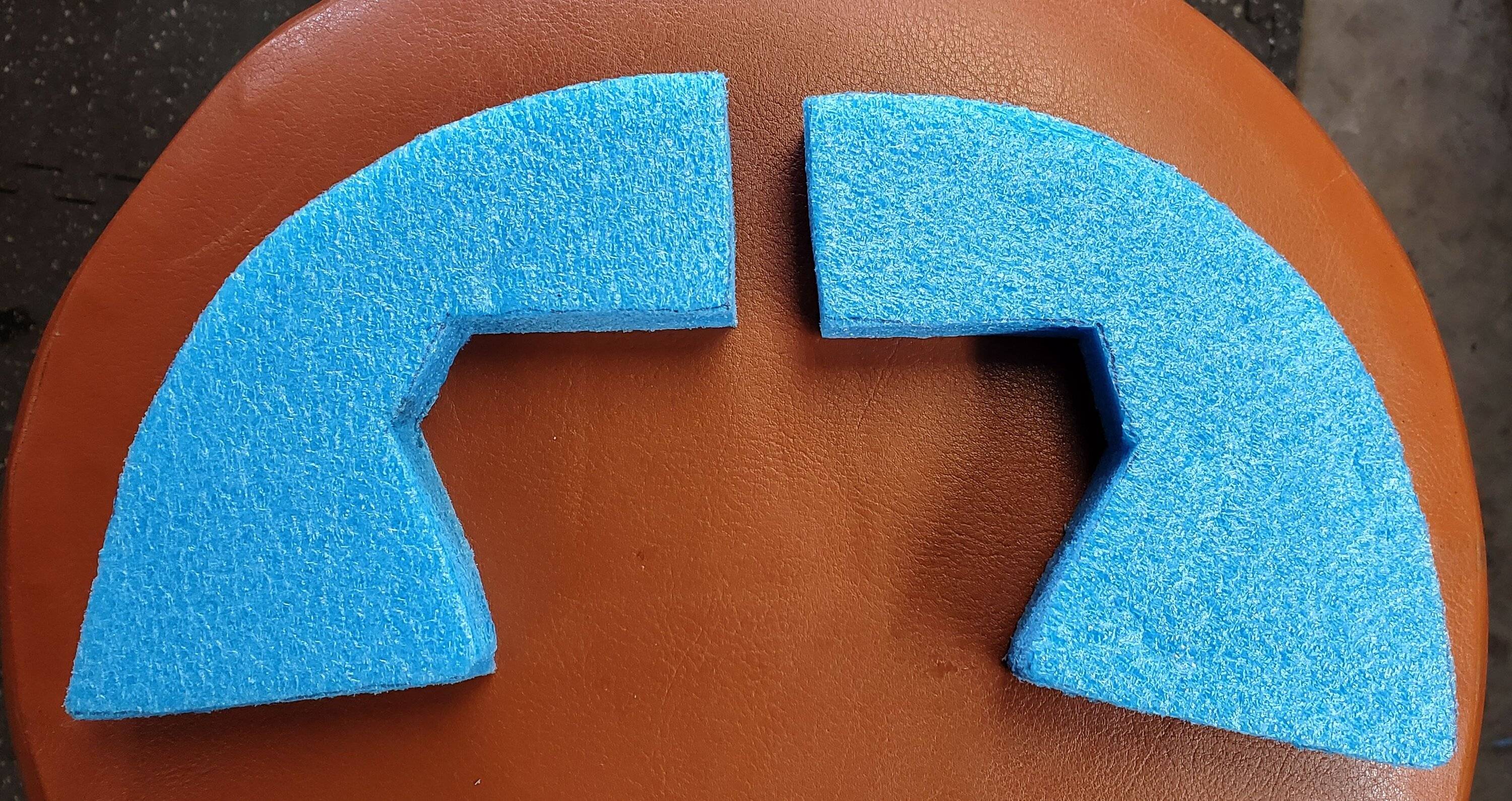

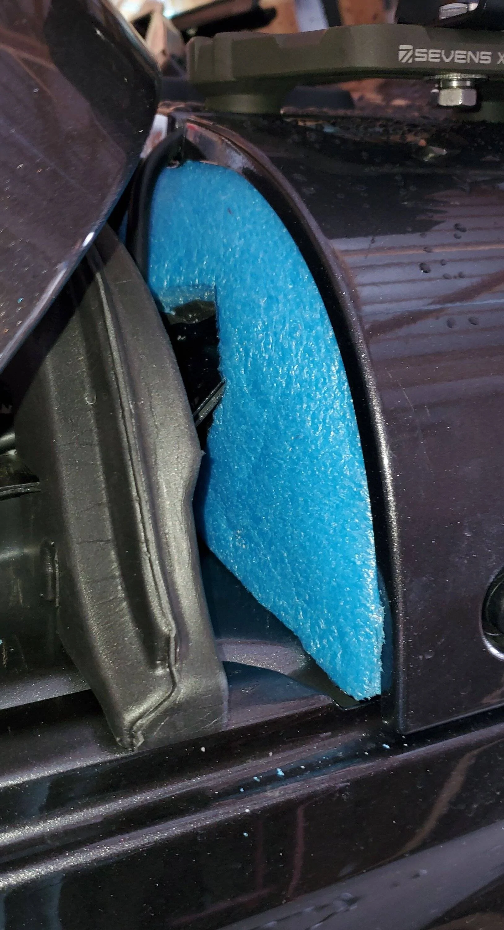

Many thanks to the OP on this easy fix. I did it a little differently but it has the same basic result in making the JT quieter, especially when driving into the wind. We have a good 35MPH wind out of the south today and this made a marked difference in the noise level. These are easy to remove if I want to lay the window down or clean out behind them.
Here are photos of my fix. I used some packing foam that has some form fitting qualities to it and its about 1" thick (25mm).
Jeep Gladiator Wind noise reduced 70% Wind Blocks Right And Left
Jeep Gladiator Wind noise reduced 70% Left Side Installed
