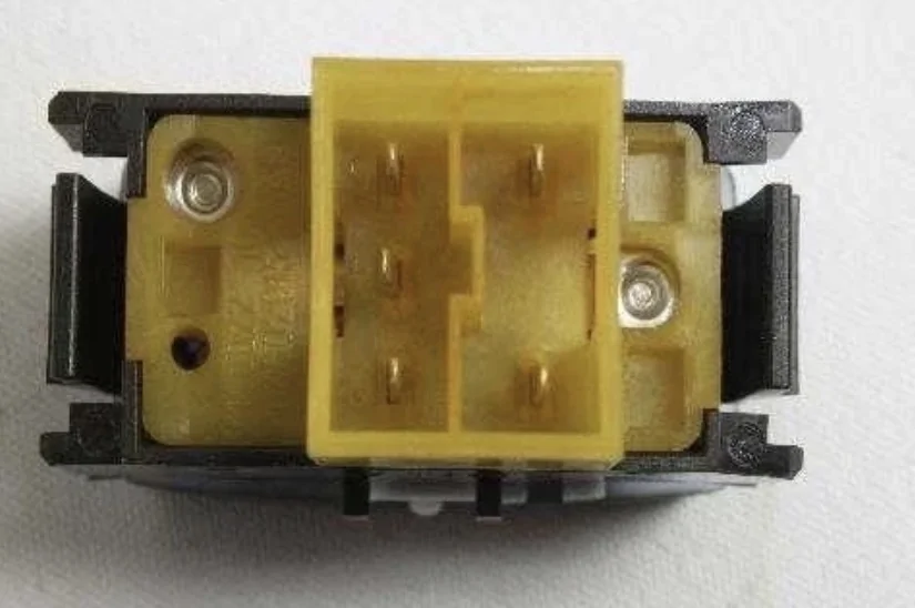

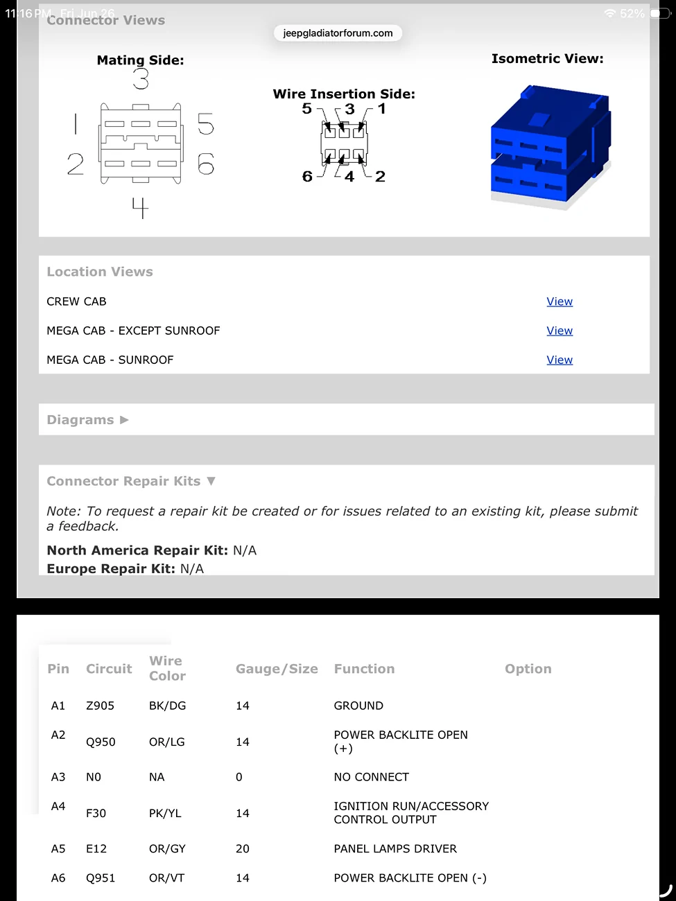

@Gatorized
I believe it should be...
Pin 1: Actuator Line 1
Pin 2: Actuator Line 2
Pin 3: power
Pin 4: ground
Pin 5: Illumination
But it looks like it would work. That would be a polarity reversing switch. I'd also grab a factory pigtail for the switch. That would make it easier to wire it up.
Good find. This is the route I'd go.

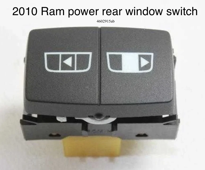

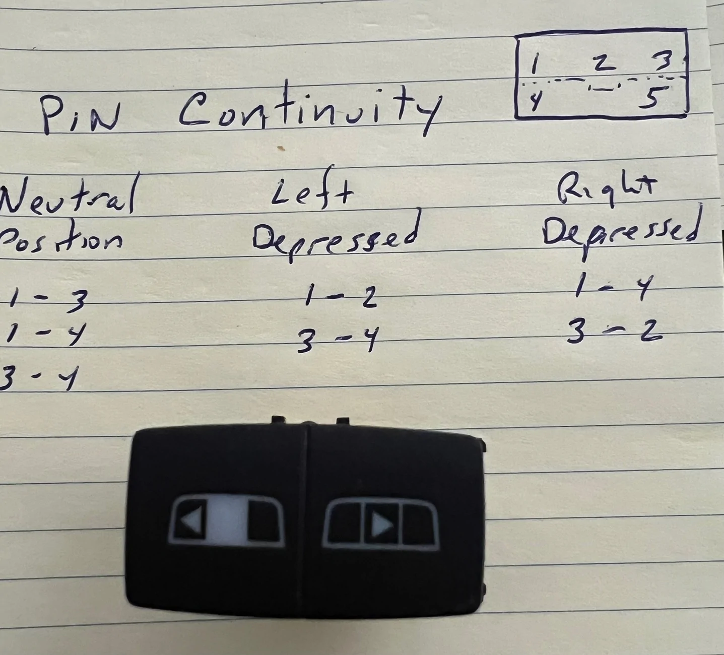

Using the 2010 Ram power sliding rear window switch - p/n 4602915AB:
Jeep Gladiator Power Sliding Rear Window - It's possible! IMG_0594
Jeep Gladiator Power Sliding Rear Window - It's possible! IMG_0595
Jeep Gladiator Power Sliding Rear Window - It's possible! IMG_0593
pin map:
1> Battery (-)
2> Motor (+)
3> <blank>
4> Battery (+)
5> illumination
6> Motor (-)

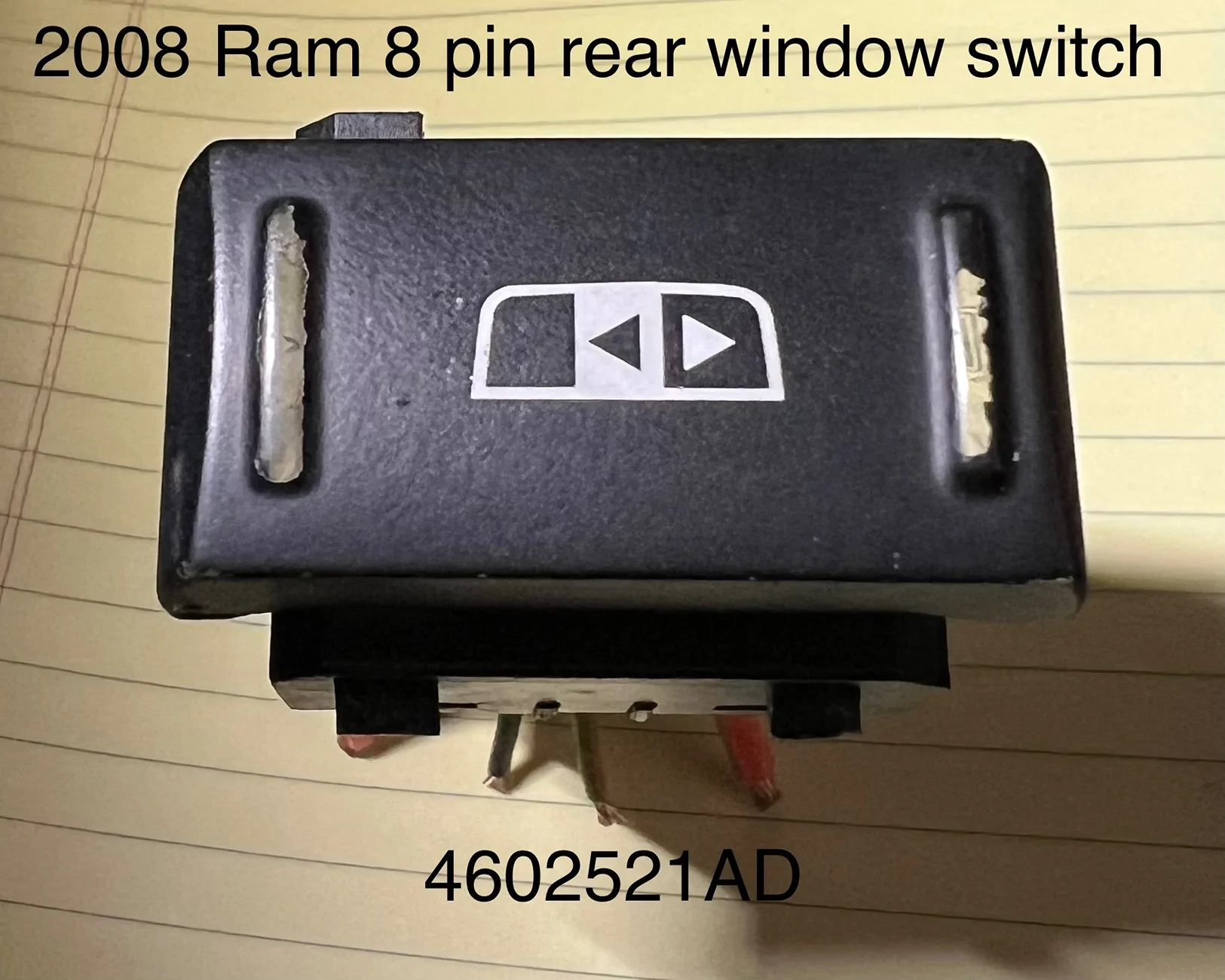

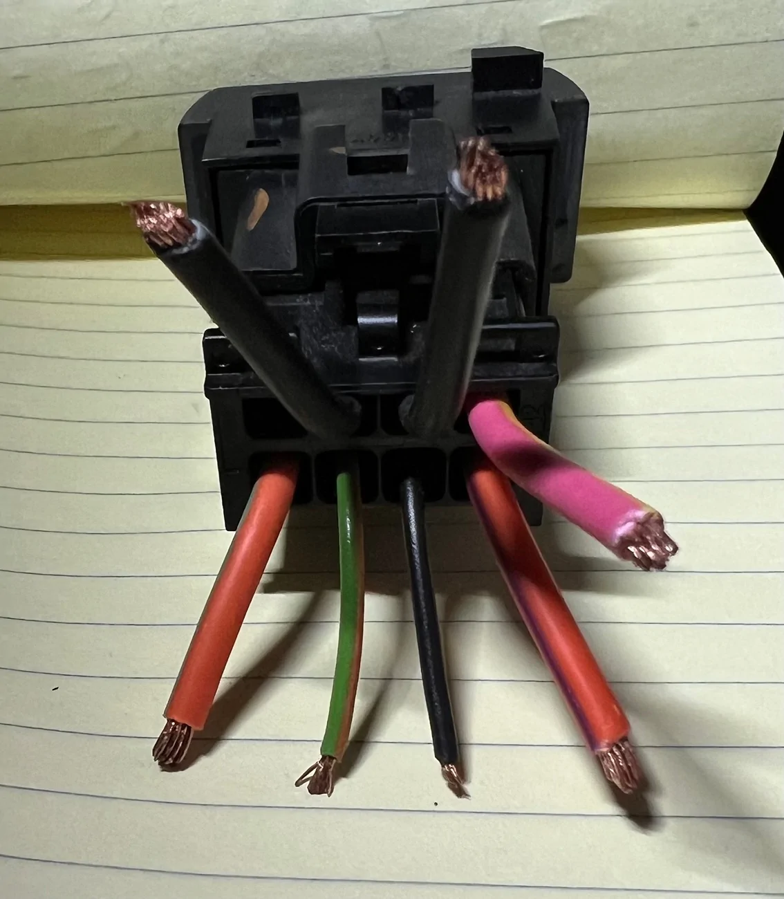

You can also use the 2008 power sliding rear window switch (8 pin) 4602521AD…
1 2 3 4
5 6 7 8
1> blank
2> battery (-)
3> battery (-)
4> battery (+)
5> motor (+)
6> illumination
7> illumination
8> motor (-)
