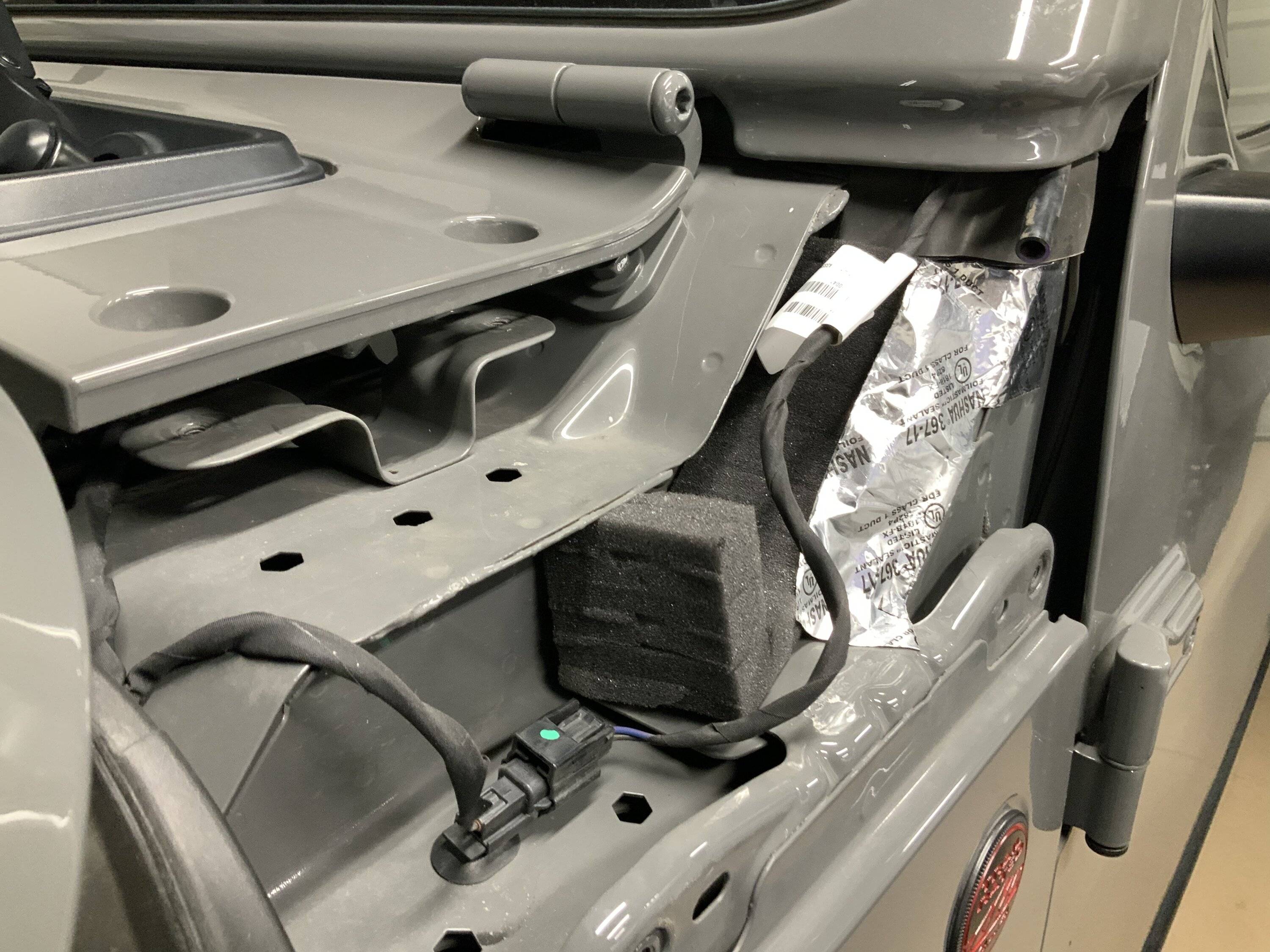

I have wind noise on my Wrangler from where the Freedom Panels meet the Windshield frame. I have adjusted the brackets to their lowest position so the panels are on tight. I have no idea how to stop the wind noise. When I put the soft top on the noise is a lot lower, so it has to be in the panels. I do not have this issue with my Gladiator.
I have a 2021 Mojave and I have the wind noise you have on your wrangler. It is not a huge problem but it is close to the phone microphone and is very noticeable. Let me know if you ever solve it. I tried tape over the seam where those panels come together with the windshield, did not help. Thanks
So I read another post about being able to adjust the brackets the the freedom panels lock into. The 6 latches that rotate, their brackets can be adjusted up and down. The 2 snap latches can be adjusted forward and backward. I dropped the brackets to their lowest setting and evened out my freedom panels. The wind noise has been reduced to a tolerable level but it is still louder than my gladiator. To get to the brackets you need to pull down the plastic trim And you need a torx bit. Smaller than the one than in your jeep tool kit.

I'd agree low hanging fruit worth looking at, especially when you are using this vehicle for overlanding and long trips. I 've had a YJ with a softop, JK with hard, softop, and Sunrider. I was quite surprised at the wind noise/whistling I am getting with my Gladiator with a hardtop and freedom panels. However, it's still too low on the list of things I want to do to worry too much about at the moment. There are TSBs about adding some material in behind the windshield frame that may not be sealed properly. There are the mods to the roof and top like sound assassin strips and hothead liners to reduce buffeting and deaden the wind noise. Plus the additional things in this thread people are posting that may help some out. Thanks everyone for the ideas, keep em coming!

I have a long freeway drive next week so I'll try this. I have some RV Eterna Bond tape that should work great. Just hope i am not sealing an area that should be allowed to drain.

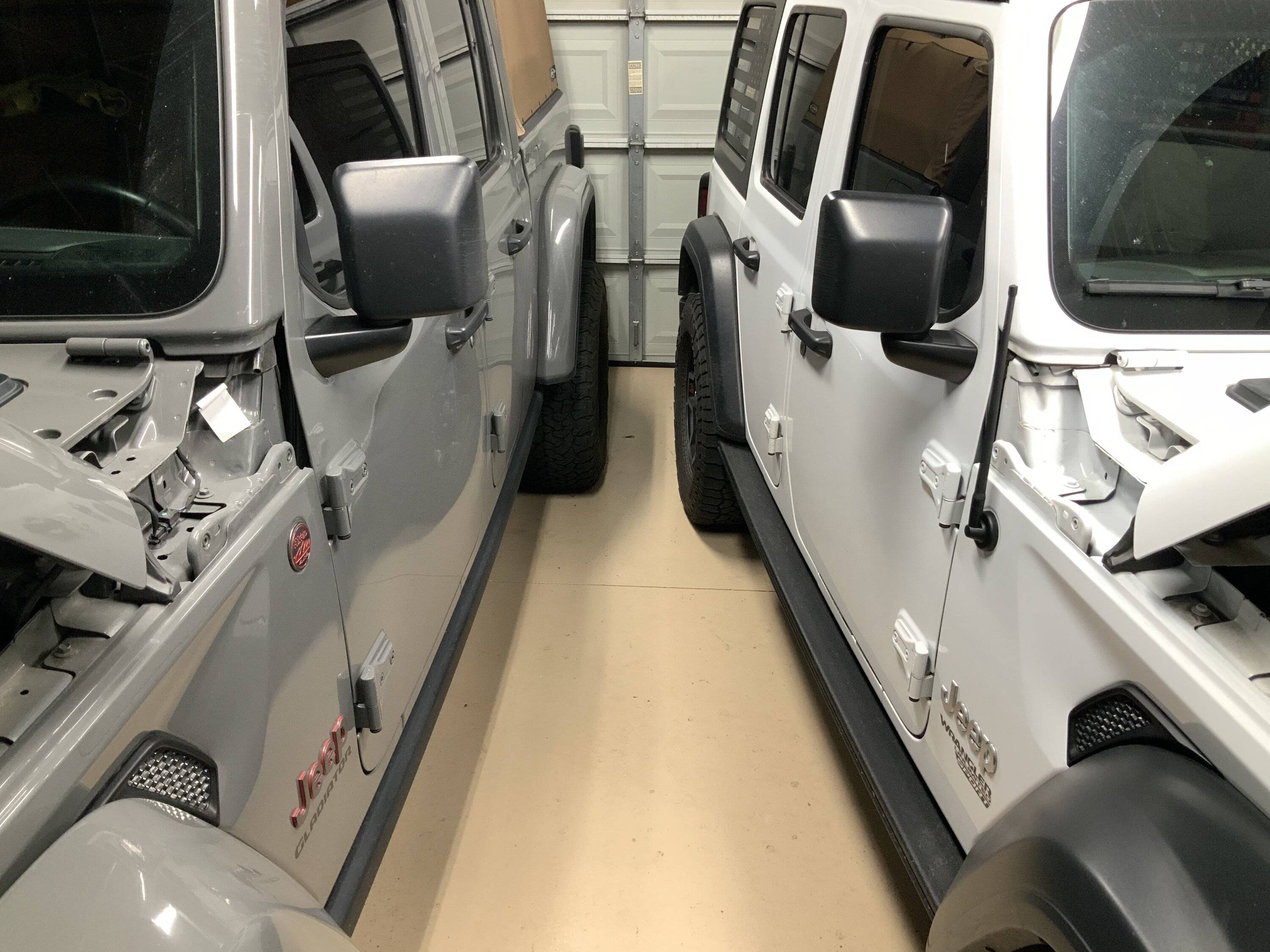

Did this with both vehicles. Drove the JT and didn’t notice much a difference. Will check my wife’s JL. Hers was noticeably noisier. Looking at the existing conditions, it’s not hard to see why, hers didn’t have the gasket below the window.
