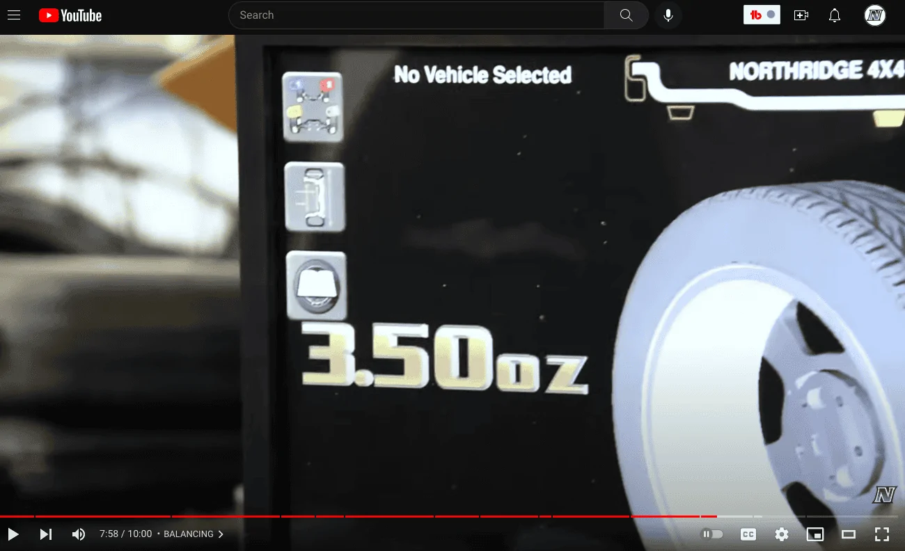

I've been in the 4x4 industry for 30 years and have never seen a 35" tire/wheel combinationation take zero weights. Not saying it couldn't happen, just never seen it in hundreds of sets of tires.
I've seen quite a few take very minimal weights, we even had a 40 in here a few weeks ago take 3.5oz which was pretty surprising.
**Edit** I went down and talked with the mechanics. They assemble multiple sets of wheels/tires every week. One of them has been with us 3 years and he says he has seen two 35" tires come through not needing weight. Another mechanic has been with us 4 years and he says he's seen 4 or 5 not needing any weight. So it's definitely possible.
I could show you my neighbors new wheels and tires - he's got one that balanced fine with no weights.
Please do, I'd love to see a 33"+ wheel/tire combo with zero weights. Even more impressive would be to see the balance read-out on it.
Here's a screen grab of the balance read-out on a 37" tire balancing to 3.5oz., that is dang good in my book for a 37" with a beadlock.
Jeep Gladiator Wobbling in Steering Wheel. Time for New Tie Rod/Drag Link? Screen Shot 2023-02-22 at 8.59.37 AM

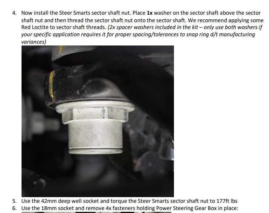

I think I figured it out for the most part. The nut on the sector shaft was so loose it nearly fell off when I took the brace off to retorque it. Slobbed some red loctite on and torqued it down. Drives great. Still pulls so thinking of adjustable lower control arms and taking it in to get it aligned
40,514
54,043
We've seen a couple of those after dealers did the TSB for the steering gear - they re-used the factory nuts which is a no-no. Tyler has a video and write-up on it out there.
Ideally you use a NEW nut and the subsequent TSB did come out finally telling them to use a NEW nut. But at the very least- Loctite. Me, I'd buy a new nut (mine being stock).
I view that 177 as a minimum. Heck, the control arm bolts get more than that.
I guess what you are suggesting is that someone didn't read the book LOL
Loctite AND torque of that magnitude it should never come loose. In the 1970s and 80s, you even staked the shaft to prevent the nut from coming loose- in addition to the other. No way in #@$% it was going to come loose.
Think of the forces on that thing - the steering force, the fact it absorbs any vibrations not taken care of by the stabilizer, etc. - it's a lot of stuff that thing has to handle. And yet people don't lock that nut in place - and techs re-using the old nut. Scary.

I did 185 on it as I couldn't physically get it any tighter while laying on my back lol.
