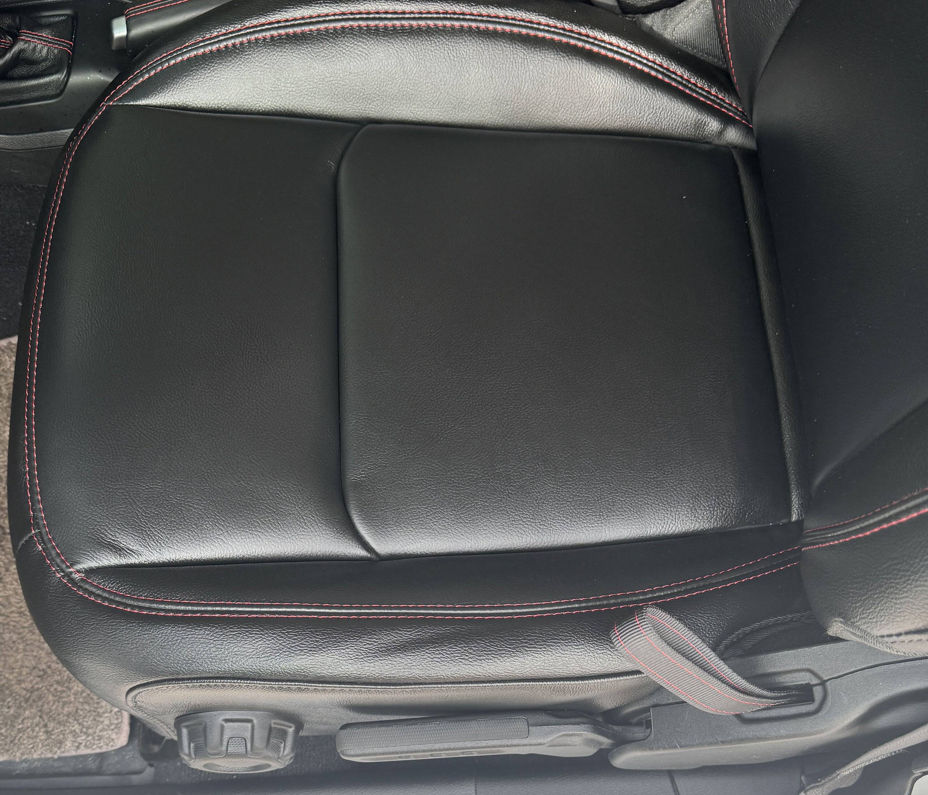

So I brought her in today and I got a new seat cover for driver seat. Warranty covered it. Everybody at the shop. Tried to tell me it was normal but I’m glad it was changed out because it looks great right now. This was something I had brought up in the beginning of the og post.
With that said,… I will be getting a loaner vehicle once he gets one in and they will be going over the vehicle. The service manager and the shop foreman are the only ones to touch the vehicle apparently. I’m sure that’s not 100% accurate, but I’m sure they know that after six visits in six months, it needs to be addressed correctly this time around. I am not quite ready to throw in the white towel yet. I just hope that when they do take it, they find the issues and I go on my merry way. Perhaps move on with a Perhaps move on with a vehicle that doesn’t go into the shop at all for quite some time, do some oil changes and tire rotations and perhaps witness and experience my gas mileage in double digits. I’ll be sure to keep everybody posted.
Sorry I’m coming into this thread late and hoping the dealer will fix the mechanical issues going on. @BAULSAUL I was looking at the previous seat pics you posted and I have a similar issue going on with my driver leather seat…only 4k miles in and feel like the leather is just loosened up on the drivers side seat quite a bit, same look as what you posted before. I noticed it happening around 1 or 2k miles in and I’m guessing that’s not normal if they replaced yours already. I do have seat heaters and thought maybe they’d say that’s normal. Guess I should call my local dealership to have them check it out and again hope they get to the root of the mechanical nonsense you’ve had to deal with!
