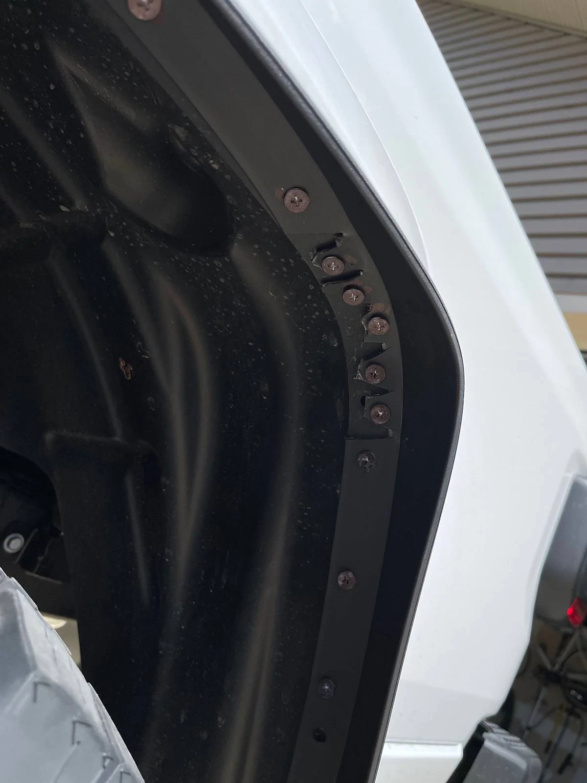

I just installed these on my 2023 JT HA and it was painful. The fender liners on mine must be different than other models cuz the holes in the extensions didnt match up at all in front. Ordered the 2 pairs of fronts and had to get some self tapping screws to make it work. Seems the angle of the liners on mine are not correct for these as much as other models (Rubicons, Sports, etc.).
Will try the backs once I get a 5th left piece as I messed one up so bad had to order another one. They do work though at keeping the debris under control for my -6 wheels on Toyo 315/70/17's.

Yeah the holes don't line up, I ended up drilling new ones. It's all plastic so no worry about corrosion, just weird to drill holes in a new vehicle! Good luck, you got it!

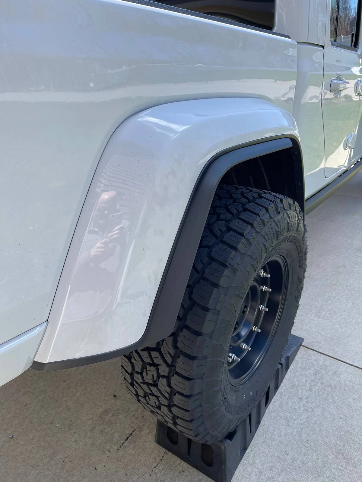

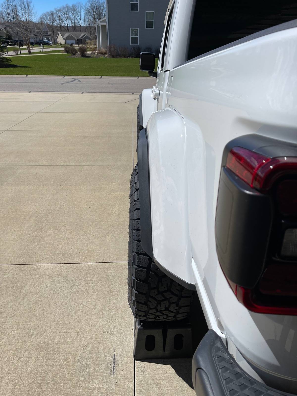

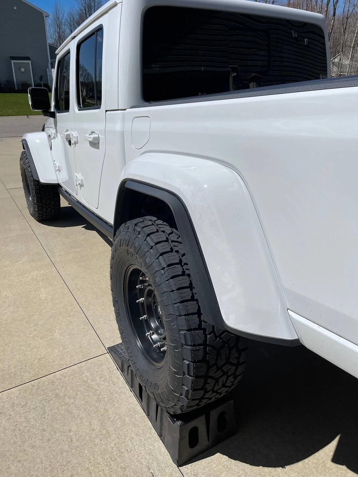

Got them on the rear too. Install there was more difficult as well. From the outside, they look ok. underneath however, not so much. That doesnt bother me though. Keeping debris off my truck and other vehicles is what I am after. I think these will work for now and can likely avoid mudflaps for the time being.
Used black marker on the self-tapping screw heads for now. Will paint them with some rustoleum matte black when it warms up.

It was intentional. The rivets and or Xmas trees did not seem to work well for me. Don't know if the High Altitude fenders are different than the Rubicons/Mojave's and Sport S models but the bend did not want to line up without some force, which is why the self-tapping screws were used.

?‍?? just drill holes and stick new plastic rivets in… those are going to rust out and not hold….
edit- these are cheap, I’d order a new pair…. Use a dremel with cut off wheel to cut…. And a heat gun to bend the extensions to flush… drill holes as needed and use plastic rivets.

I’m good thnx. Your idea may work but this is easier and accomplishes the goal.
The screws are galvanized and will not rust out any time soon. If that starts to happen, will re-do it then. Besides, I'd need new fender liners too and not doing that unless I have to.

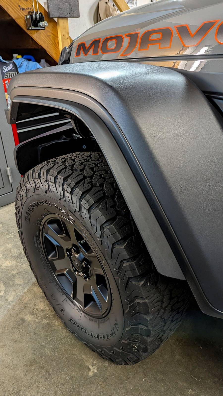

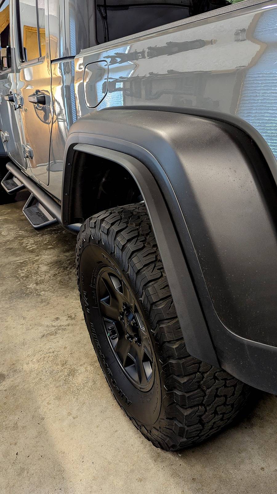

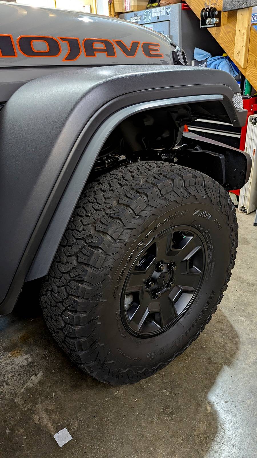

Did mine today during the eclipse.
Notes:
Be extra careful with the oem liners on the rear. It's really easy for the drill bit to walk the liner back and go around it and not through it.
One relief cut seems adequate. Working with warm materials certainly helps.
*** Remember to remove your magnetic work light from the surface of the rear exhaust resonator when finished. ?
