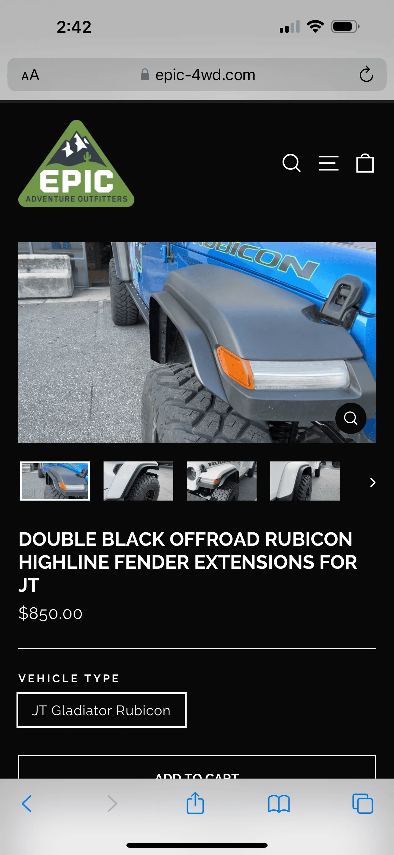

the mopar version uses the same plastic finish that you find on the rest of the vehicle (fenders, bumpers, etc). For $850 you get the aussie's version of mopar plastic and a huge poke in the eye

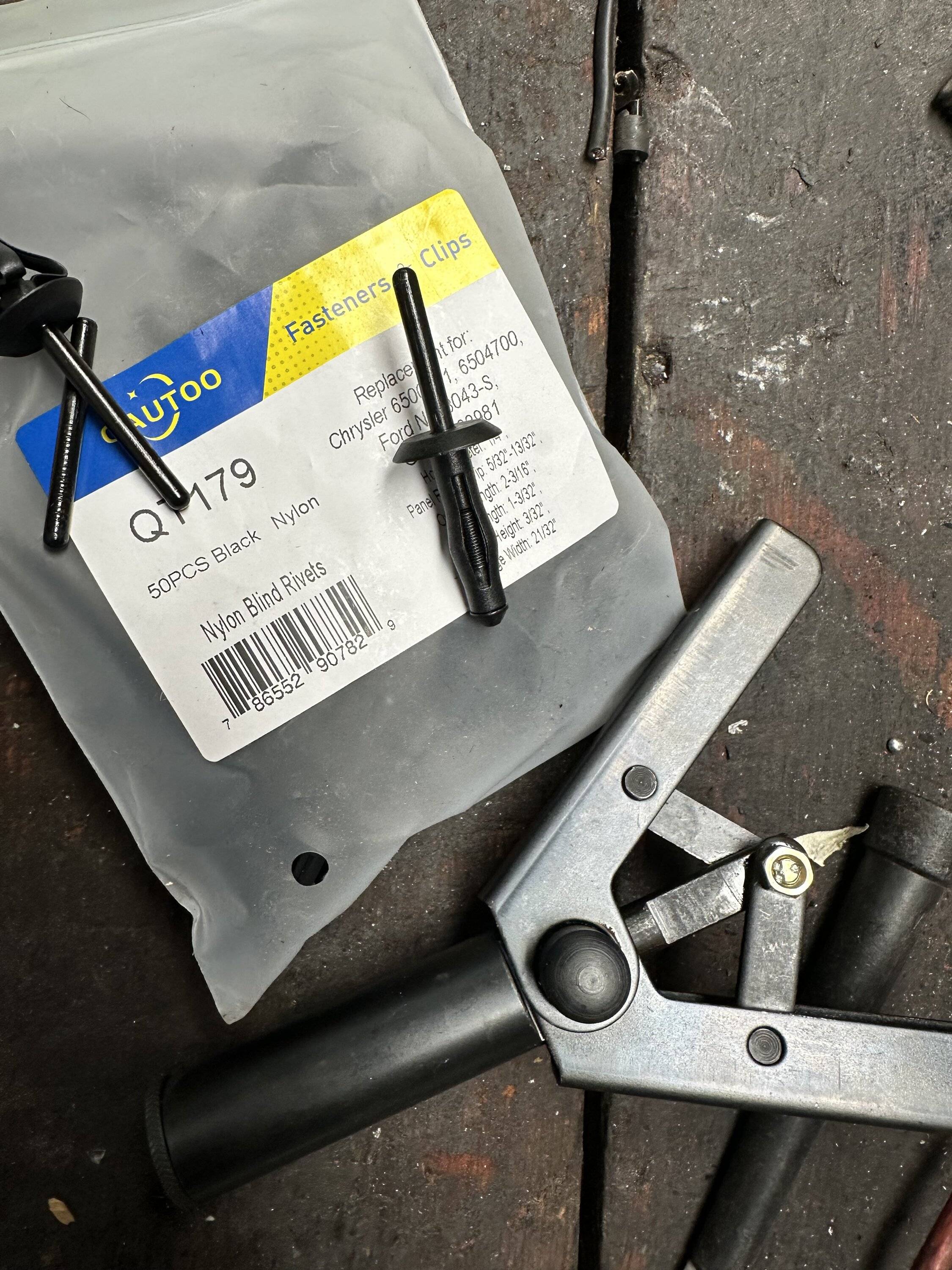

Finally got around to installing my double pair of fronts today. I used different rivets than the OP thought they came off of Amazon as well. Learned a few things in the process that I thought I would share as PSAs and took a bunch of photos since I had some questions I think could have been answered with the photos. I’m going to try to explain this as I go and hopefully not get out of order.

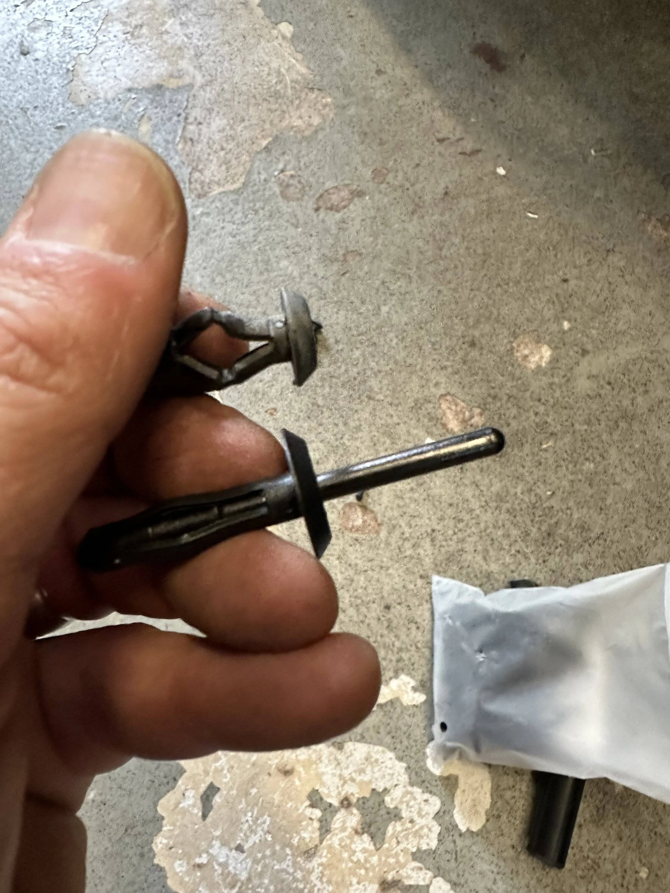

First, the rivets. They are for Chrysler products. They have a larger diameter head than stock which I actually liked since that means a tiny bit more surface area. I bought the rivets off of Amazon and assumed, mistakenly, that one of the several rivet tools I already had would work with them. Nope. The shaft of the pin is too large on the plastic rivets to use any of the ones I already had. I had to go buy the weird looking rivet gun that everyone seems to be using. It is a POS in my opinion. I managed to make it work but it was not what I would call easy nor high quality.

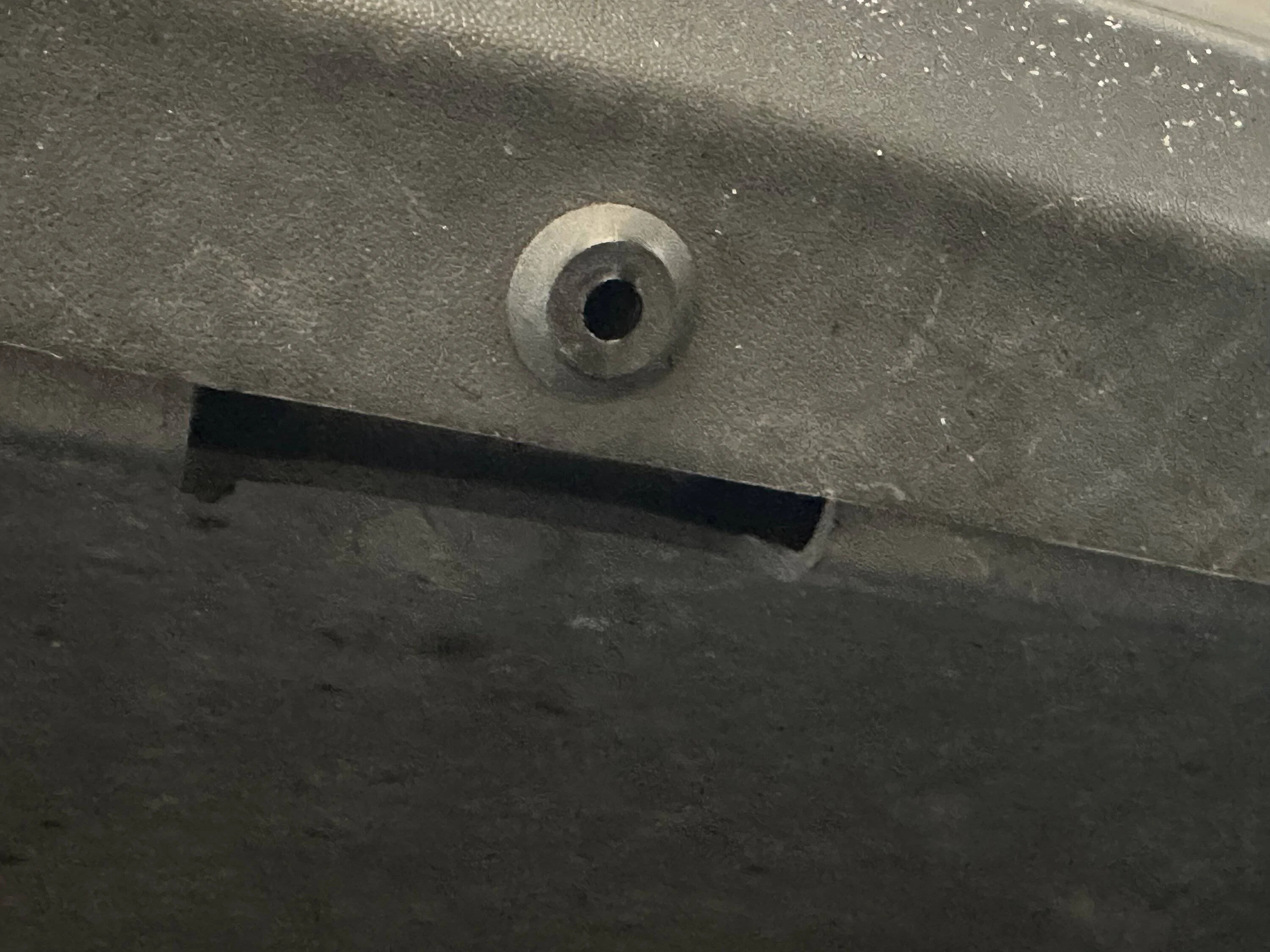

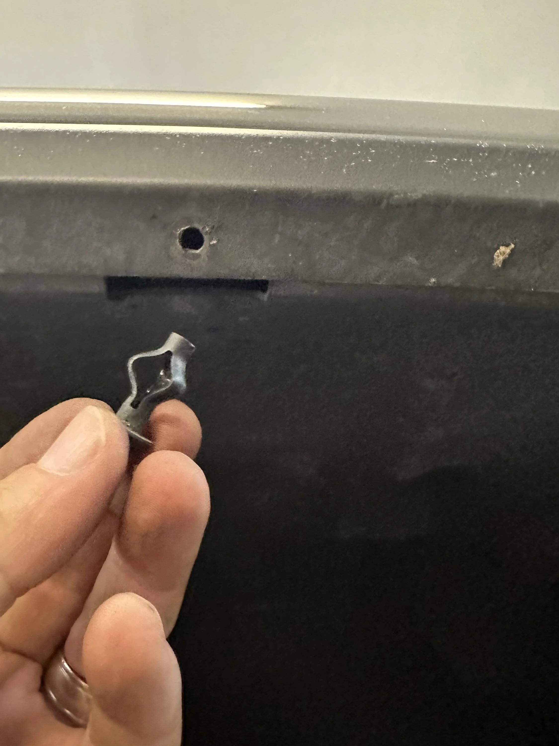

I used a small drill bit to drill out just the center of the existing OEM rivets. Once they were drilled it was easy to pull the remainder out and discard.
Jeep Gladiator Xtreme Recon Fender Extension Instsalled IMG_8018
Jeep Gladiator Xtreme Recon Fender Extension Instsalled IMG_8020
