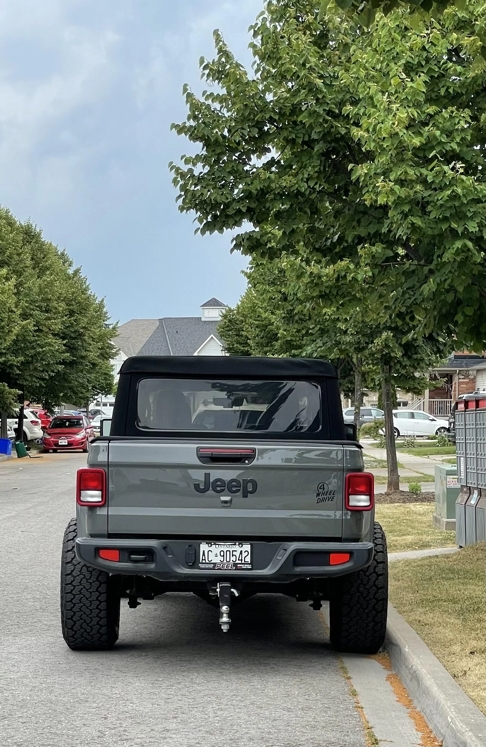

Still debating... My lift and new tires go on tomrrow. May need to go with with RokBlokz.
My Dirty Life wheels have quite a bit of poke and the rubber is getting switched out to Kumho MT71 muds 😆
