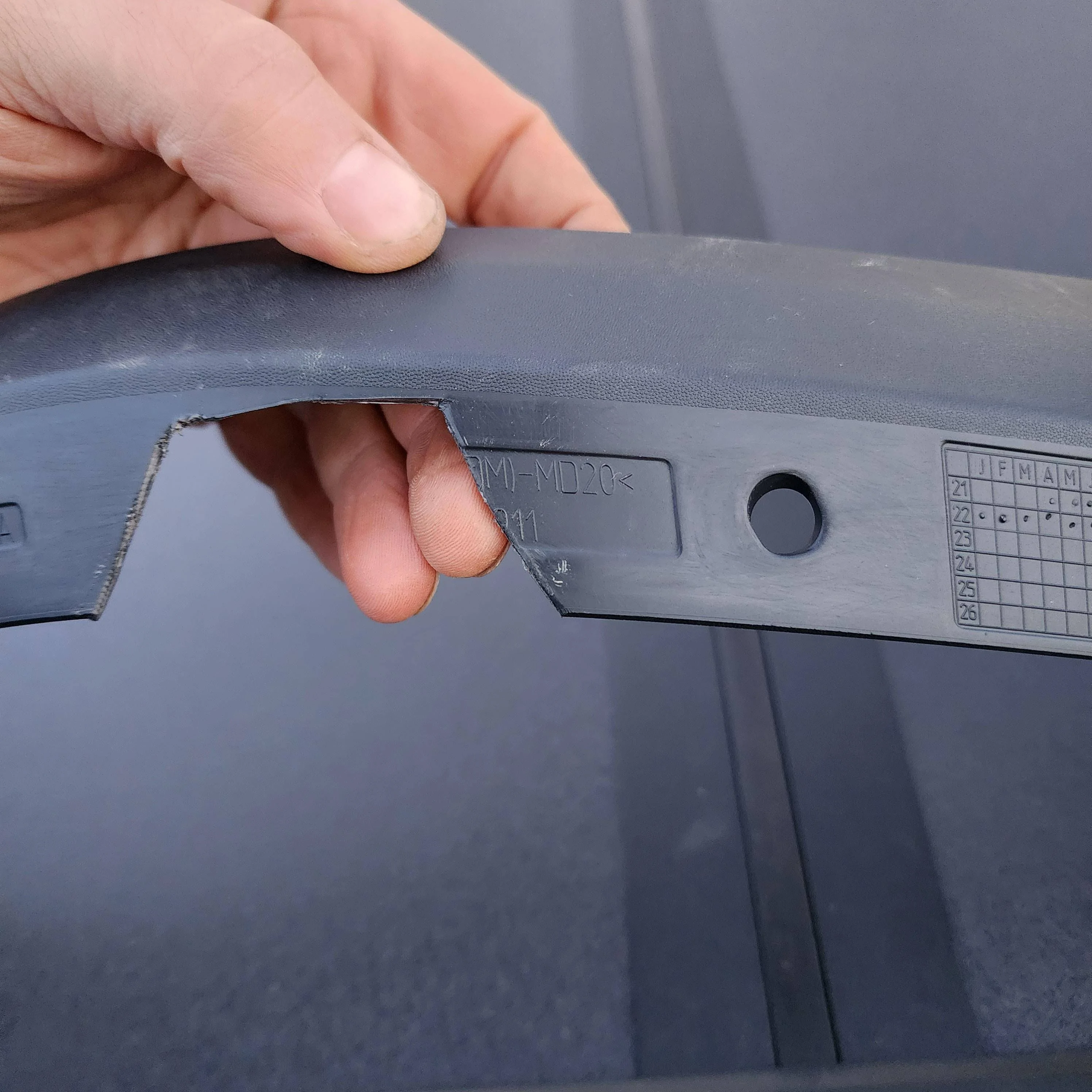

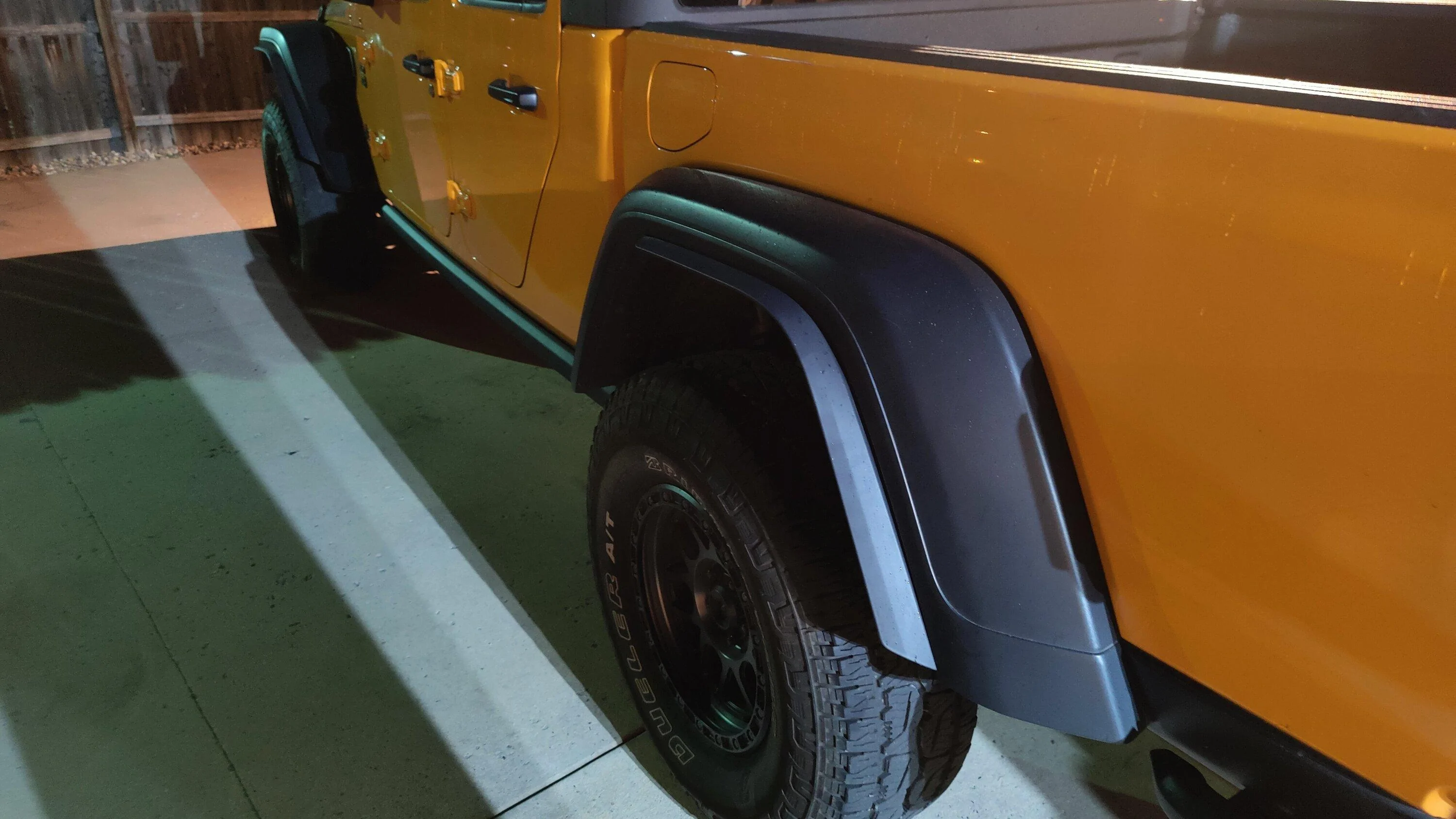

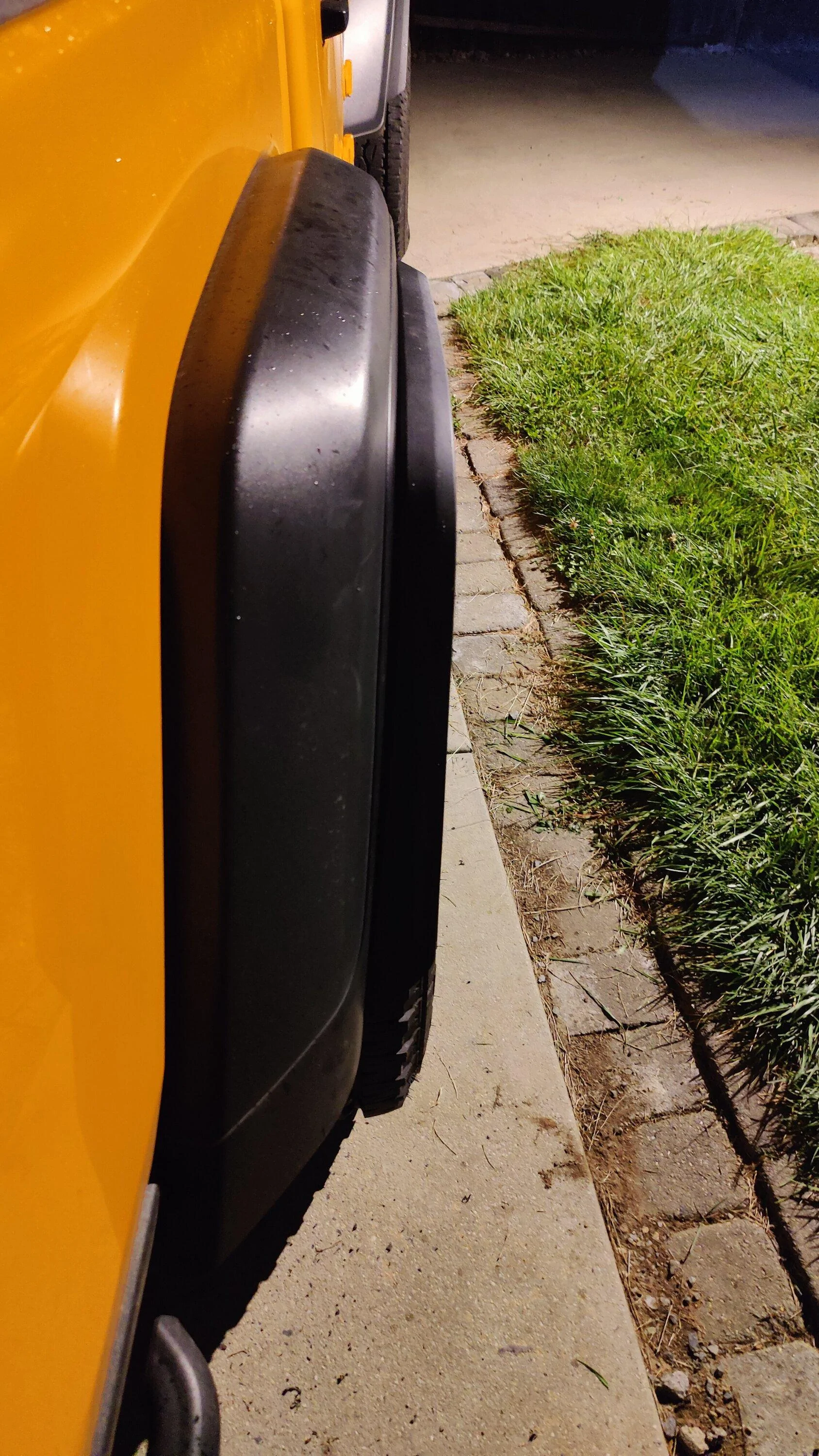

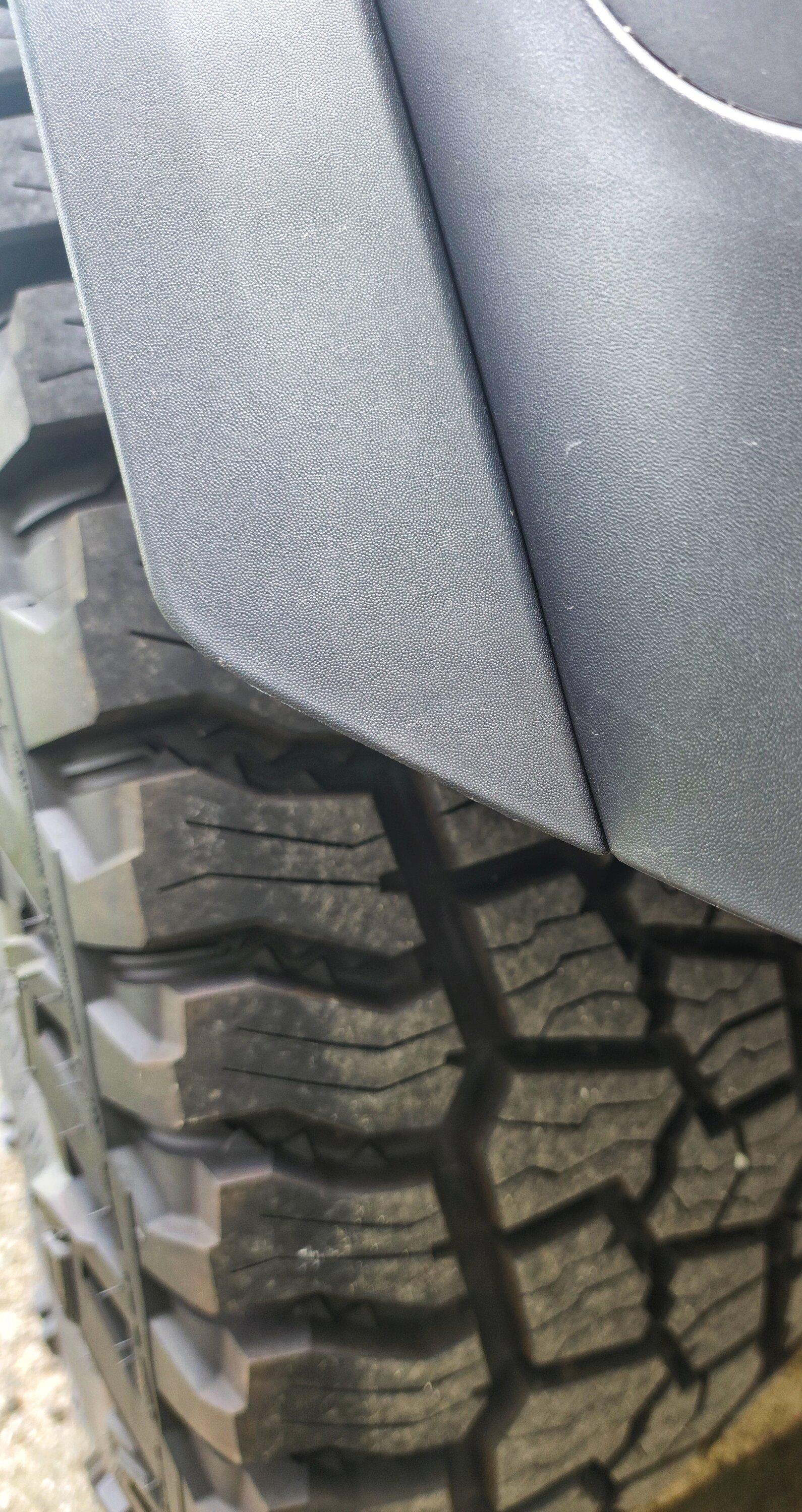

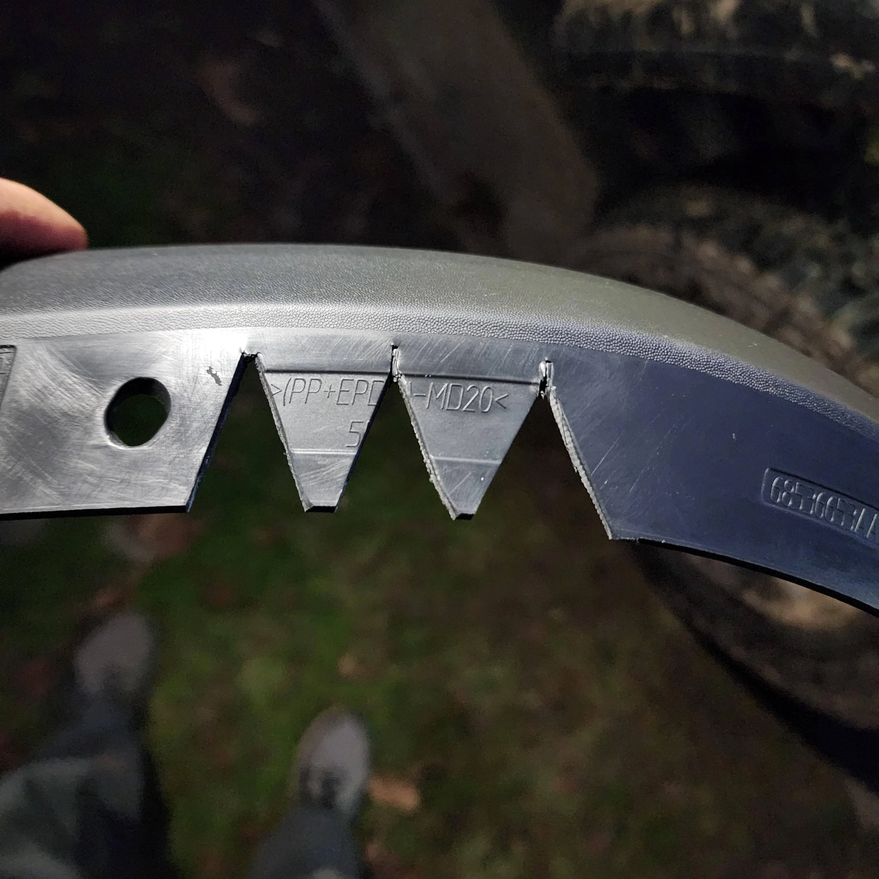

This is the rear, I wanted a flush fit on the bottom. Also a pic of the cut I made underneath to fit the curve of the rear fender
Damn. I couldn't find this post when I was installing mine. Yours came out perfect. I wish I would have aligned the rear like you did. I just used the bottom hole that was already there. I have an extra set of fronts, so I might try again if I don't like what I see in the morning time.

Looks good...They are easy to take off if you want to realign. Ive thought about redoing my front and cutting them to match the starting and ending point like the back. Im deciding if these are enough protection or if mud flaps are in my winter future

You can also align the fronts to end at the bottom of the fender line (see my original post). You may need to make some "V" cuts in the interior of the fender extension to bend it into place. Anyway, nice job looks great!

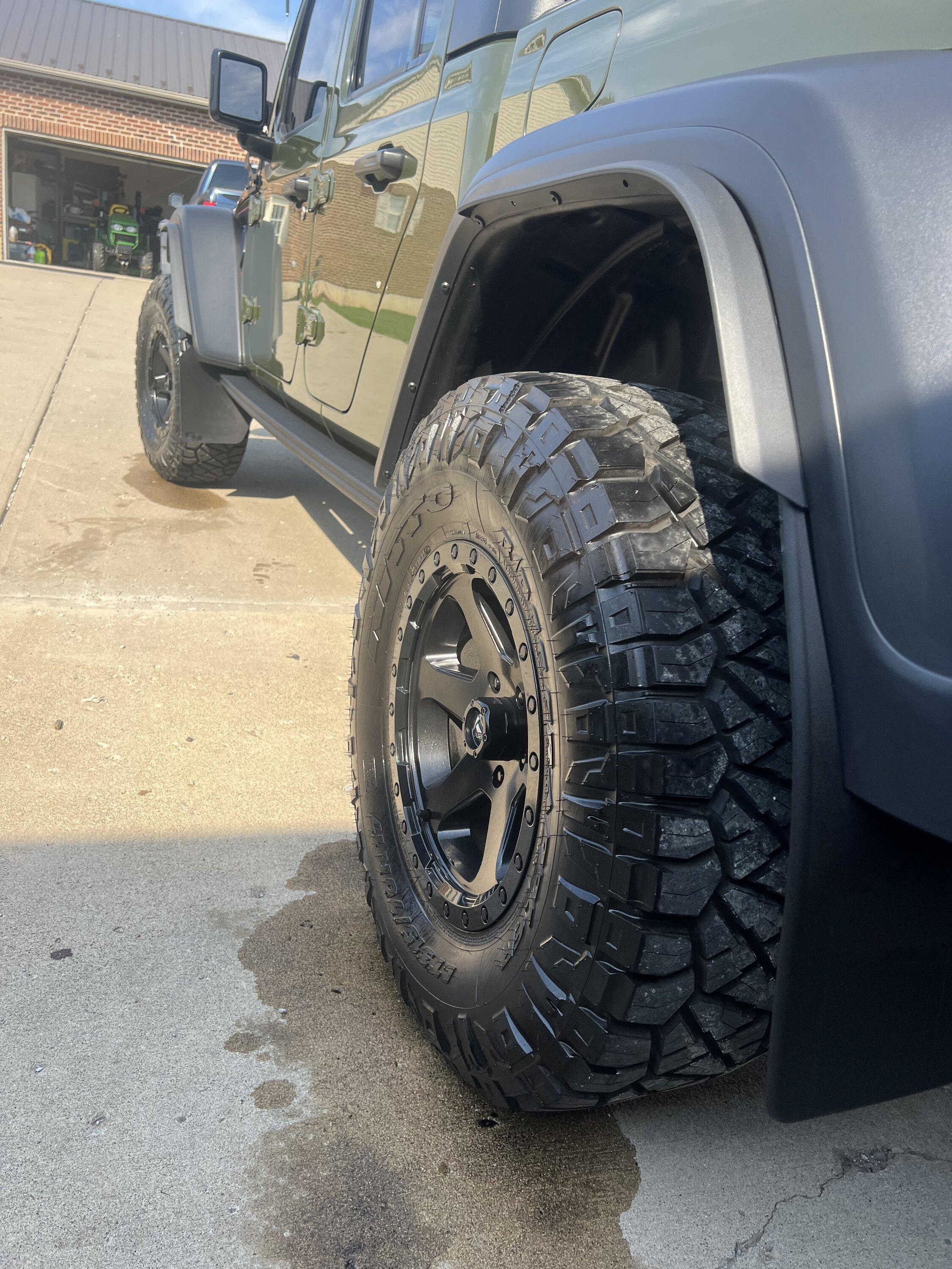

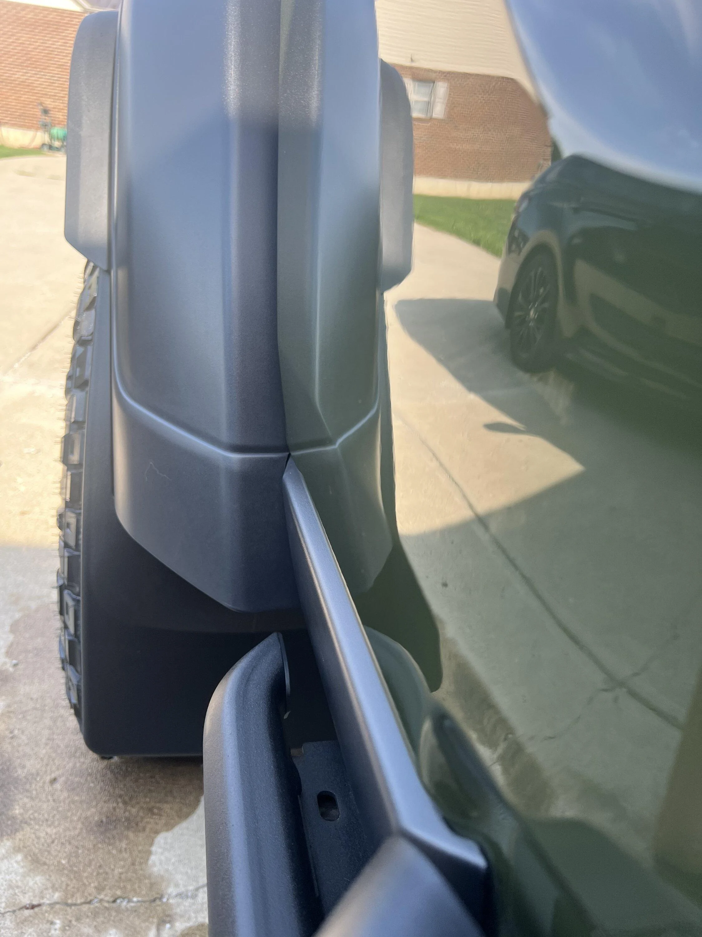

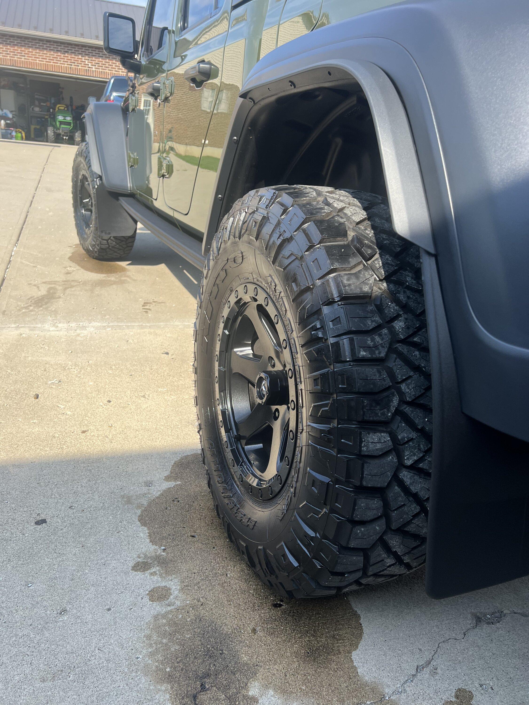

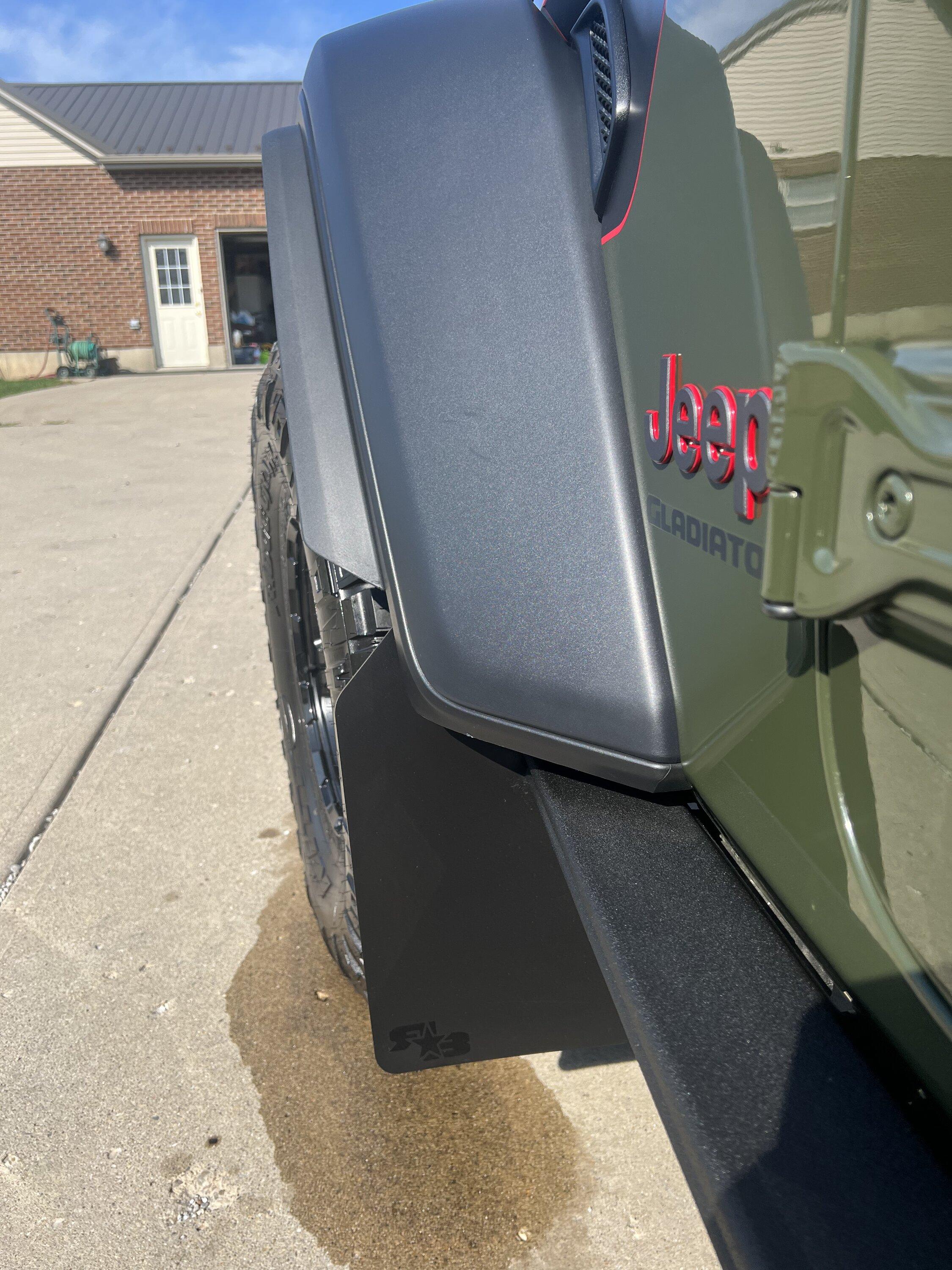

First off... THANKS to everyone here that have shown me this mod and how-to also! The perspective from the various installs led me to do a bit of a hybrid of a couple of you guys' installs.
For the FRONT, I kept it "stock" using the existing rivet holes. I really liked the combination of the fender extensions + Rokblokz mudflaps on @Dls79's set up. So I plan on doing the same (@Dls79 - what size mudflaps did you get?)
Jeep Gladiator Xtreme Recon Fender Extension Instsalled xTreme Recon Front Fender Mod

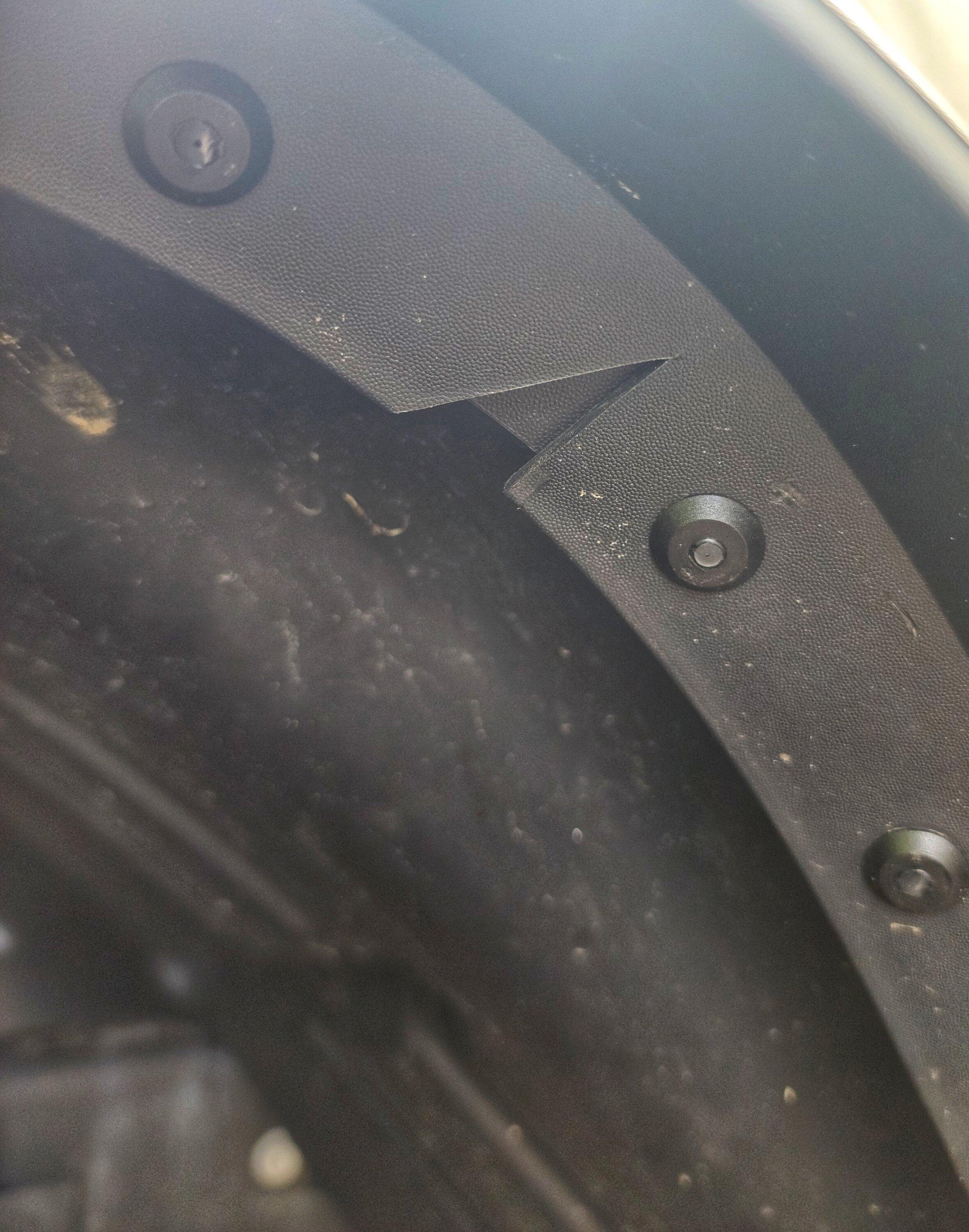

For the REAR, I did the Front XTreme Recon Flares and made them flush with the bottom. I made the same cut to get it to bend better. Then I also used double the rivets to really keep them in place nicely.
Jeep Gladiator Xtreme Recon Fender Extension Instsalled xTreme Recon Rear Fender Mod
A couple of shots from some distance... don't mind the imports in the shot... ;p

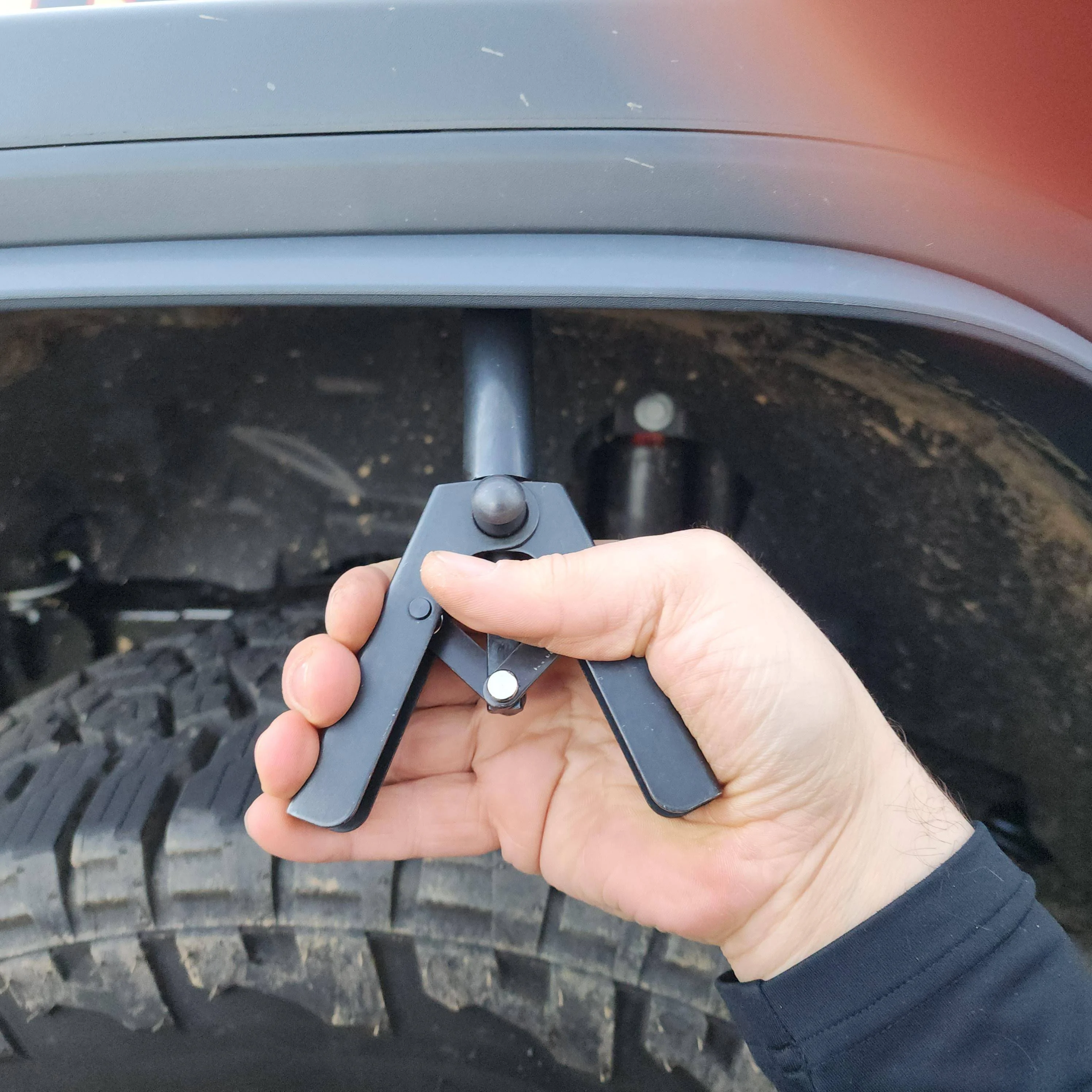

That looks familiar, I did the same thing last weekend...
So if you did it over again, you'd align the fronts to the bottom? A relief cut and redrill to make it happen.
I have the 2x front flares, rivets, and tool. Trying to figure out what I want to do with the fronts, the rears I will be copying you, cause it looks mint. Lol
