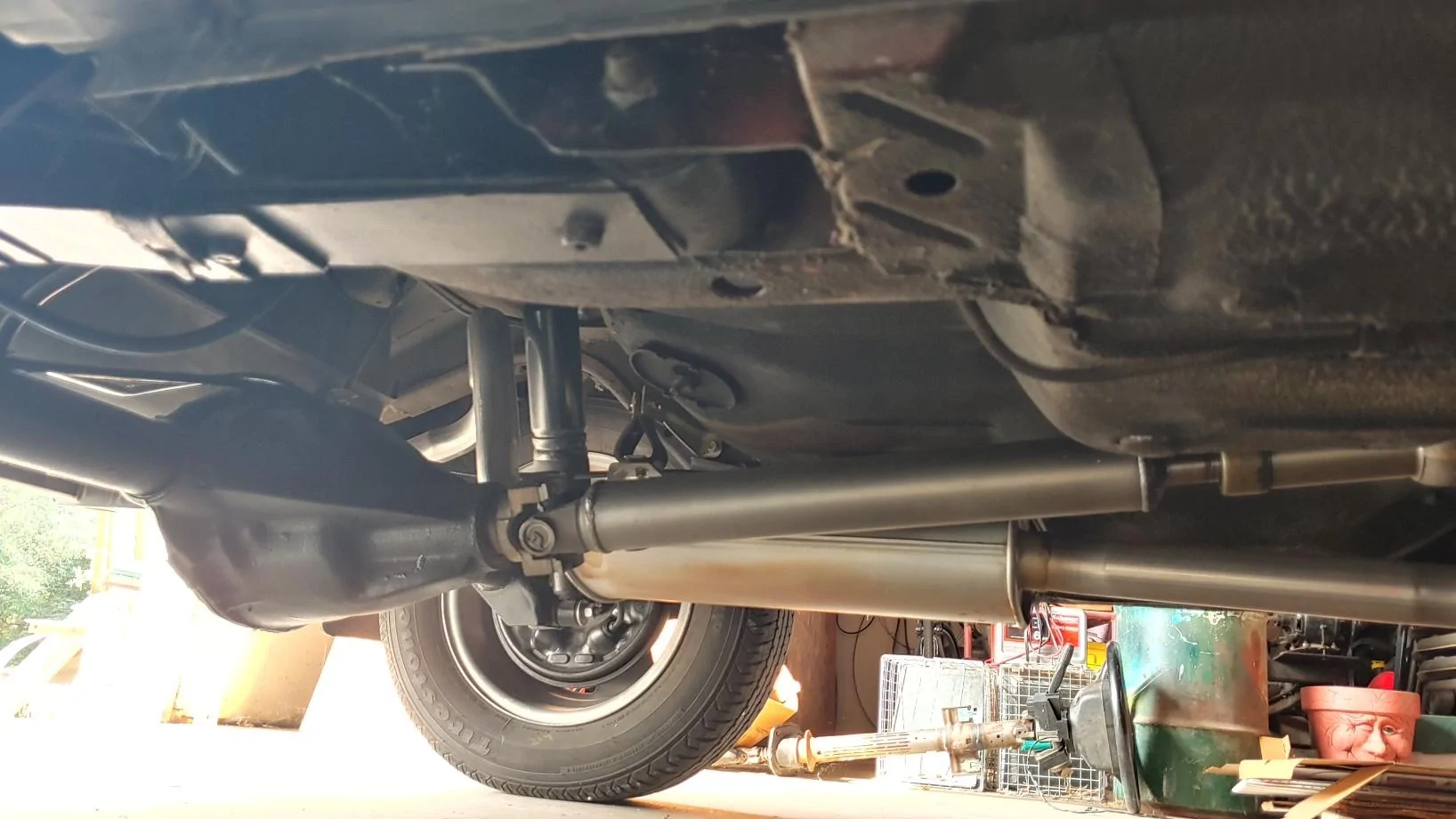

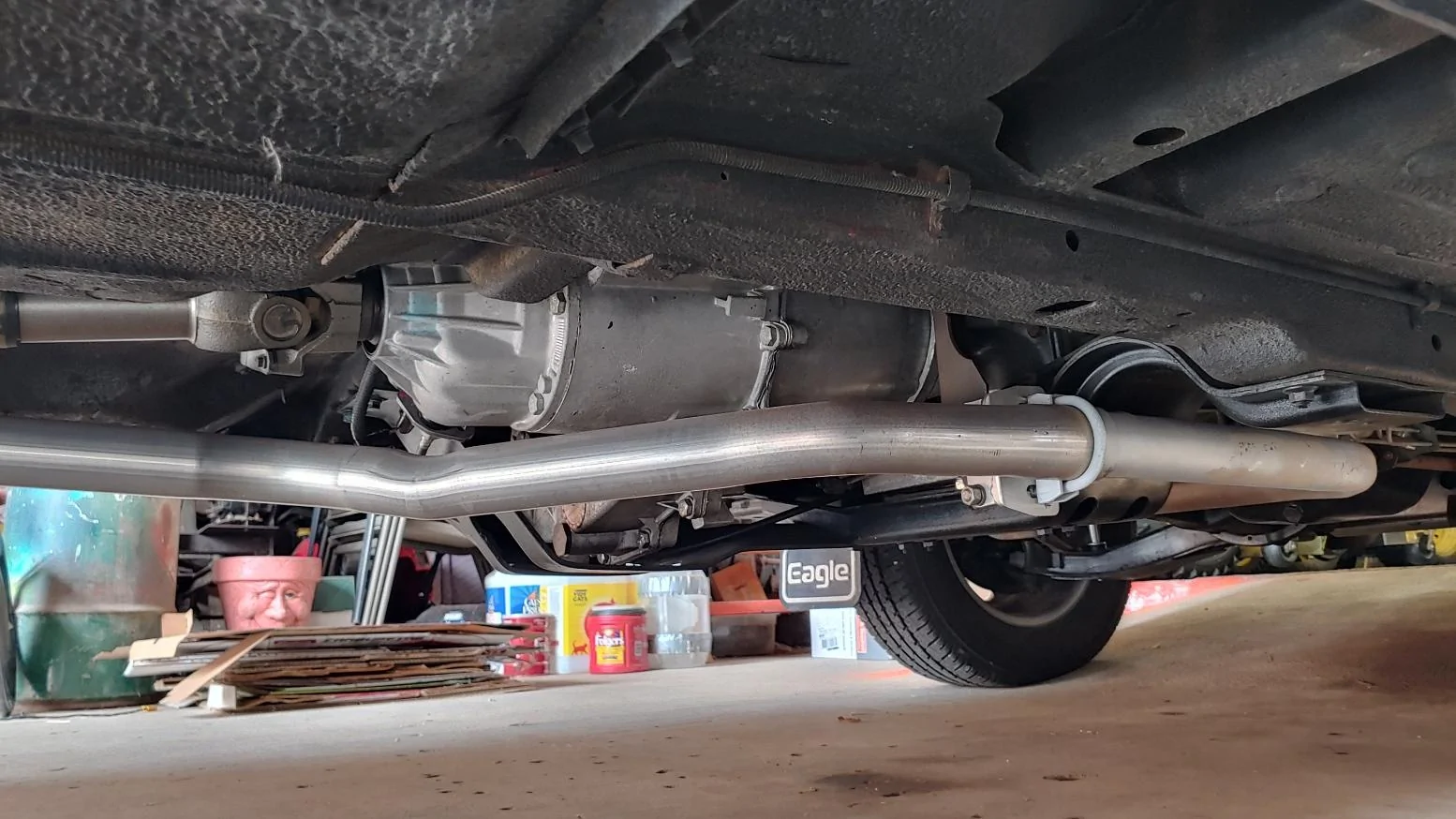

I will need to touch-up the underside of my truck this spring. There are spots like where some of the welds are and other areas - oddly, this 40 year old car is as good rust-wise. Gotta keep up with the treatment.
Jeep Gladiator Your gladiator after a year or two in the rust belt 20210912_103034_HDR
Jeep Gladiator Your gladiator after a year or two in the rust belt 20210912_103042_HDR
You can see where it needed to be "touched up" but still no rust -

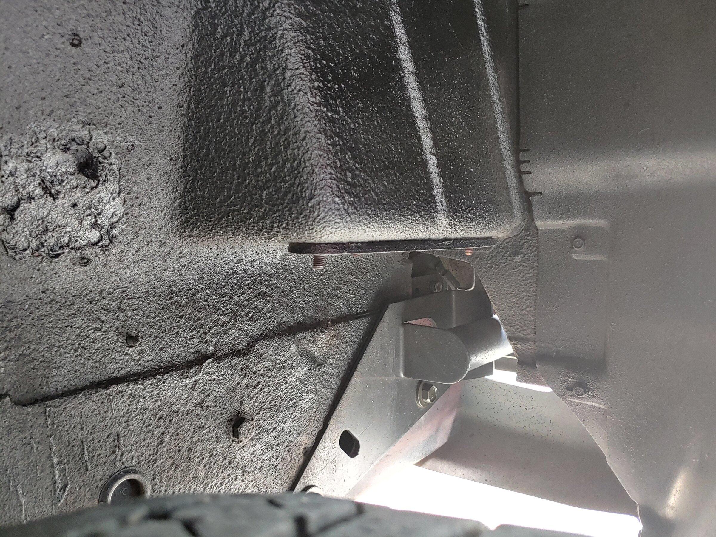

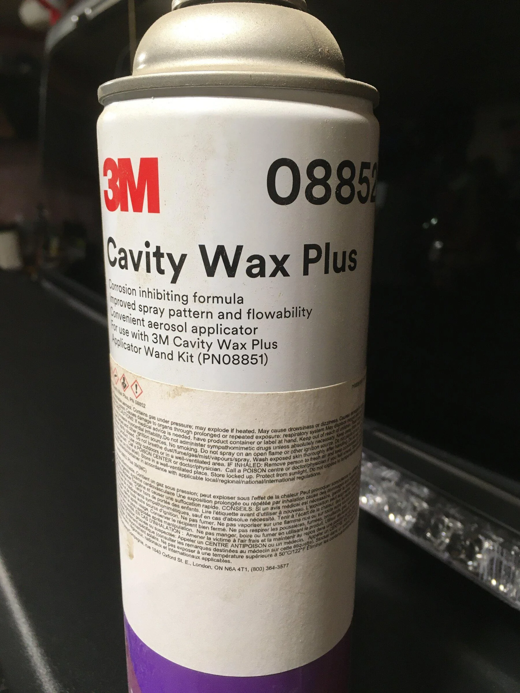

What I did for mine was to have the dealership undercoat it before I took possession in February 2021. I then ordered 3M Cavity Wax with the spray wands and did the frame internals, inside my door panels and anywhere else that had holes the wand would fit and gave everything the “3 pass” wax application.
I also ordered CRC Heavy Duty marine corrosion inhibitor wax and sprayed all the parts that couldn’t get undercoating and sprayed another layer over all the welds. I still have no rust.

First thing I did, at about 200 miles, was wash it (already some dirt and dust) and do a nice thick coat of HD metal protect. Except the inside of the frame. Dont have the right tools to do that yet.
Take a look at 3M Cavity wax for the inside of the frame. That's what I used on the inside of the chassis when it was new. Check out 3M 08852 cavity Wax and 3M 08851 Applicator wands. https://www.3m.com/3M/en_US/p/d/b40066669/
I have used Fluid film in the past, but I didn't use it on my JT because it never dries, and it creeps seemingly forever. Now, that may seem like a good thing, but it attracts dirt, can creep onto places you don't want it and makes a general mess.
The 3M Cavity Wax is non-hardening & self-healing without the long-term continued creep. So, as long as you get the surfaces thoroughly coated you are good. Note that the 3M Cavity Wax is not suitable for exposed surfaces.
For exposed surfaces, IMO stick with the HD Metal Protector that you are currently using. I am using a similar product, CRC Heavy Duty Corrosion Inhibitor, on all my hardware & brackets. It does a great job of penetrating and it then dries enough so that it doesn't attract dirt and it doesn't make a mess. I even use a light wiped-on coating of it to keep my brake calipers & brackets looking new.

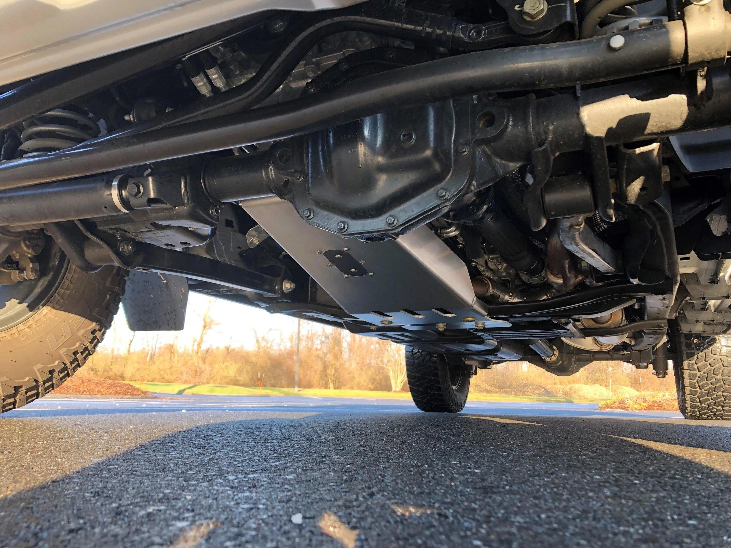

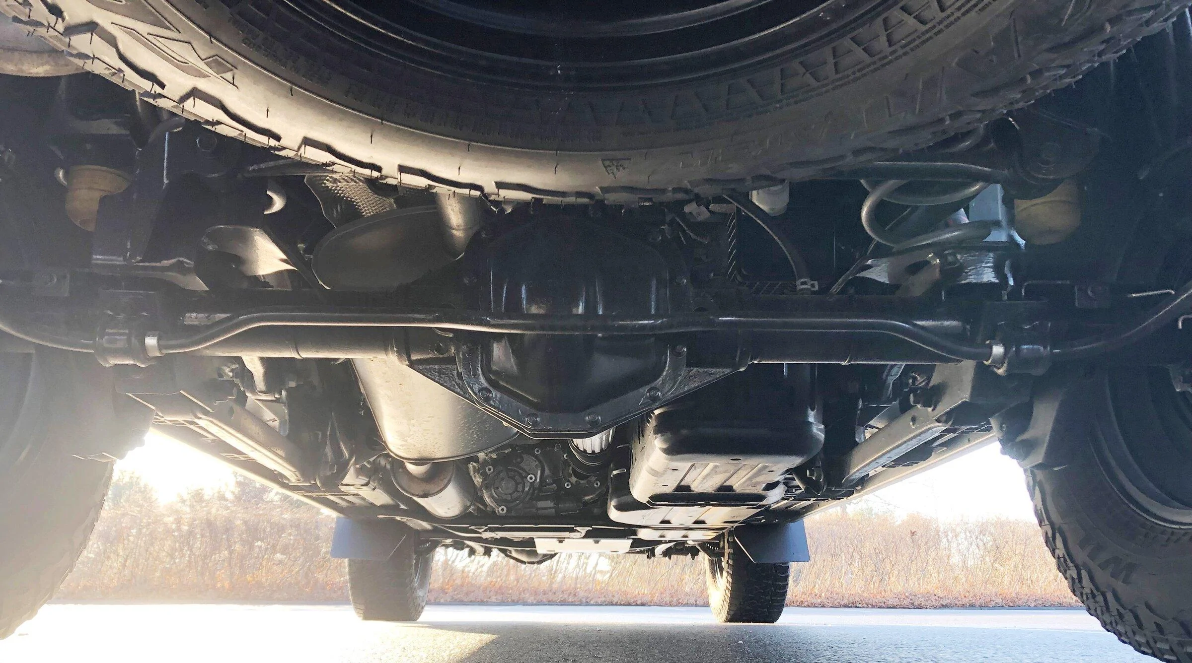

Instead of posting some pictures of un-related vehicles, here are a few pics of my Mojave after a CT winter (and I haven't even done my spring undercarriage cleaning yet):
It's not really an option for you now that you have used the HD Metal Protector, but I find that a nice heavy coat of oil-based RustOleum brush-on semi-gloss black paint works wonders. It is a lot of work to do at first, but it holds up well. I did both my front & rear axles and exposed areas of the chassis in the rear wheel well areas.

wow man that looks stellar considering its already gone through a winter. I'm truly shocked how well that held up. I can only hope to do a good job and have mine looking that good next year.

The 3M Cavity Wax goes on fairly heavy and stays soft. The application wands give 360 degree coverage inside the frame rails. It doesn't stay wet like Fluid Film, and it doesn't set up firm like HD Metal Protector. If you do a Google search, you should be able to find several videos showing application of the 3M Cavity Wax to see what the stuff is all about.
The skid is an ASFIR aluminum skid. I installed it because I did not like how exposed the oil pan, exhaust crossover and transmission lines were. Plus, I'm using a Stahlbus oil drain valve, and I don't think I'd be comfortable using it without protection.
