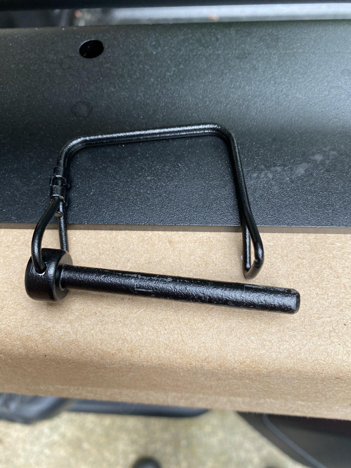

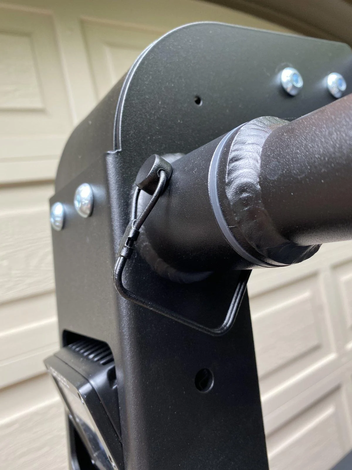

Looks great. How to the side doors stay open? I don't see any pneumatic arms. Are they spring assisted? How easy do you think they'll to open once you start mounting things to them (rotopax, hilift, etc.)?
The side doors use pins to keep them open or shut and do not have any sort of assistance. They're rated for holding 35 lbs each, so aren't going to get unmanageably heavy.

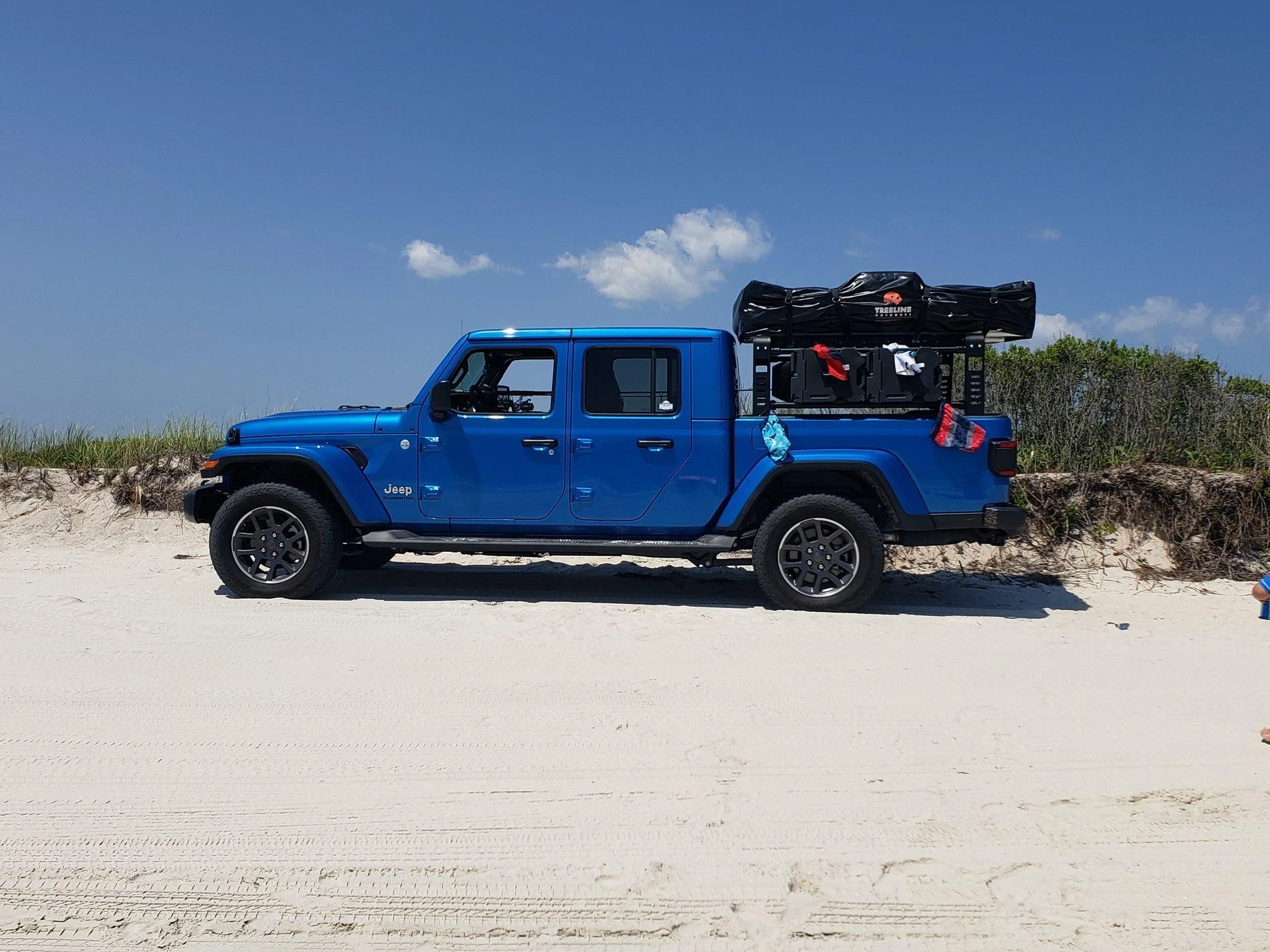

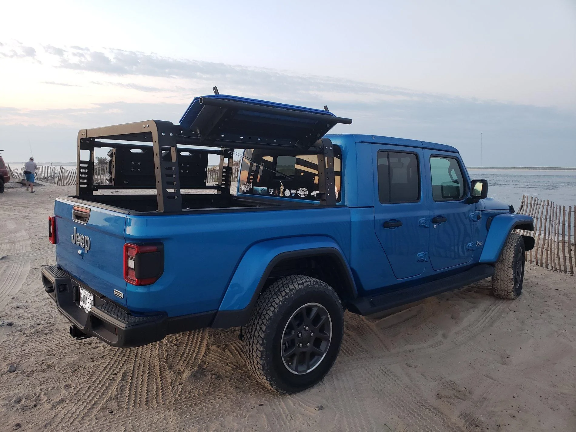

@bradxn how did you run your wiring harness for the led's? The install instructions completely ignore this and I haven't been able to settle on what I want to do.

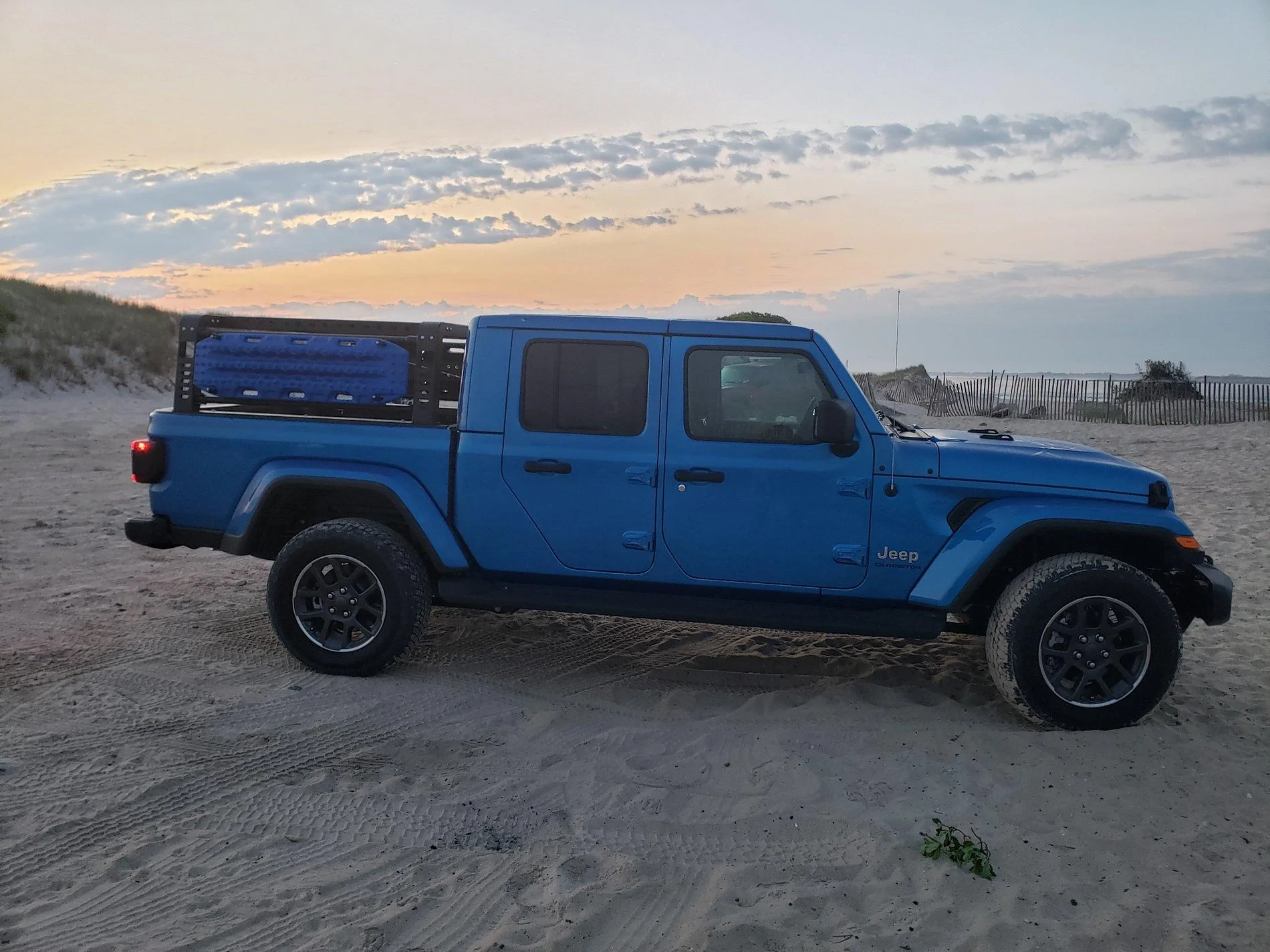

Other than that I've been pretty happy with my rack, in the month I've had it on the truck it's been on the beach probably 20 times with no issues (I tightened 2 bolts that had just barely wiggled loose yesterday).
If you asked me to nitpick:
- yes having to remove the cargo management rails was annoying but I think I can work out a way to remount them to the rack if I want to
- if the vertical supports on the wings had been like 2" wider they would've fit a pair of MaxTrax...as is I cut a piece of aluminum plate and mounted it to the wing
-the layout of the mounting points on the cross braces mean that my tent is slightly (like an inch and a half off center)

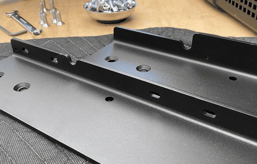

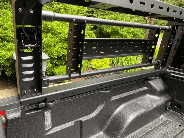

I received the correct base rails and the Trail Rail mounting hardware yesterday and have finally finished installing the rack. Here's what changed with the base rails:
Jeep Gladiator ZroadZ Rack 1596117925754
These are upside down, looking at the plate that sits on the edge of the bed. The beveled holes are for the bolts that join these rails to the vertical supports of the rack. One of the old rails is on the right and the new rail is on the left. The old rails had a long lip for most of the length and one end had that shorter bit in order to clear the tailgate frame (normally the rack would be farther back):
Jeep Gladiator ZroadZ Rack 1596118389814
The new base rails have the shorter lip along their entire length and are symmetrical. This seems to be a much better design and I can't think of any drawbacks.
The old mounting system used three clamps on each side. These clamps bolted to the holes you see on the tops of the base plates and clamped the plate to the walls of the bed.

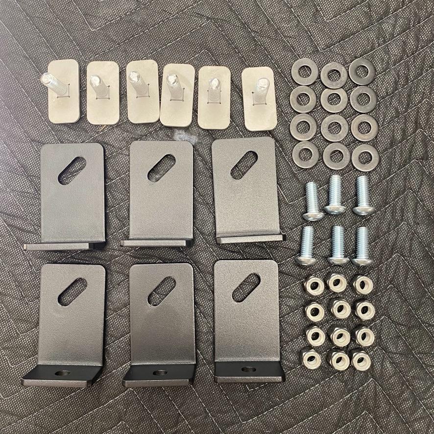

The new system has three L-brackets that replace the clamps and attach to Trail Rail inserts. Here's a picture of the new mounting hardware:
Jeep Gladiator ZroadZ Rack 1596118806114

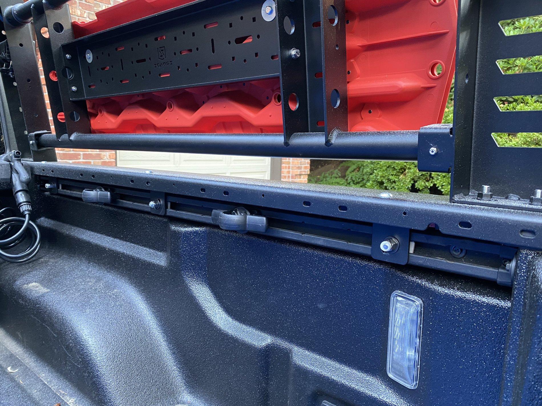

Here's a picture of the new rail:
Jeep Gladiator ZroadZ Rack 1596119142805

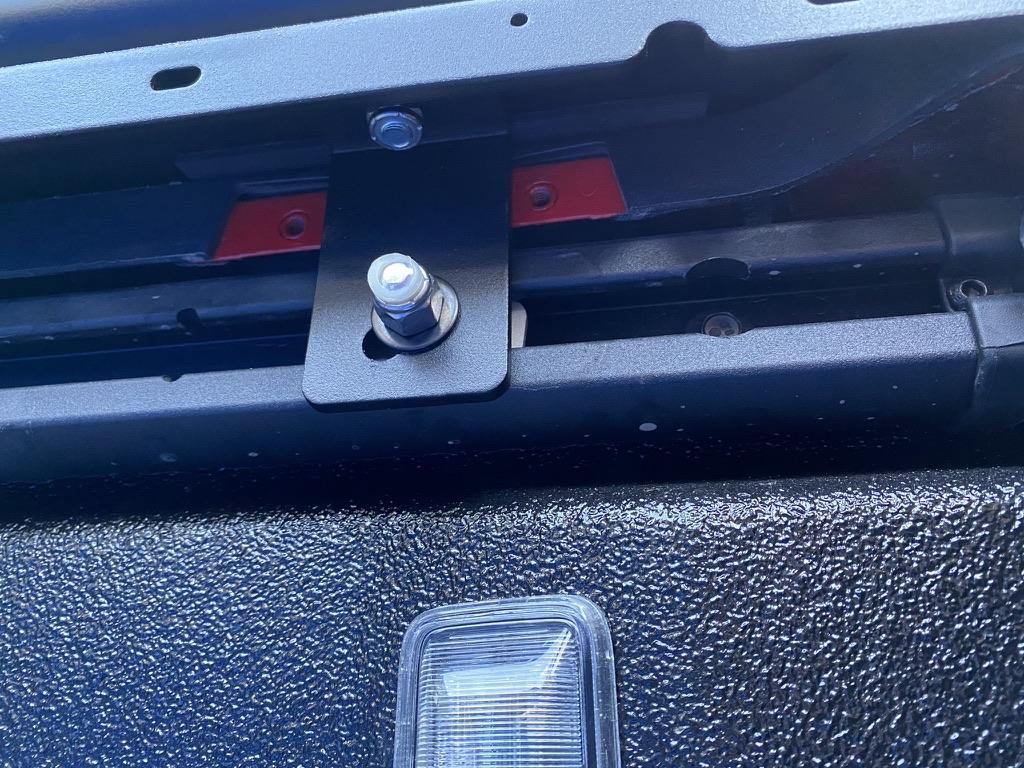

And a closeup of one of the mounting points:
Jeep Gladiator ZroadZ Rack 1596119244945
I have no idea when ZROADZ will start selling their racks with these new rails, but I assume it will be soon. I also don't know if they will be offering them separately for anyone that has the old ones but would like to re-instal their Trail Rail. I do know that they are swamped with work right now and that they don't respond quickly (or sometimes at all) to email or the information request form on their website, so call if you want to contact them.
It has been a frustrating wait, but I'm very happy with my new rack and am glad to still have the use of my Trail Rails. Now I can get that Frontrunner rack installed on top...

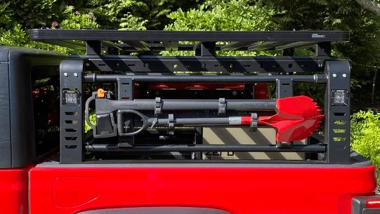

Here is the ZROADZ rack paired with a Front Runner tray:
Jeep Gladiator ZroadZ Rack 1596412720946
This is the 61.4" long by 56.1" wide Front Runner Slimline II tray with the "tall" legs.

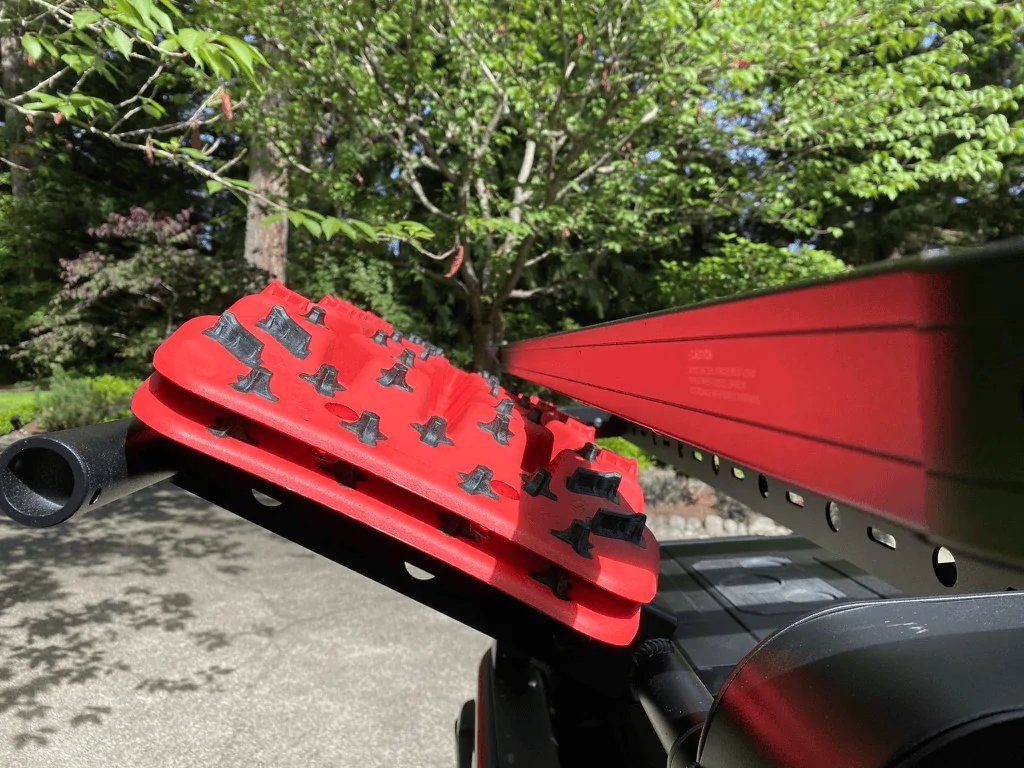

I was a bit concerned that things mounted to the rack's side gates would hit the tray when they were fully opened, but it worked out great. The shovel and axe on this side have plenty of clearance, and the other side has two Tred Pro's that fit perfectly:
Jeep Gladiator ZroadZ Rack 1596413660394
Baemen
Jul 9, 2020
11795
Gladiator Overland
That's awesome on the Tred Pros...the MaxTrax mounting pins hit the bottom of my tent (which isn't really a big deal)...but maybe if I add that Front Runner tray it will give me the clearance and give me more space to mount fishing gear :)

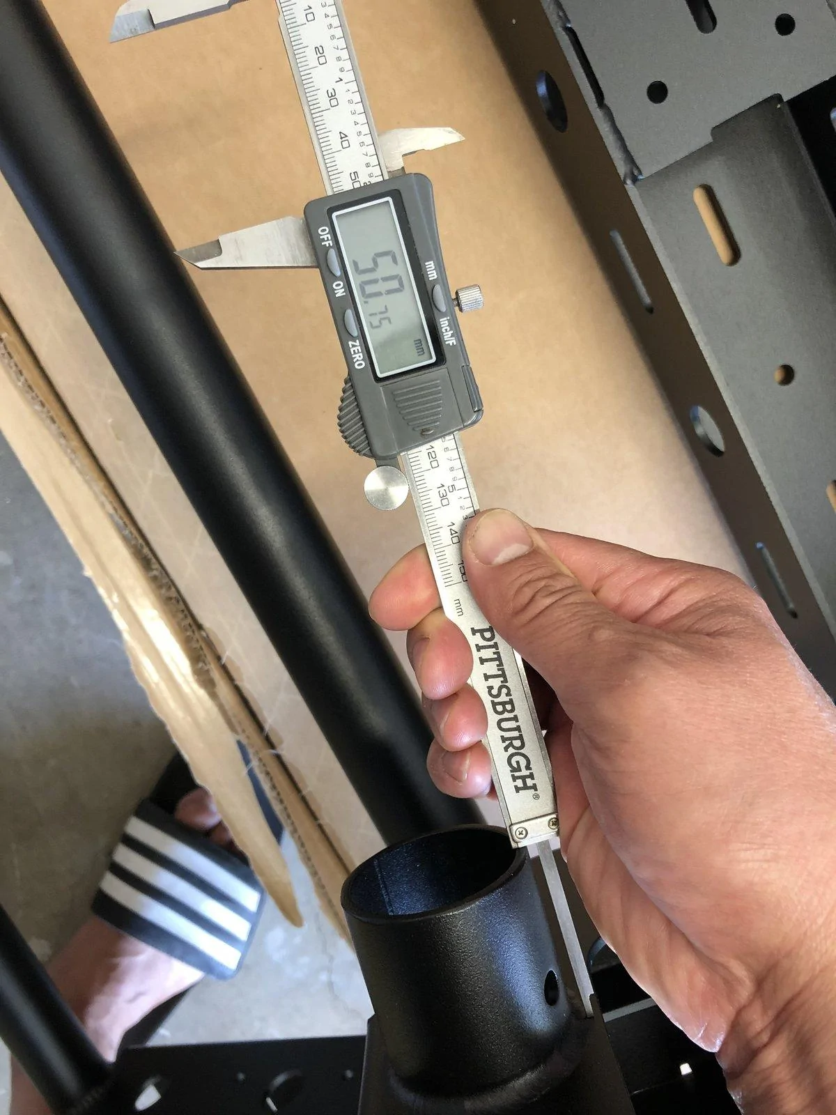

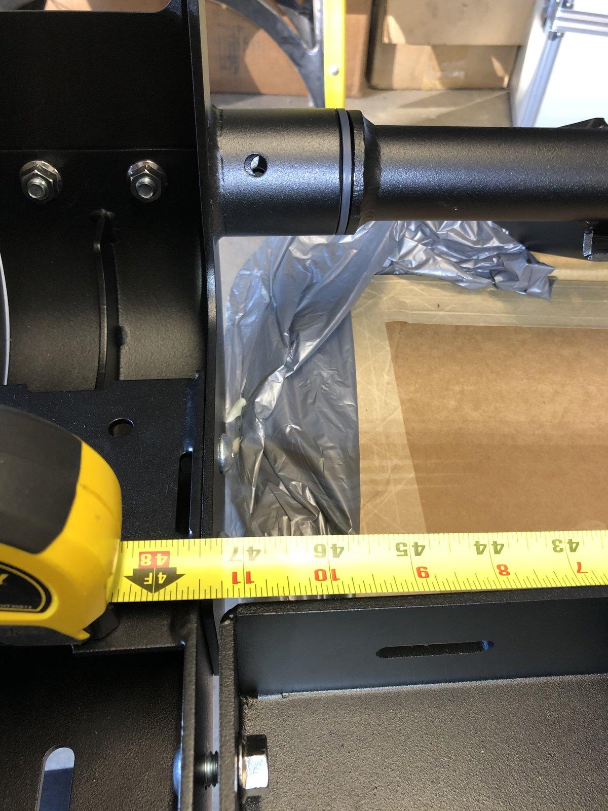

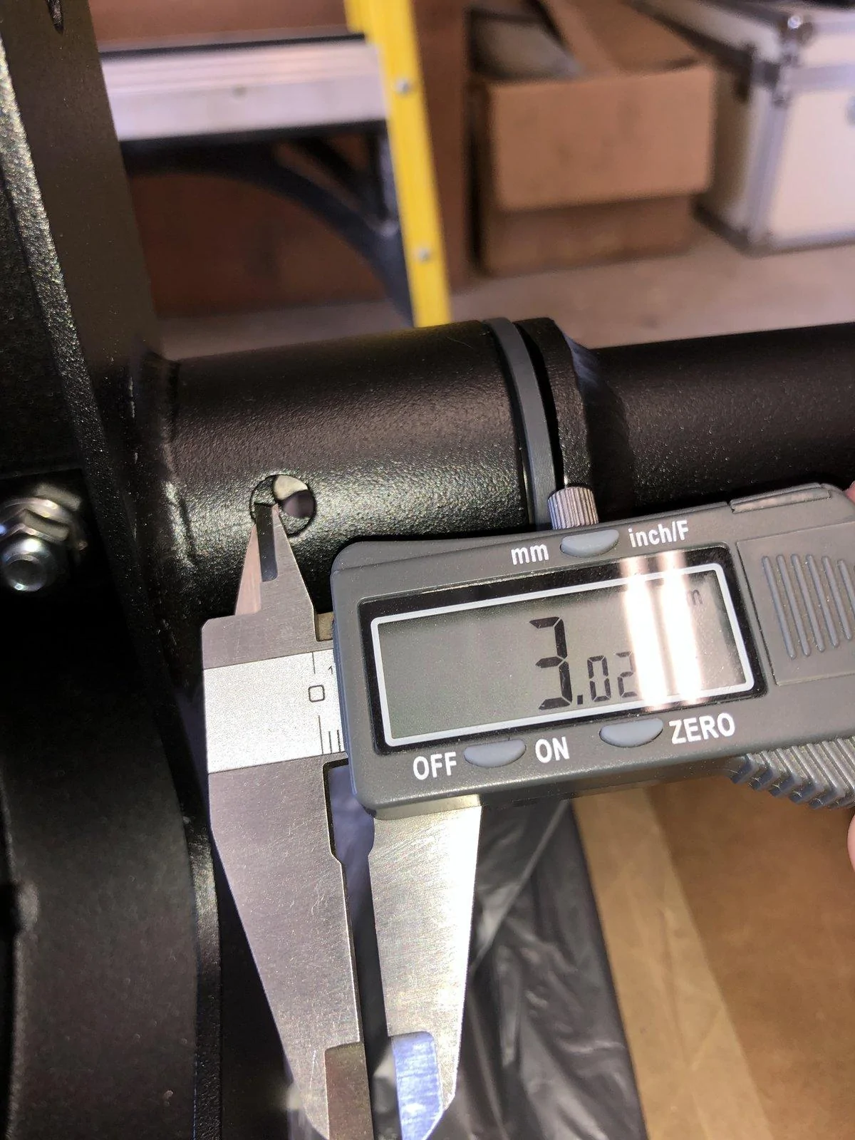

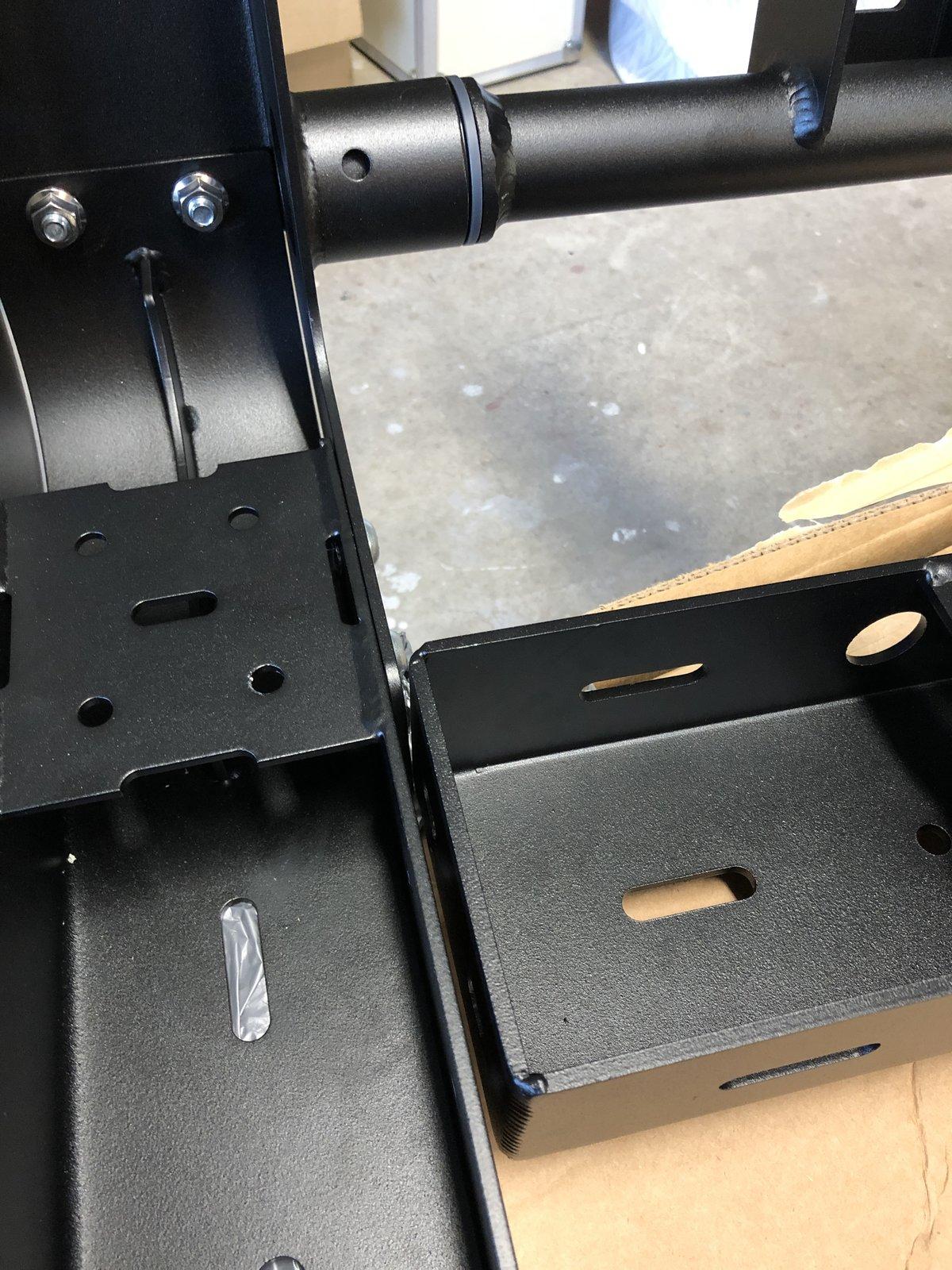

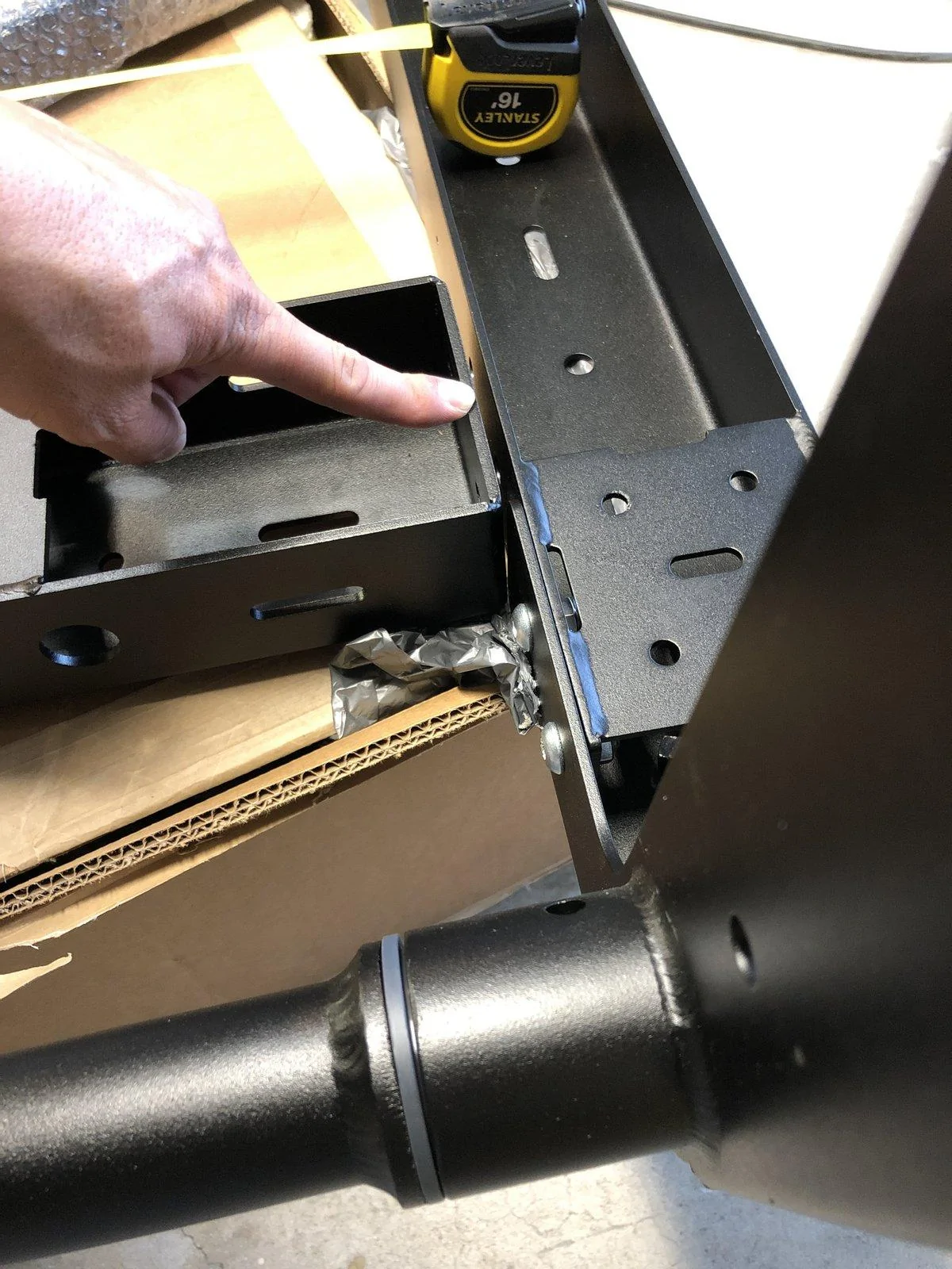

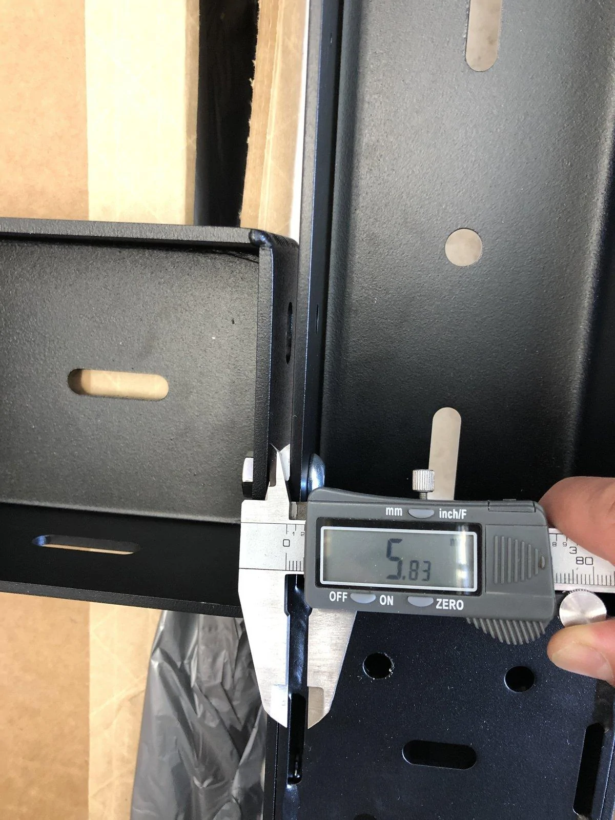

Anyways I finally took delivery of the rack last week and tried to install a few days ago. I ran in to an issue where the measurements we're off by 1/8in! There is a 1/8in gap between the rails and the transverse bar that goes across the top. If I tighten it down, it would bind the gates and also bend the rails and put severe strain on the welds. Here are some pics of my issues.
The tube that the gate slides into is about 1/16in too long/tall. If that was shorter, the hole for the pins to hold the gate up would align and fit. So if both tubes were fixed, then the 1/8in gap would fix itself.
I've been going back and forth with txt and emails with Victor and they couldn't figure out my rack was out of spec. I just dropped it off today with their designer Dan to take a look at my rack and figure out what went wrong. They said they've sold over 100 and I'm the first to have a problem. They suppose to have a new rack ready for me by this Monday so we'll see. Anyways I'm doing an install video to capture all of this for others to view and will post on YT shortly.
Just a little disappointed with this experience; leaving my truck, waiting for the rack, get a defective rack, waiting again, dropping it off, waiting again! Ugh. I just want to go camping!!

I didn't have anywhere near as big as your your 1/8" diff in the length of the cross bar vs gate shaft....but the holes for my locking pins only line up in 2 out of 4 places.
It's possible that if I flipped the gates from one side to the other they might line up but I only noticed after I'd mounted mine to the bed and since most of my driving is on the beach and 1 pin on each side seems to be working just fine there was no way I was taking everything apart to find out.
Hope they get it sorted for you soon
